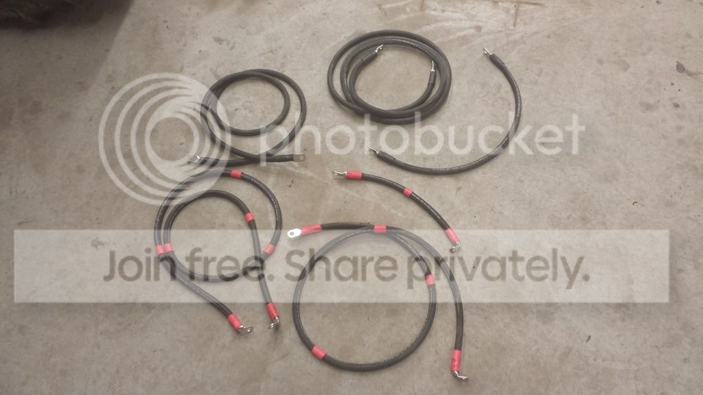

Assembled the battery cables tonight. All six of them. Because the ground side is just as important as the positive side, everything is done with the 2/0. The hot cables are, battery to cutoff switch, switch to starter, switch to positive distribution block. Stuck some red shrink wrap along the lengths of these. I'm a firm believer in as many grounds as possible. Those cables are, battery to motor, battery to frame and battery to negative distribution block. I have a ground braided ground strap I might run from the body to the frame too, but shouldn't need it because everything in the cab will ground through the distribution block.

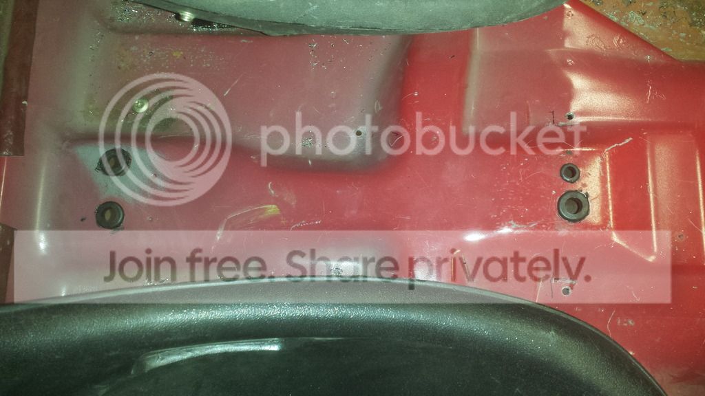

Two holes on the left are where the positive and negative cables come into the cab. Two on the right are where the positive goes out and "S" terminal wire for the starter. Will probably use the smaller one for other wires too.

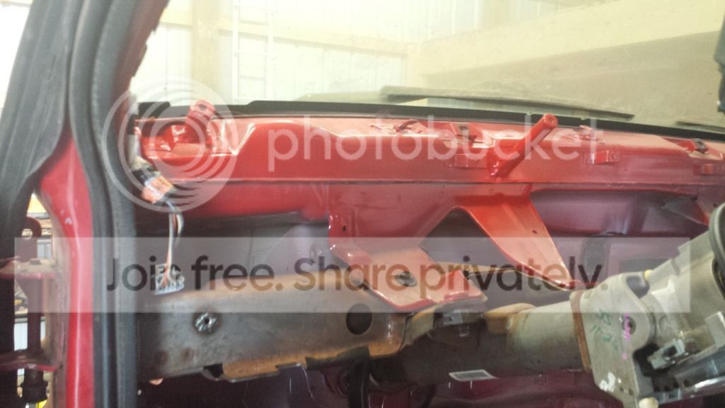

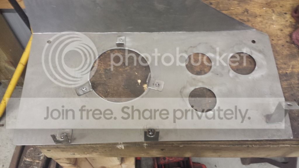

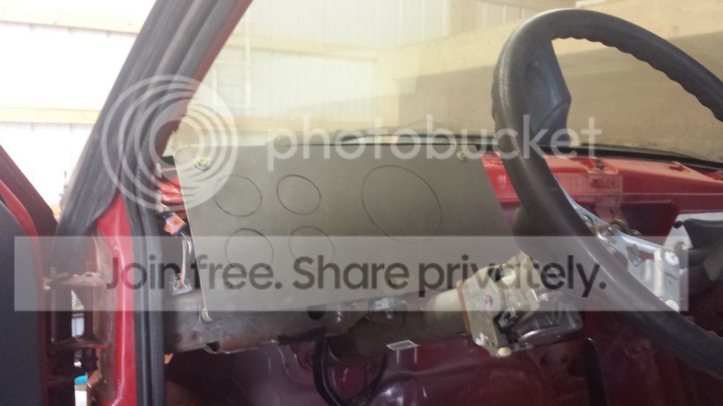

Got a decent start on the gauges today. Cut the panel, got it mounted and started drilling holes. Panel was easy to do after I got it nailed down with the cardboard, simple shape with one bend. Added a could tabs along the bottom, stuck a couple stand-offs on the cab under the windshield. Measured for the gauges and drilled pilot holes. Used a jig saw to cut out the big hole for the tach. My 2" hole saw sucks so I picked up a new one when I went into town earlier, will drill those tomorrow.
Some leftover tube with nuts welded into the end on the top. For the bottom I used the two studs that hold the steering column and the nut welded to the support brace. I may have to add a third along the top if the weight of the gauges makes it flex any. Or some kind of backbone on the panel to stiffen it up.

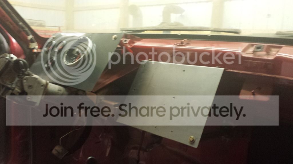

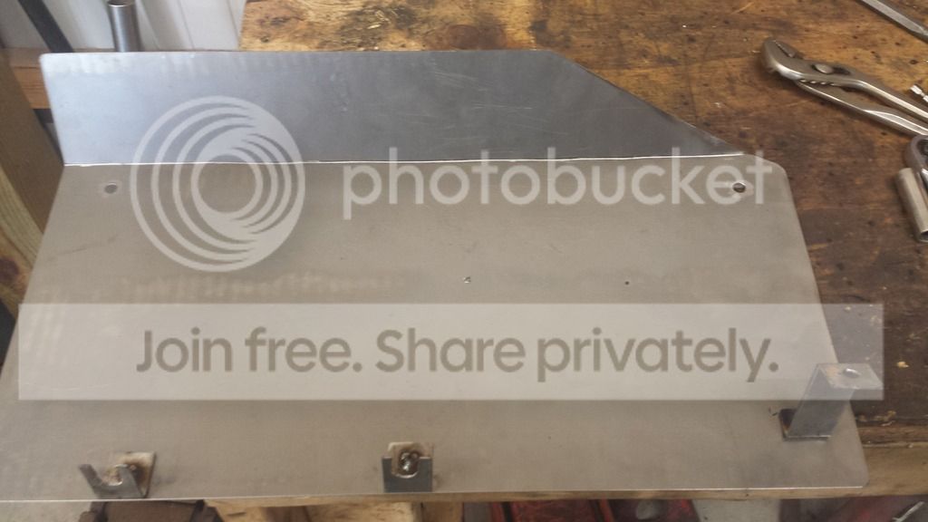

Back of the panel. Need to add two tabs for the tach to clamp to. Will do that tomorrow too probably.

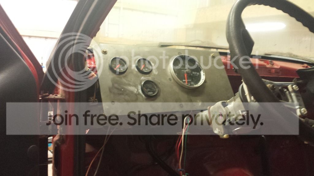

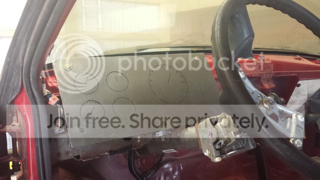

What it looks like in the truck. I drew/measured for 4 gauges on the side, but will only have three to start with. I dimpled where the center of the fourth is with a drill bit so it'll be easy to drill after I paint it.

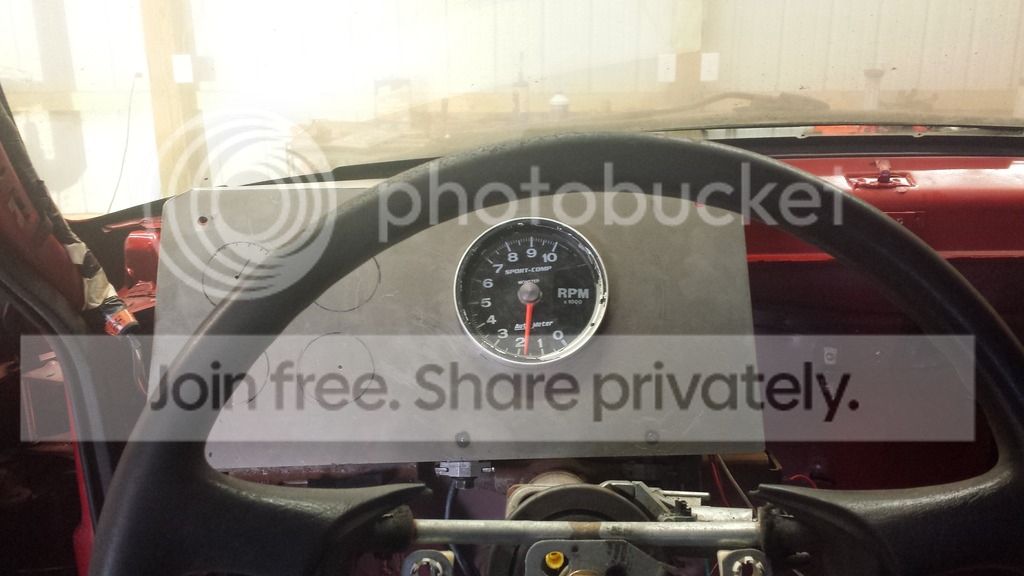

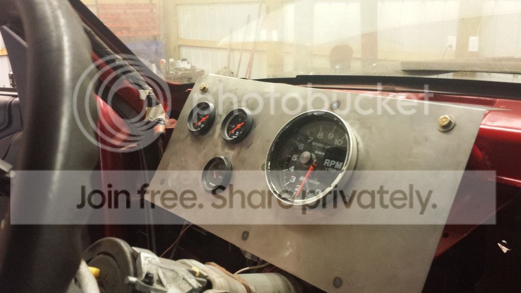

View from the drivers seat. Tach has a light press fit in the hole, will add two tabs on the back and secure it with a hose clamp. Have room on the right for a couple more gauges if I should find a need for them. Plenty of room else where on there to add warning lights and a switch to turn the dash/tail lights on.
What did you use to bend that plate?
Nothing really. Once I had my measurments down I scored it with the grinder, clamped it to the bench (score on the bottom) at the line and bent it down. I did put a piece of angle iron on the top of it to keep even presure across it. I don't think I'll need them, but I'll put a couple tack welds on the bend line.
Pretty much everything I've bent on this thing has been done that way. I find it's the easiest way of doing it without a brake. The smaller pieces I do in the vice...but same concept.

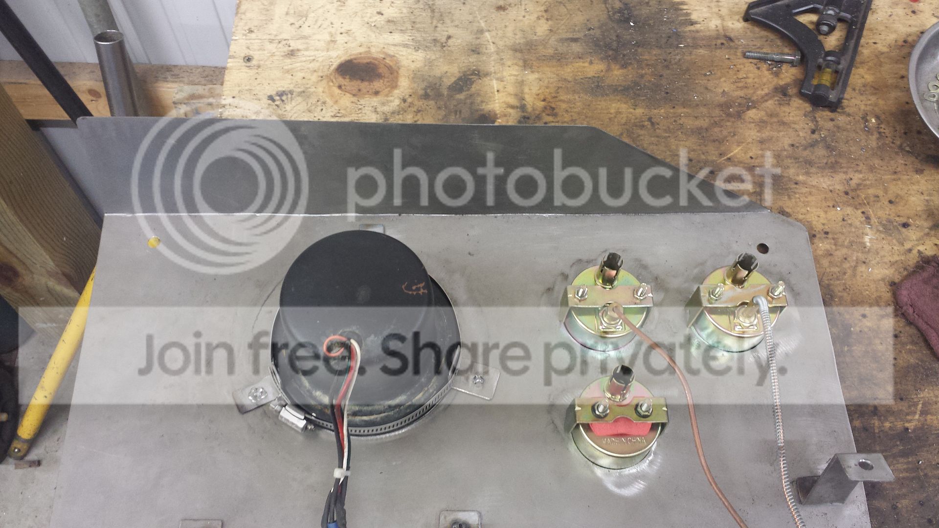

Finished up the dash. New hole saw went right through it like nothing. Added a couple tabs on the back to hold the tach in. Cleaned it up with some brake clean and shot some paint on it, no finished pictures yet because it's still drying.
Backside.
"Loaded" Backside.
What it looks like mounted up.

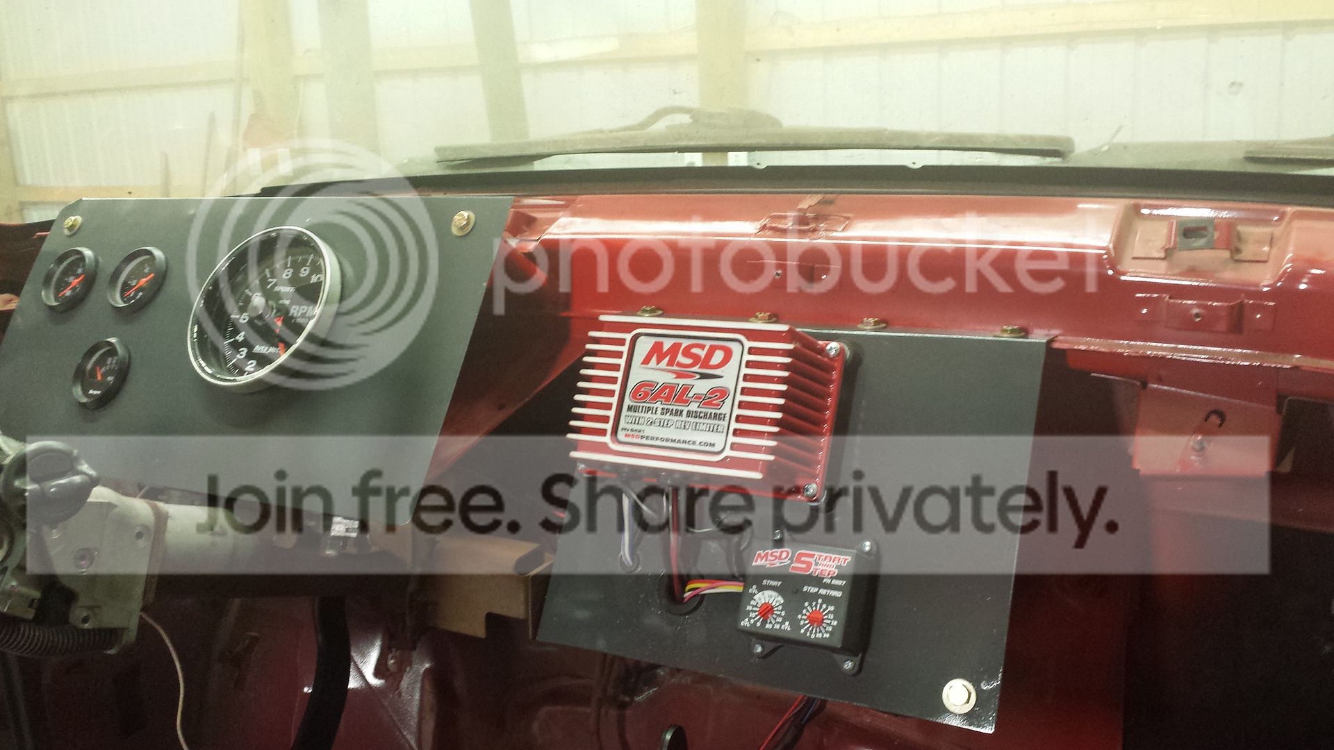

Tonight was a very productive night. Started by getting a panel together to mount the ignition stuff. Painted it, then promptly screwed up the paint. Mounted the boxes and started wiring them. Tested for spark (had great spark) and test fired it off of some starting fluid.
Same deal as the gauges, but with a little bit thicker metal. Used the pinch weld under the windshield for the top row of bolts, the steering column brace on the bottom left and a tube standoff for the lower right. At this point I had put the boxes on there once and thought that was good. Had I thought about it,,,,I would have wired them up first, taken it apart then painted it. I put some decent scratches in the paint when drilling for the grommets.
Everything wired up. The grommet on the left has the wires that come out from the box separate, blue wire for the lower rev limit trigger, white wire for the 2step box and a white/blue wire that I'm not using. Grommet on the right is the violet and green wires for the pickup coil. Each box has their own, but only one set is needed. The 2step box is triggered by the white wire from the big box. If for some reason I need to bypass/eliminate it, I can just unplug the trigger wire and move the violet/green wire to the other box. Pink wire from the small box is the trigger for the timing retard, that is tied out of the way in back till I need it.
