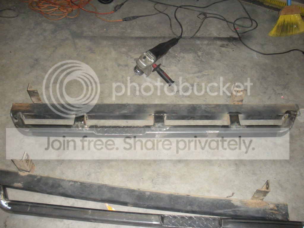

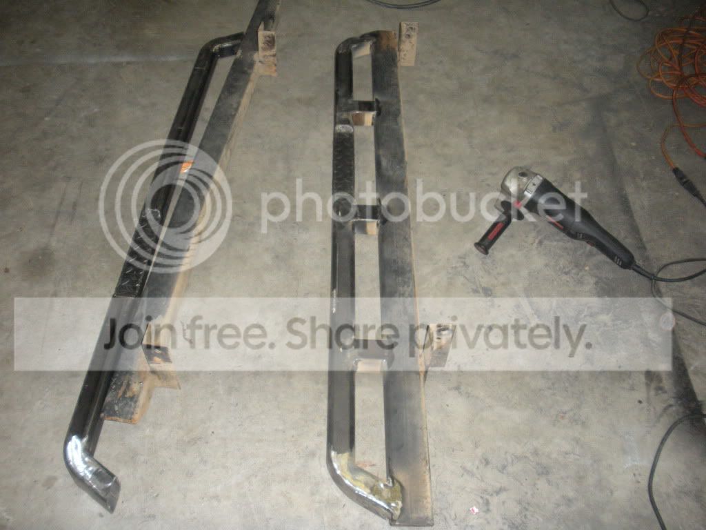

Ok so I pulled the sliders off the truck so I can work on the add ons in the garage.
I am still unsure if I want to bolt these back on, or cut out my rockers and weld them in.

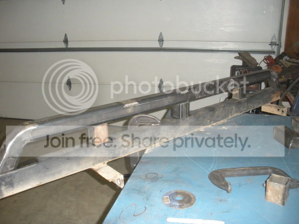

Sliders off
New additions as they will sit.

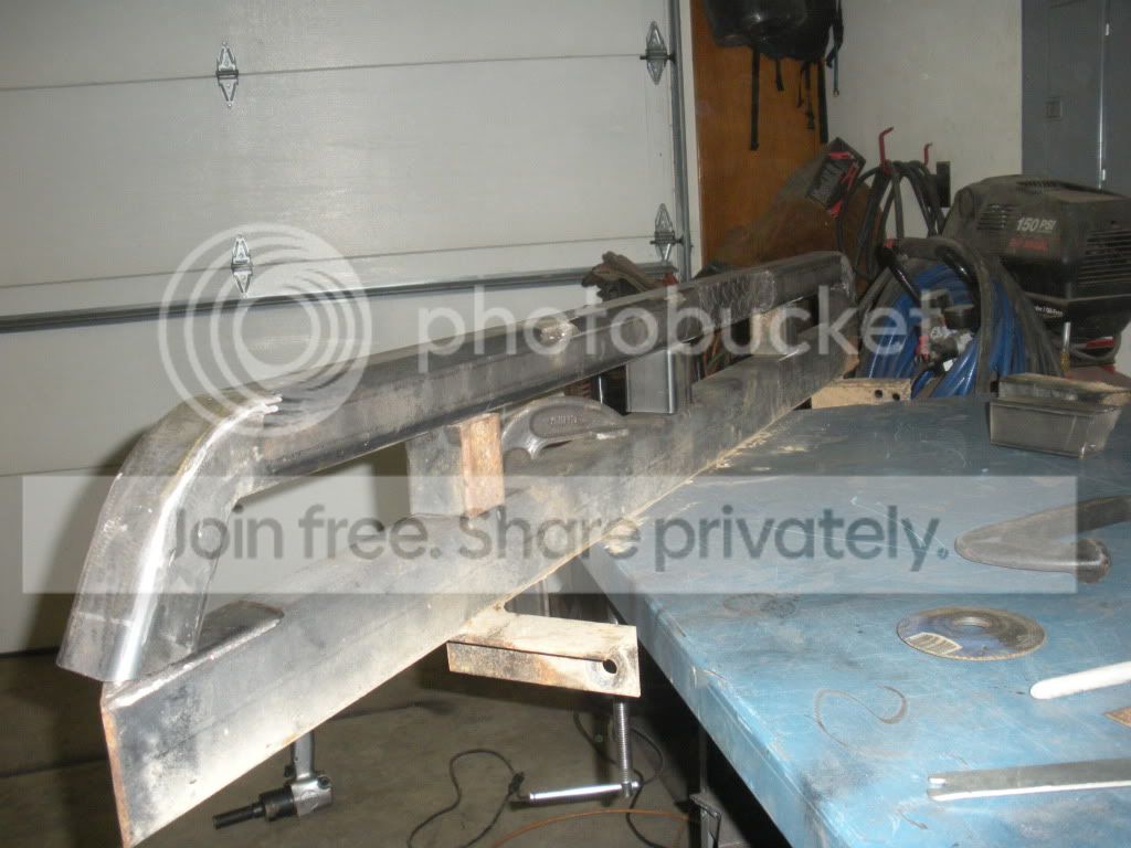

Cut a few pieces to brace it all up. Still need to trim the center one about 1/16.
Just have to clean everything up and one side is ready to weld.
Step bars are all .250 wall. The small brace pieces are .180 wall. Original sliders are .250 wall as well.
I know I am going to have to trim the bottom corners of the step bars and cap the hole still too.

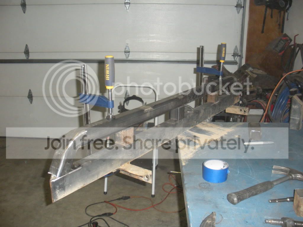

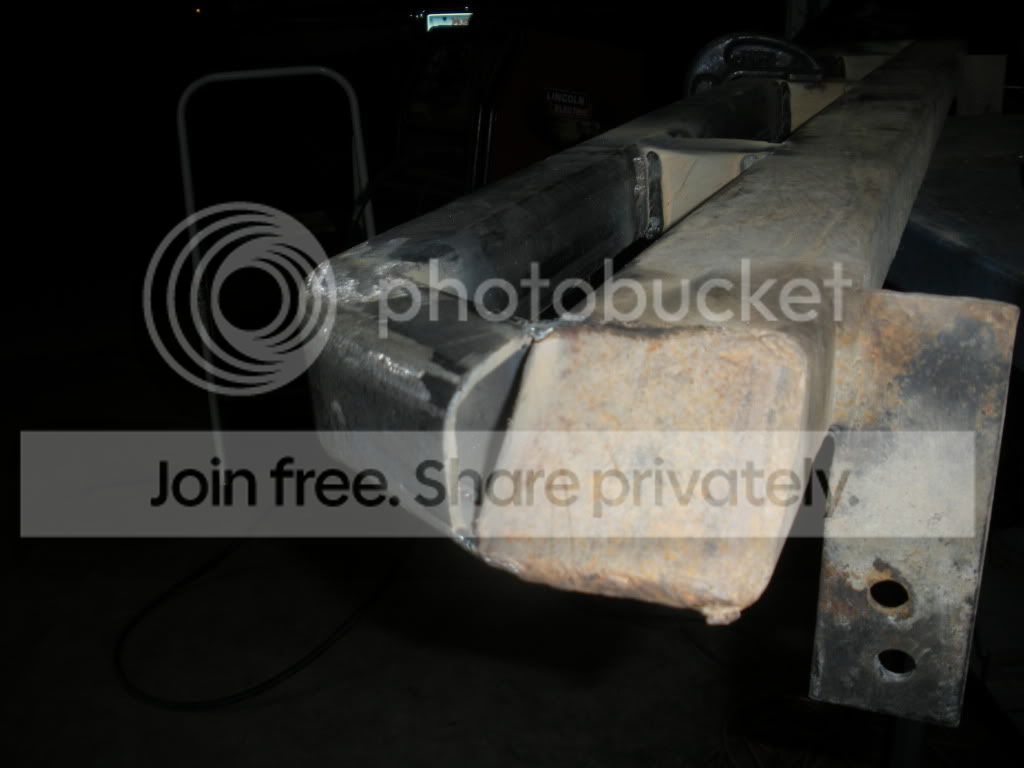

Still almost finished, but here are some pics.
All clamped in place
All welded up.

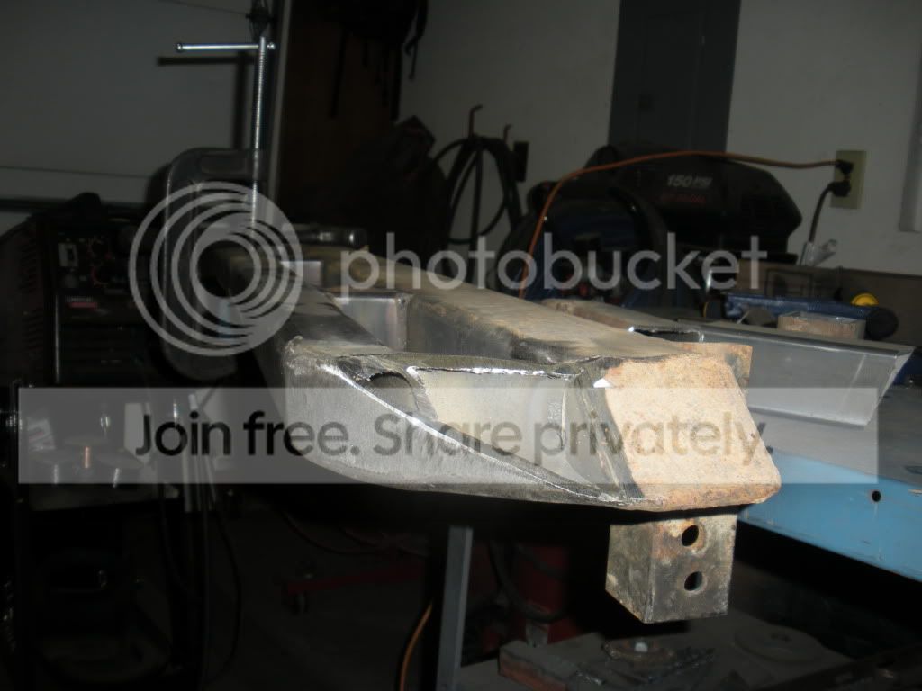

The ends overlap where the angle is so I'll have to cut them down and weld in a plate.
All cut to match the angle on the ends.
Got templates cut for the end caps. Just gotta cut them out and weld it up. Hopefully the second side goes faster LOL
