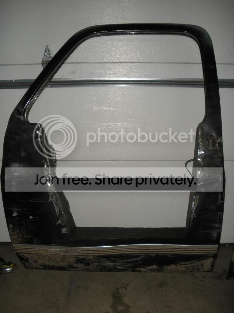

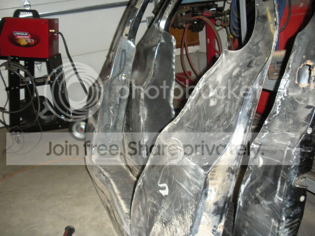

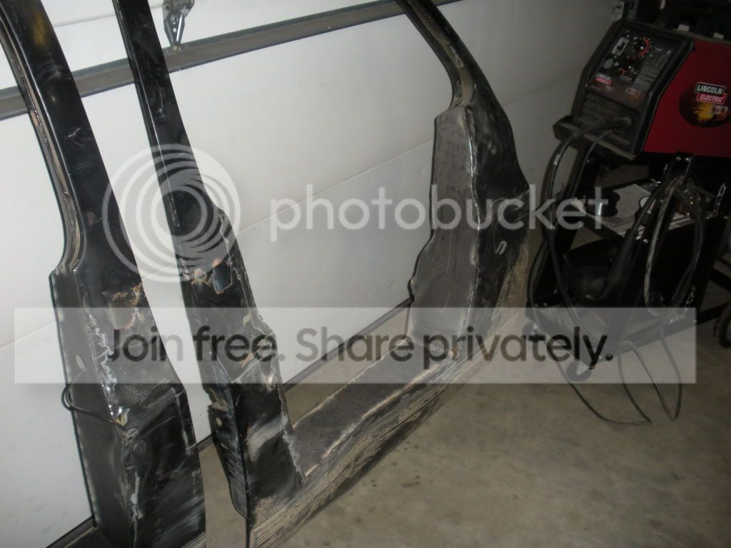

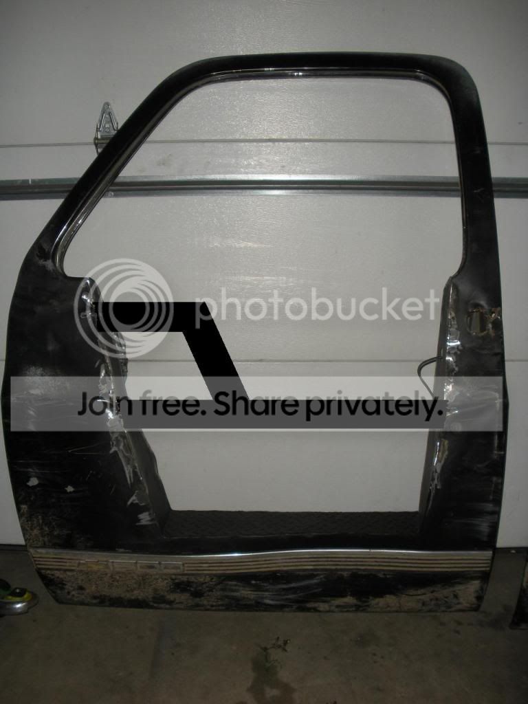

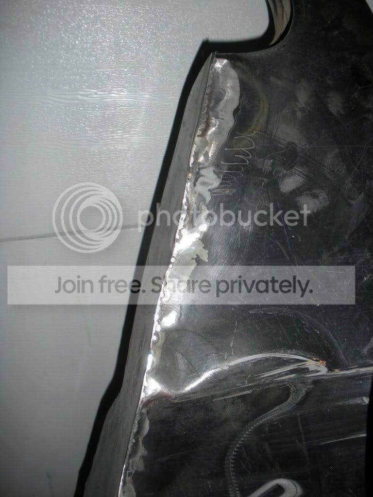

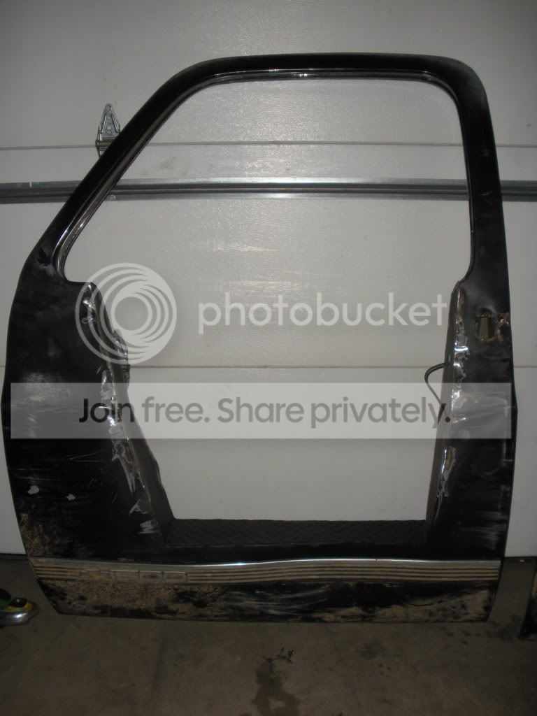

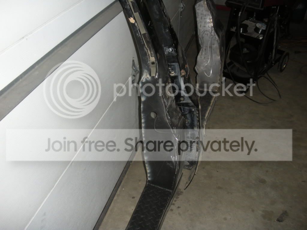

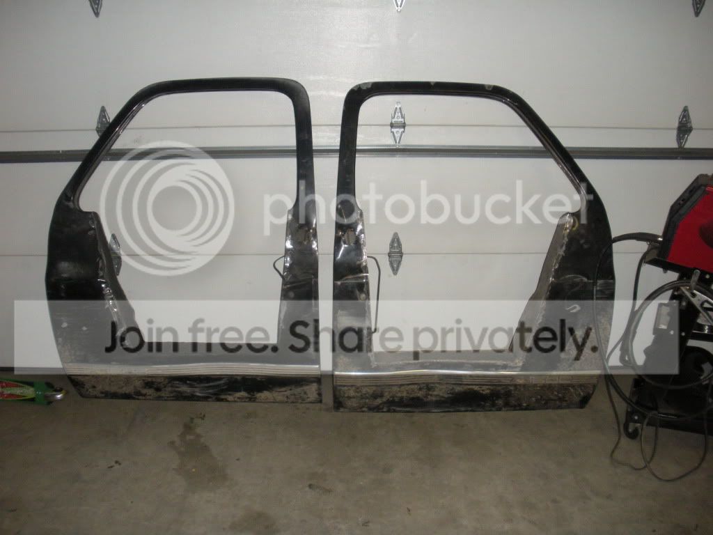

Ok got these doors mostly finished up. Just need to clean up around the welds a little bit and paint.
Not the greatest welds, but I am far from ok at welding sheet metal. I did lots of small tacks all the way around, but they are not stacked. I think they should hold, and if not lesson learned for the next set.

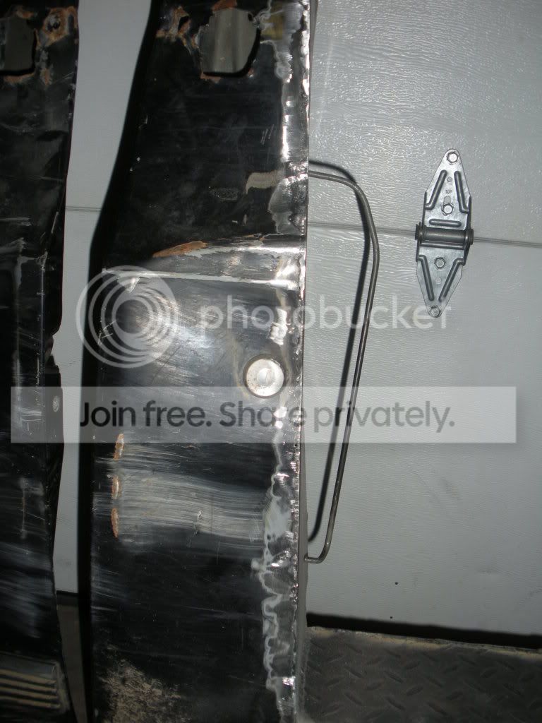

Still trying to figure out what to do for a handle. The rod sticking out of the hole is the rod that originally went to the inner latch. Pull straight out and it unlatches, but I don't just want that rod rattling around.
I am also considering a 2x2 crossbar in there since i cut them so low.
Crossbar ideas? :?:
How about a net like for a window? Gets the job done and no fab work needed plus you just unsnap it and you're out of there.:wink1:
you need something to put your arm on for sure, i like the first single bar.
also for the rod rattling aroun, can you squeeze in shock bushings or pcv valve rubbers?
I may just wheel it with these once, and see if I want a bar in there at all.

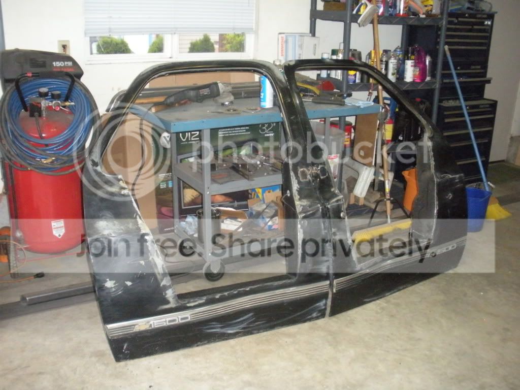

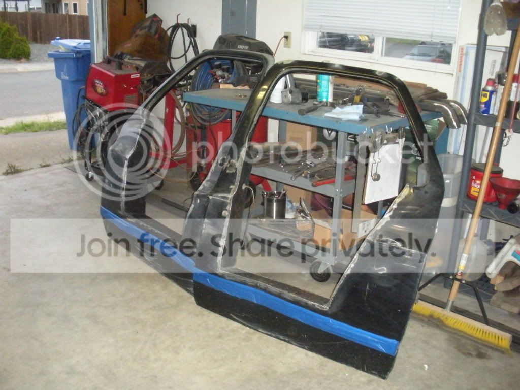

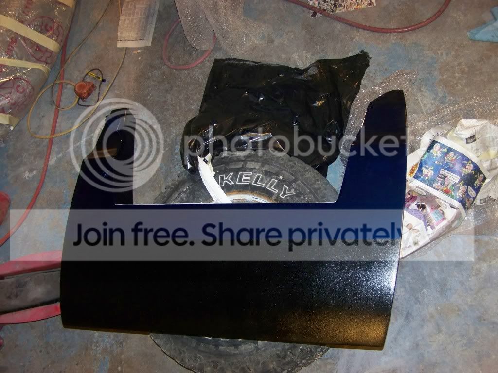

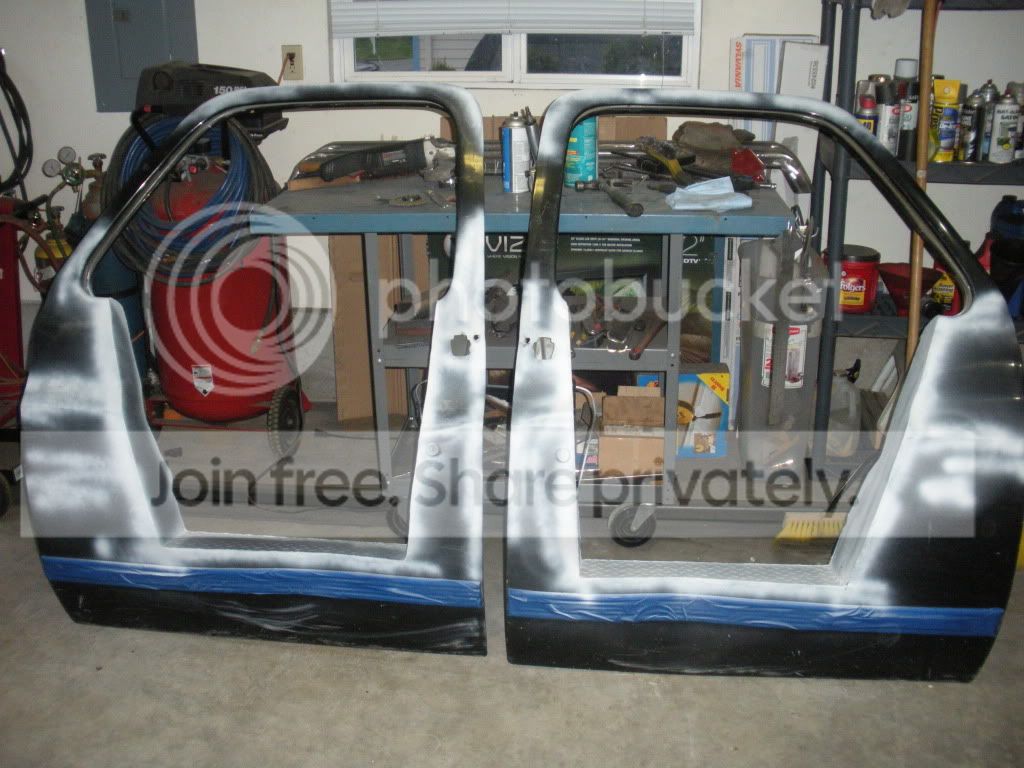

Almost done!
All prepped for the $5 paint job. I think the painters tape cost the most, but I dont wanna get paint on my trim strips. I kept them on there to prevent door dings 8-)

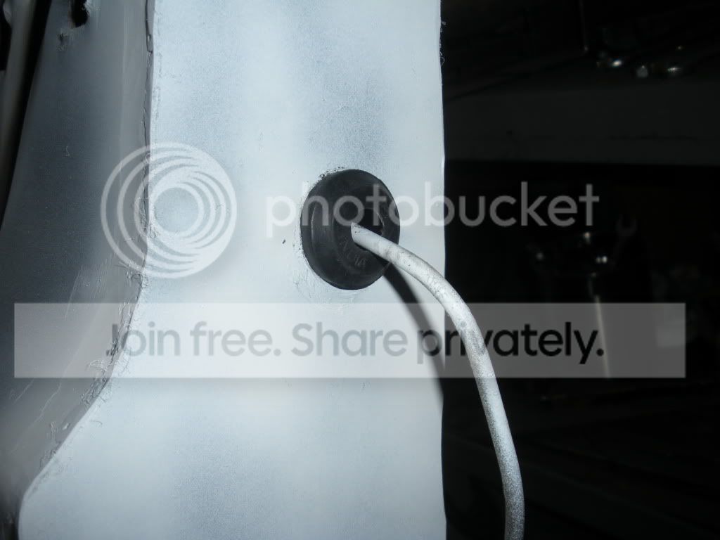

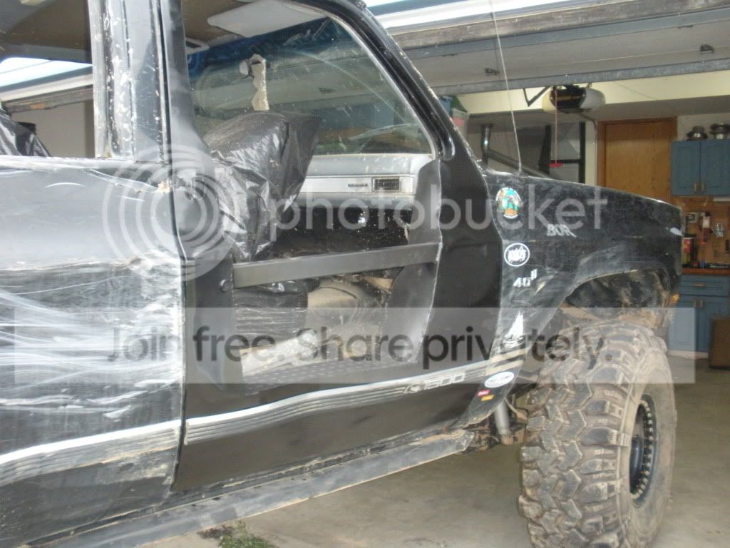

I found some shock bushings at Vatozone and dremeled a groove in them to make them a grommet. It will keep the door latch rod from rattling at least. I think I messed up the latch on the driver door messing with that rod. I may just climb in and out and have a latch for the passenger if/when I have one :lol:
Primed all the bare metal

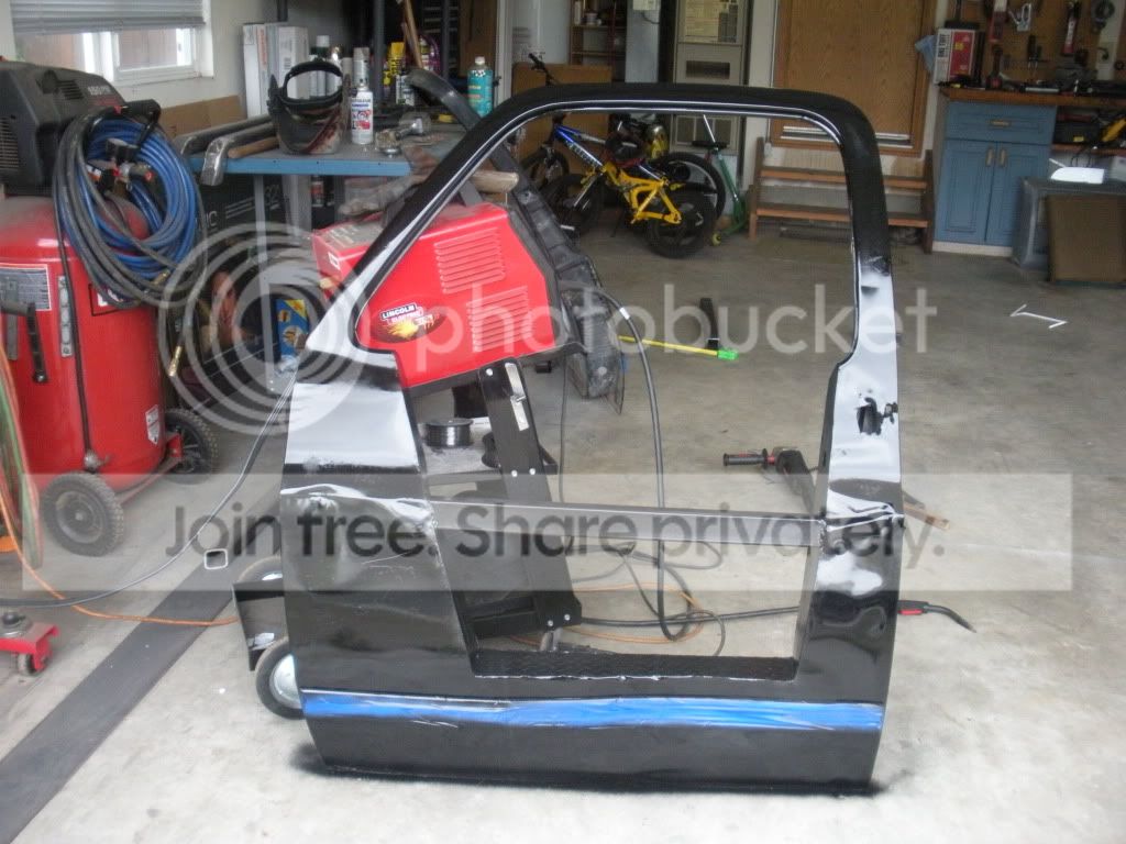

This is the cross bar I am going to go with for now. Due to the custom shape of my doors its hard to get anything to fit square in the doors. I didn't do any meauring when i cut so everything is at different angles. Had to fill a couple gaps when I welded these in. I wanted to add a bar like in my drawing, but do to the fact these bars are almost flush the body line the upper bar would have to have multiple plane bends to match up, and that seems not worth the trouble right now.

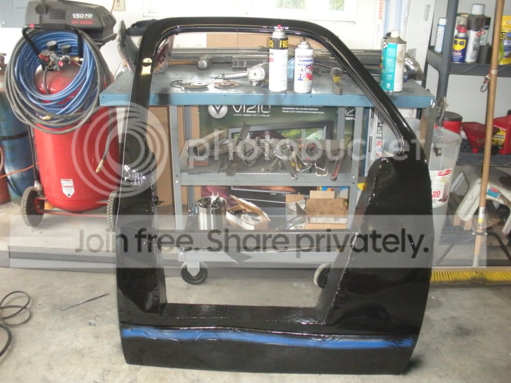

All painted.

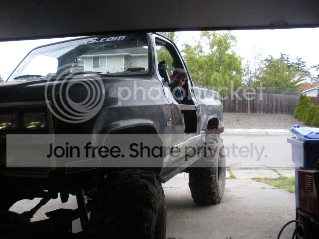

Finished painting them and got the doors hung. They are much easier to work with now that they only weigh 25 lbs :wink1:
I got the latch working on both doors now. I just welded a T handle on each rod for now. If I end up building another set I may incorporate a handle. We'll see how long this set lasts :haha:

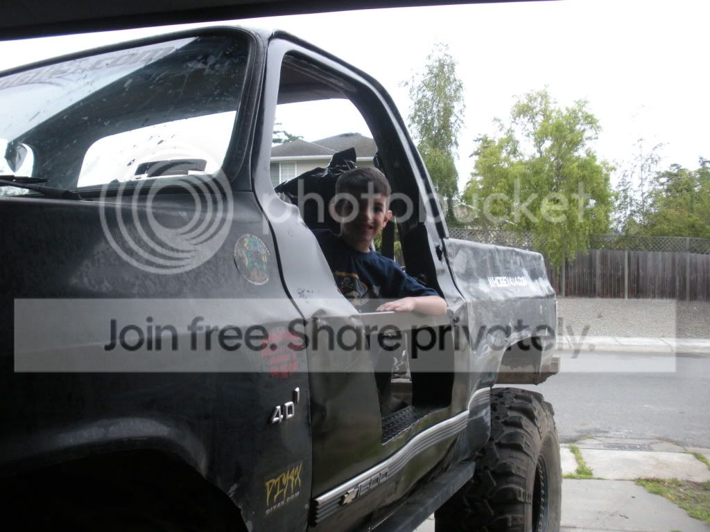

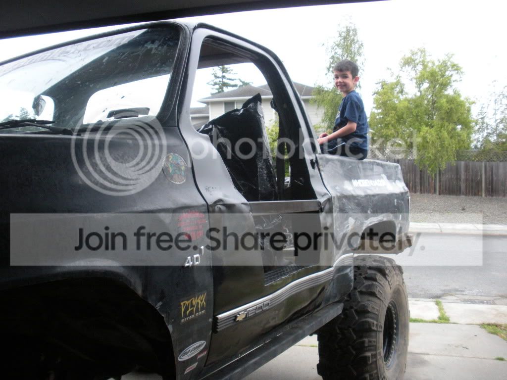

Mt little helper on fathers day. My next project is to re-glue my rear view mirror back on the windshield since it just "fell off" while he was cleaning it :rolleyes: :haha:
I am happy with how they turned out. The bar is at a good level to lean on when I lean out, but not so high I cant climb in over it easily.
