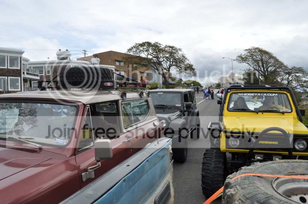

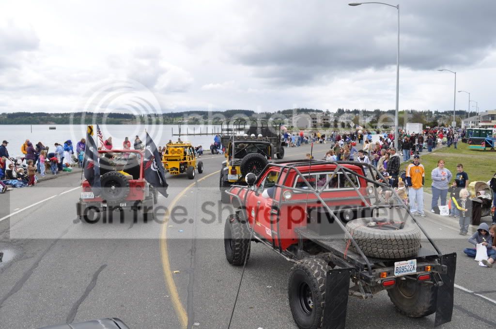

Pictures from the parade a few weekends ago

Haha I know. The red Toyota is actually on his second cab and he added the exo. He made the mistake of wheeling with no doors, and caught the B pillars on a couple trees :rolleyes: For the most part though the Jeep, Sami, Yota guys don't take much up here. The trails are built around them, but I still fit :wink1:
coolest truck in the parade....2.1/2

Are those FJ Cruiser mirrors on a Scout?
Haha I have no idea I'll ask.

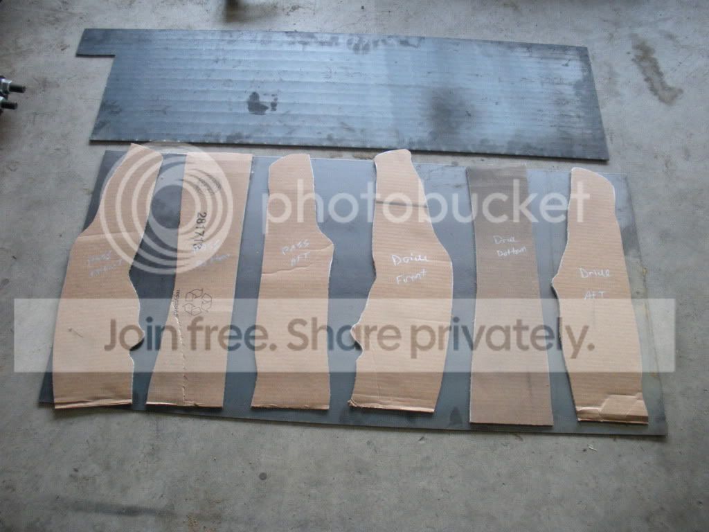

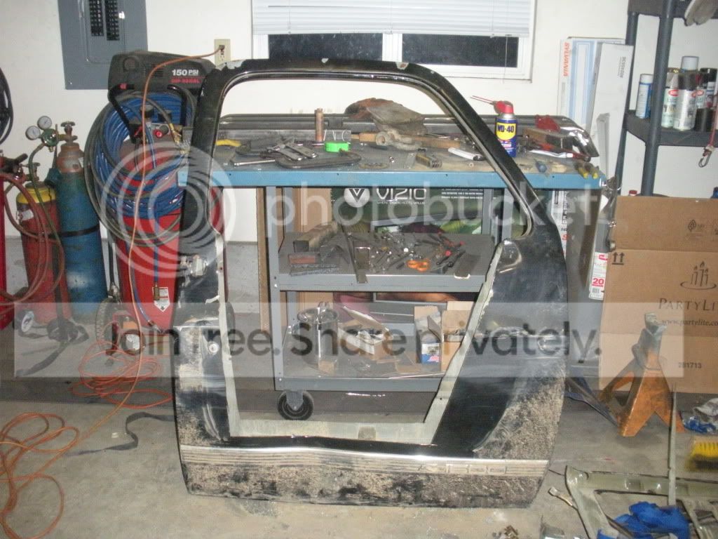

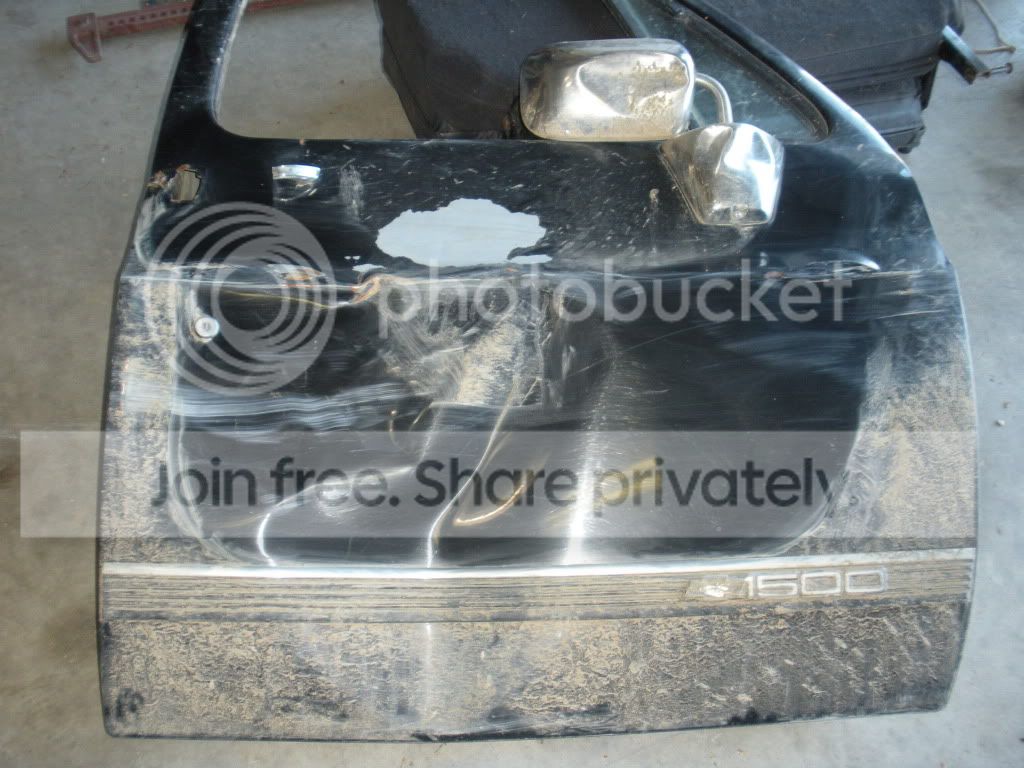

Made a little more progress on the doors.

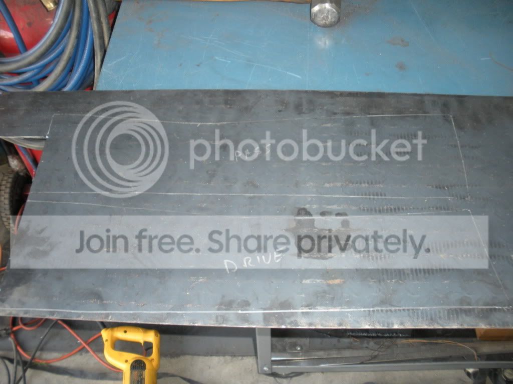

Cut some templates out of cardboard.

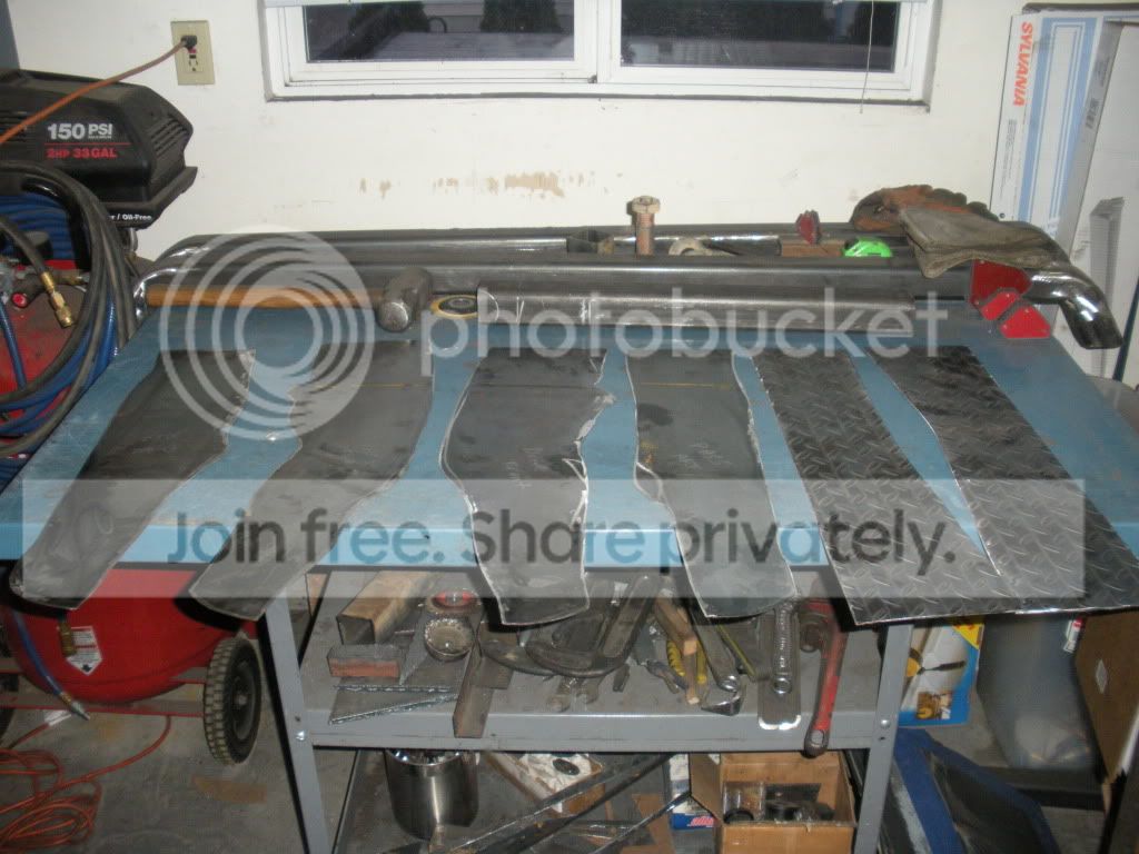

Traced them
Cut them out

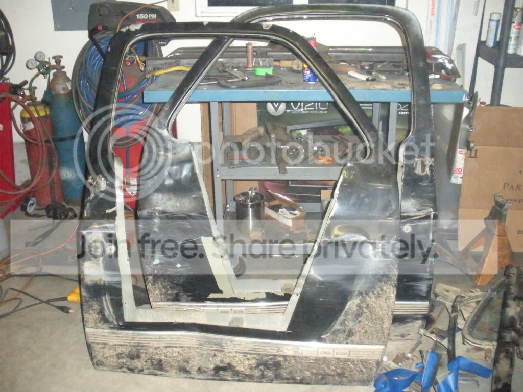

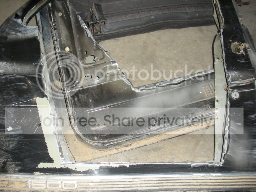

Prepped the edges of the doors

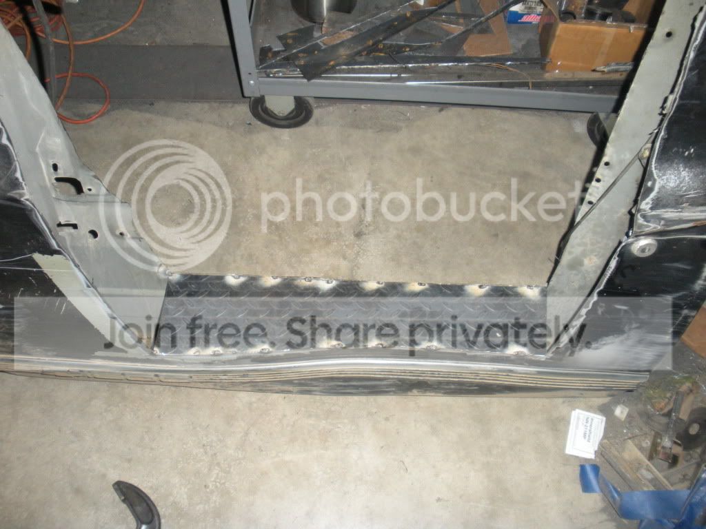

Got one bottom plate in. Thats all I could squeeze in after work today.
You didn't pop the dent out before adding the bottom plate???
On Donnie's doors we braced everything inside the door before welding sheet metal to cover it up... Still destroyed the doors in a couple of runs... Up here with the tight trails it's hard to keep working doors on a fullsized rig... That's why I built mine the way I did...
Keep us updated on the progress and how well they hold up to our tight trails... Good luck...
BTW, you should get down to Elbe sometime this summer... We're building all kinds of new things on the trails...
I was going to try to fix the dent, but these are just prototype A models. I figure if its already dented there is less chance rubbing LOL. I have a couple more sets of doors to refine the design.
Yeah I know how hard it is to keep doors straight. Trying to finish these by the weekend so I have something to keep my B pillars intact.

P.S. welding sheet metal sucks!!
I could call it the Bruise! :haha: Or just Black and Blue would work too.
Do you have a spoon??? It's not real great for welding in tight corners like you're doing, but helps a lot if you can get it behind the weld...
EDIT: You could also use a piece of angle copper and hold it with a pair of V-grips...
