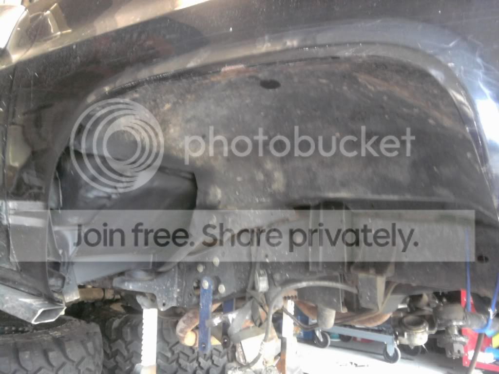

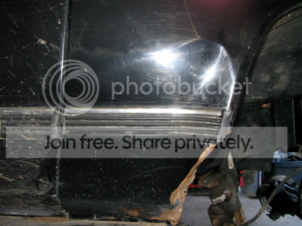

Backspacing is 3.25 or 3.5 I don't remember. Nope they don't hit the springs at least that I have noticed. They hit the inner fender real bad. I just finished trimming one side. Will upload pics later tonight.:laugh:
Excuse the ****ty pictures..apparently my camera is dying.

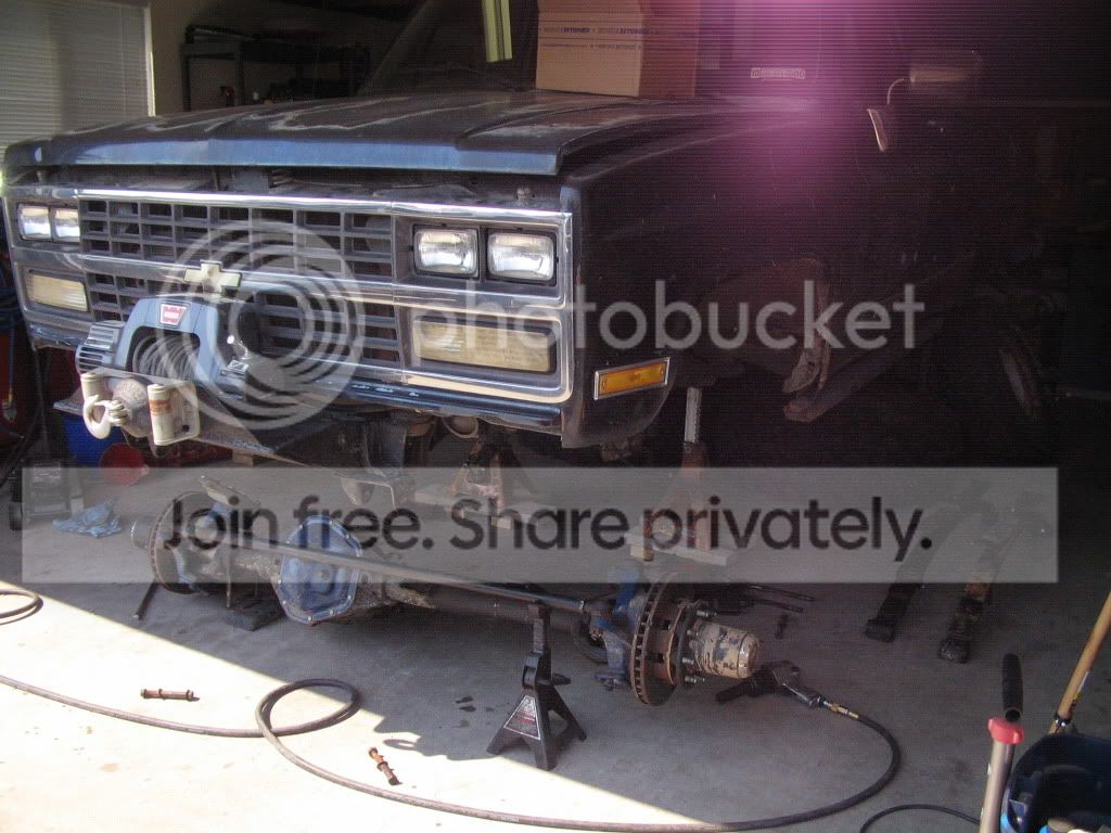

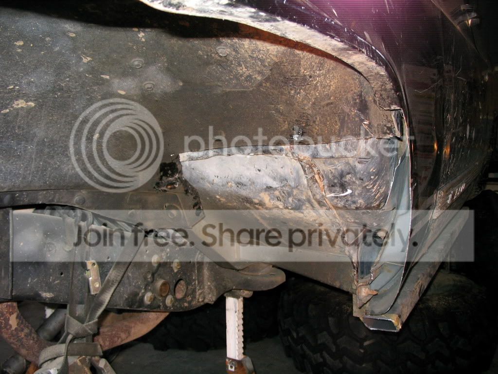

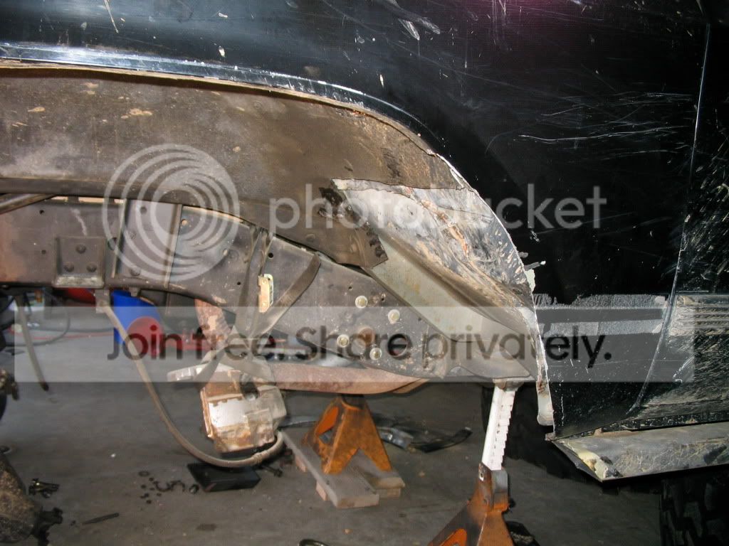

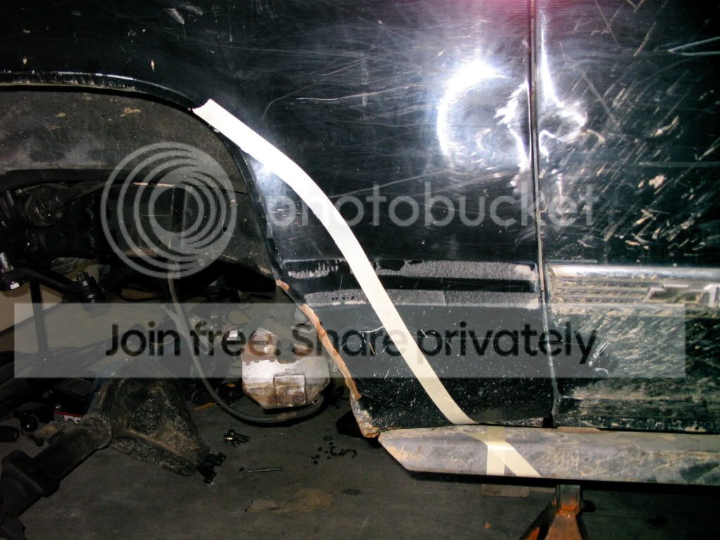

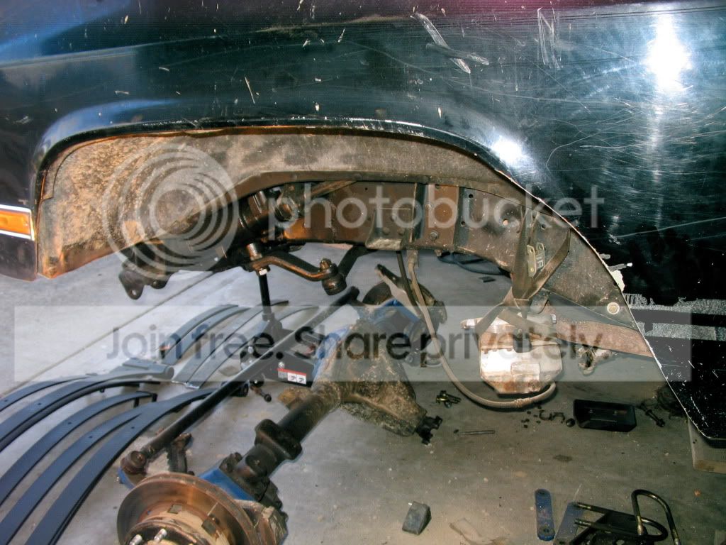

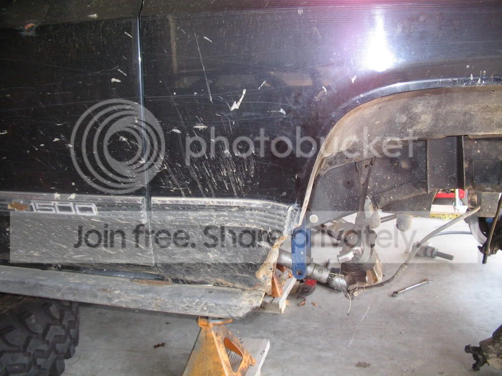

Got the back portion of the pass side fender done today..still have to figure out how to cut under the rad support. I cut as far back as i could before I hit the firewall. Had to trim my slider to match. Got a new Sawzall for Fathers day so I got a chance to try it. It went through everything easily! Had to massage the firewall a little so it looked right :wink1:

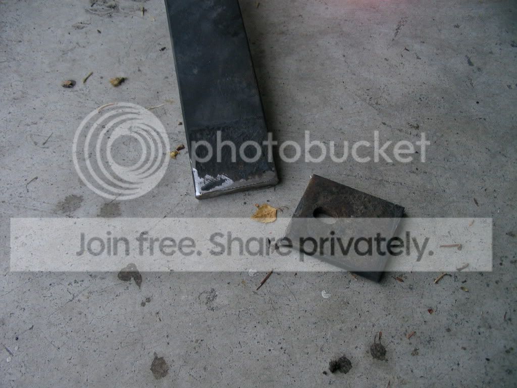

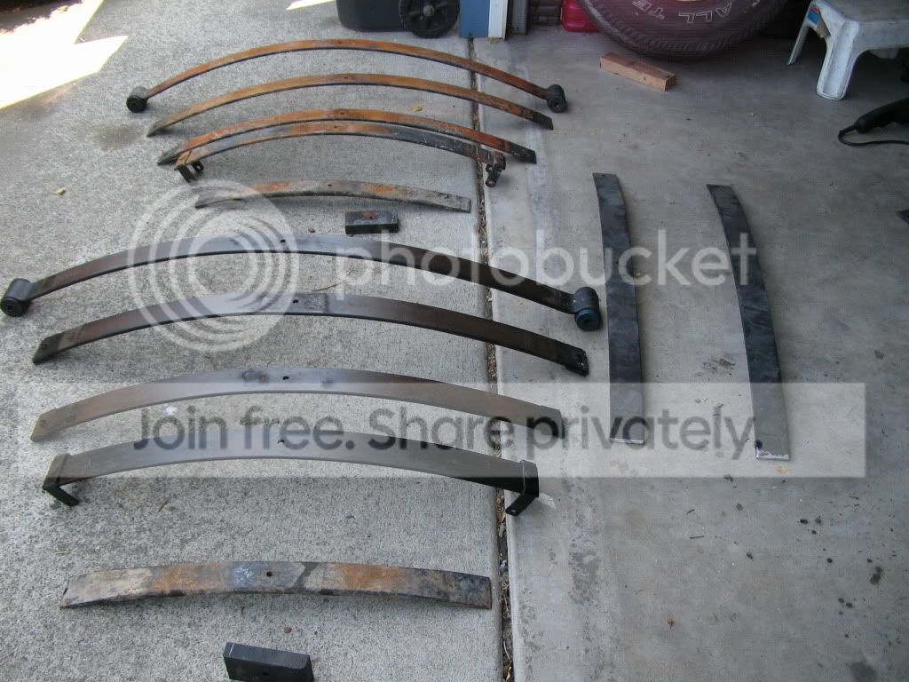

Rebuilding my 52's up front. Took a leaf from my 56 pack. Trimmed it to make it equal length from the center.
Ready to flap disk and paint..Can you guess which pack was under my leaky PS box :rolleyes:
All cleaned and painted.

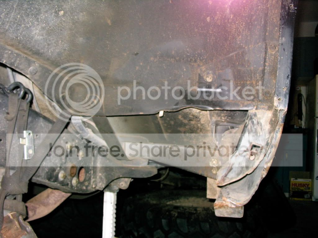

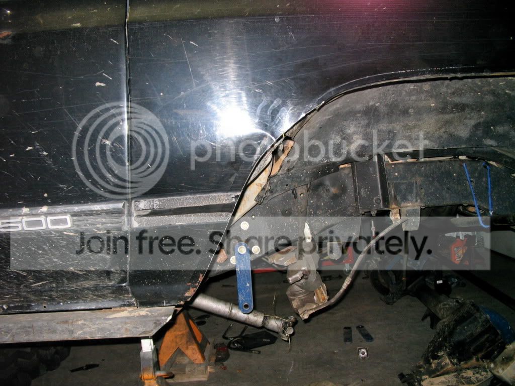

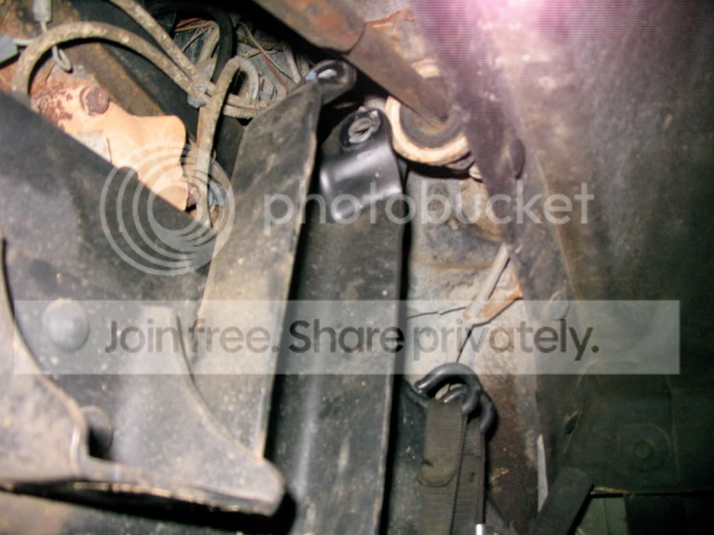

Got any picks from inside the wheel well looking back at the fire wall?
Yeah I'll upload them in a few here.
Here you go. Doesn't look real pretty, but at least my tires won't get chewed up anymore.
Did you have to modify your drivers side shock tower to mount them where you have them due to the steering shaft? Pics would be great...
No I didn't modify the tower at all. They had some trimmed from the bottom when I bought them. I had to remove the factory brake line bracket, and then used one of those holes and drilled another. It is fine with the shock mounted the way I have them. If you used a large body mono tube and mounted them the other way there may be some interference.
I took a quick measurement for you. The tower is 9.5" from the bottom of the frame rail to the mounting holes.

The rear cuts look almost identical to mine. Nice work.:wink1:
Thank you! I pretty much cut as far back as I could without having to do any major hammering on the firewall.

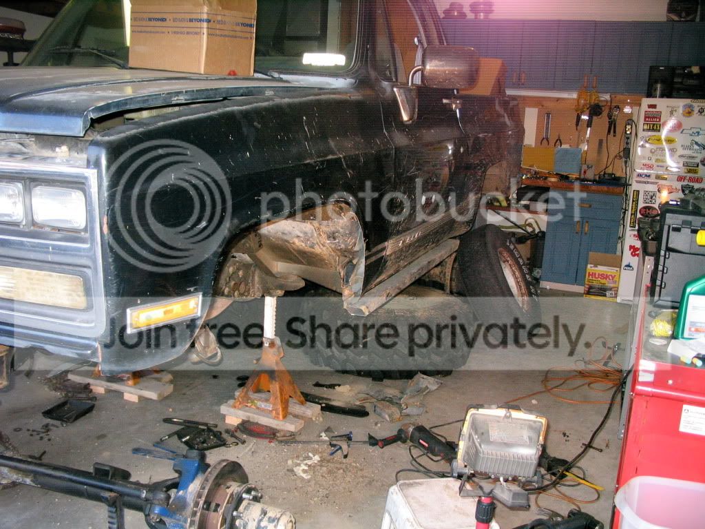

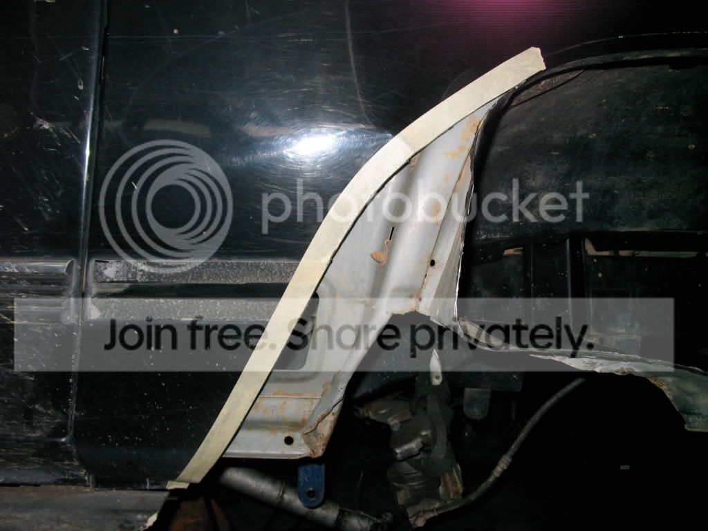

Finally got some time to get back out to the garage tonight.

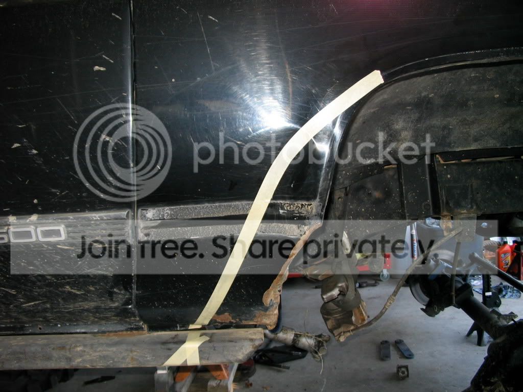

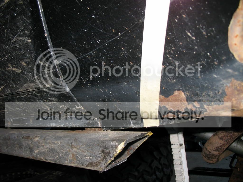

Made a cardboard template and got the Driver side fender taped up.

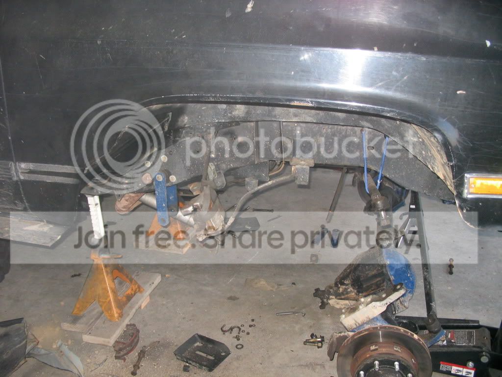

Inner before cutting more.
All done my tires should be safe now :D
Inner afterwards

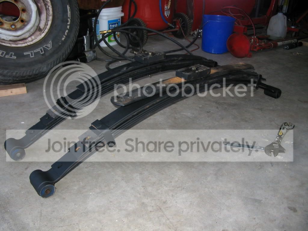

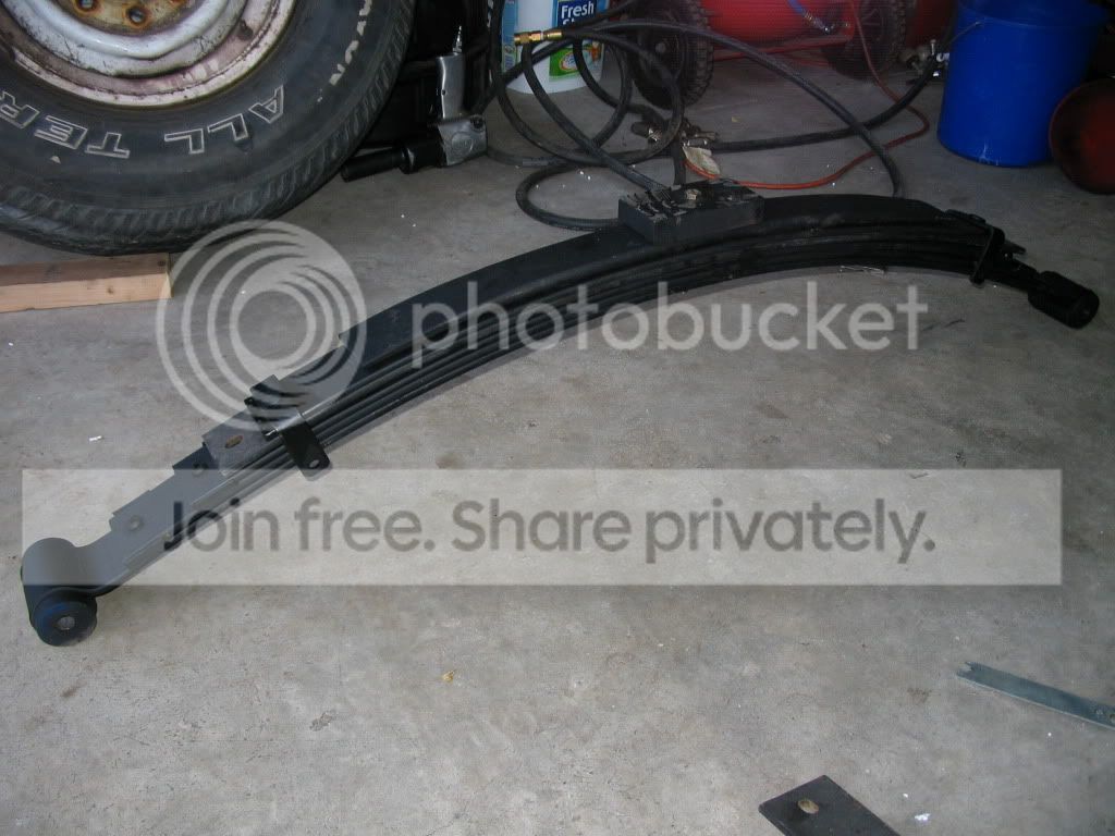

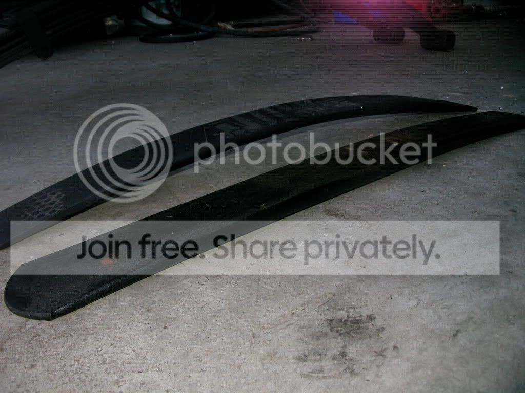

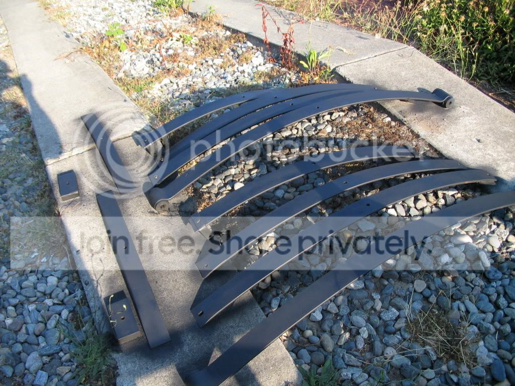

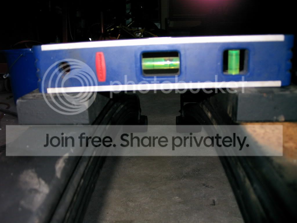

Ok the second reason I am reworking a few things was the front of my rig sits lower by about an inch. I added a leaf to my 52's up front and I am considering an overload with more arch to support the pack, and actually make it a little stiffer up front.
I put two packs together, and figured I would post them up. I stood on each and bounced. The one with the curved overload is a bit stiffer, but the flat overload is a tad thicker so that pack is a little taller..
Does anybody run a 52 pack with the arched bottom overload?
Pack with the curved overload spring.
Other pack with the flat overload.
These are the two different overload springs. I have been running the flat one upside down with 4 leaves. Now I am going to run 5 leaves and one of these overloads. It was very soft before, and I had some axle wrap up front. Hoping to make it a little stiffer, eliminate some of the wrap, and gain a small amount of lift ~1"
Here is the height difference. Flat overload is on the right.
Looks good, I ended up doing something similar my fenders,I need to bend the inner fender a bit still
I may have to what you did to the front leaves also, or link it
I don't think many people run overloads in the front. I'd run the curved one just because it is less likely to hang up on things.
