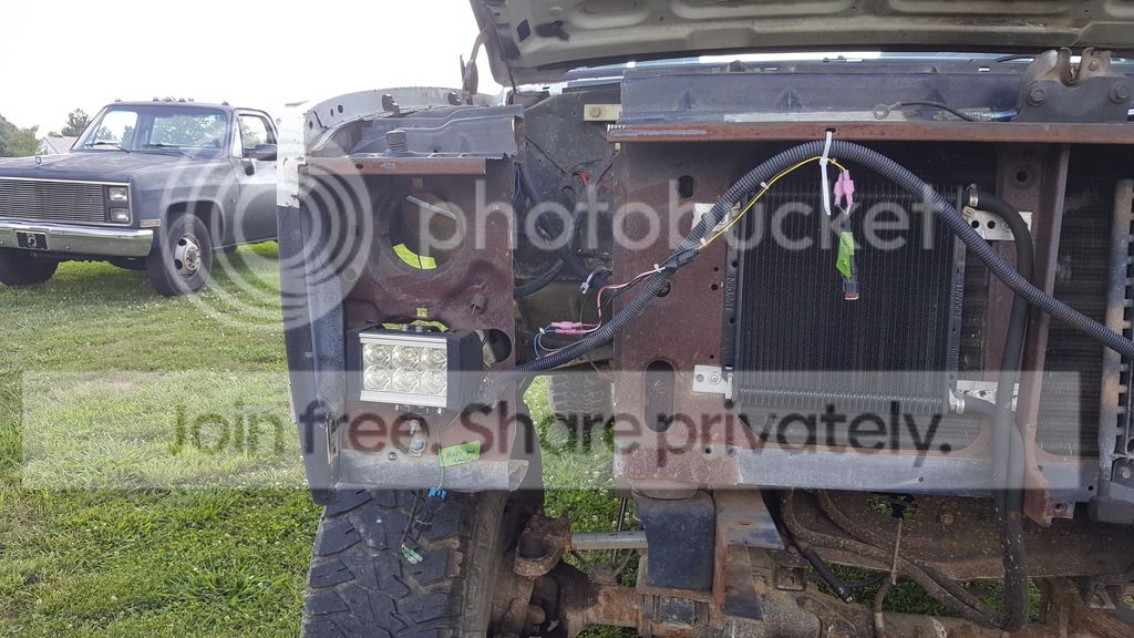

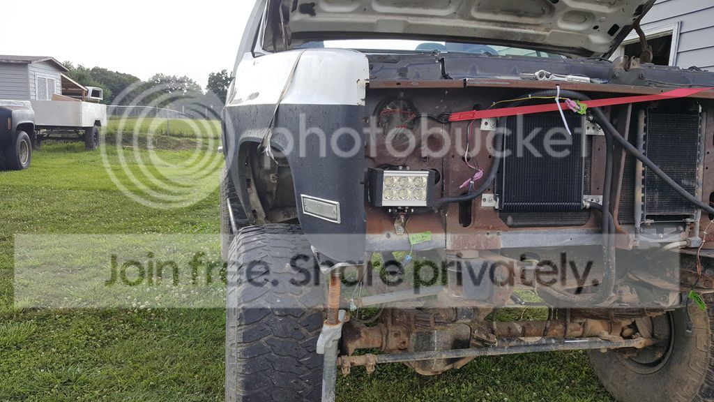

So, its been a few months since an update. Been busy with training and increased responsibilities at work. A few months ago I decided I wanted to narrow the front end of the K5 and so it begun...

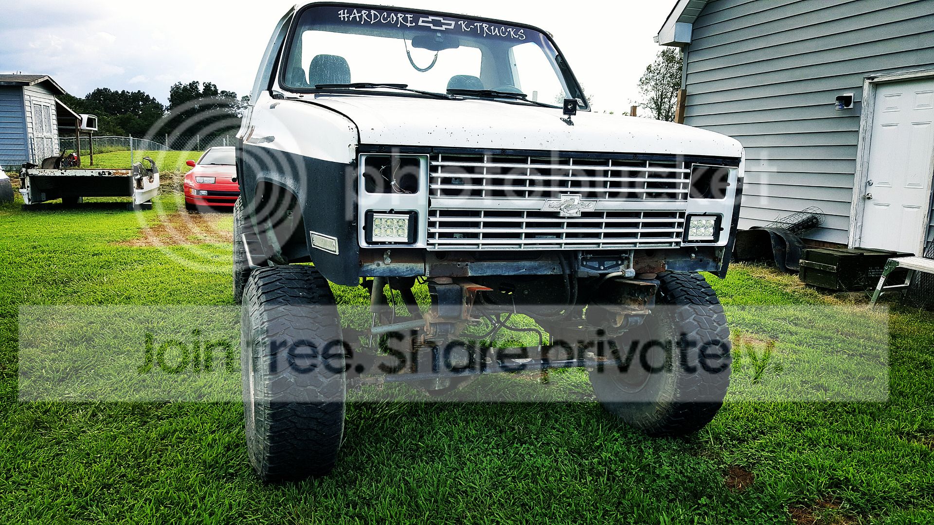

It ended up with this:
Still a work in progress, slow going with my schedule as of late but getting there. This all started because I had picked up an 82 dually 2wd but then someone made me an offer on the dually that couldn't pass up. I was offered nearly double what I paid for it. Then the hunt was immediately on and I found and picked up an 84 K20 350/465 which I am driving daily now. Will probably start a build thread for that here shortly.

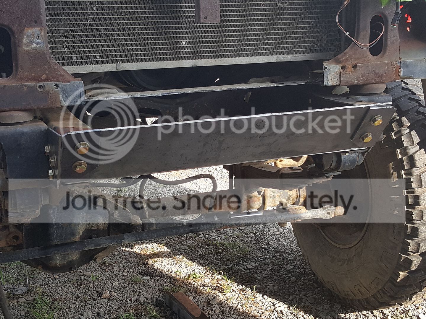

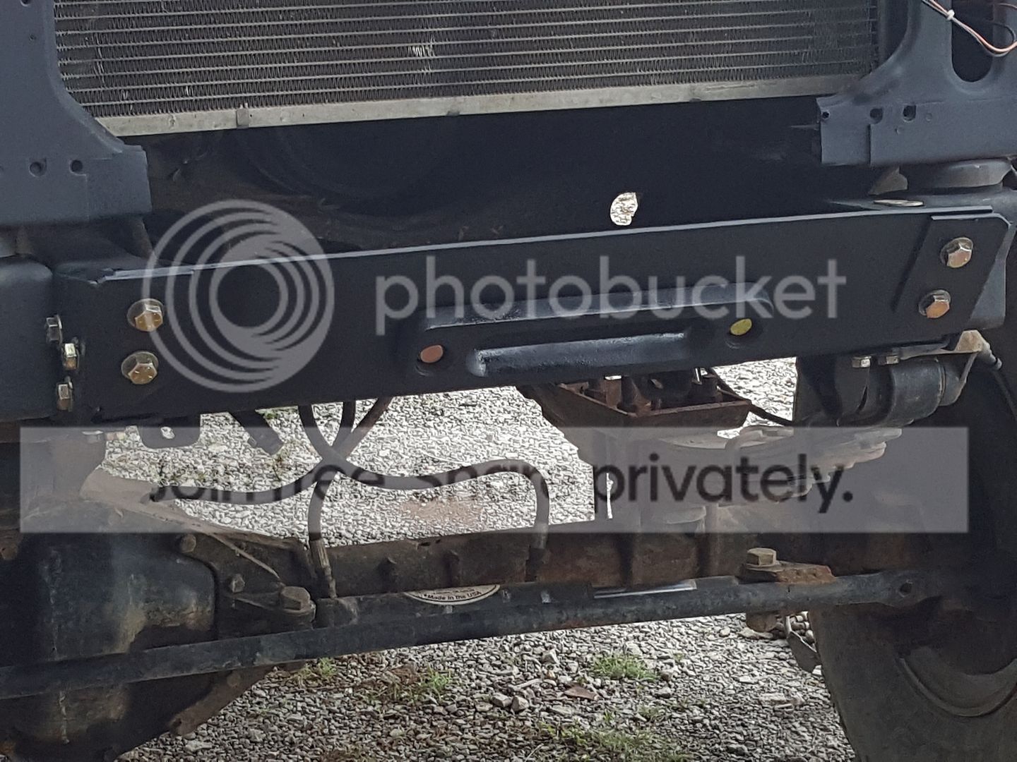

Now Im on a couple weeks of leave and so I started working on a winch mount since I narrowed the front and sold off my old tube bumper. I took a page from Pblaze but with my twist. Obviously not done but should have things dialed in the next few days.

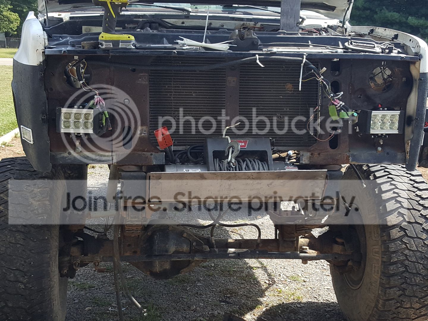

So, I got to this point where I welded up the rest of the relief cuts, slapped some primer and paint on it and installed it back on the rig with the fairlead.

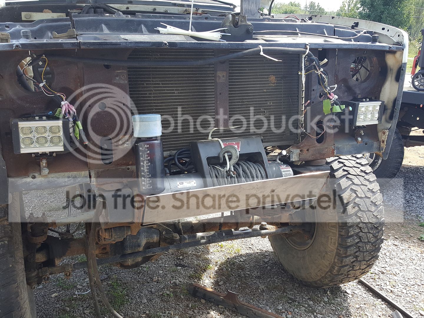

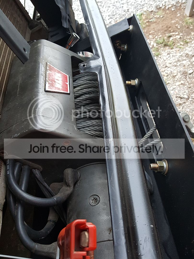

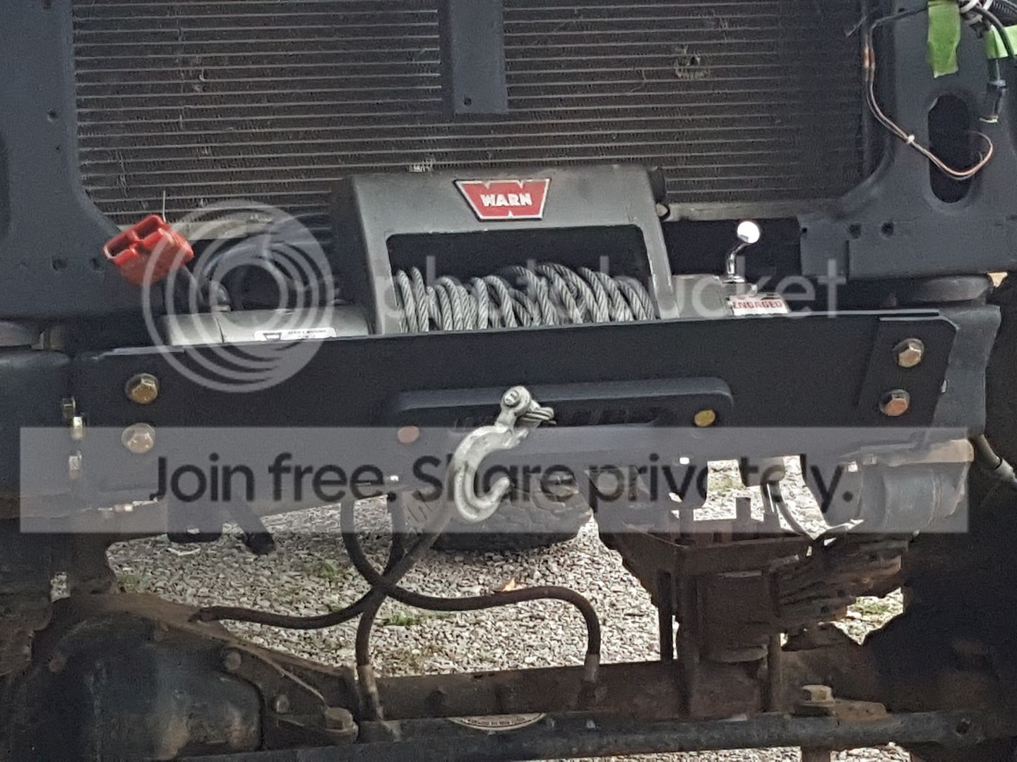

I was going to leave it like that till tomorrow but got anxious to see the winch in there so after dinner, I tossed in the winch.

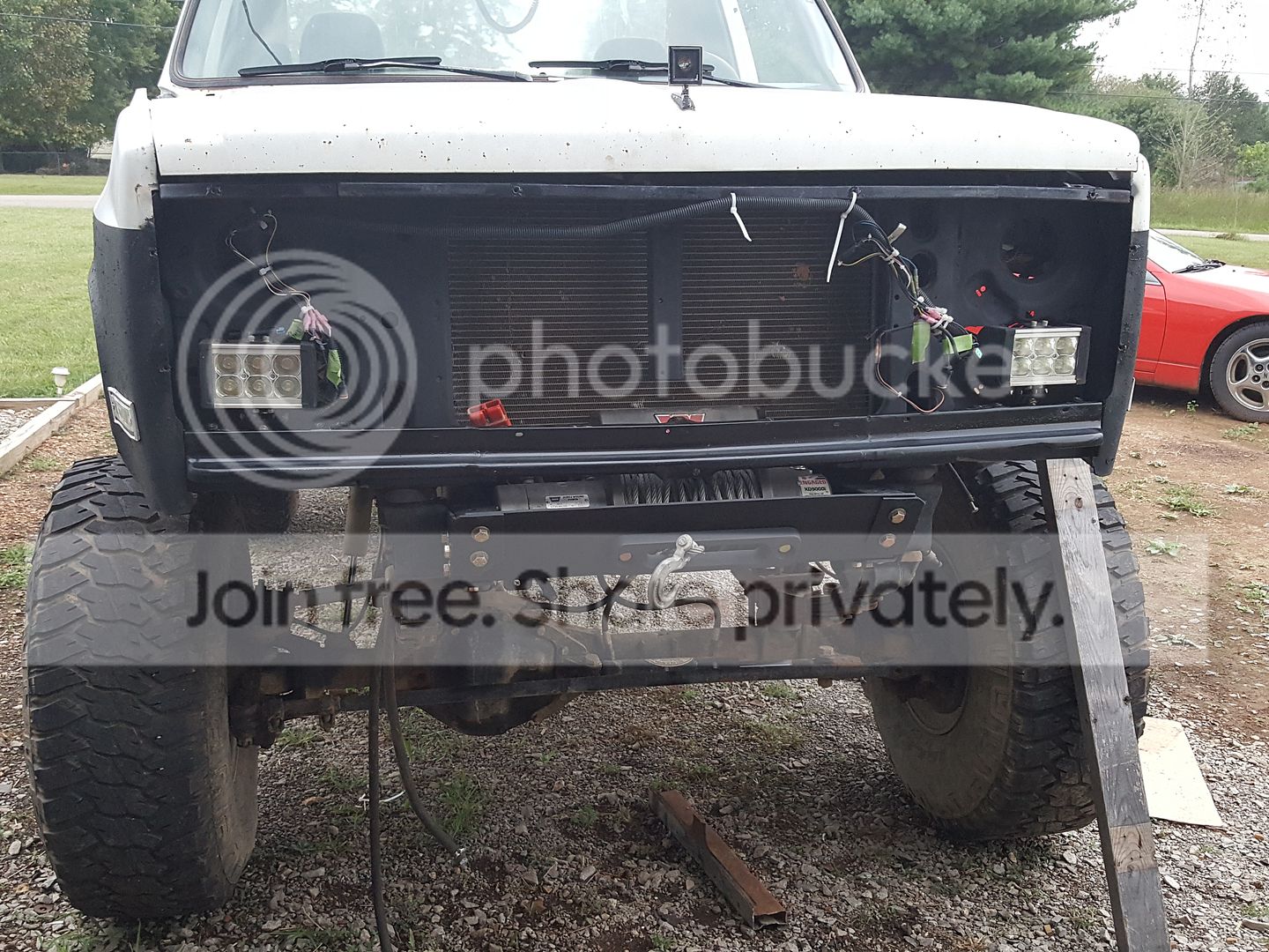

Then I stepped back and pondered if the winch would clear the lower valance......

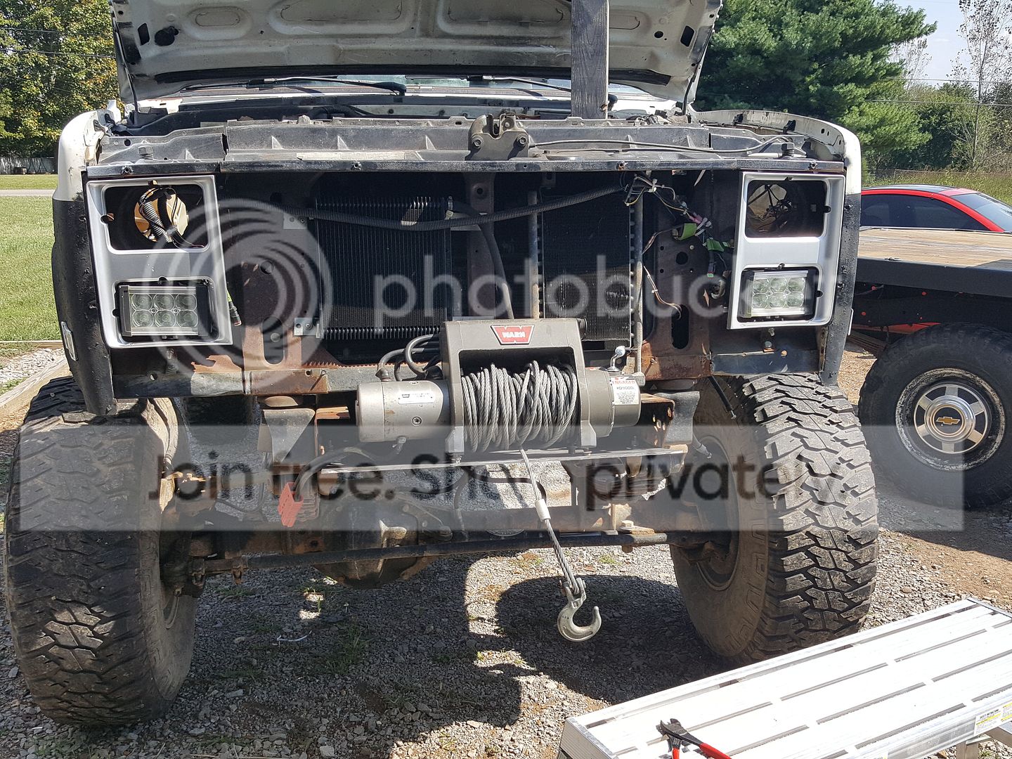

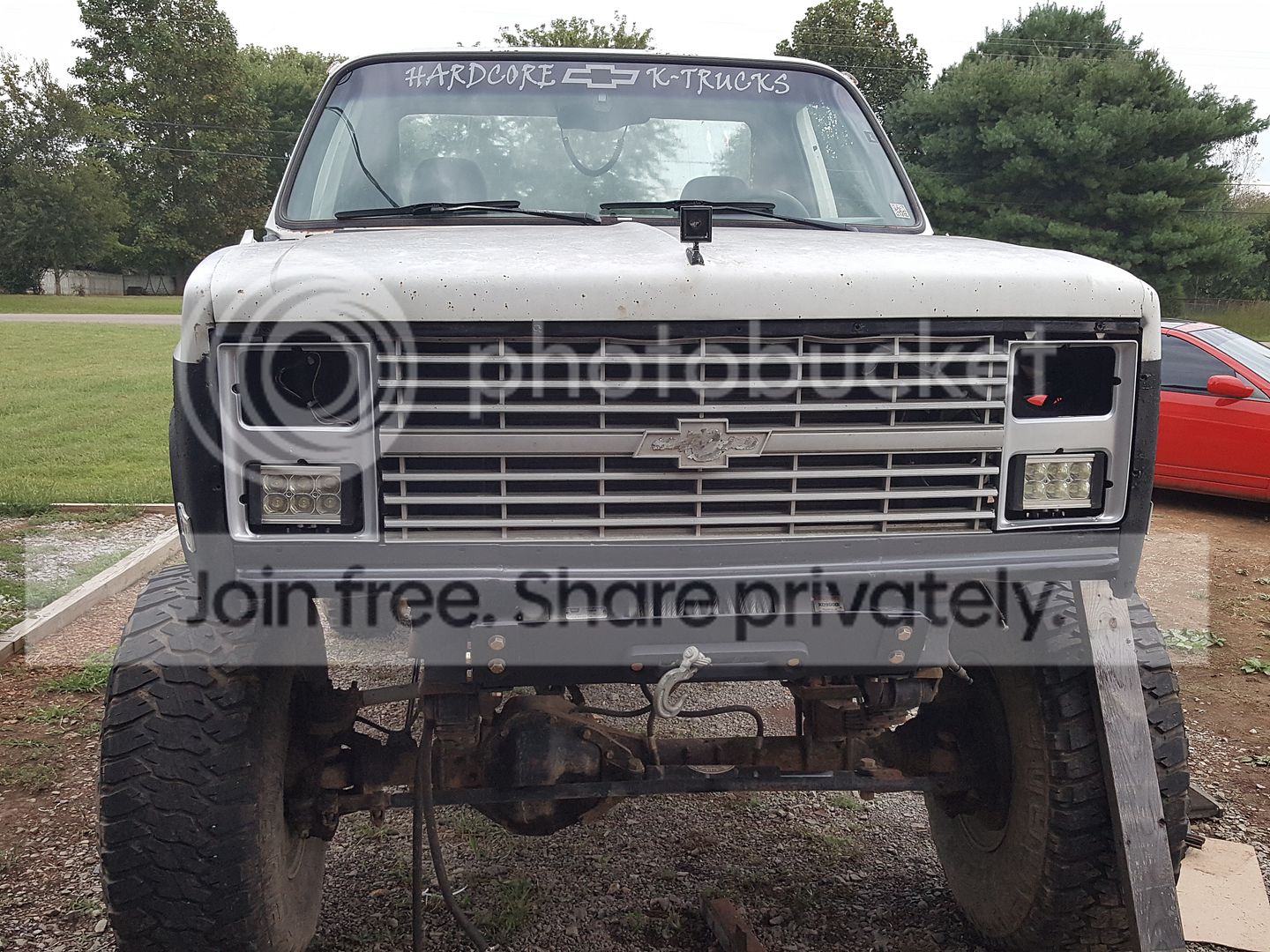

Happy to see that it cleared with no cutting, I said "F@*k it" and laid in the grille and buckets....
