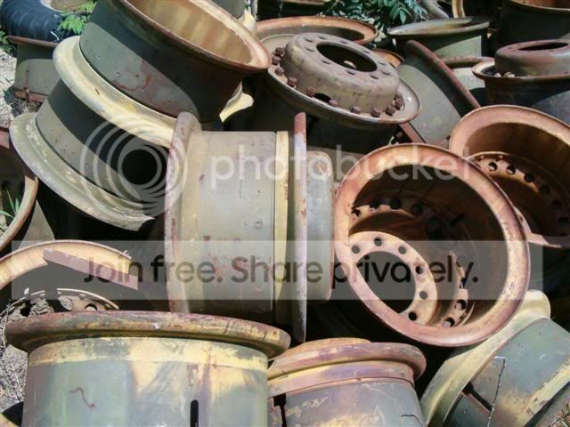

Creep3286, The 39" XZL's run on a 16" rim. The 46's and 52's run on the 20" rims. My tires came with the rims on them. They are a VERY heavy split rim with a lock ring and a solid rubber run flat inside. Here is a photo that I found online showing the type of rim they came with.

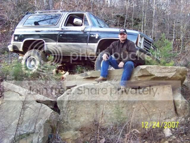

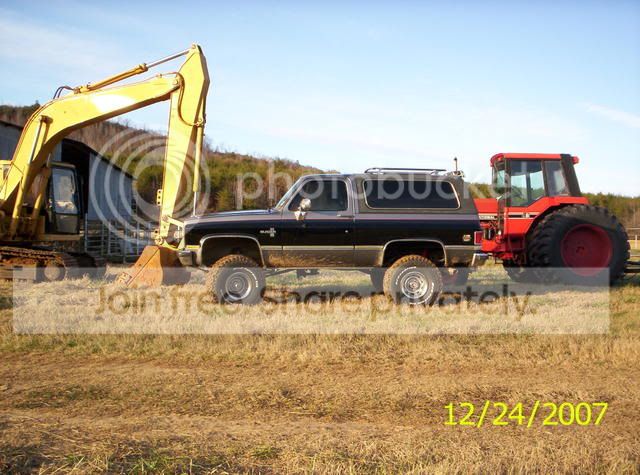

81K5GUY, Here are a couple of pics.. all I could find right now. I had a guy across town make the bumper for me. I like the way it turned out.

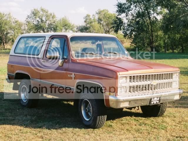

Izzy's 81 K5
Truck When I first bought it. Picked it up for $800.00. Solid Vehicle, everything worked, tranny slipped a bit :D

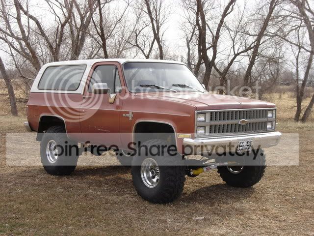

After 6" Super lift and 36" IROCK Tires on 15x10x15.5 Rims :cool:
Its currently in shop getting makeover.. Will Post more pics later...

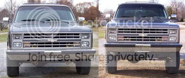

Left is stock sittin on 31/10.50/15 winston wieners,.... Right is 4" rough country spring front/4inch block and add a leaf rear w/custom made angle shims. sittin on 35/12.50/15 BFG muddies, still on factory rallies. self made swaybar dropsand CV rear shaft and 4.56 gears to be added SOON.
