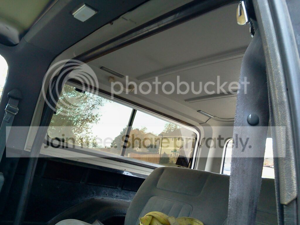

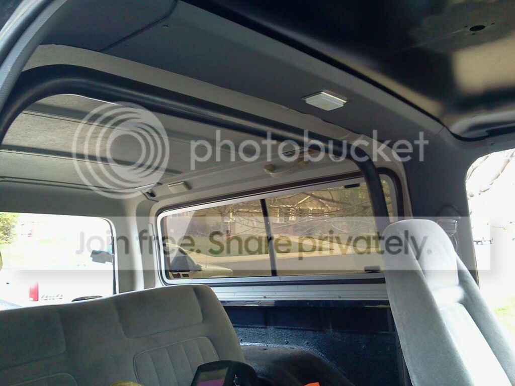

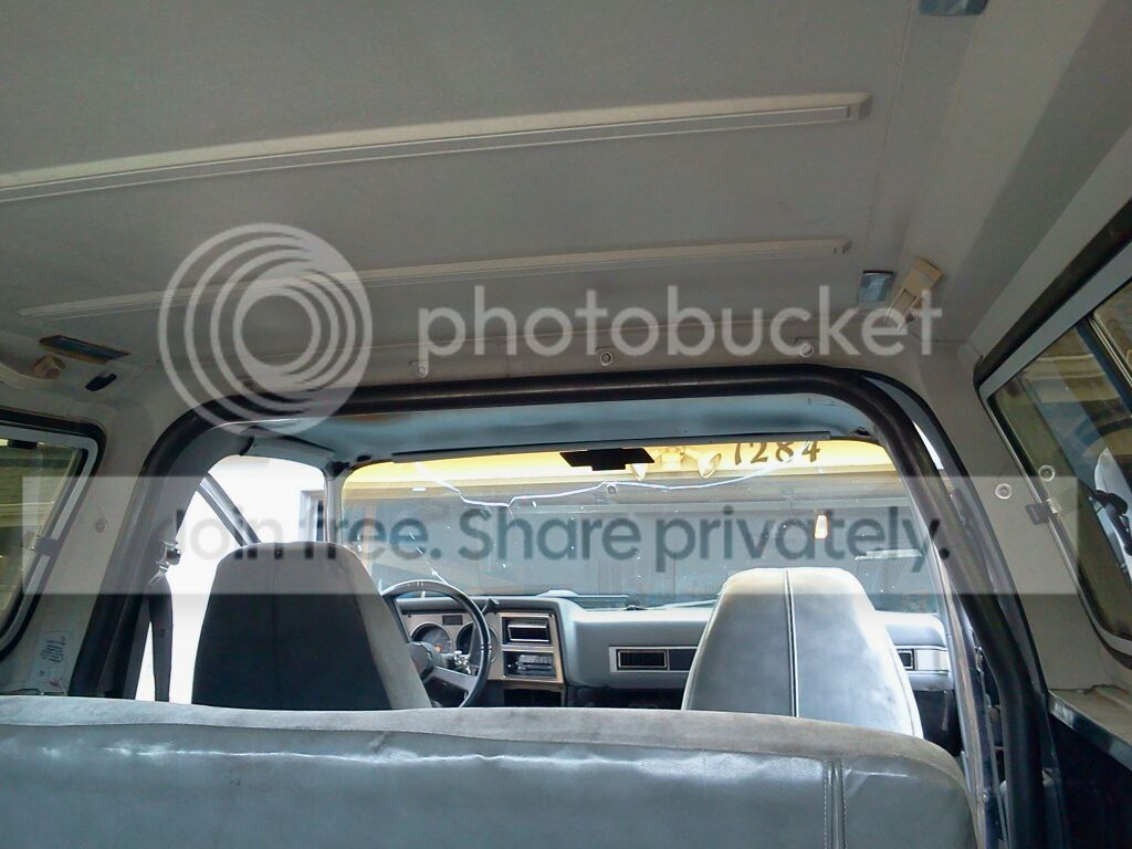

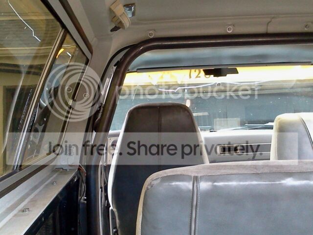

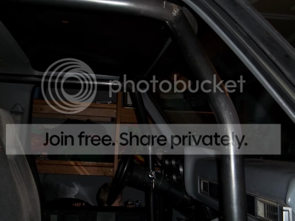

Started some work on my cage. Nothing too crazy yet, but wanted to document all of it as progress happens. So here are some pics

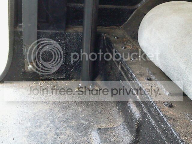

Cage plates from DIY4x

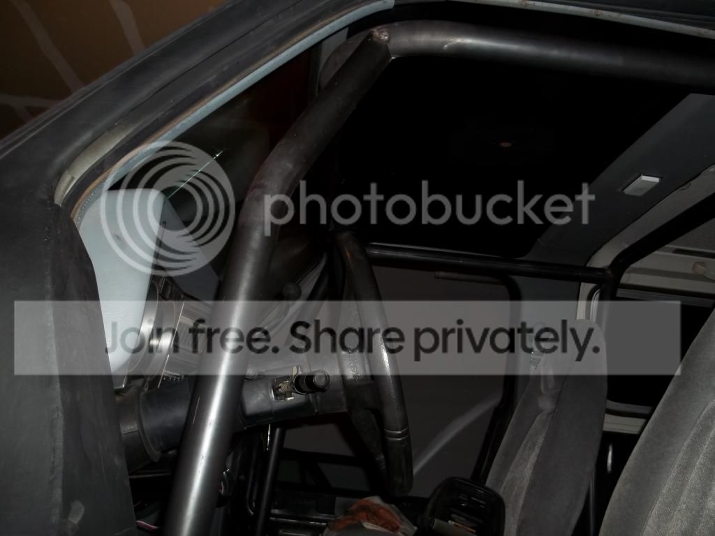

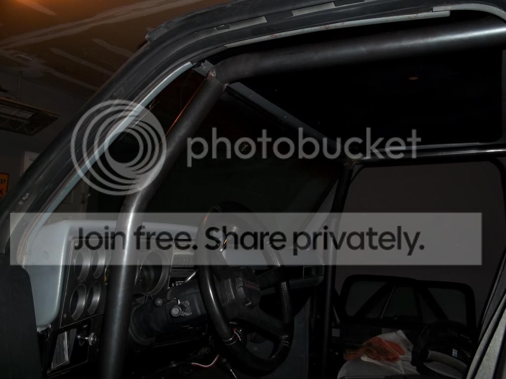

Start of the halo up front

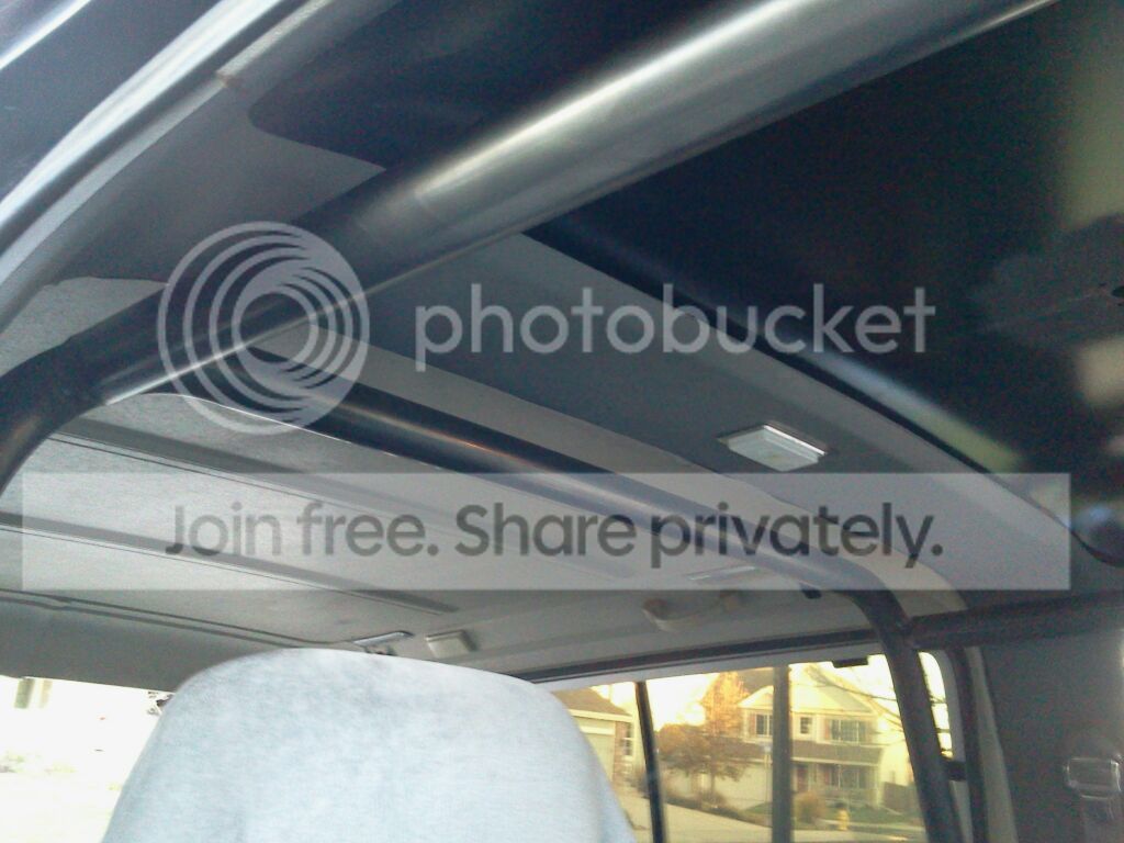

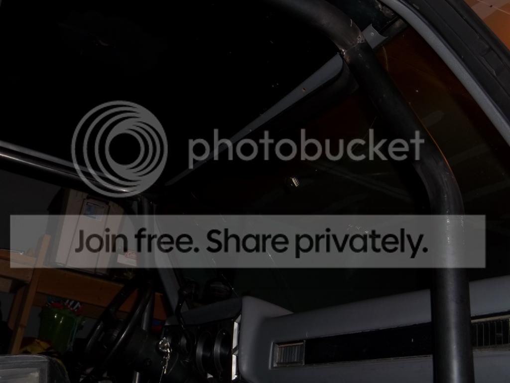

Will now work on the down bars up front and start on a bunch of bracing. I would like to finish the front half first, then start on the back half. And for those who may ask, I am doing this with the top on to make sure that I can always put my top back on if I ever want to. I think it has turned out pretty good so far, not perfect, but a good start.
That's it for now. Will hopefully get some more done in the next couple days/weeks.

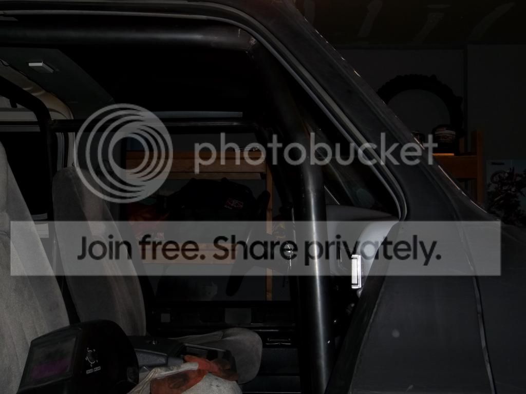

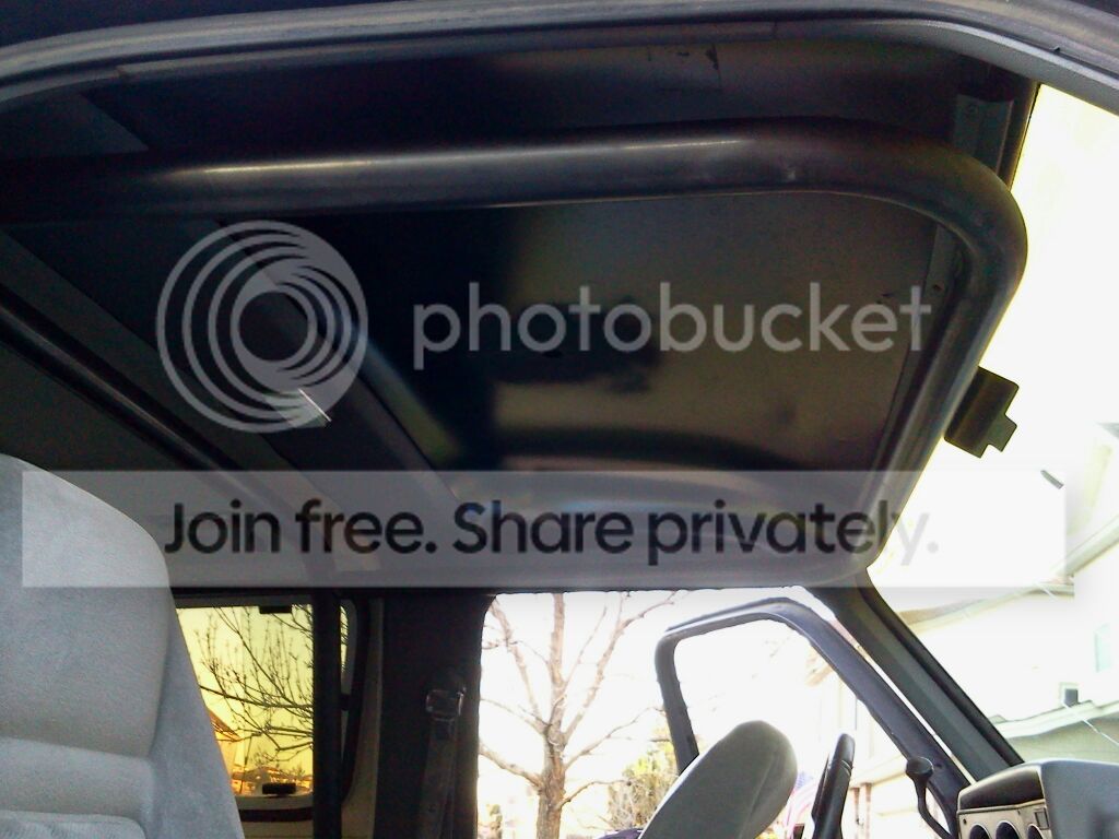

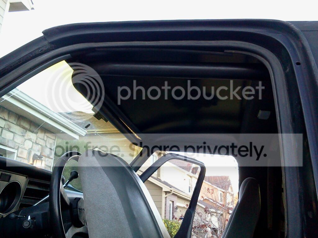

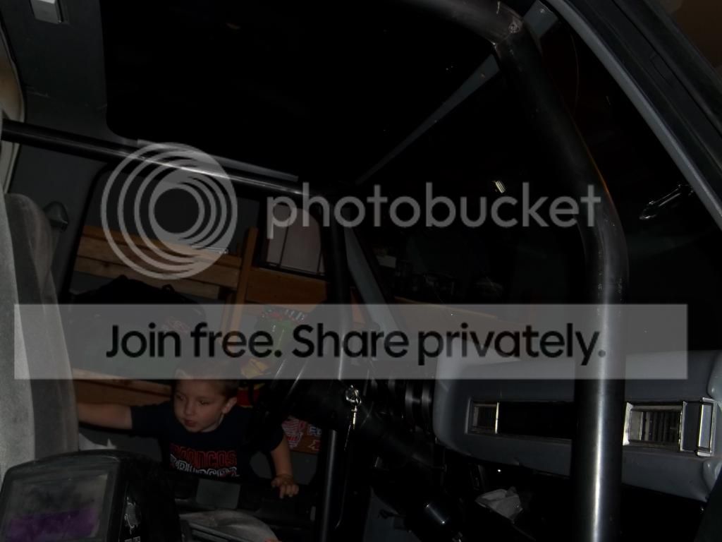

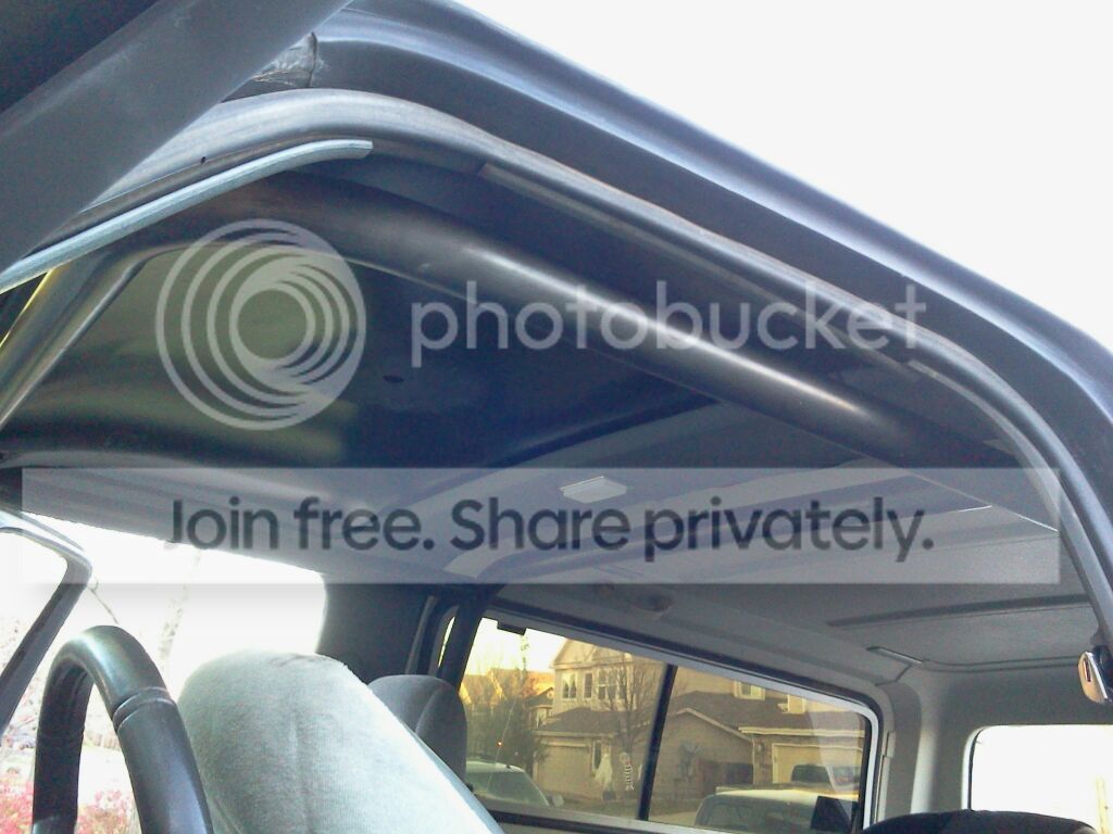

Got a couple more tubes on today. I probably could have gone a little tighter to the dash, but I really was more concerned with strength. Where the front tube comes down is pretty much directly above a tube that connects my sliders to my frame. Added to that, I am only about 5'8" tall, so maximizing leg room isn't as big of a deal for me. It's coming together though.

Does your knee hit the a piller at all when hopping in? That is my only concern with going behind the dash instead of through. But not really that big of a deal..
Winning!
No, I don't really hit my knee. I could have gone a little closer to the dash and it could have been better, but it works for me. I am not a very big dude though, so I can get away with it. I could see how bigger guys may really need to go through the dash or hug the dash really tight or else it could get really annoying. I plan to put some padding on the a piller for knee protection, and also on the halo by your head. That way if things get rough in the cab, it will still be all good. :D
