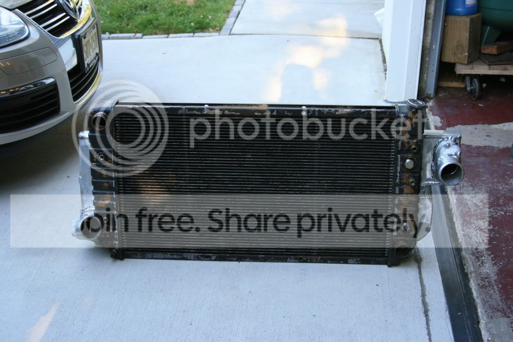

It's cold outside, but the Dearborn heater is keeping the shop at a toasty 54. I've opened up this 5 lb sack, and will see how 10 lbs might.
Sorry for the crap photos, but things are a bit cramped with the doors closed.
First off, let me say that this thing is big; real big. It would probably clear the factory 34" diesel radiator, but the Ron Davis tanks or just a fuzz wider than normal. I think I can just move The outlet over 1" and get the clearance needed. It's also about 2"-3" too tall, so it'll get cut down just a bit.
I've kept the radiator and cooling circuit intact, so that I can still maneuver the truck through the project, but I can't see a way to do good work modifying the core support without removing it from the truck.
David

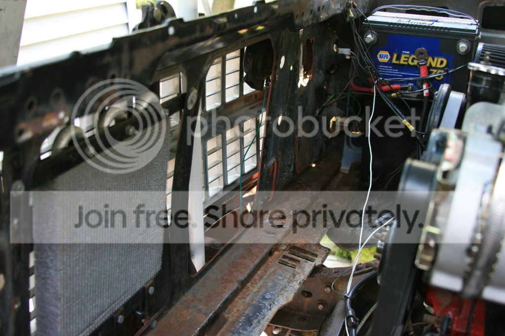

Ok, found my pictures from my install. Here's the core support all ready to go. I had to remove the box structure that goes over the mounting bolts for the support. The bars that hold the intercooler in place take the place of the now missing box supports.

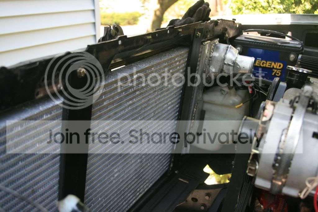

Here's the same shot with just the intercooler in place and how its held there.
From the other side.

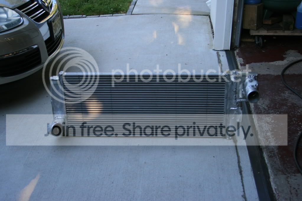

Here's the modded intercooler alone.

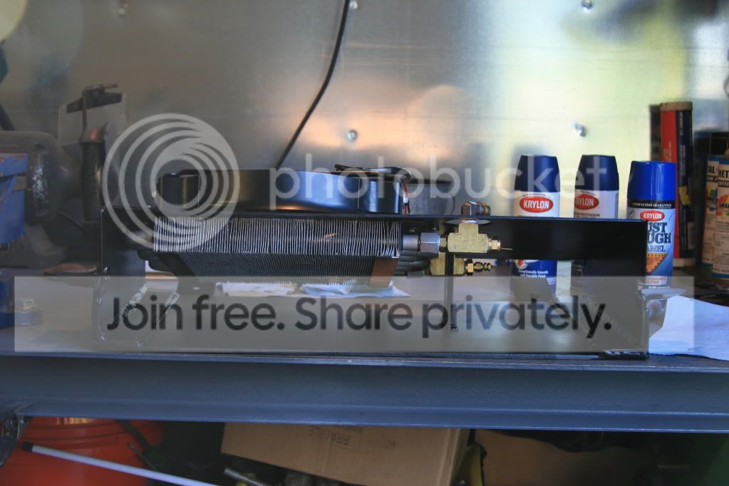

I came up with an interesting solution to where to put my oil cooler. I put it under the core support between the frame rails. I built a mounting bracket/skidplate that holds the cooler and a small fan.
Here it is without the bumper on.
And here with the bumper back on.
I've changed to a plate style cooler since that photo was taken and it holds temp pretty good. Temp gauge is on the inlet and it gets up 200. The fan sensor is on the cooler outlet and its set for 180 and it rarely comes on. I'llget a better picture of how sits tomorrow.
It's clear the core support hardware has not turned in the past 30 years.
David

Needed a payoff for the night, and aside from height and outlet configuration, that's pretty much how I see it sitting:
The inlet is at the same level as the turbo (Banks manifold), and with the batteries out back, there's plenty of room for the outlet to snake up toward the intake.
That's it for tonight.

Well hello, Clarice...
Trimming down the intercooler, I'm reminded of a scene at the end of the movie, Hannibal. A (mostly) full weekend of progress awaits.
