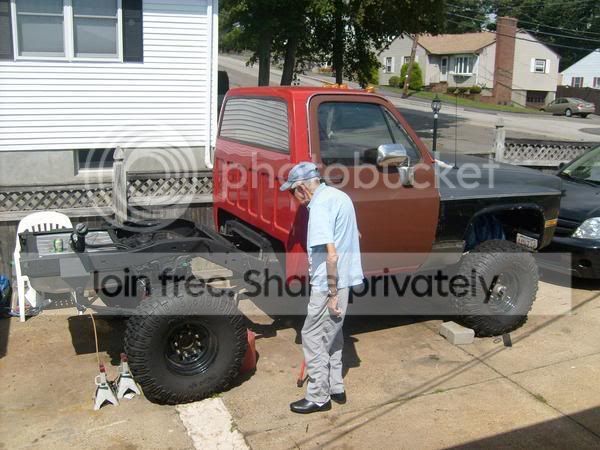

I ended up dicking around half the day tuesday and yesterday morning with our focking dryer, then half the afternoon yesterday at the junk yard. It took us like 3 hours to figure out all the mortor wiring, and the starter. I'm running the remote solenoid setup (like what ryoken's got), but I didn't put the jumper on the solenoid at the starter from the battery lug to the lug on the solenoid where the trigger wire would normally go, and all it would do with the key turned is click at the remote solenoid. We figured it out, after my buddy held a screw driver between the two lugs on the starter solenoid and I turned the key, that it was problem. So, threw a jumper in there, and she turned over
