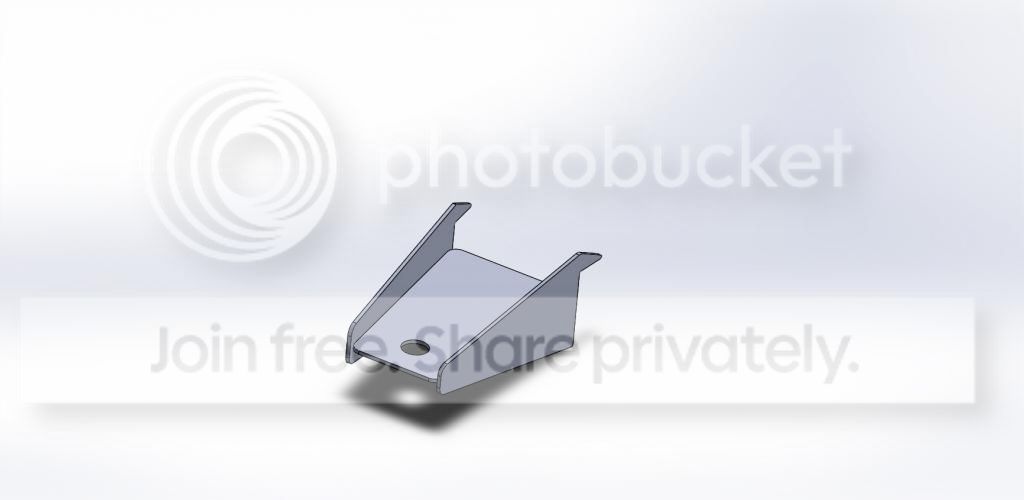

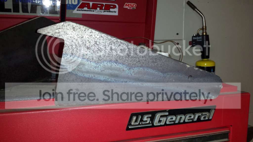

Measured and modeled up the front body mount.
Wrapped the vertical pieces to triangulate 1in above the frame for added strength I was worried about. Going to talk to the boss about cutting them out monday. Theyre either going to be 3/16ths or 1/4in. I would rather have 3/16ths but we currently dont have any at work...

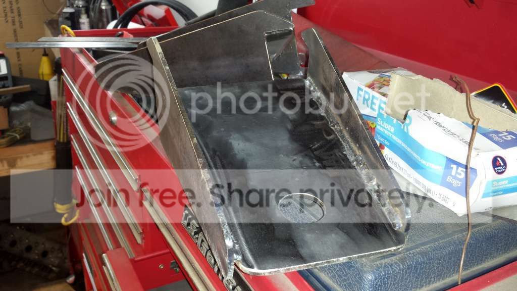

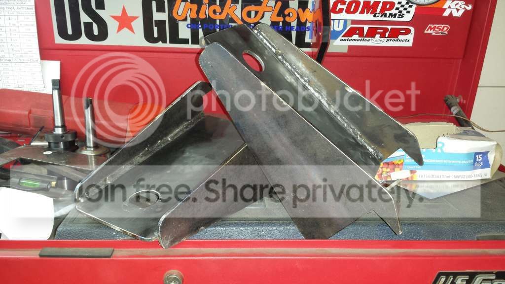

From computer to real life.
Probably would have been easier to cut them out at work instead of with a grinder...
Thats an s10 front body mount for a trooper tube frame. Im also going to be selling them as 6bt motor mounts lol.

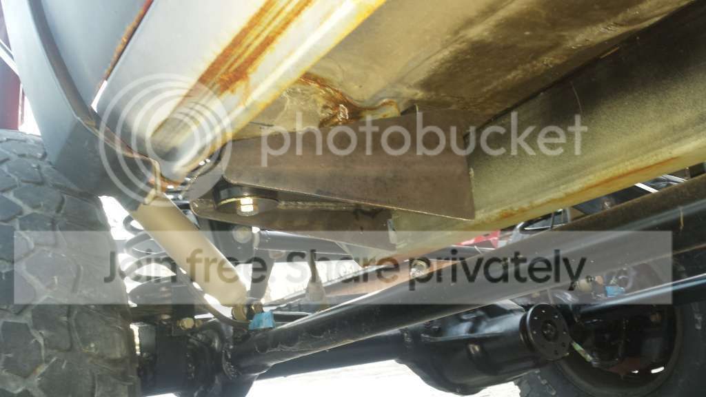

Fits like a glove. A glove thats like a body mount that I specifically measured carefully and designed on the computer ahead of time :pimp:

I would plate the body mount. It's sticking out a ways and will get caught on rocks. So plating the bottom. Guess I should check in more often. Didn't think anything would be going on considering the weather
Looking sweet man.
I want to see how my rock sliders pan out first. This truck is going to be flatbellied so Im considering doing UHMW inserts between the tubes tying the sliders to the frame.

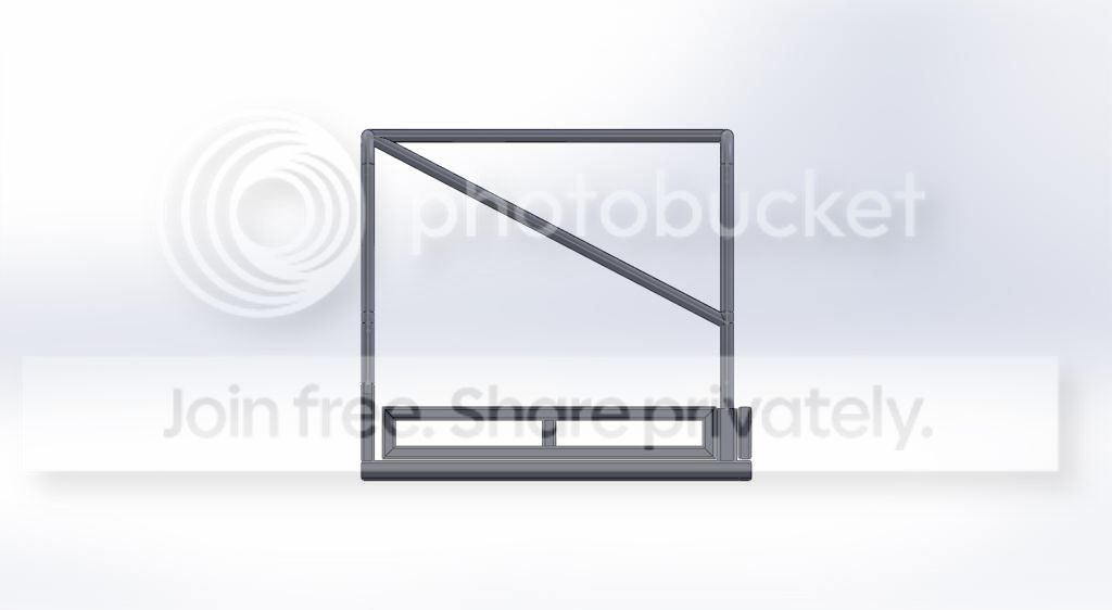

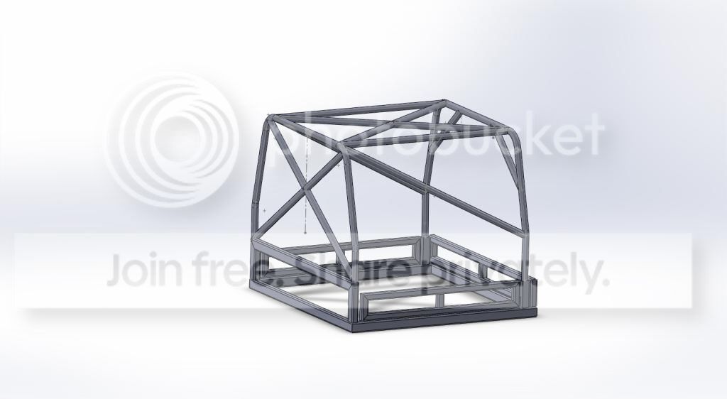

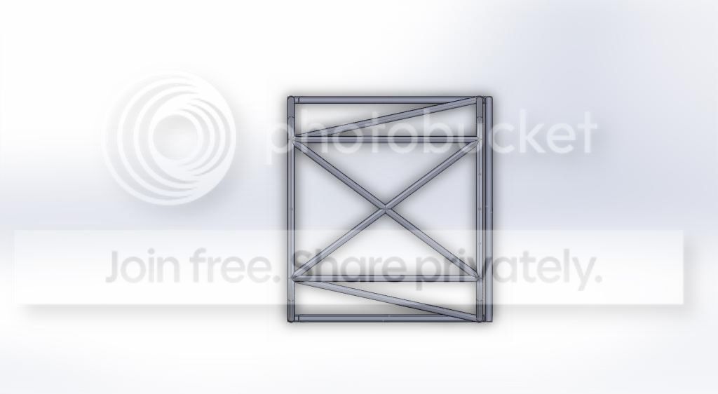

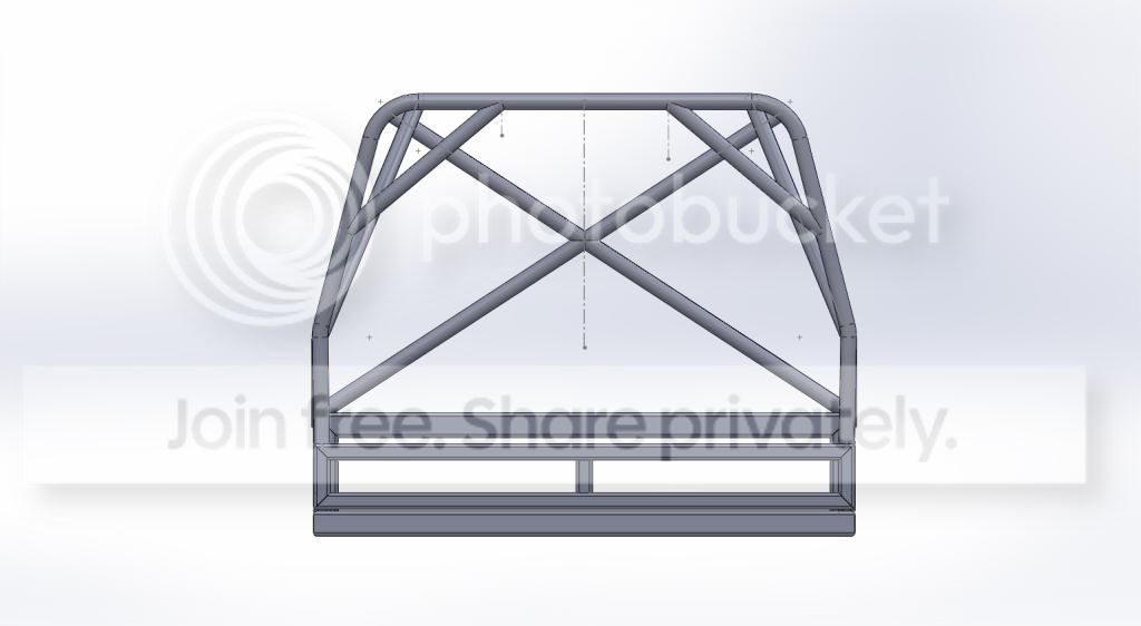

Got spiffy trying to learn solid works better. So heres the first draft of my bed. Still some things to fix up. Need to add floor and fillers on the sides and gate etc. Looking for criticism on the tube too. Solid works can be a powerful tool but insanely annoying when you cant get it to do what you want... Watch quite a few tutorials tonight...
Front/Back
Side
3d
