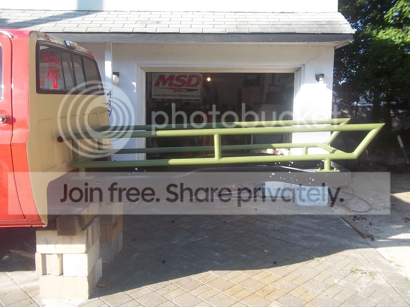

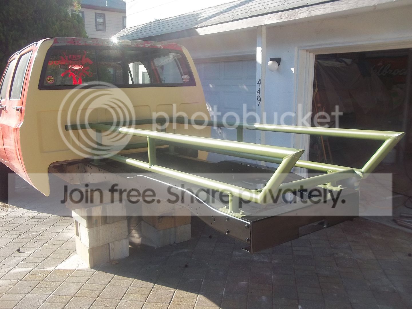

Ryoken's 89 Crew Cab Tubebed build... aka Mutt....
You've got to be a master at blending the way you do your painting in parts...sometimes months between....wish I posessed the painting skills :waytogo:
thanks boys! :bow:
back to tube work this coming weekend.. :grind::weld::hack:
Amazing work as always. Love watching your progress.
BTW does anyone else feel the desire to play Jenga with those cinder blocks....
No, but I want to do some kind of skateboard rail grind on those bed tubes!!!
:D
-G
