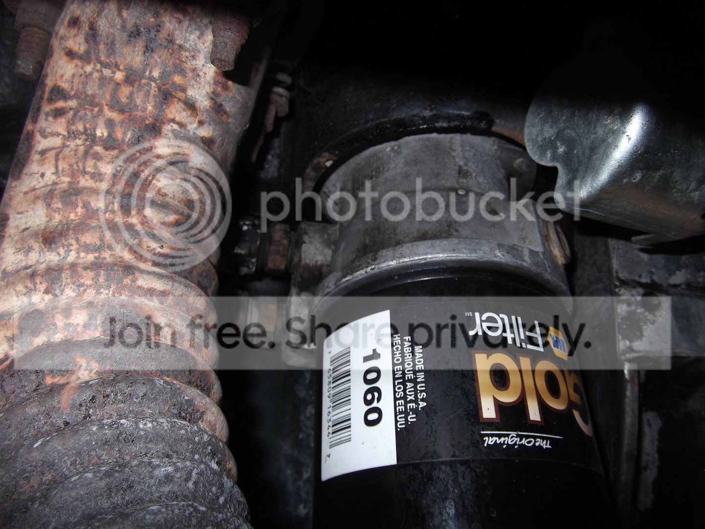

I want to eliminate the oil cooler on this rig... 1989 454 I have this adapter that I'm sure most are familiar with, held up with 2 allen bolts..
now I have an adapter that would bolt in there from my K5 to remote mount the filter... and actually have a cheapie remote mount.. I just don't want to be bothered making up some pushlock hoses/fittings, yada for a mill that's gonna go 6BT anyway........
I just wanna eliminate that one and run a filter in the block...
I think I just need one of these
http://www.summitracing.com/parts/ses-3-60-08-900/overview/year/1989/make/chevrolet/model/v3500
and the filter gasket will just seal on the recessed block surface that the current adapter sits on... and than it would just take a standard cheby filter like a wix 1515 or napa gold 51515
but that search is for an 89 454, yet in the description it says those only fit up till 1986?
wtf?
actually it would be another napa 1060, as those are 13/16-16 thread like that adapter.. whereas 1515's, etc take a 3/4 thread.. or if I wanna go big capacity, I could get the 2 qrt version, napa gold 1794
You are on the right track, get that adapter and the appropriate filter.

Spin on adapter, bypass the problem.
thanks mang.... my biggest concern was whether the filter threads would be sticking down far enough for the filter to engage... gonna order it this week... think I'll go right for the 2 qrt 1794 filter too... next weekend project...
yeah, the one original hose is starting to weep a bit I think and they are horrible looking... might as well get it out of there now, make some room.. ditch the cooler.. help clean the front up some in prep for the new bumper skid, yada....

I just had new hoses made for crew cabs oil cooler last month cost @ 120. Turns out I didnt need them the power steering cooler was leaking right above it and wetting the oil cooler lines! :doah:
yeah, I am VERY suspect of that going on here too... I have added a tad here and there..
that's why I spent SO much time today getting EVERYTHING as clean as possible so I can figure out exactly where my leaks are over the next couple days.....
but I planned on getting rid of it anyway, so may as well do it now..
thanks..
it looks like one comes with the gasket, no bolts.. and the cheaper summit comes with bolts and no gasket... 6 one way, 1/2 doz the other.. :haha:
i'll order the cheaper summit tonight.. I have gasket paper at the house here if needed....
