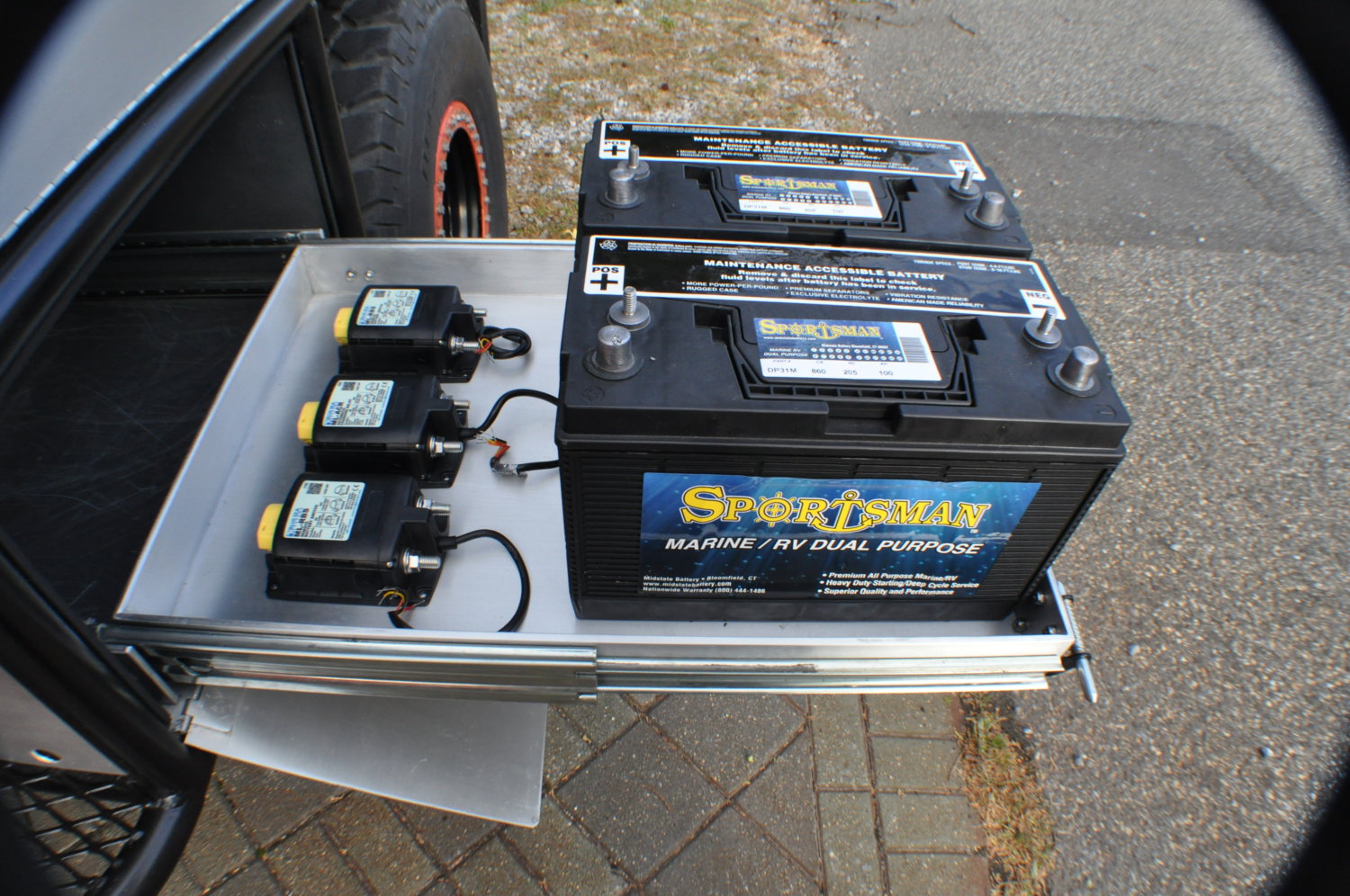

My wires are not secured at all, but I'm wonder if the pressure from the bigger wire on the plastic, when rolling around that curve, will be too much for the chain? Then securing it to the chain may alleviate some of that pressure? I would definitely try in without the wires attached first though.
that's why i was looking at the metal stuff.... now that you brought it up, i'm not seeing why you would have to secure them if it all tracked nice...
they actually make those in fully enclosed, 4 side, feed-thru style too... i ruled that out initially, but maybe I should take a peak at em tonight...
Are u going to have on/off switches at the batteries for emergency shut down?
those 2 remote bat switches that the bats are feeding have manual shutdowns on them.. in addition to the remote on/off switch in the dash...
you turn the yellow knob at the end.....
full
oh, another sticking point to this whole deal.... I'm not exactly sure how the track is gonna have to mount... it will more than likely be upside down compared to this pic....
cuz the tray moves, not the ceiling... so that throws some tray configuration issues into the mix due to where the cables will exit onto the tray....
gonna get out and check all this tomorrow.. i may actually move the bats to a front/back config on one side....
