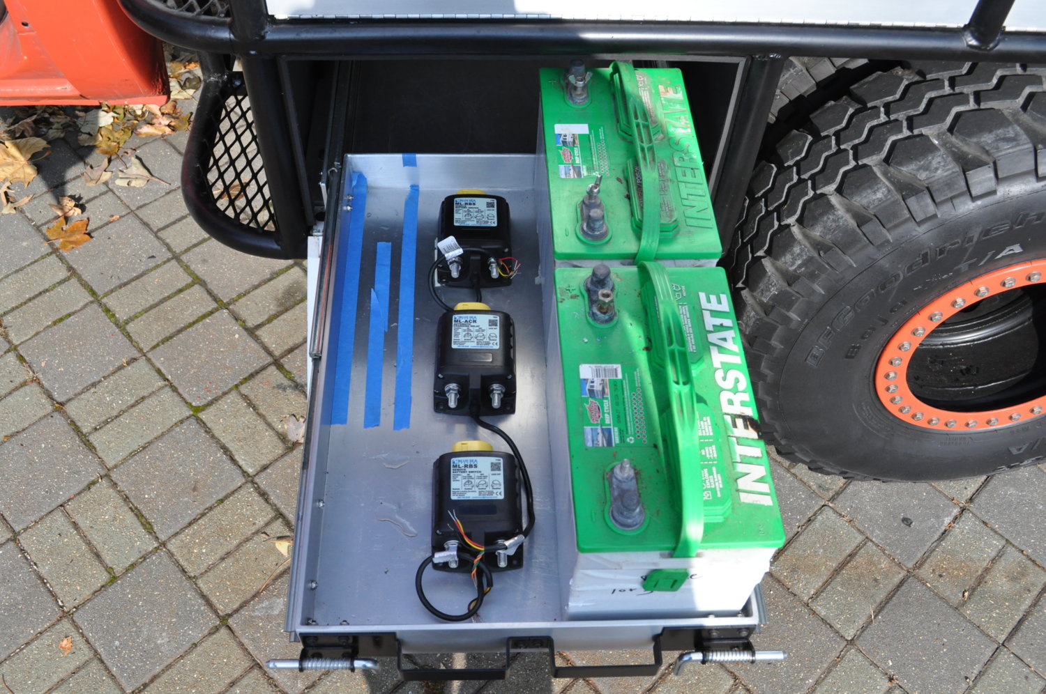

so... this is the new proposed tray layout..... the track goes from the sidewall, to the right side of the blue tape... how far forward on the tray, unknown at this point....

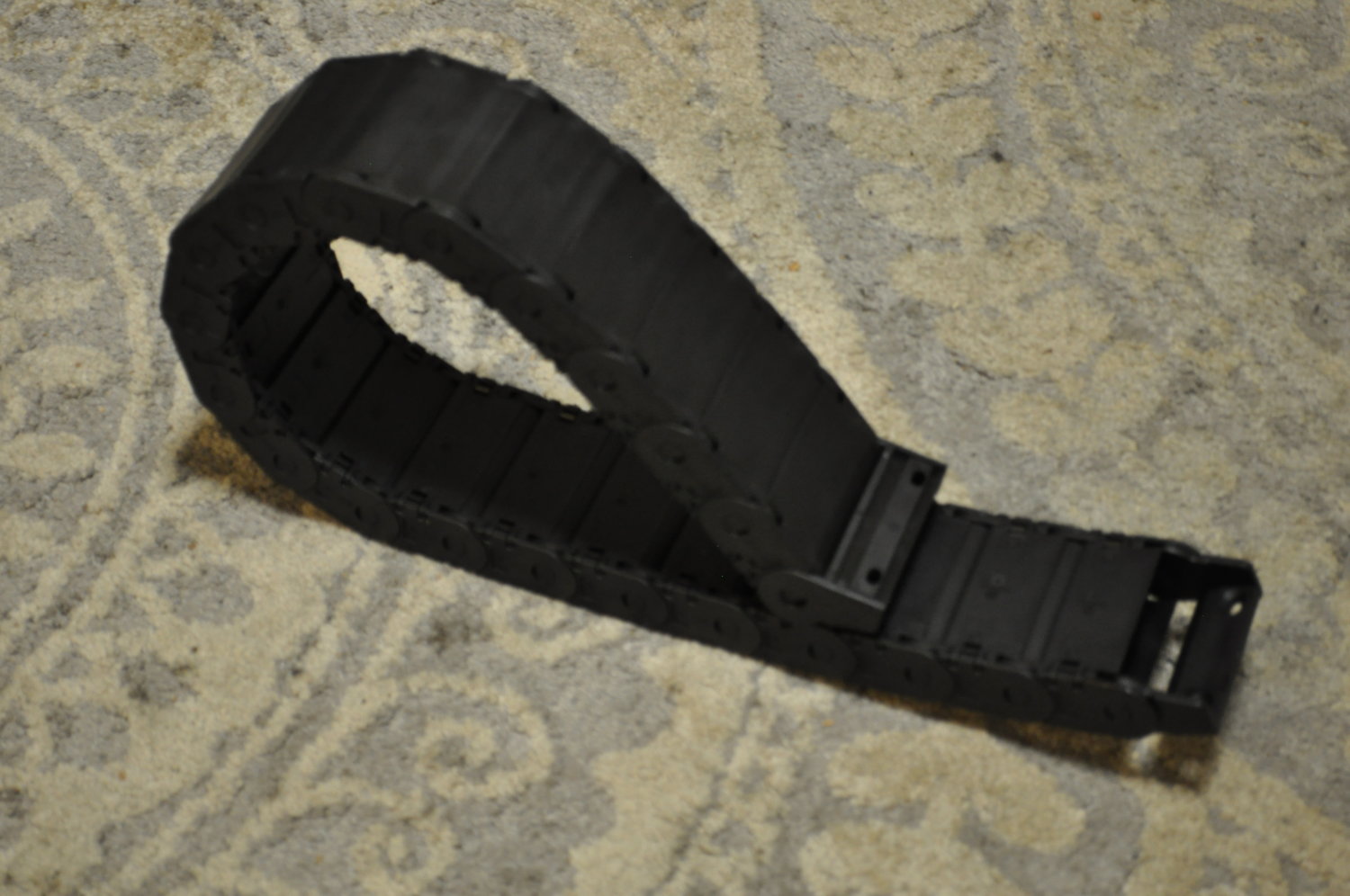

the one thing that will have to be done is, that tray's back wall will need the left 3.5" removed.... that's where the cable carrier will lay when all the way out......

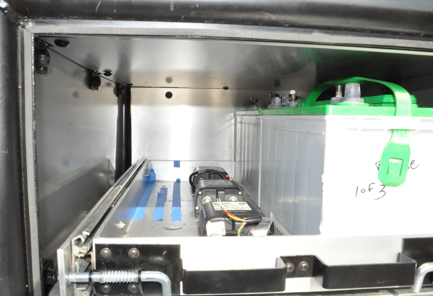

here's how tight i am..... also, in relooking at this, the ceiling track mount will be as far forward on the ceiling as i can get it... it has to be for when the tray is out....

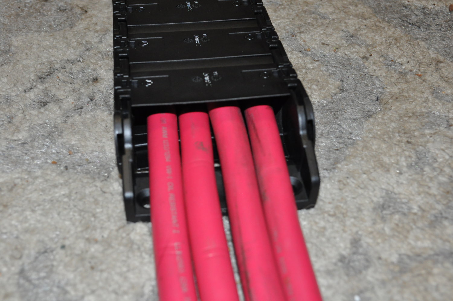

the wire bundle will actually come out of the track right at you, than curve around and head back down the middle of the ceiling next to the bats....towards the backwall....
