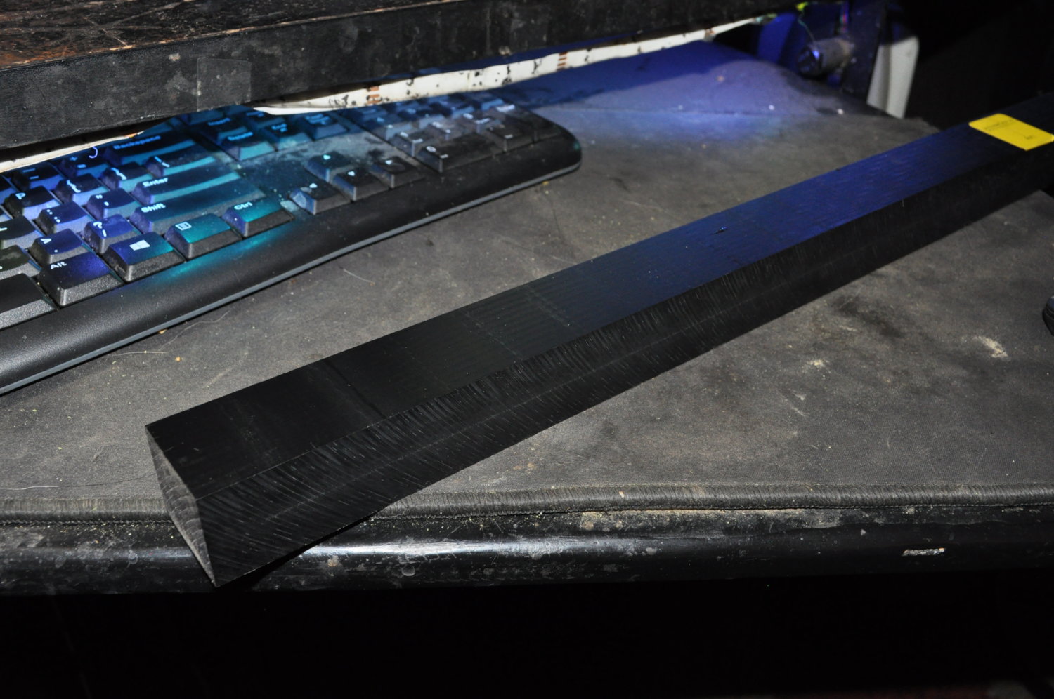

some black Delrin would be nice, but pricey... about $40 to do a 1/2 dozen.....
https://www.mcmaster.com/8663k23
i think 1 1/4" x 1 1/4" will be a good size... hopefully that's enough "beef" once i machine out for the wires... the wire is 5/8".... and I'm thinking being that I'm going with the delrin, which is designed for this, I'm not gonna bother adding any shrink chafe protection.. the marine jackets should be fine... that should be enough to do 6 with no screw-ups.... my only indecision at this point is whether I'm going to do individual "tunnels" or 1 large opening with the wires right next to each other..... leaning toward the latter...
gonna run black truss head hardware to hold em down....
https://www.mcmaster.com/94779a900
oh, with all the x-mas shopping this week, I earned enough points to get an amber underbody light kit.... :pimp: can't wait for my layoff..... ;)
wow, this Delrin chit is pretty cwazy.. it's fuggin heavy.... :haha: 2' hunks gotta weigh 4 or 5 lbs...
it seems very hard.. my boss thought it was alum when i handed it to him...
full
gonna be interesting to see how theses "finish"... apparently it doesn't like a ton of heat, so low speed will be needed... but i feel like i'll be hand-file breaking/rounding edges, etc... and not sure what the final finish will be.. maybe wetsand with 600 or sumfin...??? I'll feel it out once i drill the corner holes out and see how it cuts this weekend hopefully.....
I have 0 doubt that this stuff will be plenty stout and perform the task....... my kingdom for a Bridgeport right now tho....
* Ryoken - needs to actually figure out the dainty, yet stout bat hold-down frame..... *
full
Delrin finishes pretty nice, a little like acrylic but much. Way easier to machine than acrylic though.

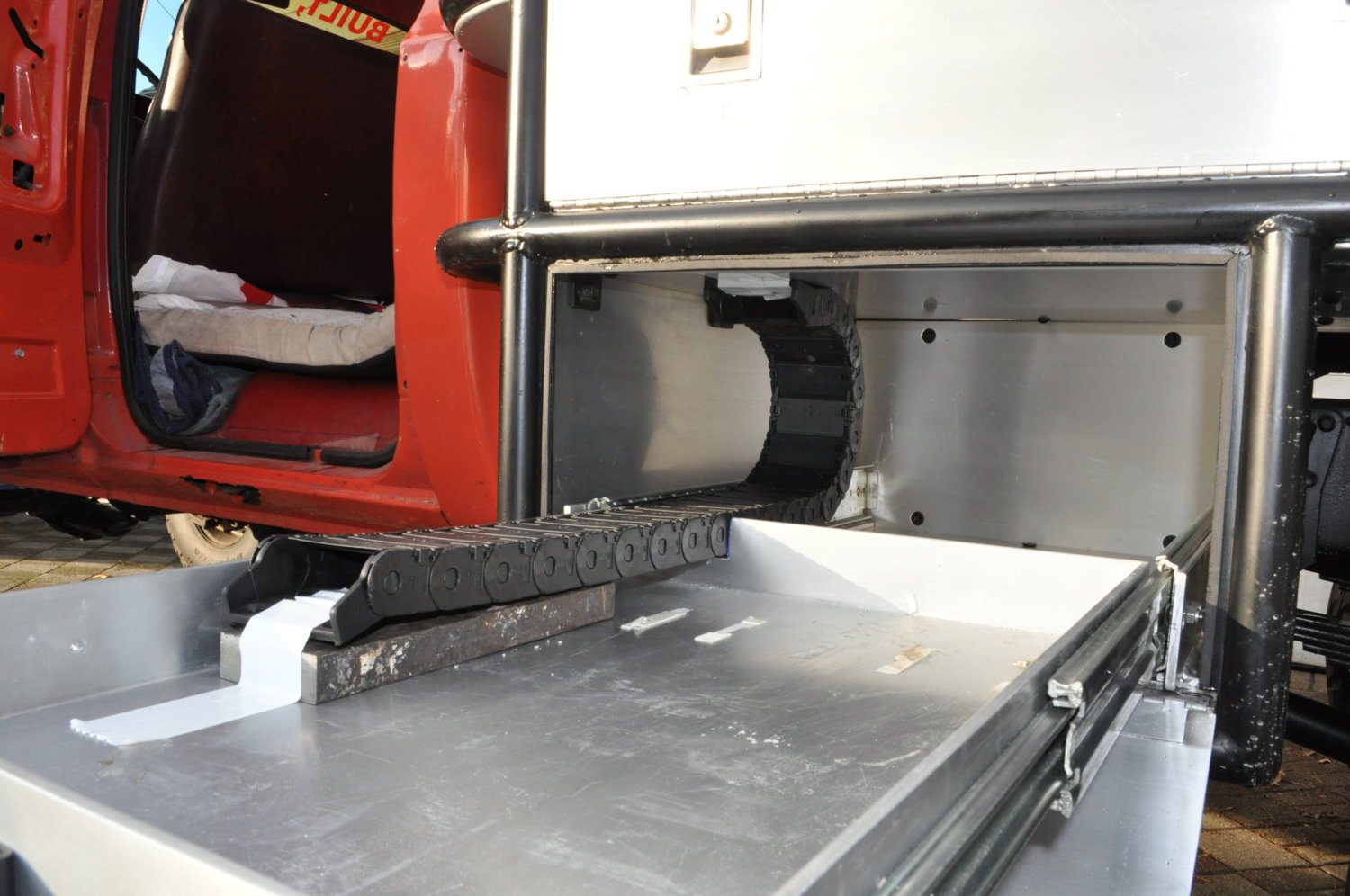

so, had a few minutes this afternoon...... whacked out the needed back wall section and did a quickie proof of concept...
ignore the tape, gapping, etc in the pics... when you hold each end in position and operate the tray, it moves sweet....
full
full
you'll see i have it setup the way i talked about, with a bit more room in the tray than the ceiling....... at this point, i need to start working on the cable clamping/bending to see what realistic radius's I can put this cable in... that will dictate how far forward i could move the entry/exit points if i desire...
hmmm, i also need to allow for UHMW sheets on the roof and track... i'm thinking 1/16 or 1/8 adhesive backed...
Interesting, it comes pre-adhesived. Wonder what they used and how long it will last. If it ever failed in the temp swings you'd have a hell of a time re-sticking. Maybe some kind of fastener system would be better. countersink fasteners if necessary..
well, it will be thru bolted at the ends of the track... i'm just trying to avoid sumfin thick, and expensive... ;)
hmmmm, they only have the adhesive up to 1/8" thick.. obviously not enough for mechanical.... but for 1/4" non-sticky, it's basically the same price...
and that's in black, which i prefer.... it'd be more work, of course, but that may be a "safer" route... 6, or 8, fasteners per piece prolly..
