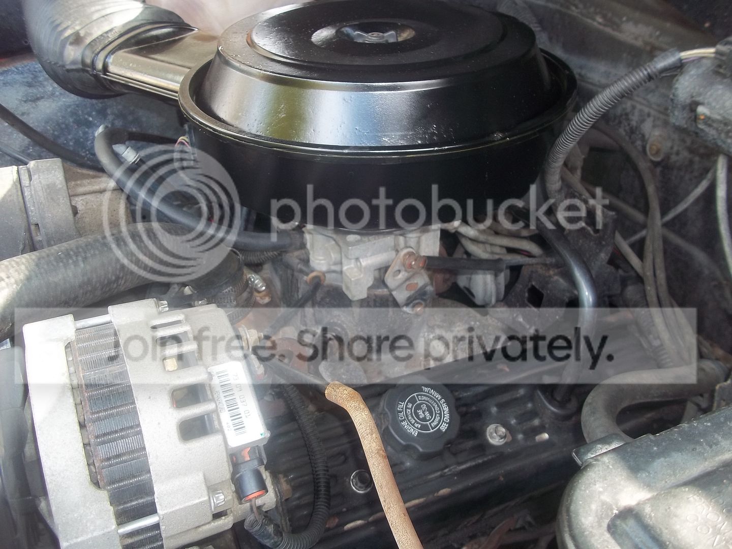

as some may gather from that 4.3 TB thread, I'm doing some throttle body rebuilding on this thing tomorrow...
so for tonight, I just had to post this.... :whistle: :haha:
All hail the mighty blast cab! :bow: :thumb: :bow: :pimp:
mang, I luv that thing! :bow:
semi-new 350 throttle base.. TPS plug was different tho.. runs much better now...
