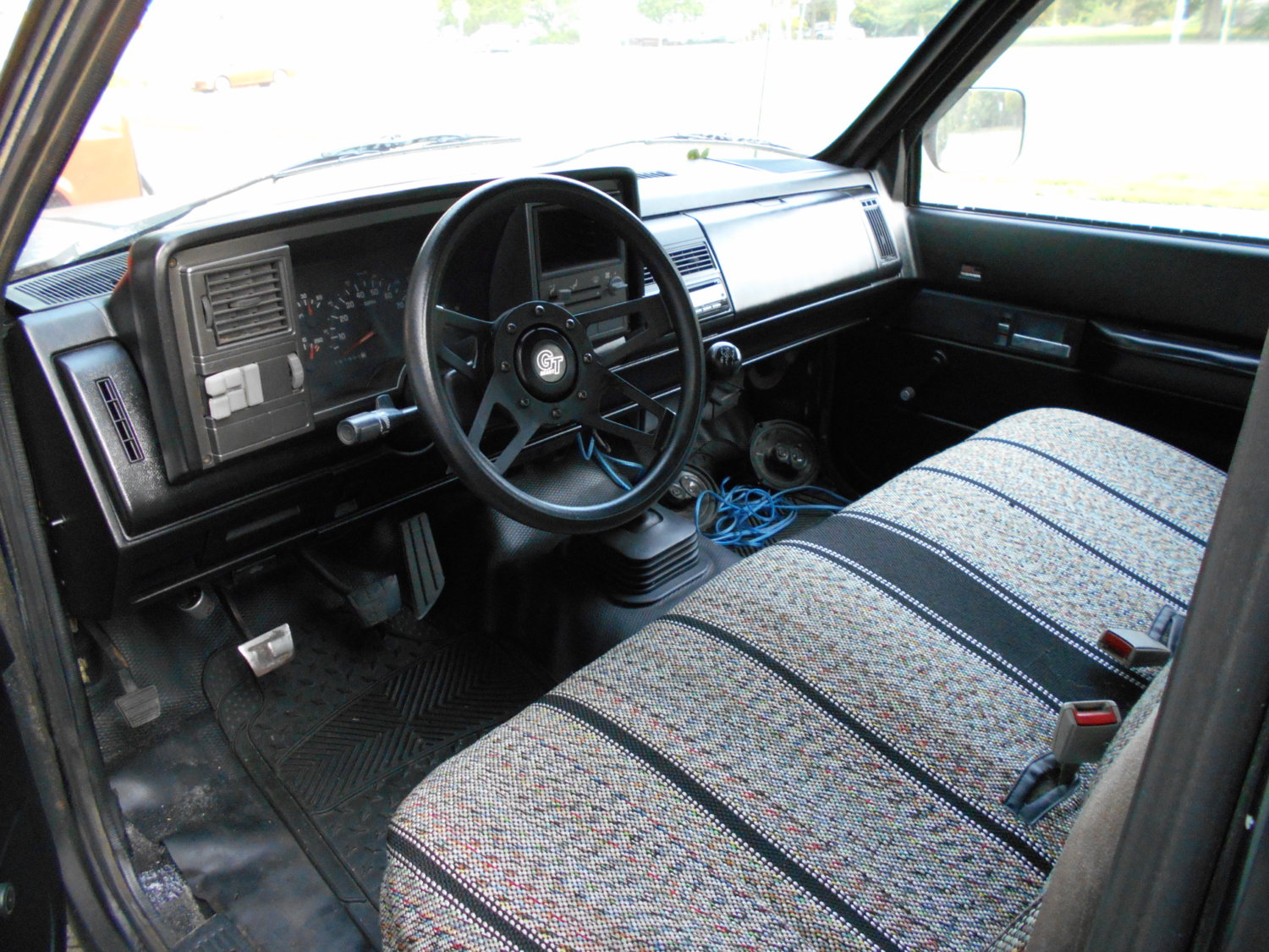

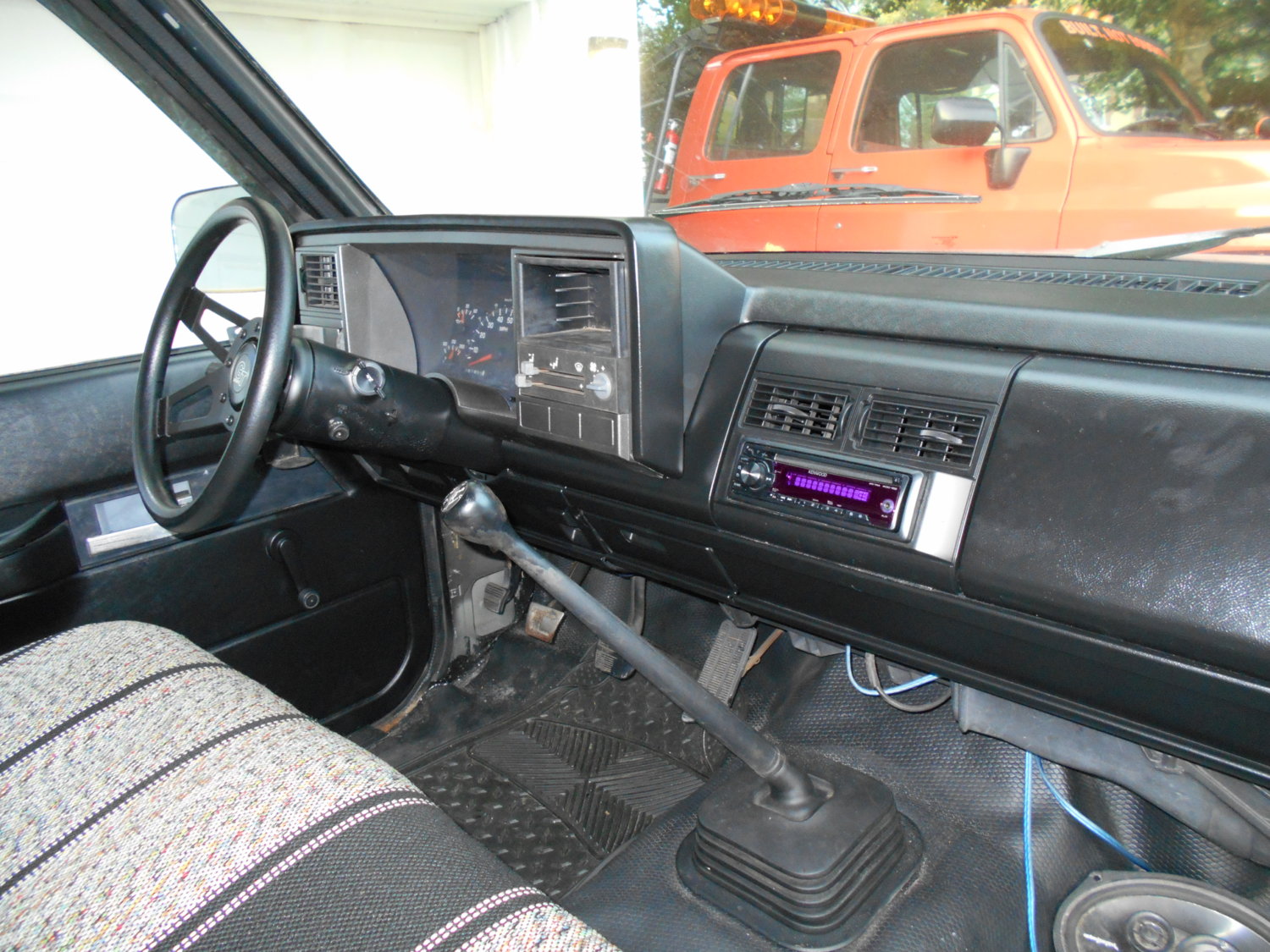

so.. other than mounting the new rear speakers in their "behind the seat boxes", the interior is pretty much done.. excuse the finger prints... and still need to get into the column for the turn signal cancel... but the new front speakers and Kenwood unit are in and all the satin black is done.. just need to do the gunmetal on the door insert pieces around the handles... same color i did the bezel in....

I won't be running plastic pillars, kick panels or a headliner for a long time, if ever... don't care, it's pretty sweet in there now compared to before...

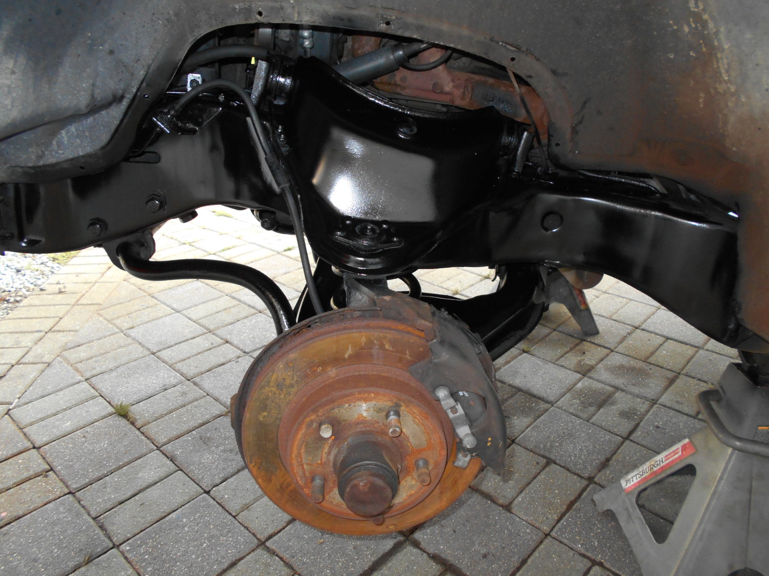

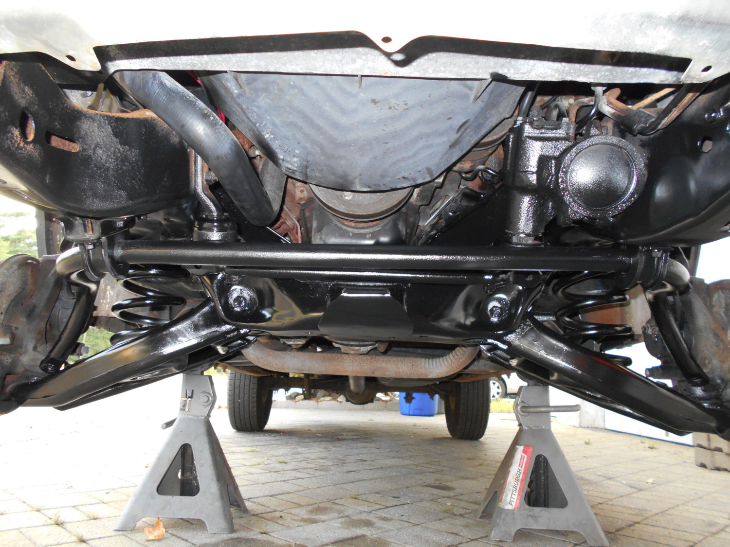

than today, in prep for new shocks, end links new tie rods, I wire-wheeled, roloc'd and sand blasted the front x-member and control arms.... . primed and rusto'd.. next yr when i replace the front clip, i'll get the frame rails better.. the shocks, etc will be in monday...

oh, and yes, that is a broken wheel stud.. the guys who did the front tires must have had at it with a 3/4 impact... the knurls are stripped in the rotor.. had to cut it to get the rim off... grrrrr... thanks...

need to run it down for a final alignment, but the all new shocks, tierods and end links made a huge difference.. the fuggin shocks where original!
the interior/stereo stuff came out sweet.. it's just an $80 kenwood with fresh 4 x 6's and boxed 6 x9's behind the seat.. but it bangs out some Ted, L7 or Sab with some snot when need be... i find myself "over hanging in it cranking tunes while my steak is on the grill. ;)"

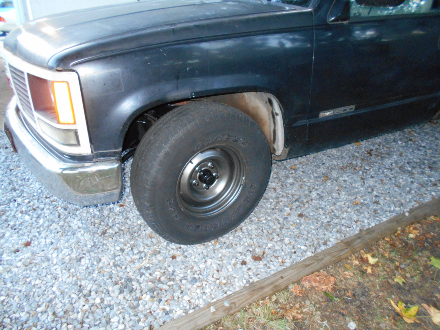

gonna have them put a new pair of general grabbers up front to match the new rears from a couple yr's ago..
oh, and I'm thinking of carrying over my dash bezel color to the rims... kinda of a puetery platinum kinda deal to offset the black... i may try a few other more "standard" silvers... I do kind of like how close this is to the blacks.. and the bit of "brownish" it has adds sumfin too. we'll see.. easy enough to change around being rattlecan.... I'm also gonna do the bumpers and grill whatever said color too...

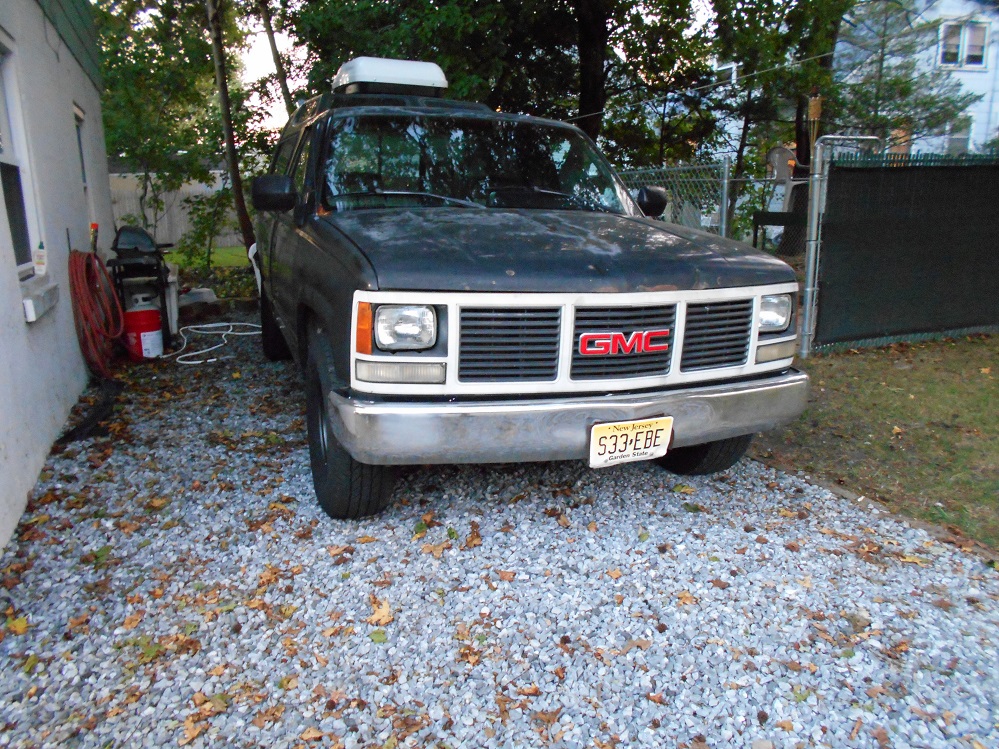

ok, someone more versed in this body explain this to me...
what is my grill setup on this 92? all the listings in LMC for an 88 to 93 show a quad light deal.. this looks like the 94 to 98 single headlight one? ????? wtf :confused:

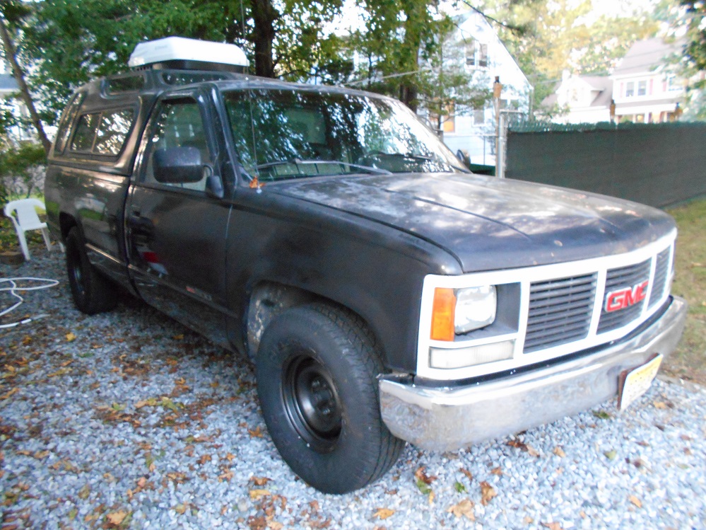

this weekend begins the front end "look" change to see what looks good... the grill is all busted up so it's a good candidate for multi-rattle jobs... i'm also painting the bumper....
the question is which way to go...
full
the immediate thought is to do all the lighter gray parts the bronzy, gray that the rims are done in... than the center inset in black.. and probably the bumper in black..
but something inside me doesn't like the way the grill meets the fender.. i'm thinking matchy matchy for the fender and grill, than do the insets in the bronze gray.. and try the bumper in the bronze gray.... think i'm gonna try that first,,,
once i figure out what yr grill it is, and what colorway looks good, i'll get a new one... the bumper i'll just paint the chrome...
LMC likely doesn't sell that grill due to it being pretty easy to swap over to the quad headlight style. That is the correct grill for your year. The single headlight trucks like yours are the lower trim package grill is all
so i could buy a quad grill, than i need what, just a quad composite headlight? i'll have to look at what's in there this weekend.. i don't see headlights listed for my rig in LMC.. i don't mind doing that upgrade if i can do a headlight upgrade at the same time.. just don't want it to be nuts.. like $100, 125 for a pair of complete headlight assemblies i would do....

Take this at face value but this topic just got covered yesterday on Facebook. A guy asked about switching from sealed beams to the composite headlights and chrome grill. He got probably 10 answers saying it's a direct swap over with the correct lights, grille, and light harness. I haven't done the swap myself but maybe @beags86 can confirm since he has parted his share of GMT400's
It's a straight forward swap just like a single to quad swap on a squarebody. I have done it before on some plow trucks but it was free because I had a parts Truck.
And Yes, that's the correct model grill for a base trim model truck like yours. A quad headlights only came on SLE trim.
