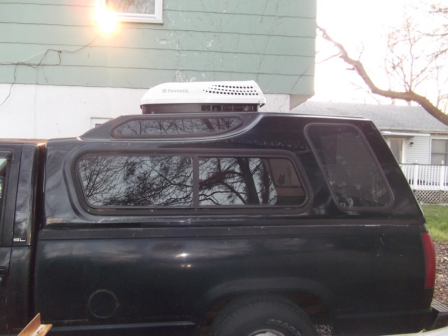

also ordered new body mounts, notate the bodylines below, cab is laying on the frame... here it was recently after the AC install.. when i buy the unit for Mutt, I'll get a black one, swap the covers.. than paint this white one Ryoken red for Mutt...
the amp draw on this thing is borderline.. it's a 12.7 RLA... so it'll be right around 15 startup... doing the wiring tomorrow... many circuits are 20 these days, and that is actually the minimum the unit calls for to run... obviously it's designed to run on 30 amp RV hookups... that wouldn't be an issue at the marina, but elsewhere, don't know.... but hopefully it fires on bs 15a lines too... as long as it isn't tripping outlets...
full
did final wiring today.. works fine on a standard 15 amp... seems to crank pretty good..

i'm stoked on the AC.... i'll have to see how performance is with it.. probably continue using the sun tent to shade the rig at the marina just to make it's job that much easier... it HAS to be better than the hokey portable air conditioner i had vented out the slider.. that thing worked like sh*t...

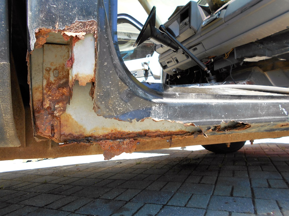

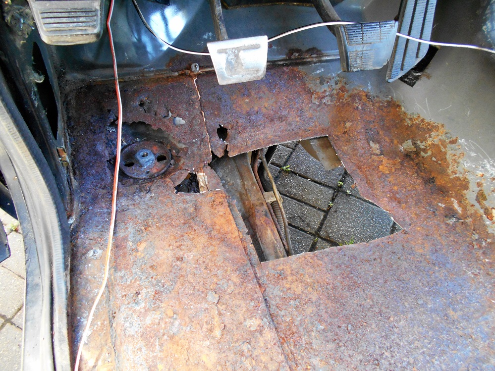

anyway.... since i committed myself to the rig pretty thoroughly with the AC and now clutch.. I need to start saving the cab... doing the body mounts now, the cab was laying on the frame..... they actually rotted thru the frame brackets, so I'll be plating those next weekend and getting the mounts in...
was originally gonna just throw a quickie patch over the hole in the floor, but said screw it, just ordered a ds floor, front left cab support, 2 cab corners and a ps rocker... surgery starts next week.....
