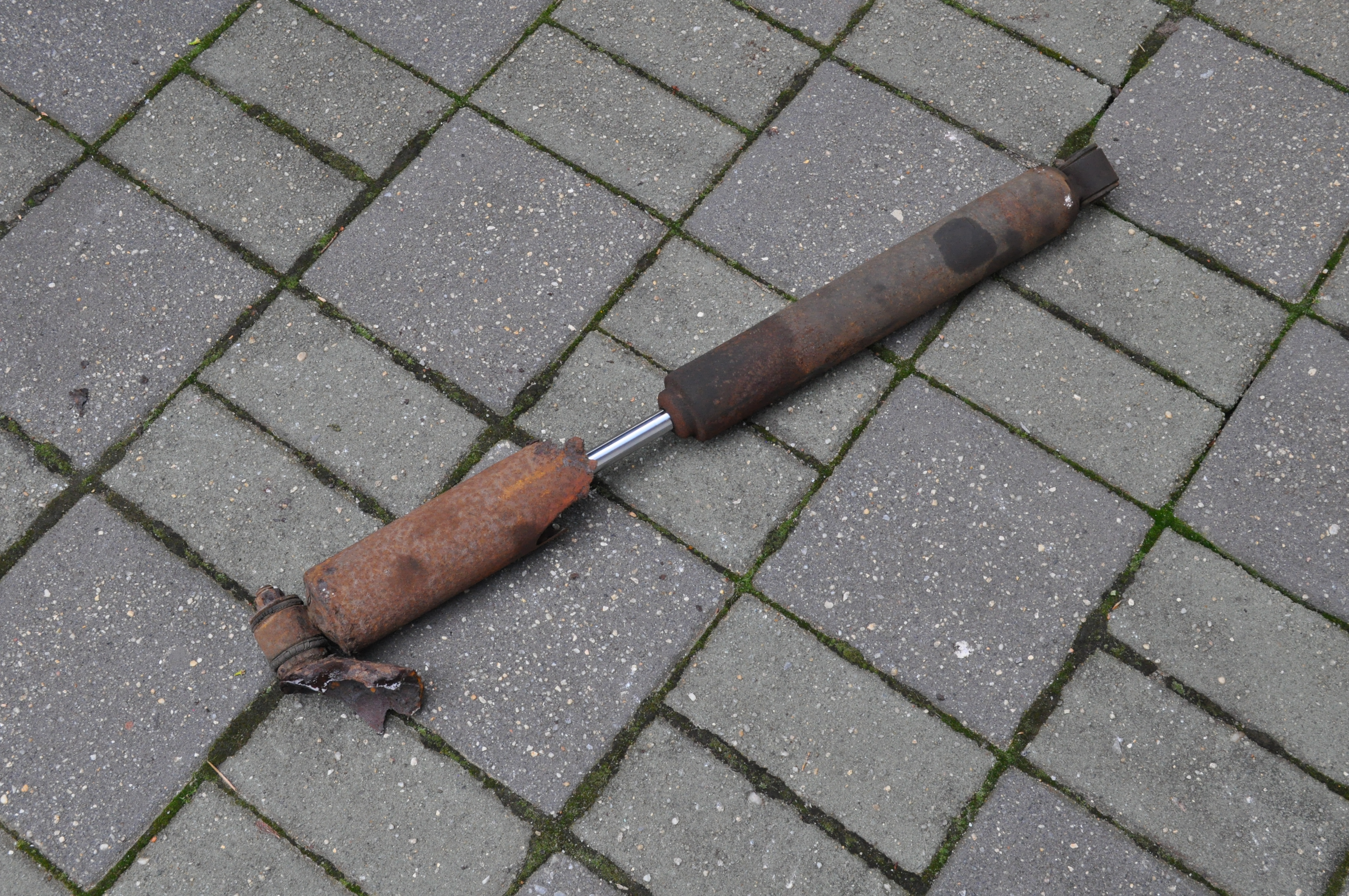

and, this happened the other day.. almost took out my new gas tank..... :doah:
full
the other rear mount is about to break off too.... I ordered both upper mounts from Jeff's.. they'll be here during the week..
soooooo, I'm gonna do shocks soon.. but being i still want to lift it down the road, don't wanna get crazy..... gonna look to get some of the cheapest monotubes I can find...

NAPA truck shocks used to be pretty good stuff for pretty cheap.
Also, check Rock Auto. Sometimes they blow out older stuff for pretty cheap.

Oreilly used to have a Monroe gas magnum shock that was a good value.

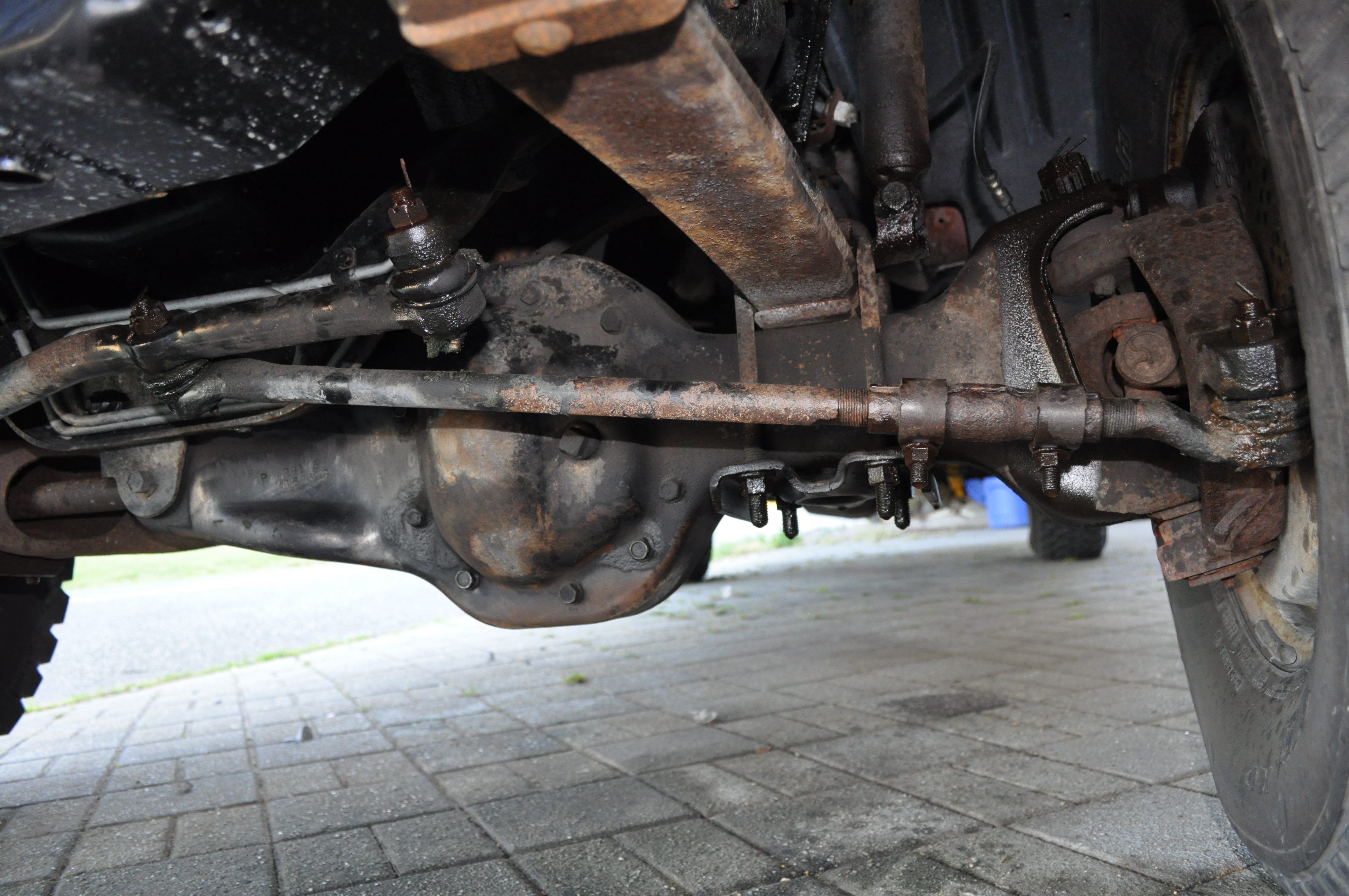

since i'm figuring I might be waiting a few yrs to do a proper SAS/lift on this rig, I'm thinking about a temp solution to my "saggy" front end, rake....
the back of the rig is exactly 2" higher than the front....
I'm wondering if putting an add-a-leaf up front might be a good go between here to get a bit better stance and help with tire clearance up front... maybe even go for the 35's at that point...
anyone have experience with something like this? or is it hokey?
1.5" would be perfect help to even the rig out.... hopefully it wouldn't mess with steering, etc much at all...

Should be just fine. Everyone and there brother puts a front leveling kit on 99-04 super duty trucks. Most I've seen are like a goofy mini-pack thats basically a zero rate setup.

All those ttb trucks look like they are sagged out in front with shitty camber.
I'm hoping overly religious tire rotation can keep the tire wear pretty even on a new set of Toyo's.. I'm sure the alignment will need a tweak if I throw an add-a-leaf in.. that's one thing I'm gonna look at over the next month, get the front jacked up and inspect tierods, sleeves, bj's, etc... tho it drives fine now, seems tight, no wander..... I greased it all when I first got it...

4 - drop front TTB and do add-a-leaf... prep for alignment..

got about 4 hrs in today.. happy that i got some blasting done.. always a nuisance gig... ds rims are stripped, primed and painted.. and got the rotted out rear shock mount replaced and that shock in... also got the front end degreased..
the other task i missed on that list is a fluid change on the trans and tc.. have the fluid, just need to get to it... next 2 day weekend i can manage, I'm gonna see about doing the add-a-leaf up front...
