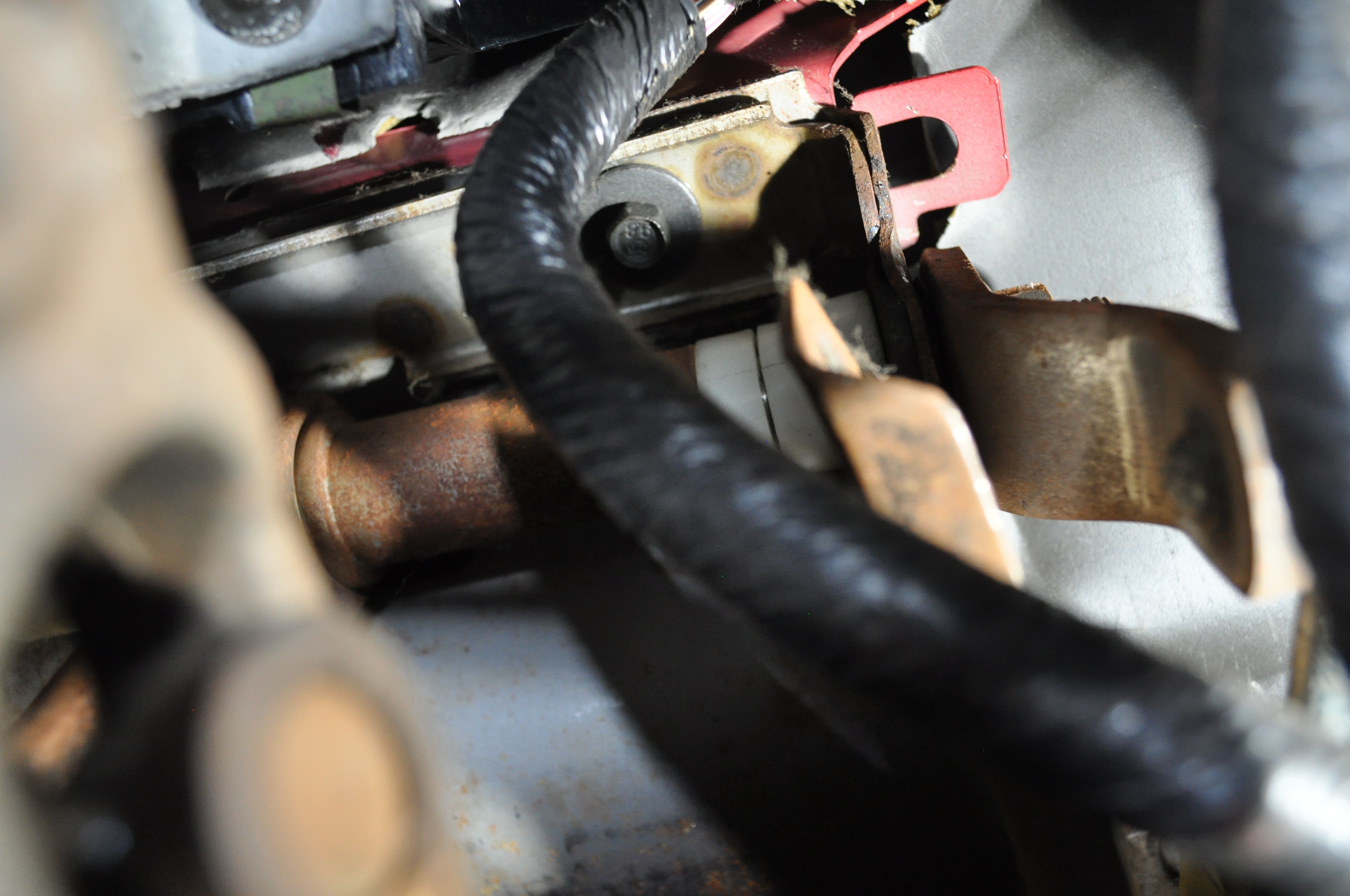

Finally took a REAL peak at the clutch and realized the right bushings where fugged. Going to do a rod end mod on the end of the master rod to the clutch swing arm to replace the bushing there that is destroyed... But also the 2 right, white, upper shaft ones are slopping around... That may be a bit more involved... But you can buy a kit...
It's gotten a tad worse which is making the neutral safety switch not trigger sometimes... Hopefully I can get the parts by next weekend...
Oh, and I was right, that window motor jeffs sent me was wrong...that's twice I've gotten fugged by them now..... But apparently you can run a ds one in there.. it bolts up, just the motor faces down, not up... just needed to reroute the pigtail.. windows working...
just ordered the main shaft bushing kit.. and the rod end mod.. also a new swing arm cuz it needs to cut new splines for the new arm position..
the upper shaft is much less the culprit here.. BUT.. the job looks WAY more involved.. it looks like you MAY have to pull the pedal assembly to do that.. meaning not only the hydro master, but the brake booster/master cylinder also needs to come off... possibly the e-brake pedal too...

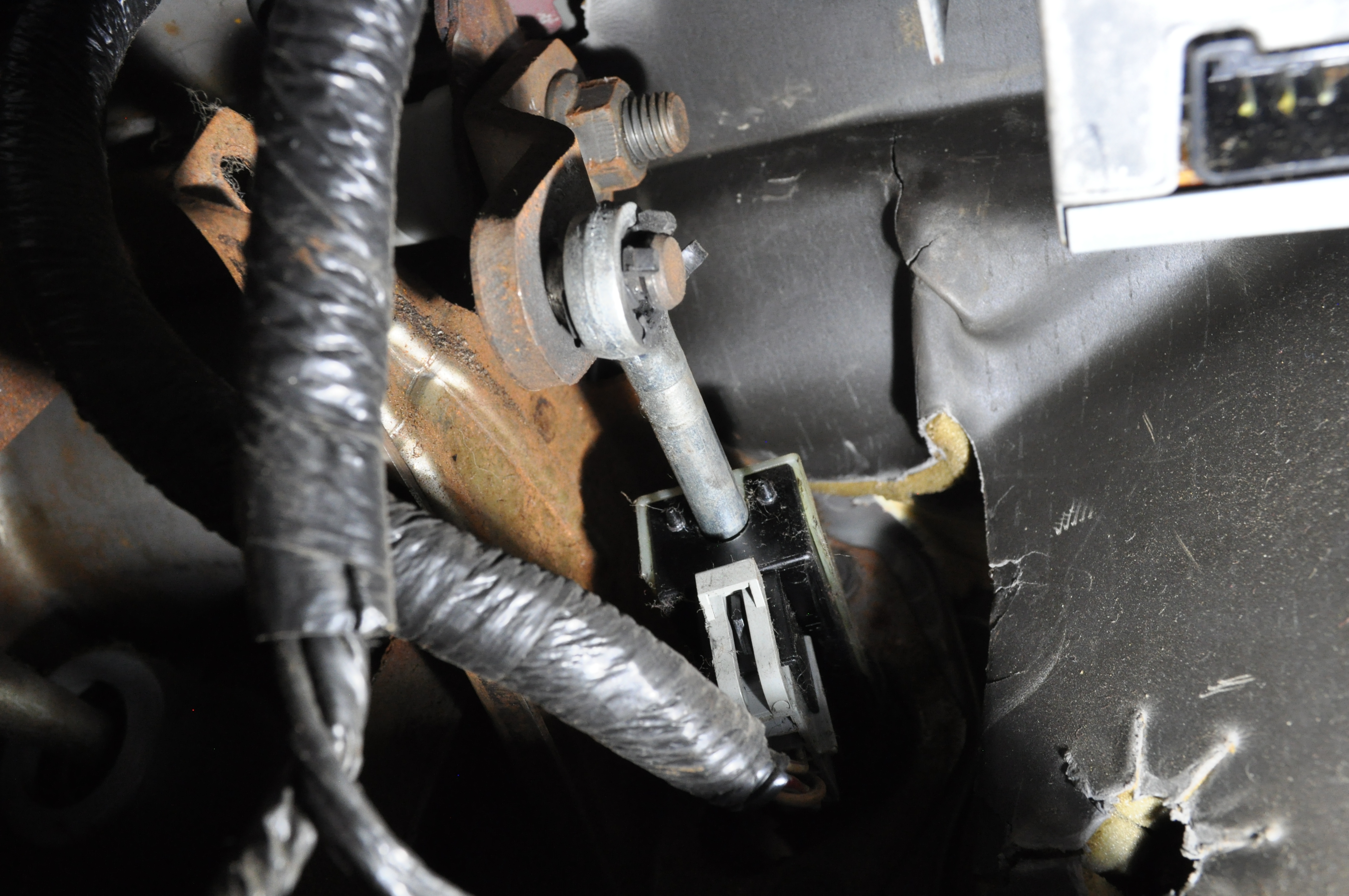

this is the major culprit.. prolly a 1/4" of movement..
full
that black bushing is toast... but a new one will be fugged in 6 months most say.. thats the rod end mod... you chop that master rod that goes thru the neutral safety switch right before the round part... them you slip a smooth bored heim over it... you mod the new swing arm, to the left for the heim... than seat it back on the upper main shaft, cutting new splines.... the rod end stays in tension on the end of the rod.. no threads...
the prob lies in this shot.. the end of the white upper shaft bushing that rides thru the bracket is wasted.. so that actually gets a bit of movement too... much less severe... but i don't want it to now be getting shredded with the new heim mod tightening up the rest.....

not sure if it can be done with the bracket in place.. not a lot of shifting room up there... booster and master may need to come out..

You did say you weren't real sure about the clutch feel on it.. Guess you were right. Good find. Wonder if someone makes a brass bushing that could be put in there rather than a rod-end. Brass may be more trouble free in the long run... maybe...
my understanding is the rod end is an end-all fix for it... last forever solution... bit more involved than just replacing the plastic bushing fo sure tho..
