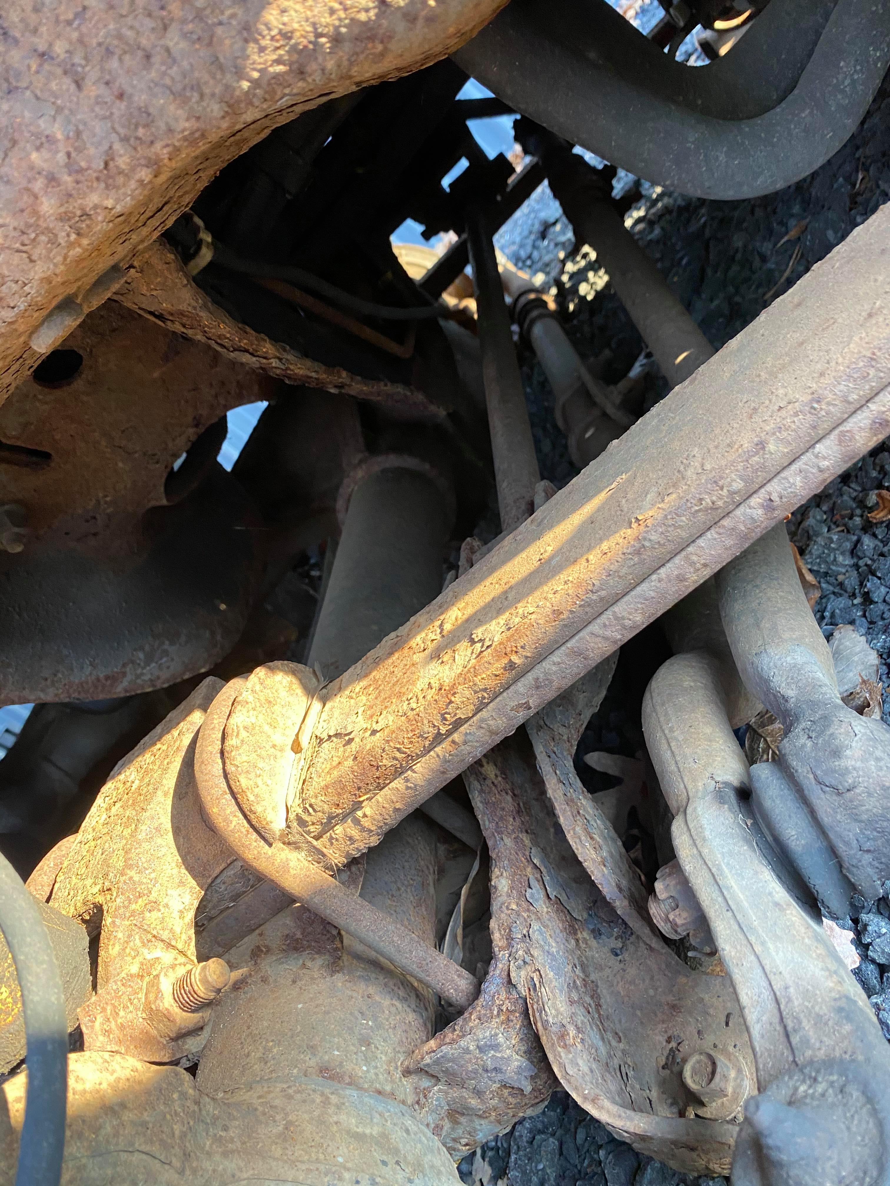

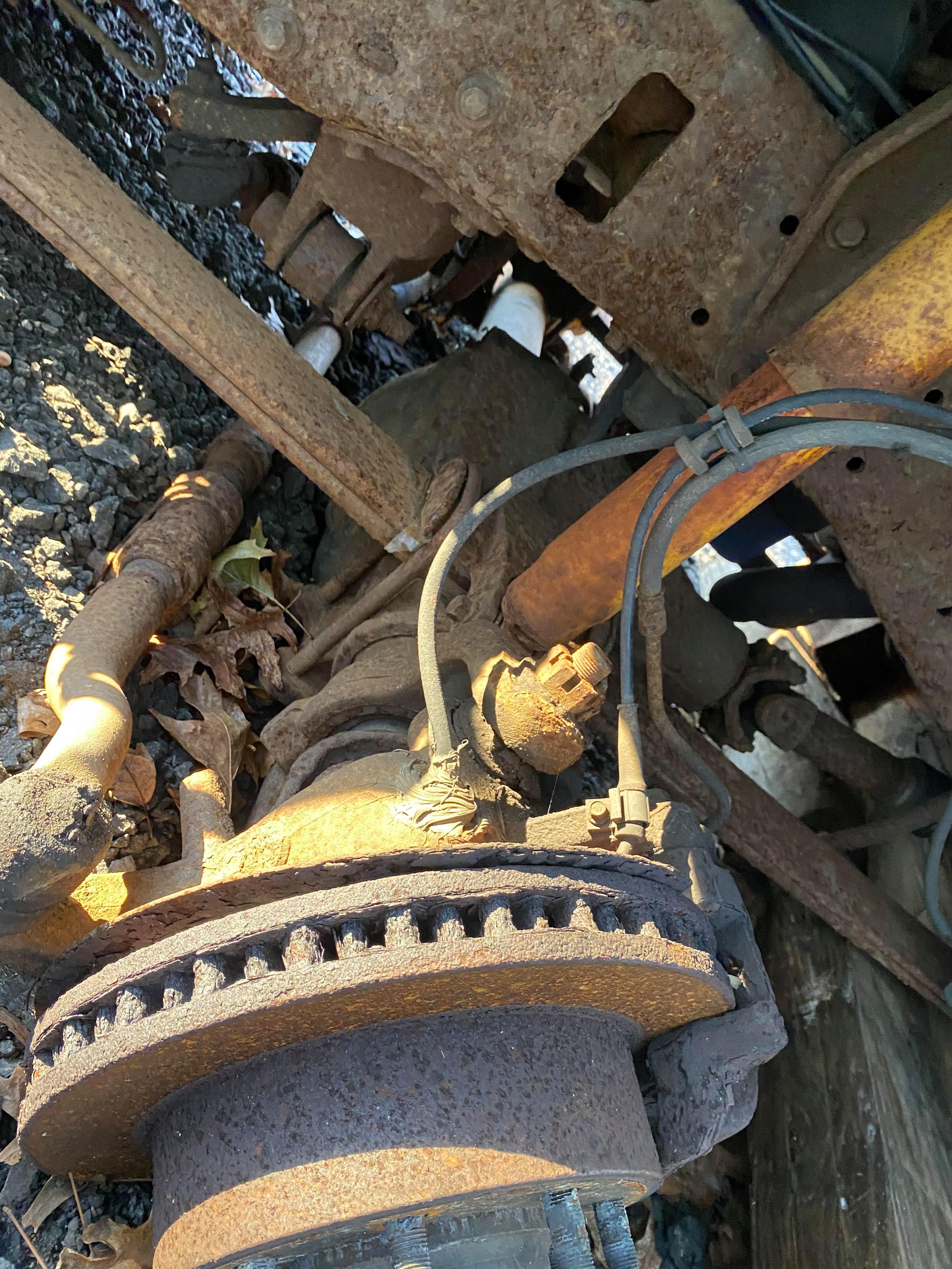

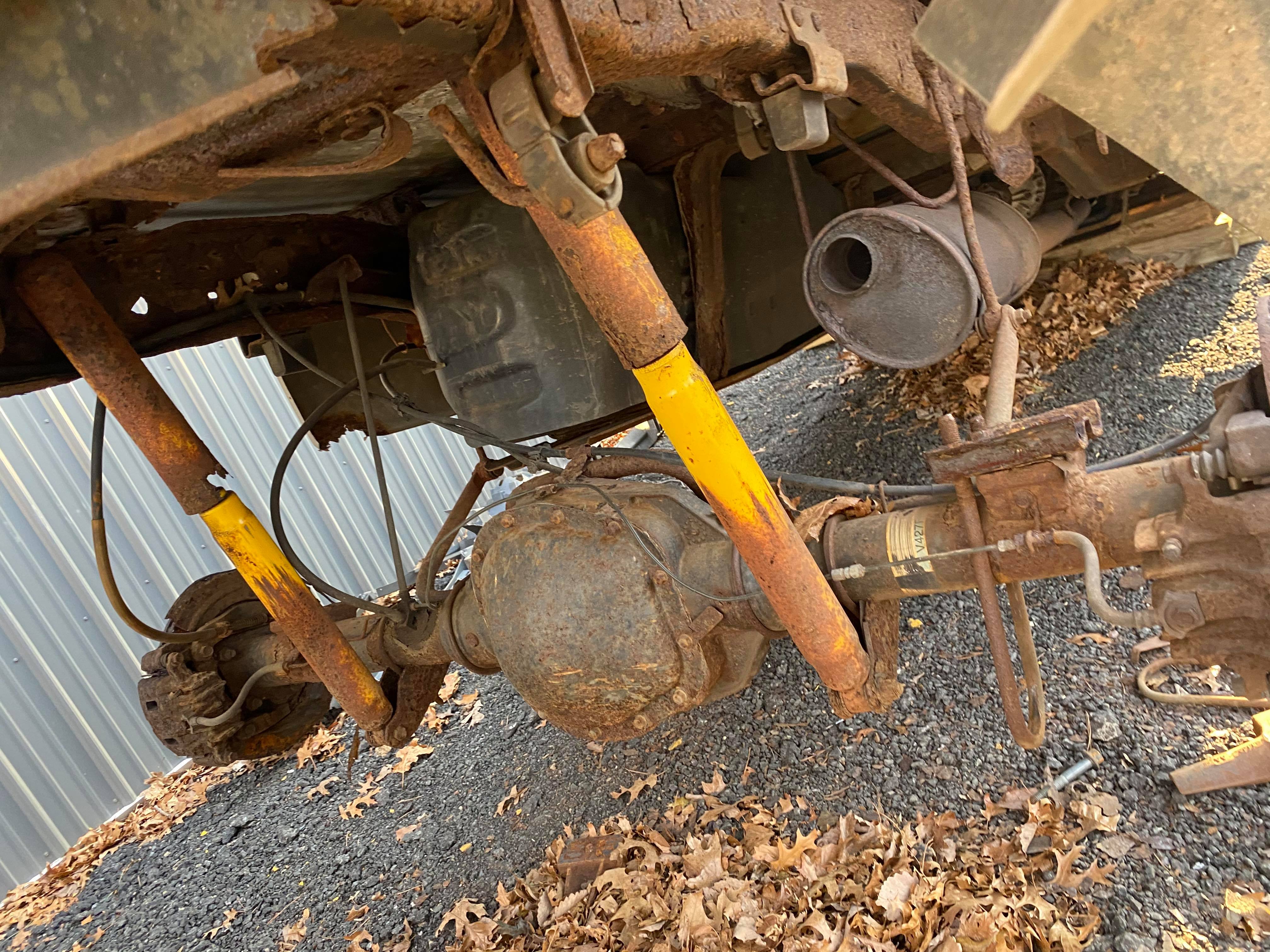

these are out of a super duty, isn't that a 60? here's pics.. he wants $700 for the pair....
full
full
full

I found my D60 from an ‘04 F350. There’s a cast gusset on the pinion that makes it easy to identify
Dana 50
Dana 60
he says it's a 60.... these will be good pics to verify, thanks.....

I paid a LOT more for a D60 a couple of years ago. The one you're looking at had a lot of rust on that thing but it was all in places that can be replaced... Seems pretty cheap at $600. But again western US the D60's get a premium.

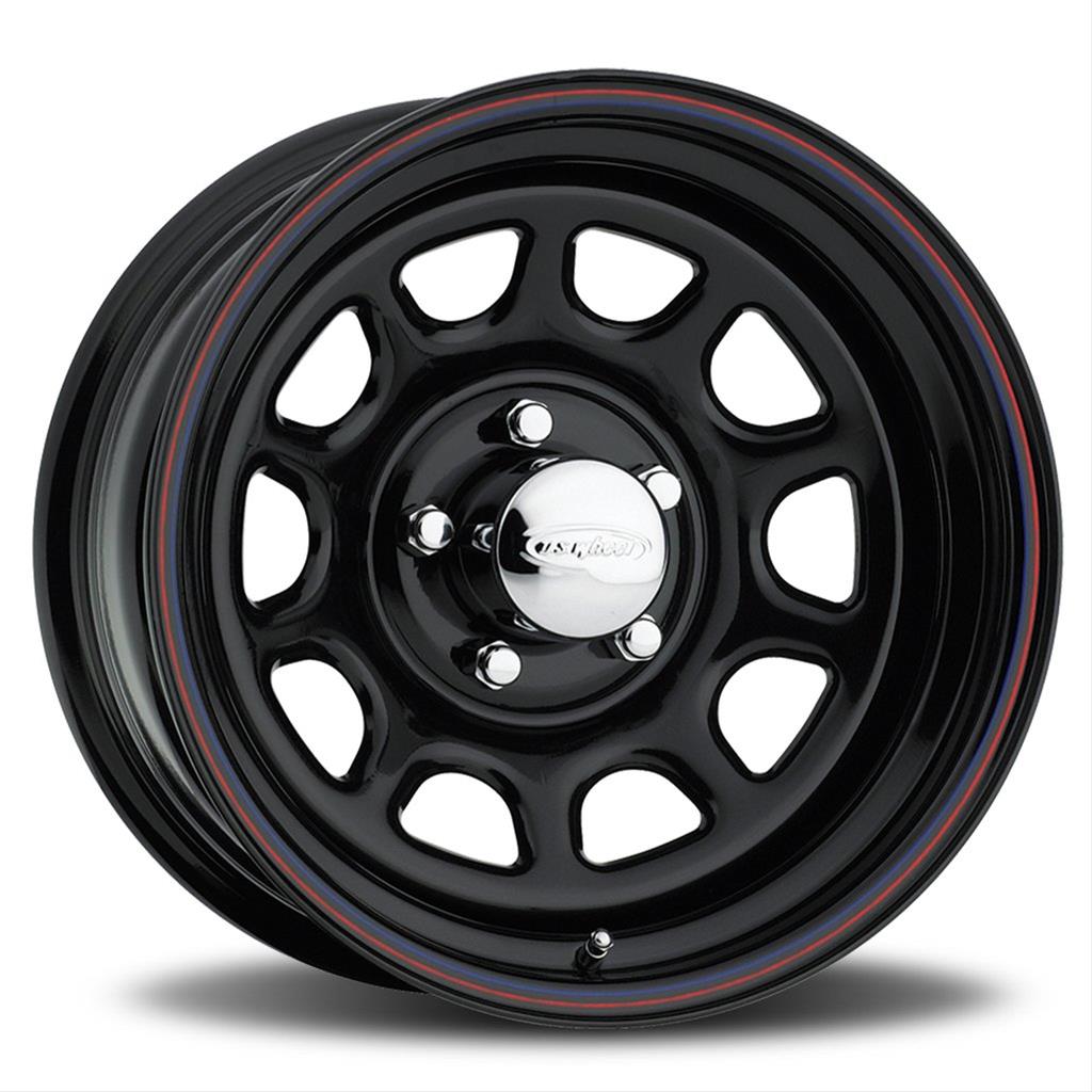

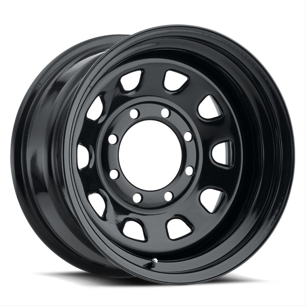

so, after looking around for a bit... the best 2 choices i can come up with are 2 different D-window style steelies... one 16 x 10 and one 17 x 9.. of course, i was kind of liking the idea of a 16 x 9... ;)
i really like these better with the smaller D window and the 9" wide... but i am a sidewall guy, so the 17 is a bit of a turnoff.. tho after looking at some images, it isn't horrible...
these are actually by a company Vision... https://www.summitracing.com/parts/vsw-84h7970ns
I'm thinking I would keep the argent theme and paint them....
the other choice, the 16 x 10 is a U.S one... https://www.summitracing.com/parts/usw-84-7087
bit bigger windows.. but either would work, just really down to tire size.....
which is a bit conflicting to the rim size.... the 17 x 9's actually call for a wider rim... but either is doable...

ah, that sucks... just looked at summit.. they ain't got sh*t for steelies.. all round hole or D-window daytona looking stuff.. definitely not the look i was going for...
If you need to replace the hub/wheel bearing units, you can buy ones with 8 on 6.5 or you can redrill the stockers.
