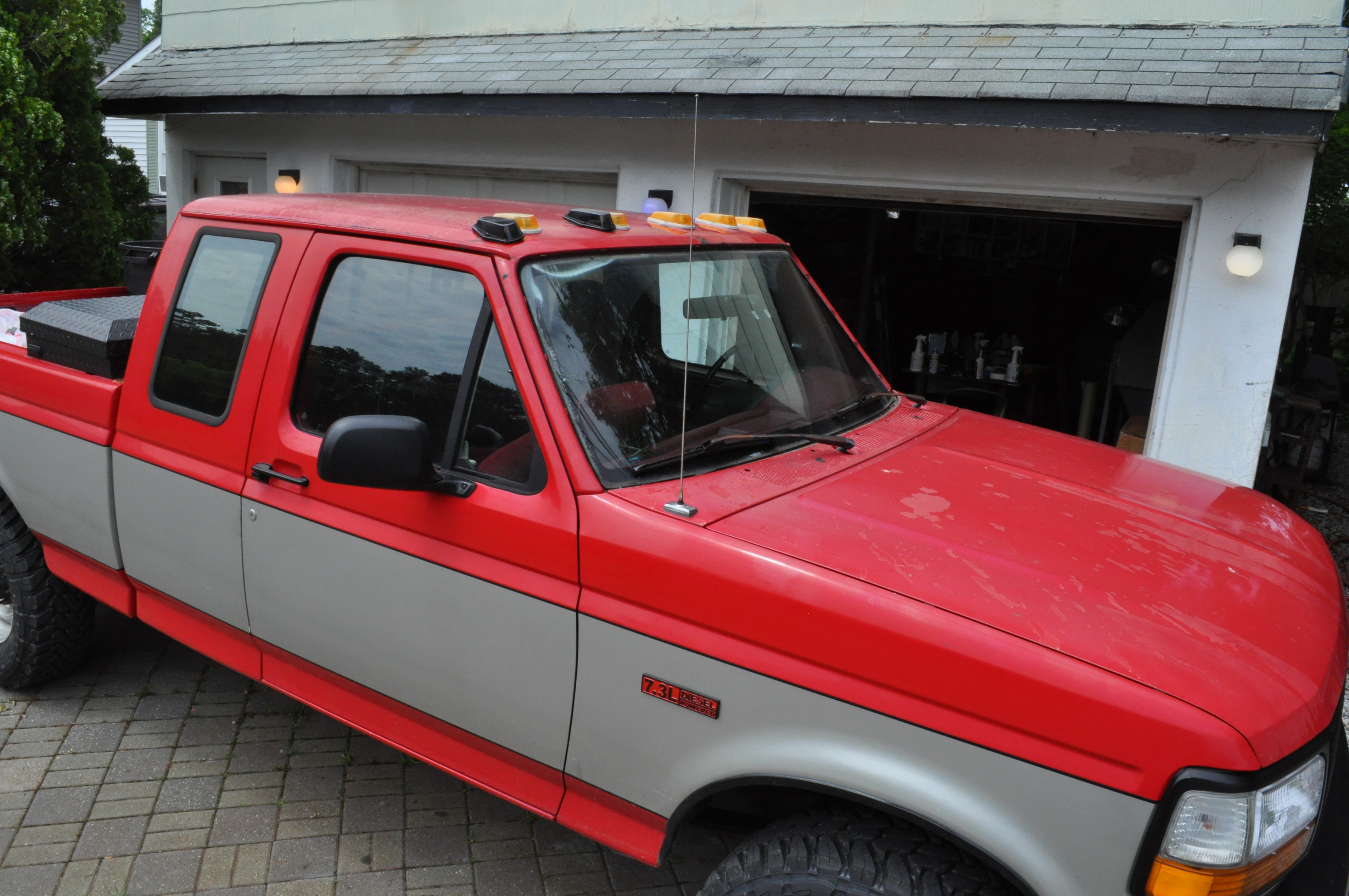

boredom Google image hunt thru trucks... I finally came across another rig with the same color combo deal going.. certainly looks like it could be argent... i'm guessing it WAS an orderable combo...

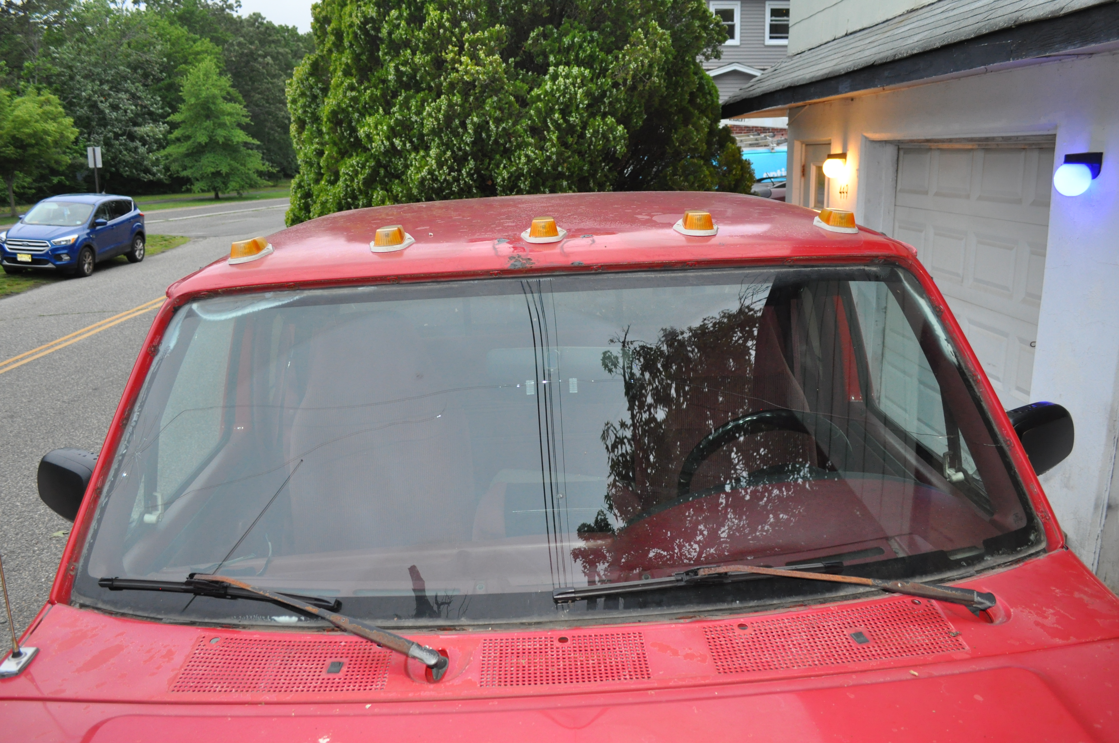

but I'm so glad I started heading down the "put a windshield in" mode...

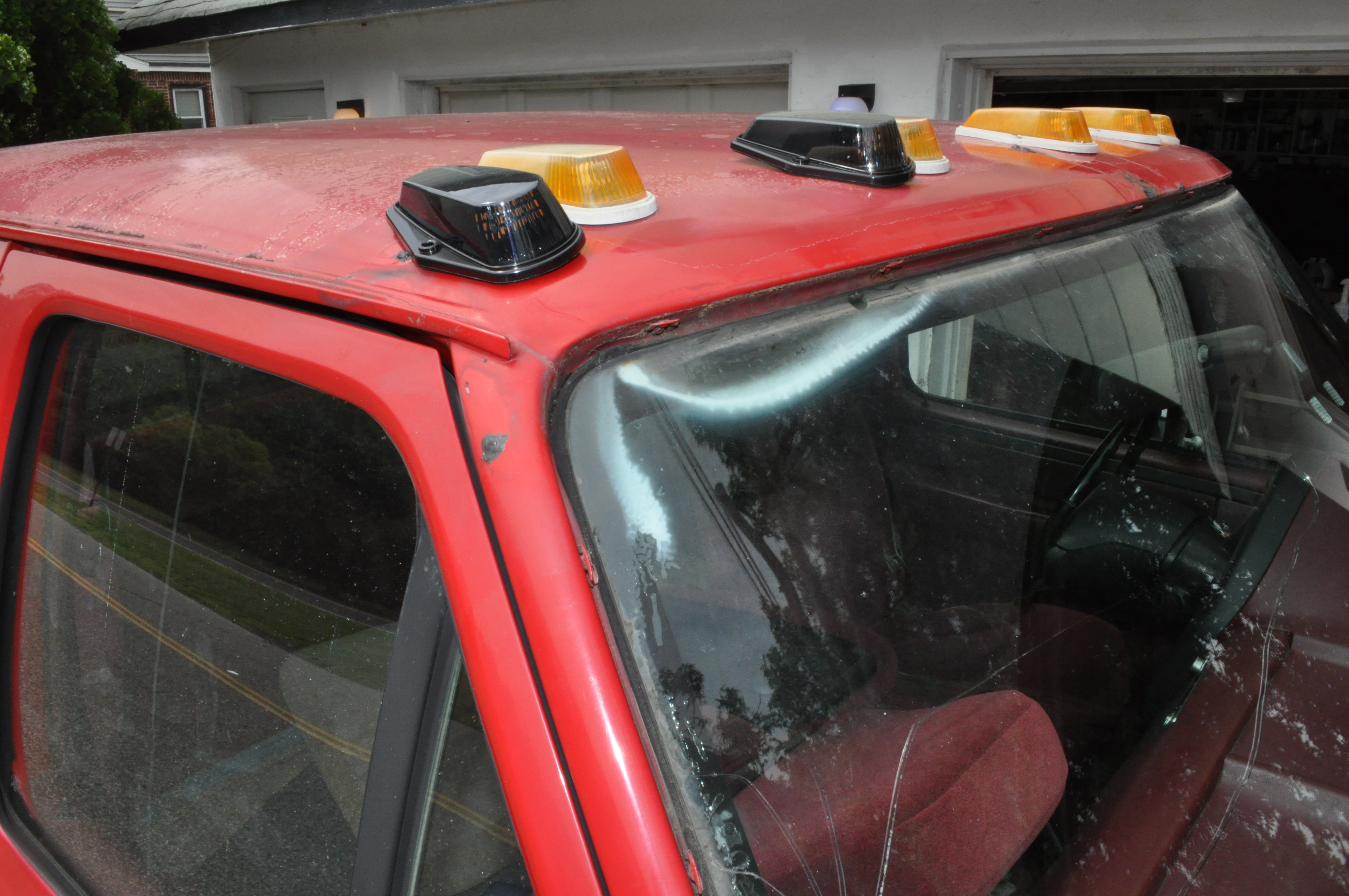

caught that rust starting, etc.. TONS of debri under the upper and lower molding.. but NO rust, other than the 2 holes for the visor... glad to have gotten that all cleaned out...
I'm just gonna do the bodywork, prime and paint.. the roof, A-pillars and cowl..... for now.. later in the summer i'll do the hood... so i'll be getting a qrt of red next week...

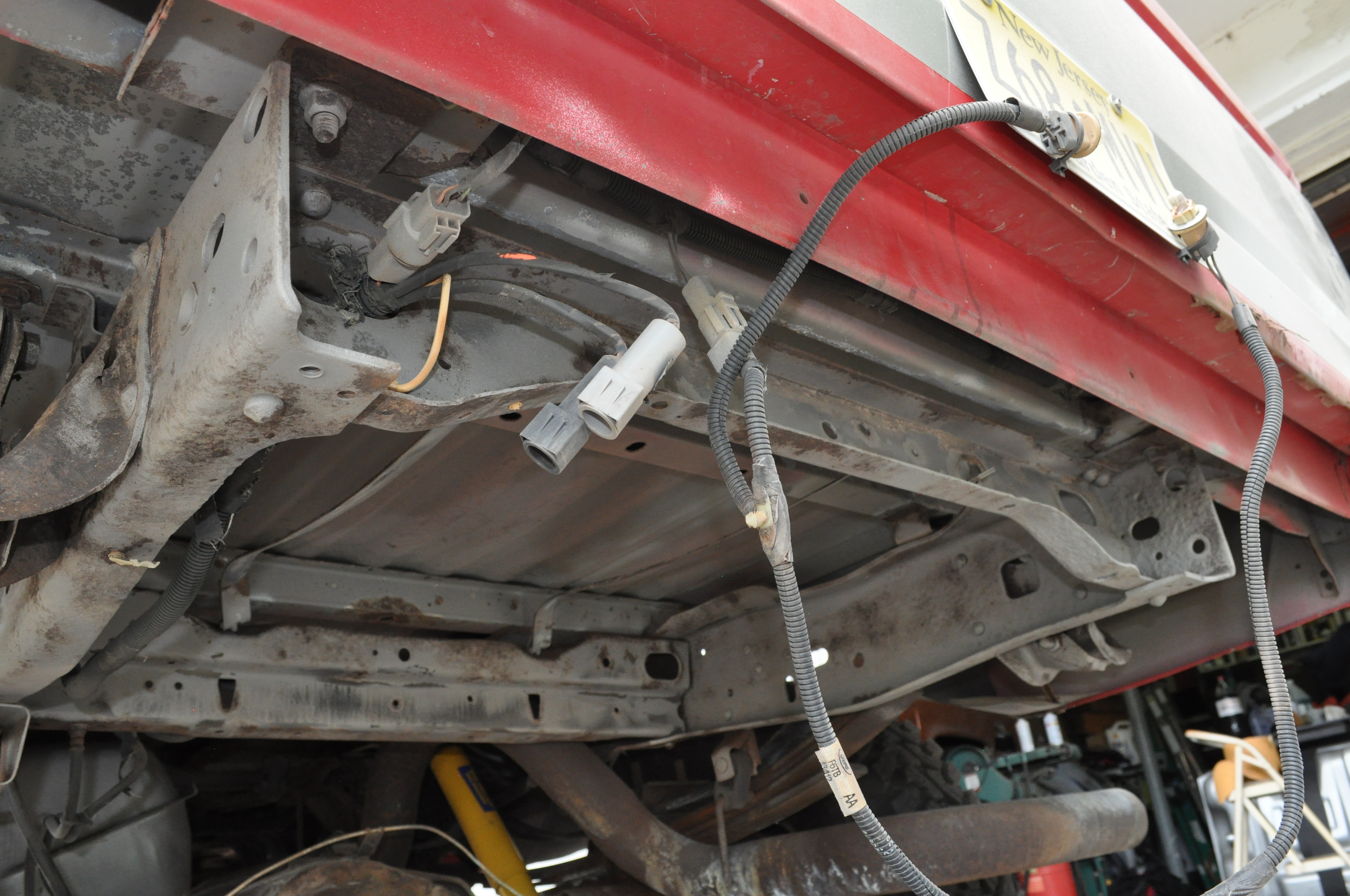

tank fought a bit harder than the front... had to torch the mount bolts... eventually had to cut the return line.... i'll just bubble flare the other end and run dizzle rubber...
the odd thing is, the tank has those upper straps pictured (which aren't apparently available.. not pulling em, the front nut/stud setup will snap, etc, too corroded to save......)
but the lower mount is strictly the 2-piece skid plate, above the spare tire... when i ordered parts from jeffs, i got lower "straps" with the tank... it looks like they ran one, or the other.. maybe depending on spare tire location?
I'm inclined to reuse the skids... couple hrs in the blast cab, prime/paint, new anti-squeak...
tomorrow, i'm gonna start hacking out spare tire mount brackets and hardware.. maybe pull the back bumper....
the rails are gonna take a bit of work... :whistle:

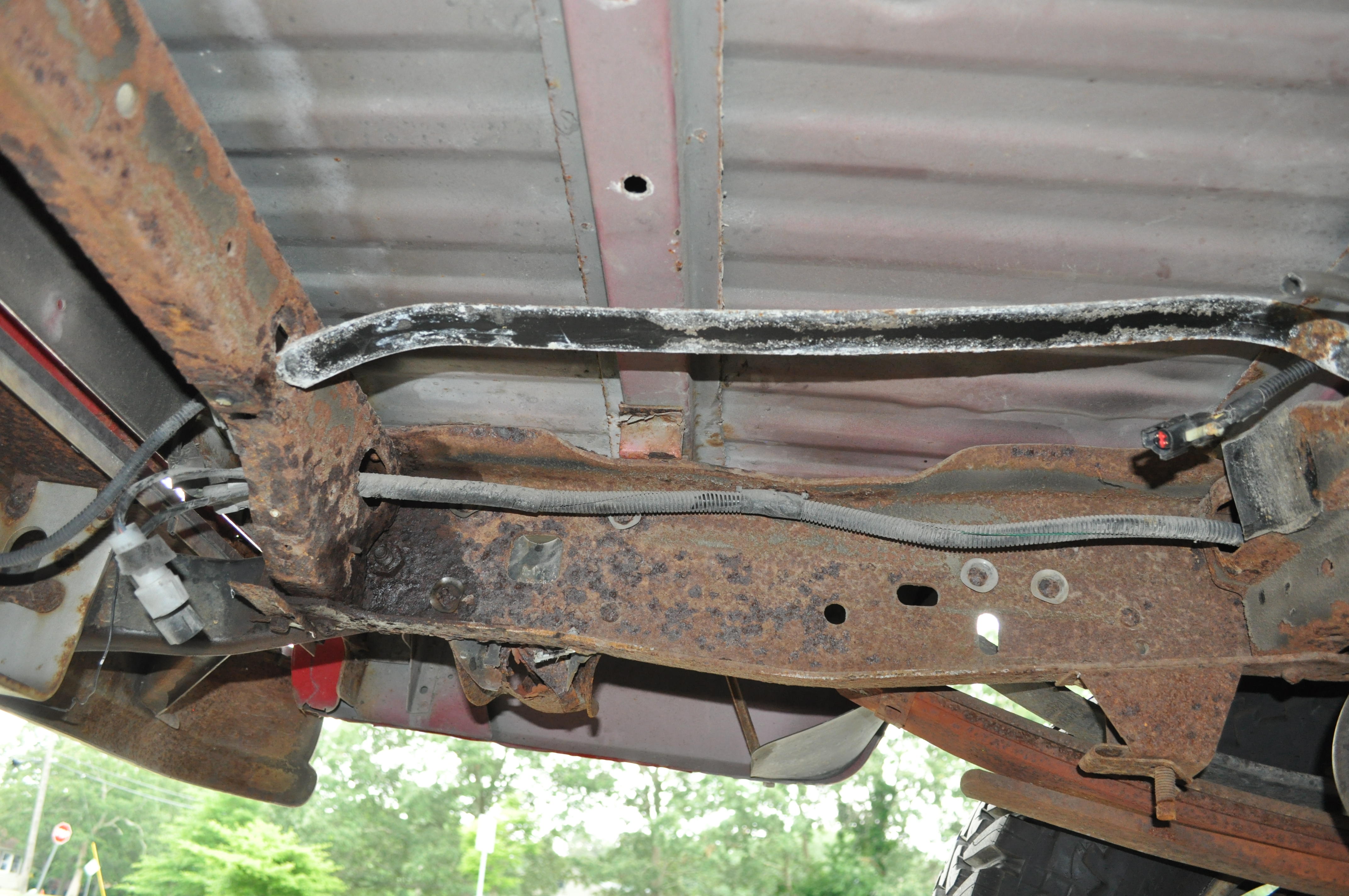

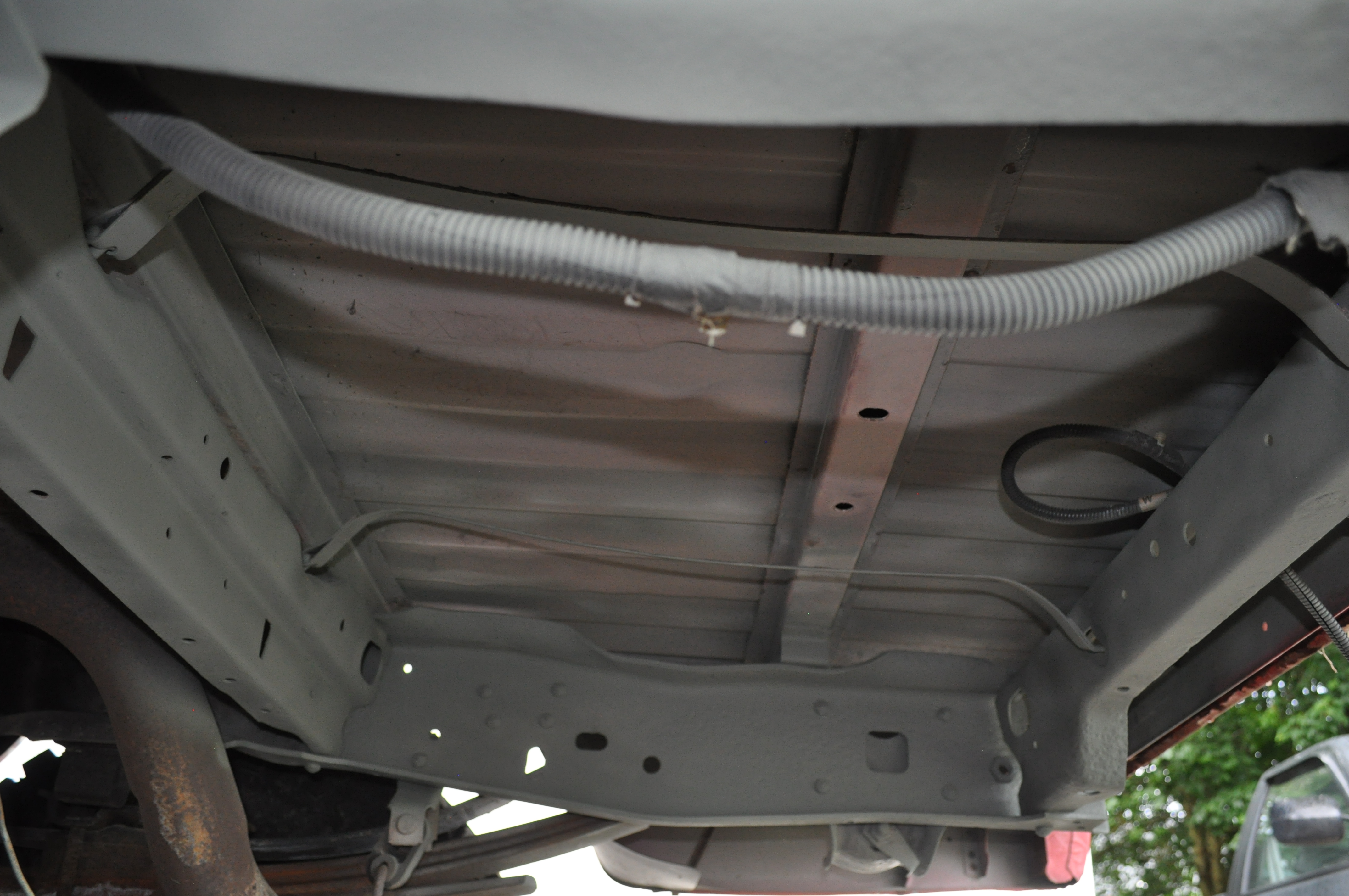

Crazy how the frame is crusty but the underside of the bed is mint.
Look under any 5+ year old GM truck in the rust belt, my 2012 included. Wax frame coating all pealed off and left exposed metal to salt/elements. Frames look like they've been to the bottom of the ocean but the body is still mint.
I think Ford used some kind of E-coating. Apparently it didn't hold up well either...
that back, 2', 3' is by far the worst area of the frame... makes senses I guess, sh*t getting thrown up there..
they wont be perfect without taking the bed off, but if i can "stop" the progression and get 90% of the area cleaned up, i'll be happy... hopefully i can get the blaster working ok...

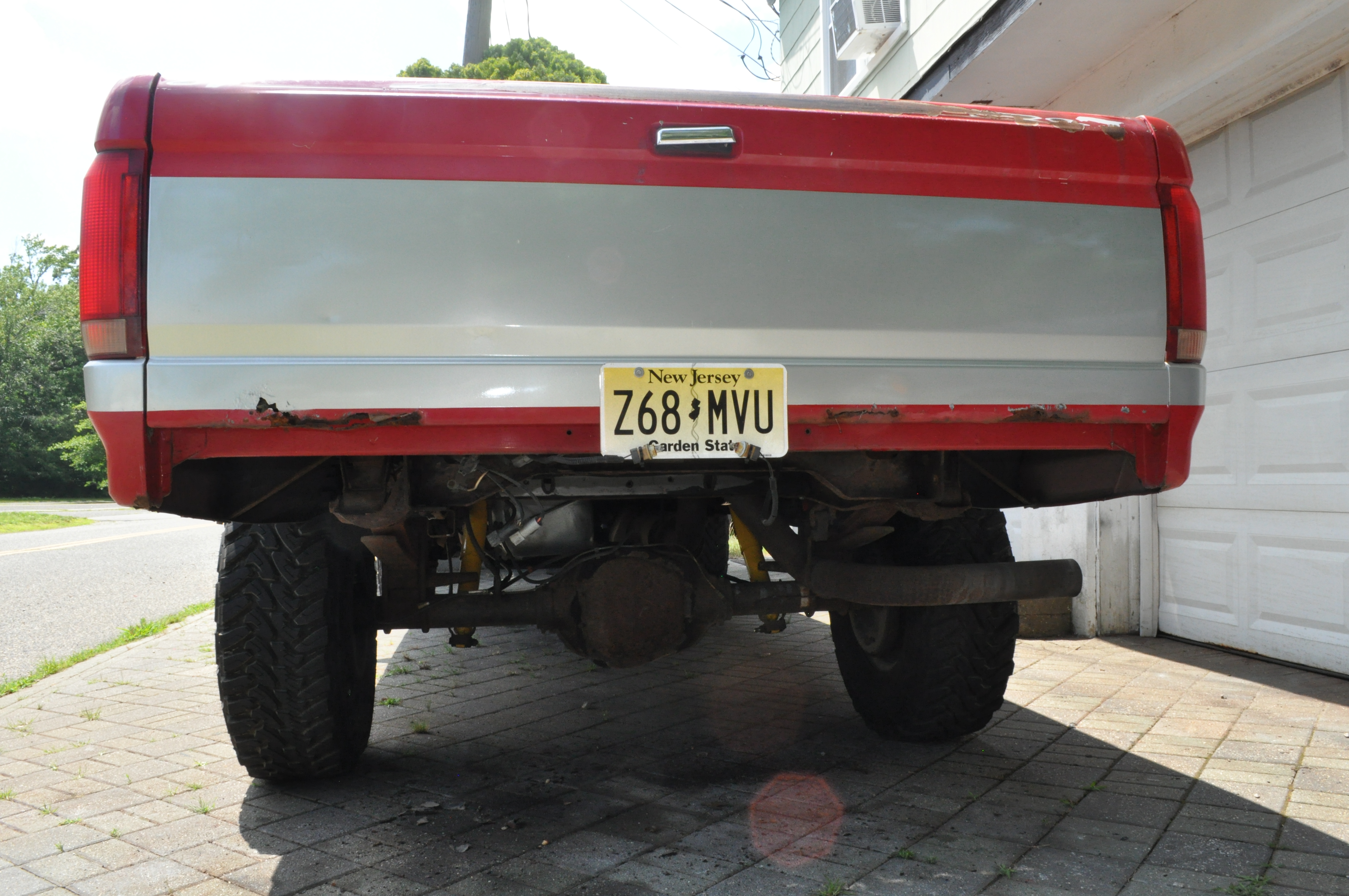

here's how the fUrd will be running around for the next month or so...

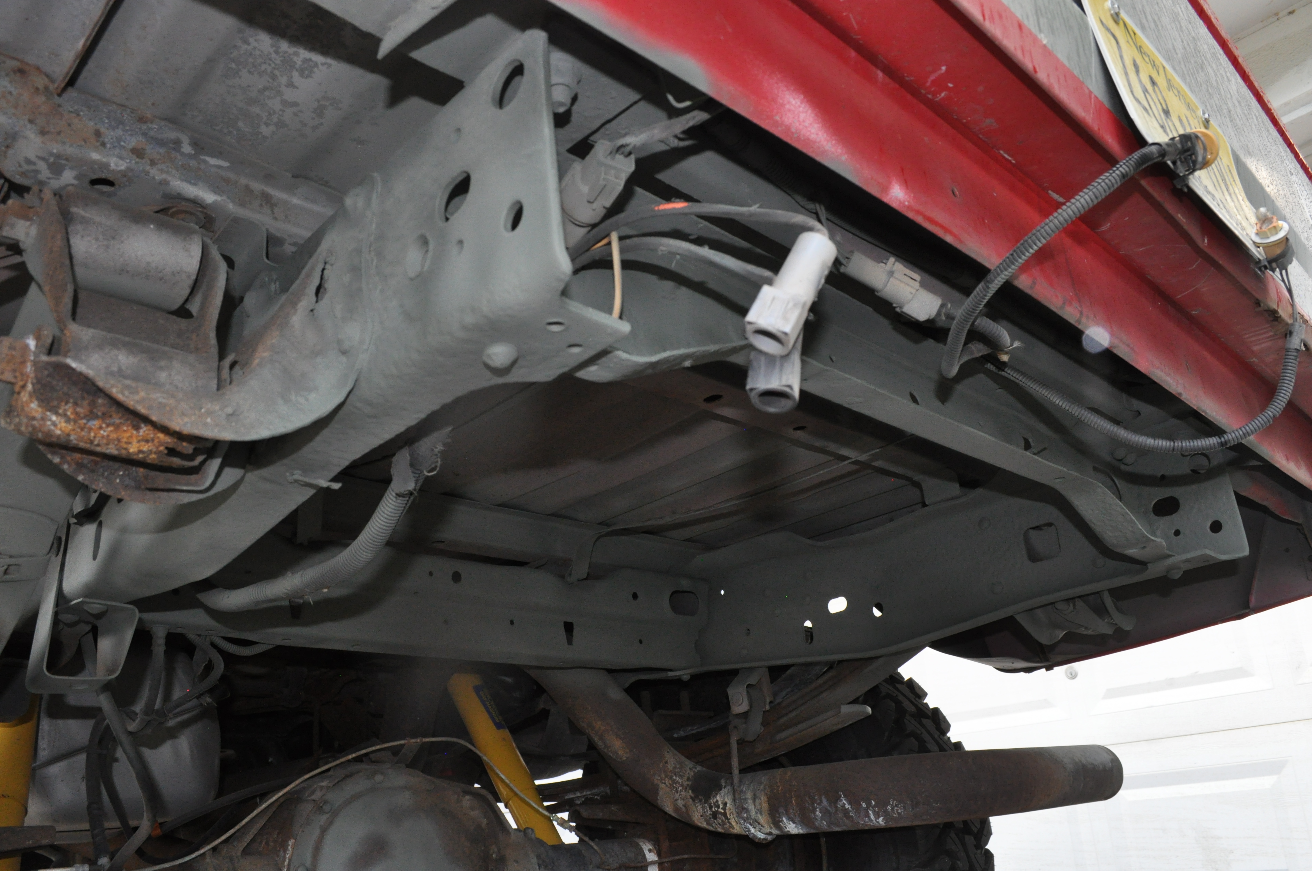

took fri afternoon off, fug boats..... :saweet: prepping to get the arse end as clean/raw as possible and in self-etch by the end of the weekend.. possibly doing the hangar bracket too........ and gasp, back into paint.. we'll see how that works out...
wire wheeled and acid washed the heck out of it this afternoon.. still damn hammered..
hopefully the blaster works reasonable tomorrow.. it really needs a new tip, but really don't want to drive 45 minutes one way to get a new one...

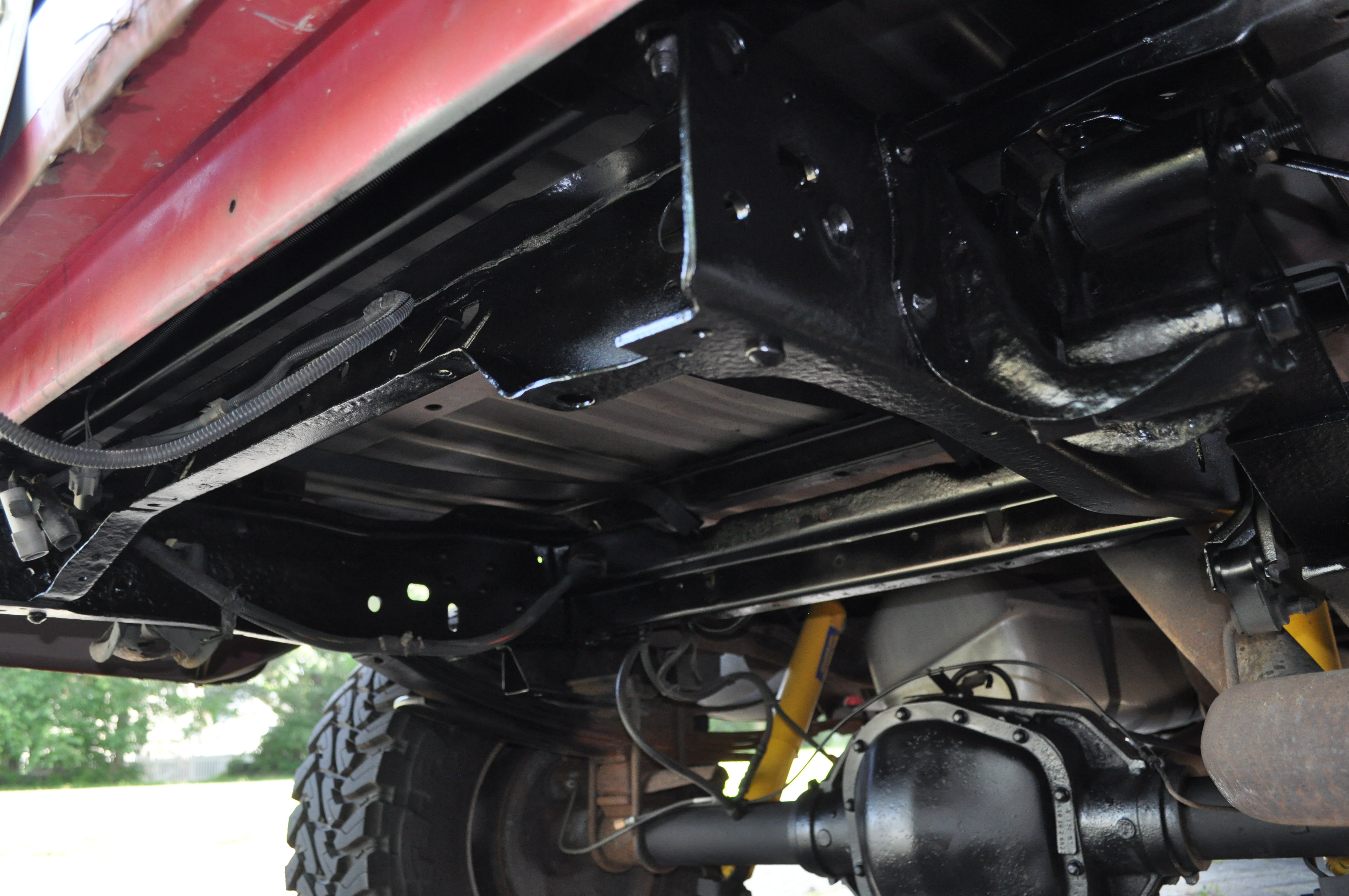

frame, etc is blasted and self etched...
no pics yet.. sumfin wrong with the camera.. think the cable is bad, won't upload... tomorrow, I'm gonna see about replacing the shackle hangar..... oh, and bumper is done, ready to go on. cleaned, ospho'd, sanded, etch, black... haven't touched the crusty skid plates yet...
tough going with the blaster today with all the moisture in the air...
full
touched that up with the wire wheel, roloc and DA.....
full
full
so... in an effort to keep things "even" in the rig and do pairs, like I preach to my boat customers, port AND stb, lol.. I decided to wait on the hangar and do the ps too before I put the tank in...... it's not too far behind the other one... I'll do both at once....
