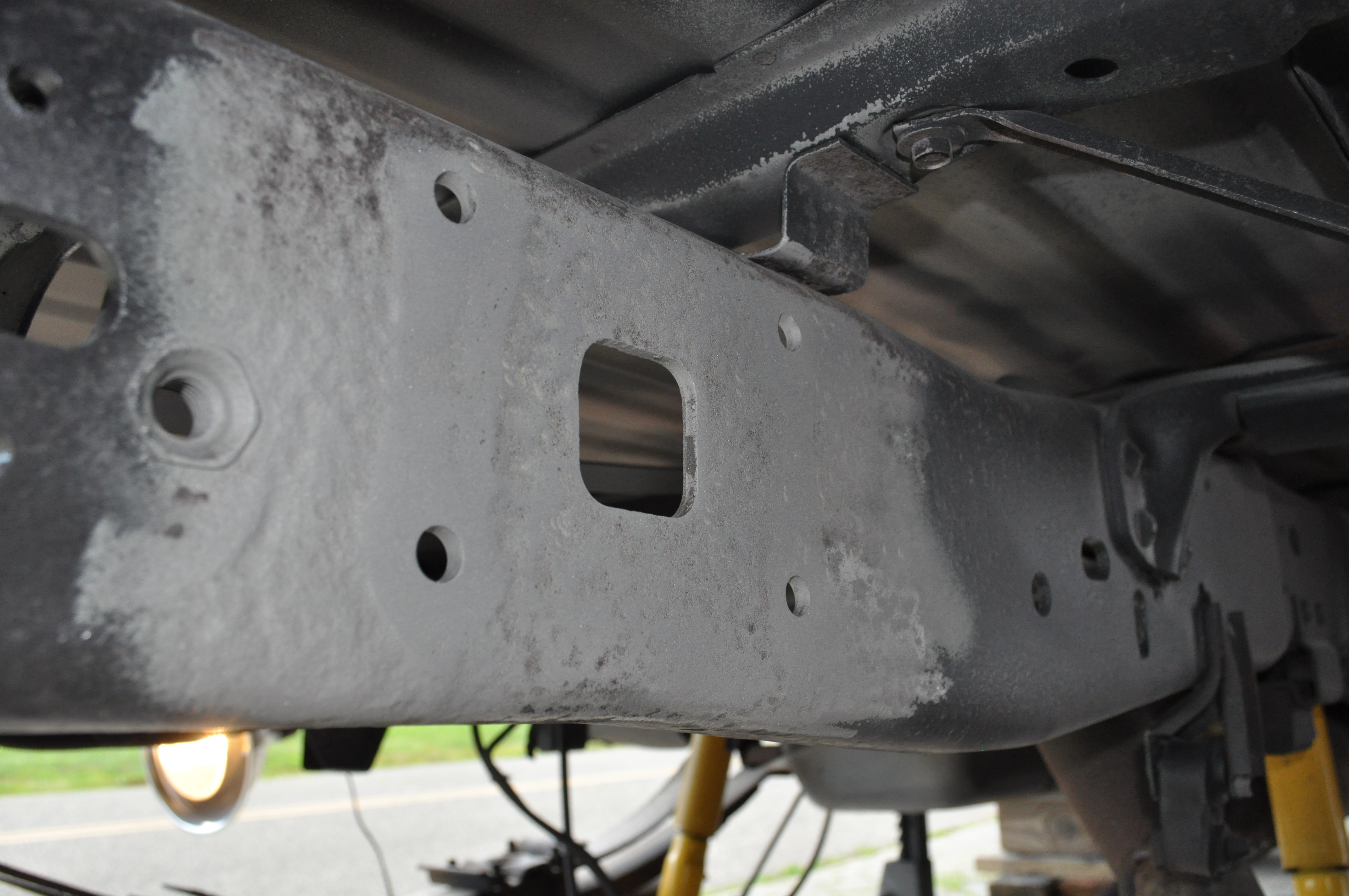

friggin damn blaster... an hr dorking around for 8 minutes of blasting... #perfectsteelprepOCD

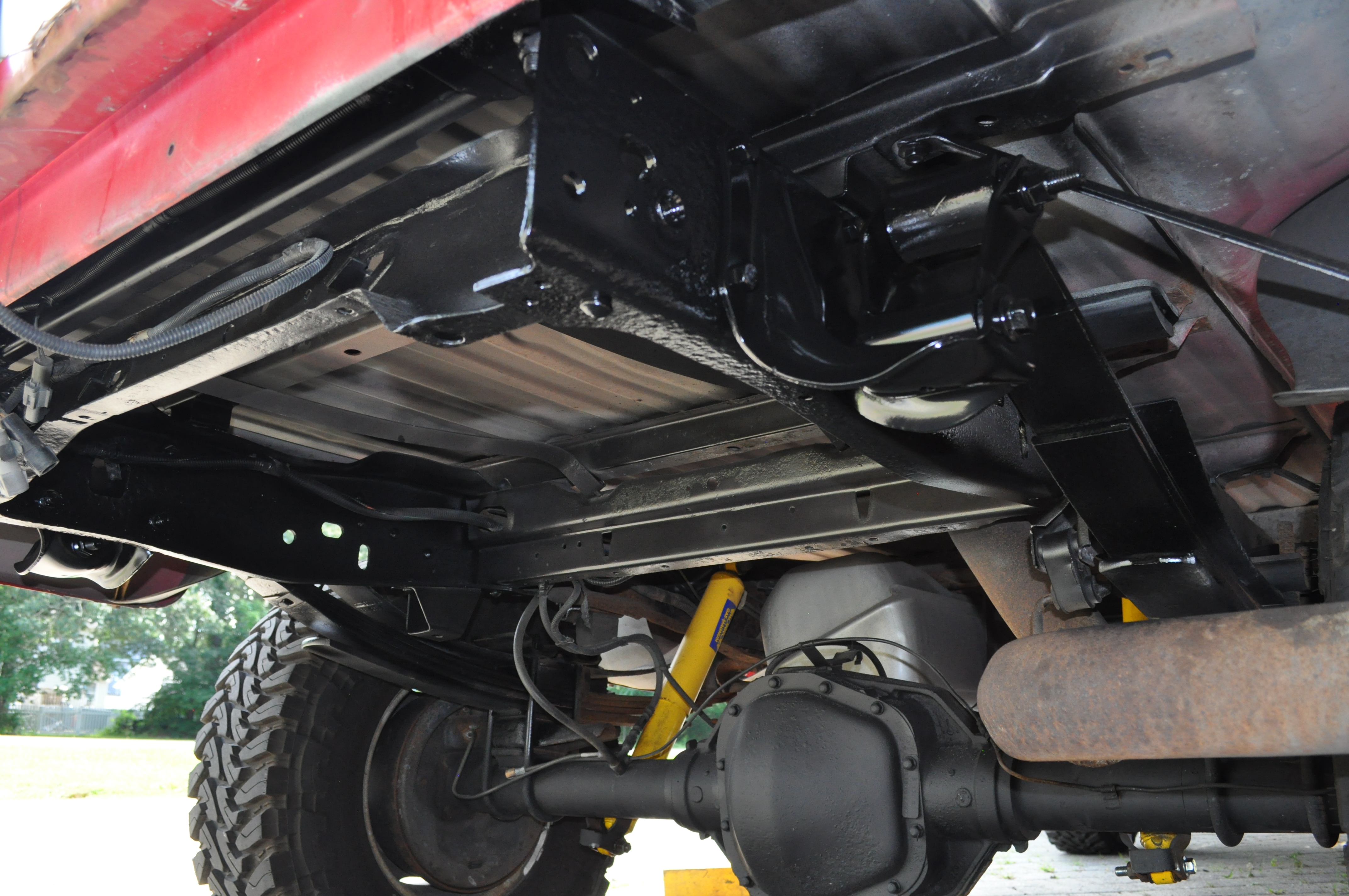

rivet work made me feel right at home like a cheby, so it was all very familiar... ;) new long barrel throws some snot...
didn't bother with the spring bushings.. they where sh*t and gonna be a nightmare to get out.. I'll leave them to be replaced when I do springs/proper lift at some point...
glad to be confident throwing a bunch of weight in the back of this without issue now... was starting to hear some funky noises back there... :whistle: want my dual tanks back tho, sooooooo...

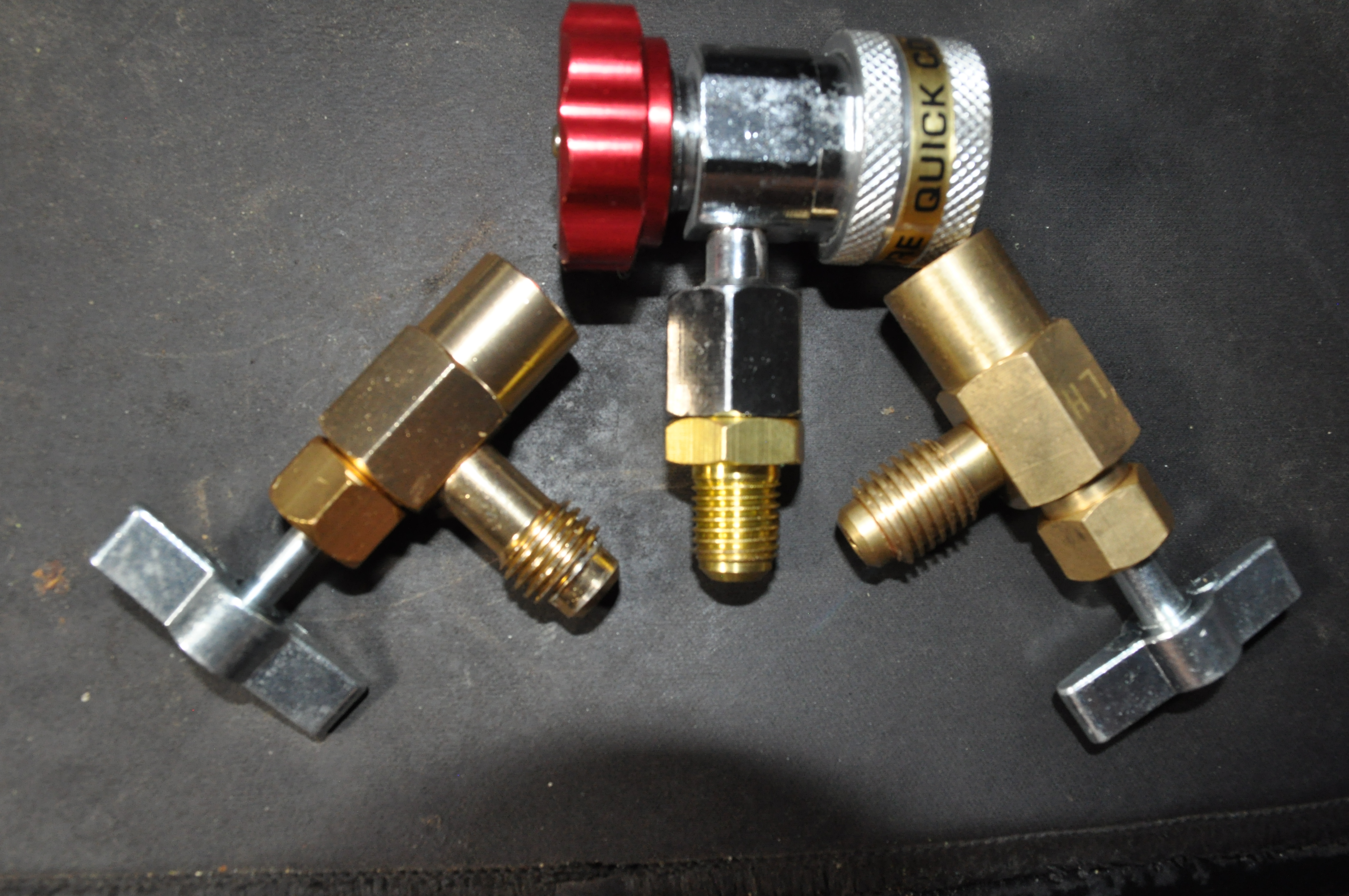

stopped at AZ on the way home to pick up a tap.. eesh, they have 1/2" LH and RH thread ones.. "eh, I don't want to come back, I'll cover myself and buy both"
neither one are right... they are too big compared to the thread the gauge set uses on the hoses...
anyone have any insight about this?
full
so it looks like they have adapters... wtf does it got to be complicated for? i don't see any can taps that go right to the 1/4 thread...

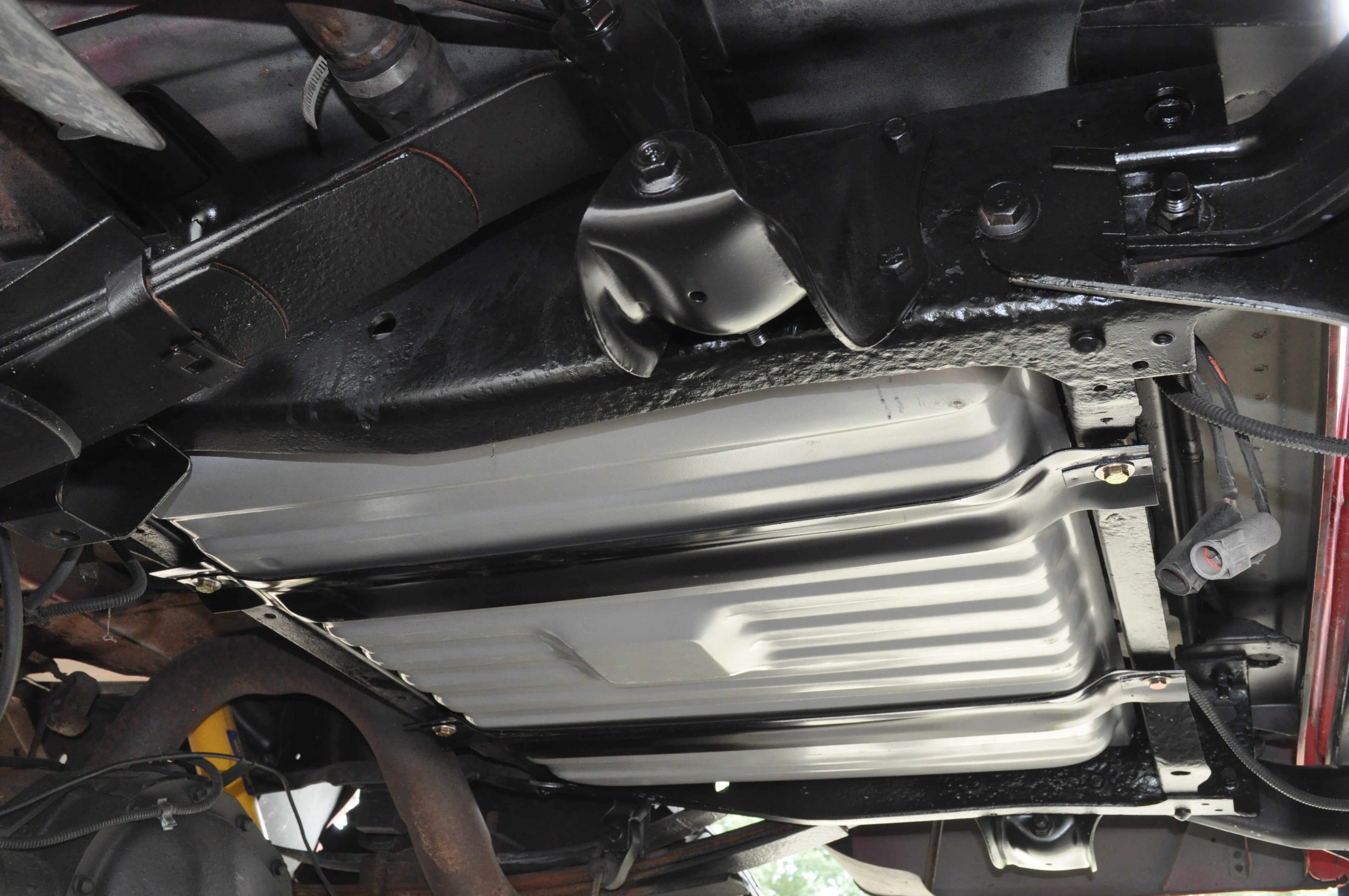

looking to bang some stuff out this weekend.. tank installed and filled... and maybe try to get the roof blasted and welded...
tank is in, full and functioning...
