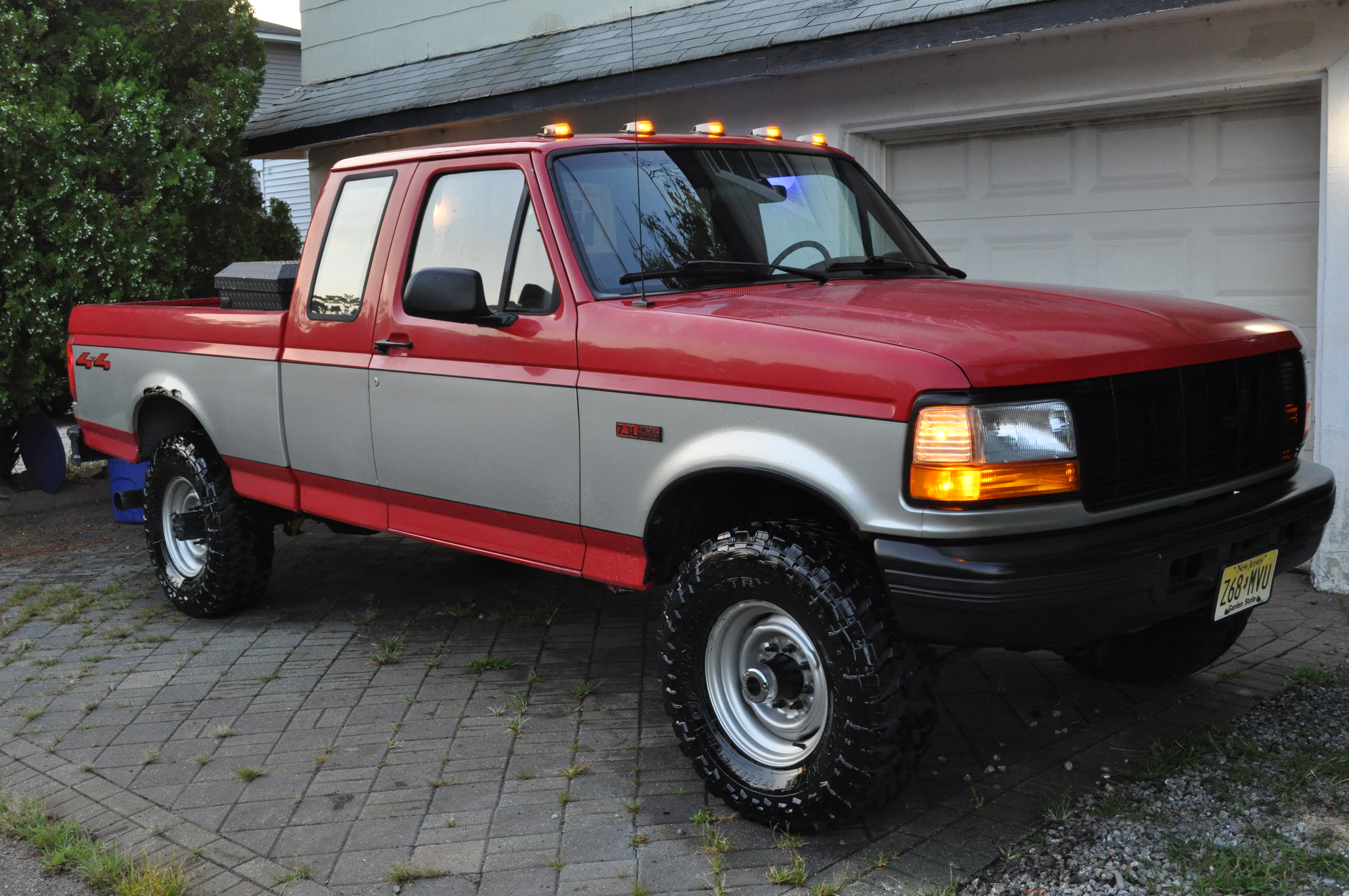

Ryoken's 96 Furd twofiddy
I'm a form over function guy.. Smoked would look more complete, but will loose a lot of light... UNLESS, you take some smoked light housings and put projectors in them...
They will never seal.... every aftermarket set of lights i've ever sold get water in them. Doesn't matter if they're OE replacements, Recon's, K-source, whoever. For some reason the glue they use or however they put them together sucks.
great info....
i do like how the front looks... i'm a fan of the amber lenses... that's why i did it..
i may try fresh all-amber lens up top at some point to see if it looks more match-y and good... cheap enough at $35... I have it so they just unplug... i just got into the "blacking out" moldings, etc mode and went for that.. and i do like the roof as is..
i think it would look good either way up front.. but I'm definitely leery of leaking and poor performance.. tho, I don't really do much night driving to begin with.. I'm old....
thanks for the input boys, I always value your thoughts.... :bow:
hopefully we'll be segwaying our interest back to Mutt in the "not too distant" future... ;)

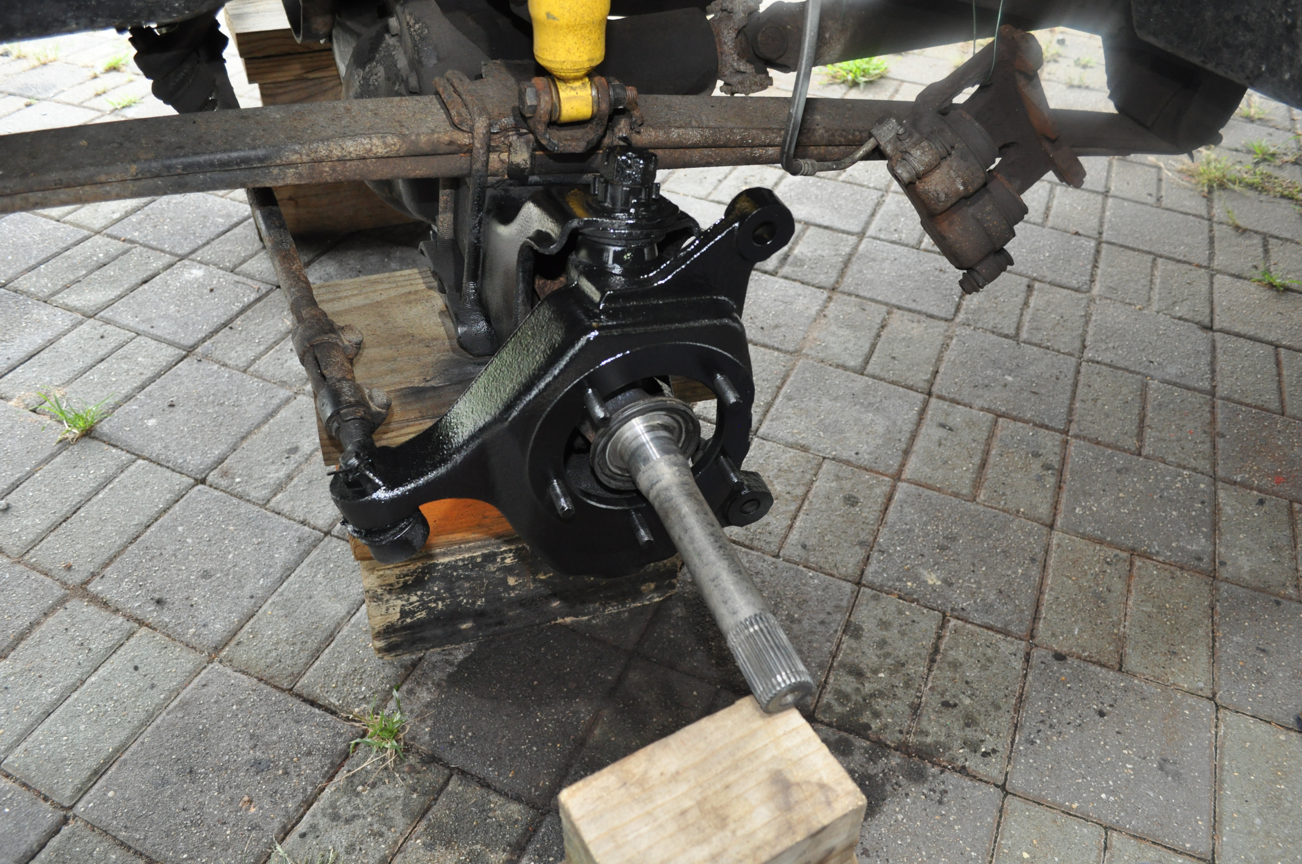

went one step further than i needed, by pulling the spindle and mud catcher off for cleaning/blasting.... wanted to exercise that stuff so i would know i can get to the u-joints or camber bushing if I need to get back in there... tell ya what, glad I did, that spindle took some beating to get out... tape, block o wood, sluggo, repeat x eleventy...... NOTHING has EVER been apart on this rig... but the BJ's seem nice and tight...

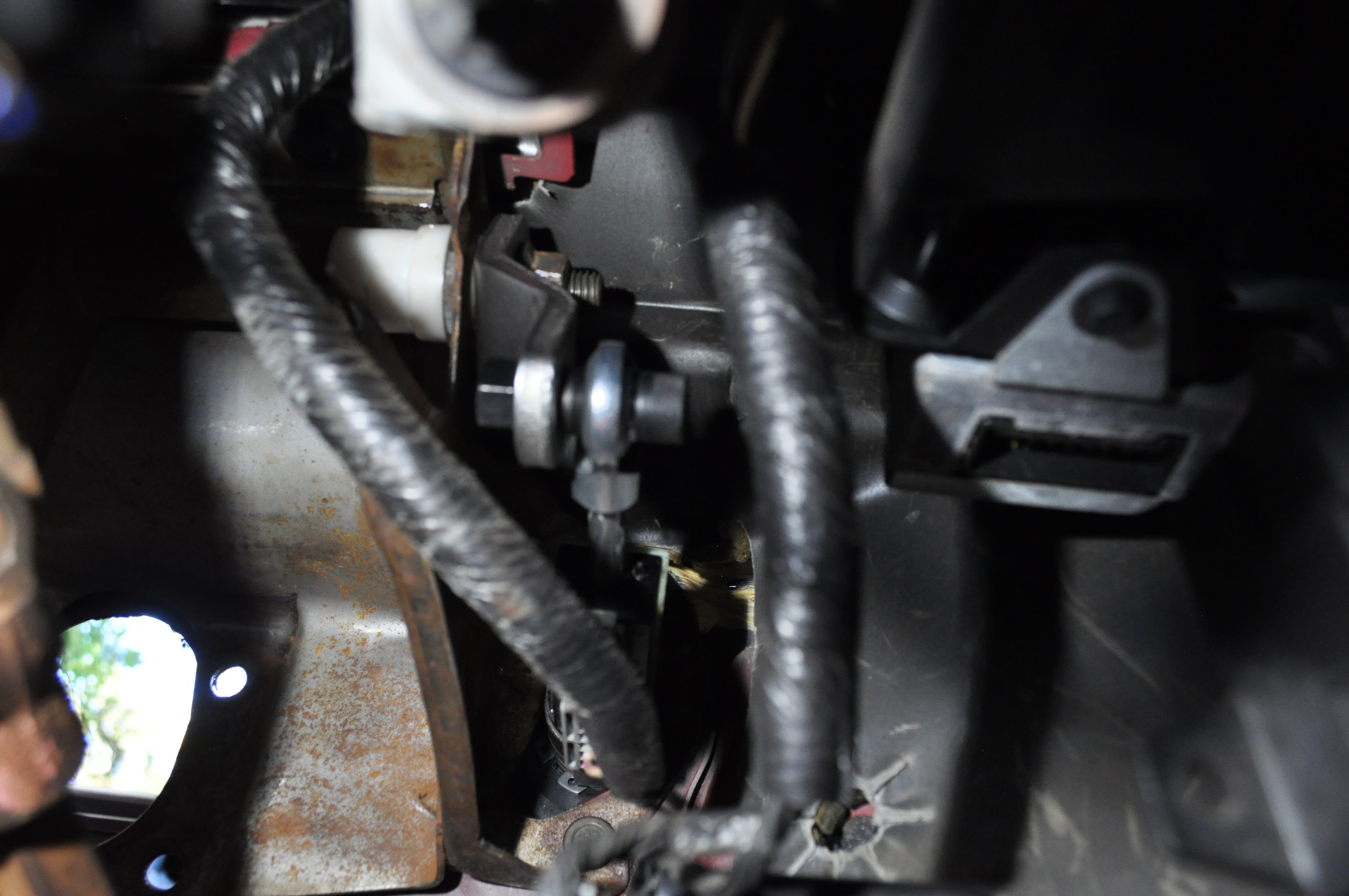

the pedal assembly can be taken out with the column in, barely....

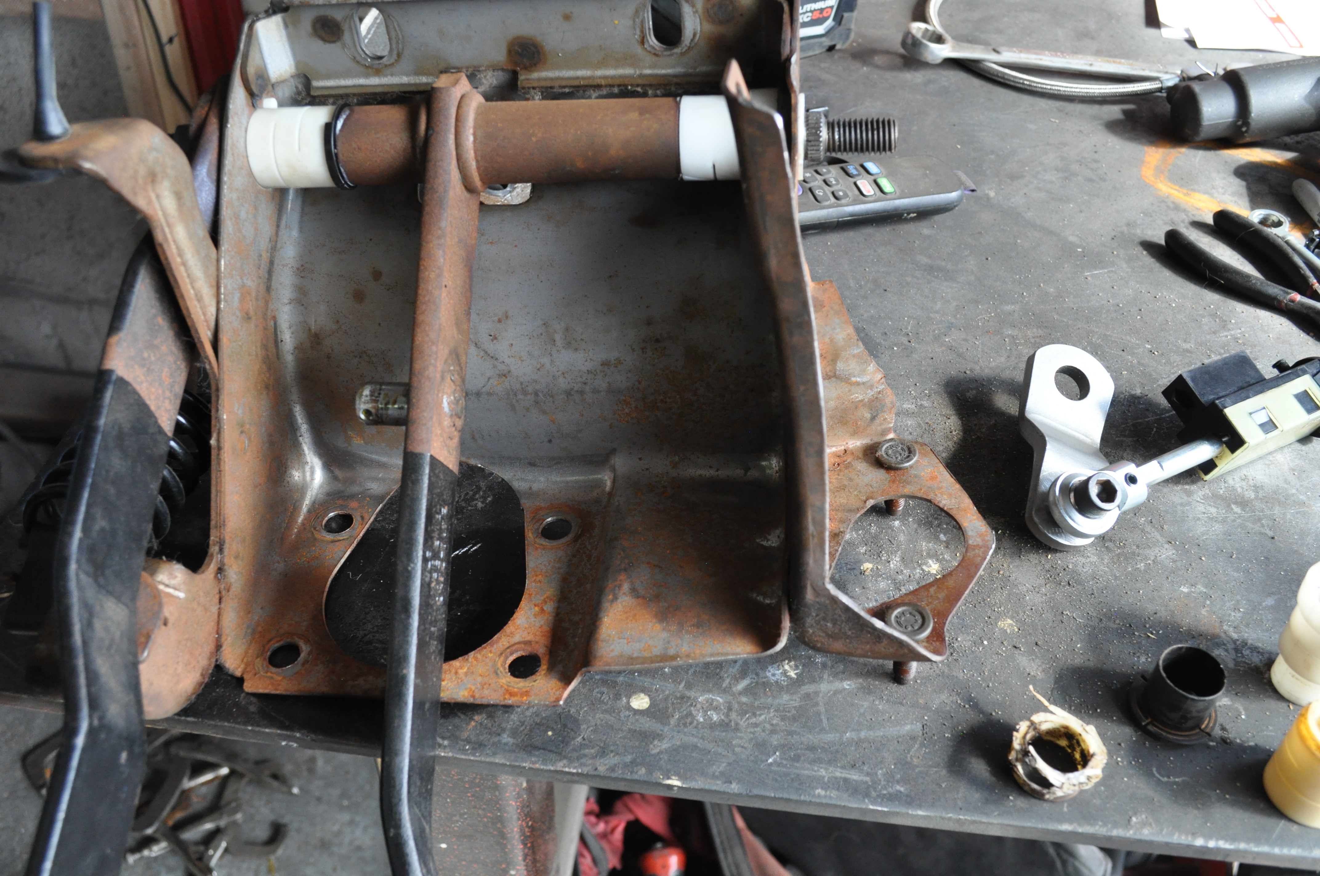

freshly rebuilt, you can see the one toasty bushing lower right... and the new modded hydro rod above that...
full
you get a new lever so it will make it's own, new knurl cuts from the end of the shaft...

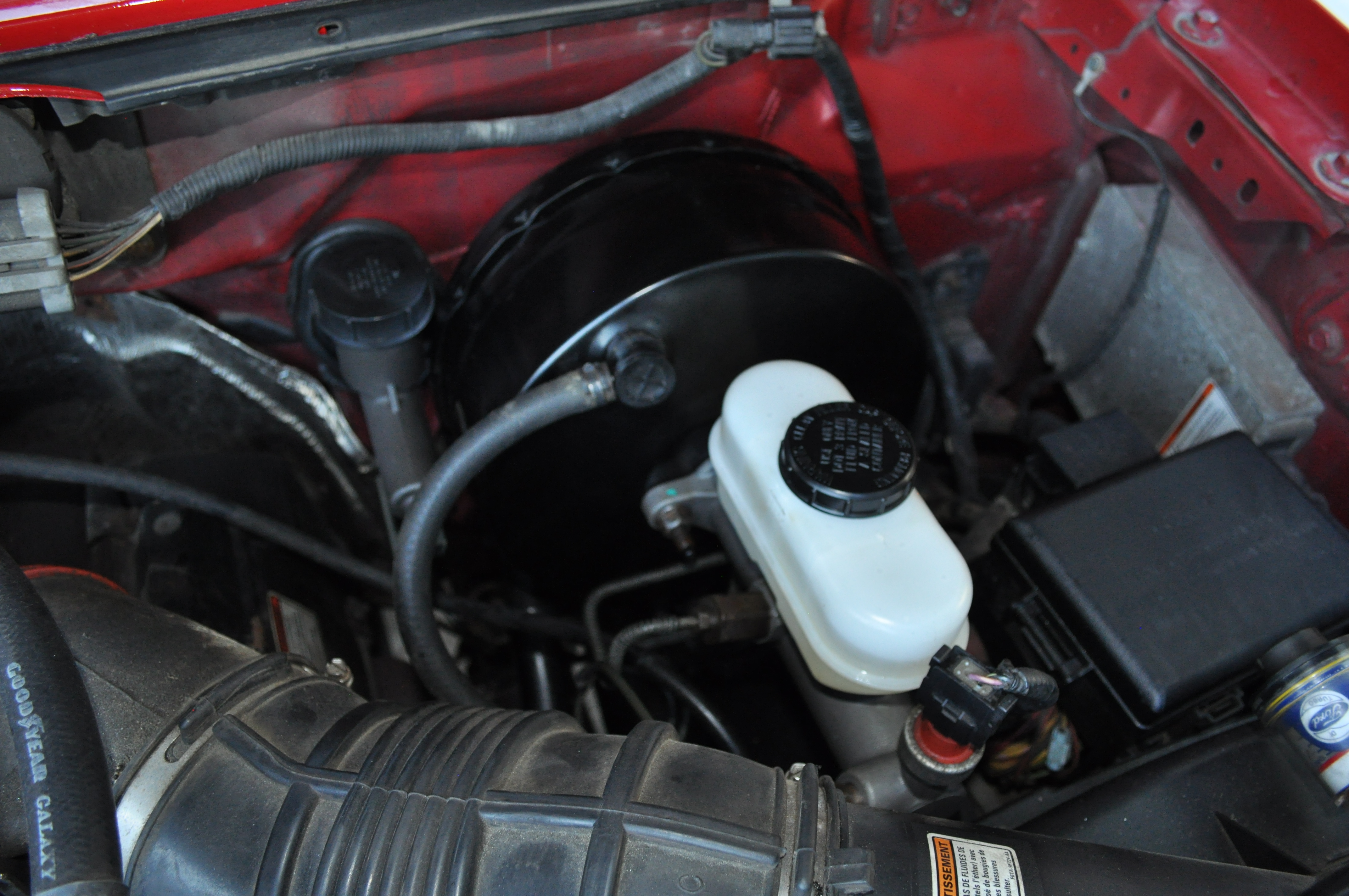

the pre-bleed hydro master was the way to go.....

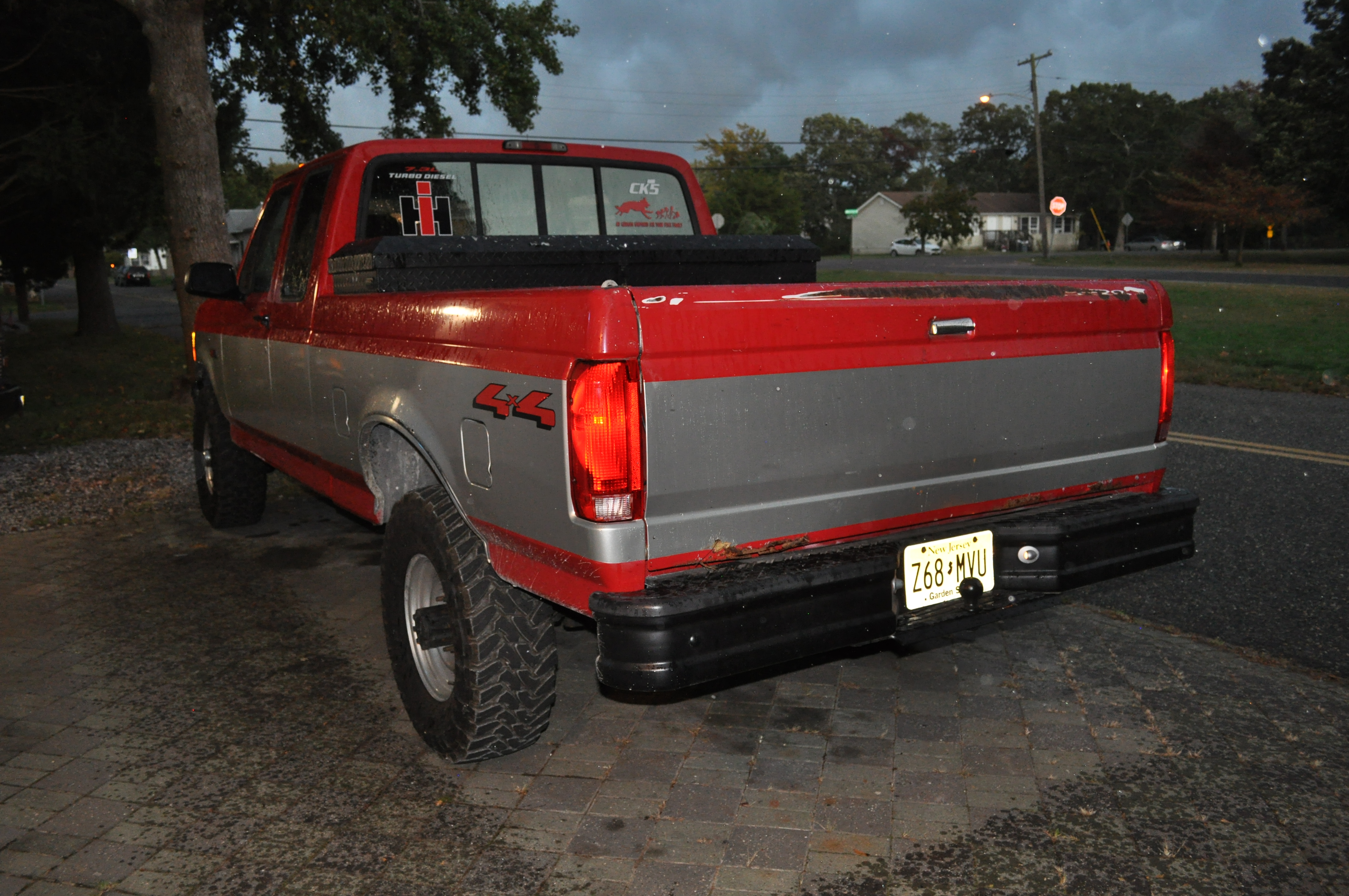

oh, and $20, I threw on new taillight lens too.... old where hammered oxidized... make the rig feel good about itself for a while.... ;) hopefully I wont be touching it for a few yrs now....

so. I wanna hopefully close off this miniscule thread for a while... that's a good thing... I'm pretty proud of the amount of projects this rig has gone thru in about 15 months.. it went from a semi, pretty hammered, all original mid 90's rig to a solid contender now... i'd be comfortable running this to Fla tomorrow.....
new rad support and all body mounts.. 2 new fuel tanks.. 8' of frame blasted... new shocks and mounts.. motor maintenance and vac pump... shackle/brackets... all new brakes.. clutch/hydro junk.. windshield.. tires.. pretty drastic visual change..

it may not be a Mutt, or over the top K5, but I think my efforts have done the rig justice... :deal:
Love it. I love looking at original pics and new pics and looking at the changes and what I built. That’s quite an accomplishment you did.
