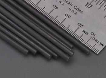

He said they usually weld in "round rod" and grind it down to make nice tight body lines on old chevy trucks....
What exactly is "round rod"...:dunno:
Solid steel rod ranging from 1/8" to 2" body guys use 1/4"-1/8"-3/16" to fill space or help when resectioning roofline on chops or and other crazy bod mods. It is mild steel and easy to form, bend, weld, or to use as guide lines for the body mods. We use it at the shop to help get or make radius' for projects, and build skeletons for artist sculpures. That and TIG rod.
In your case that may or may not work. Usually folks use that method if all the gaps are good except one that has like a 3/8" gap. They would weld the rod into the edge of the door on that side and then hide it with weld and/or bondo. Not a bad method really but its not exactly preferred. If done right you never know it was done.
