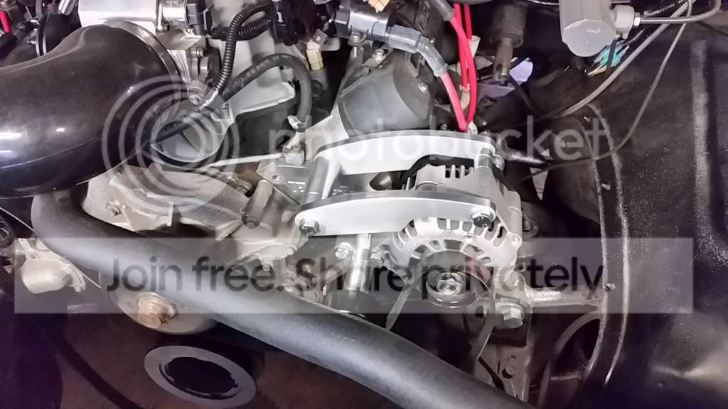

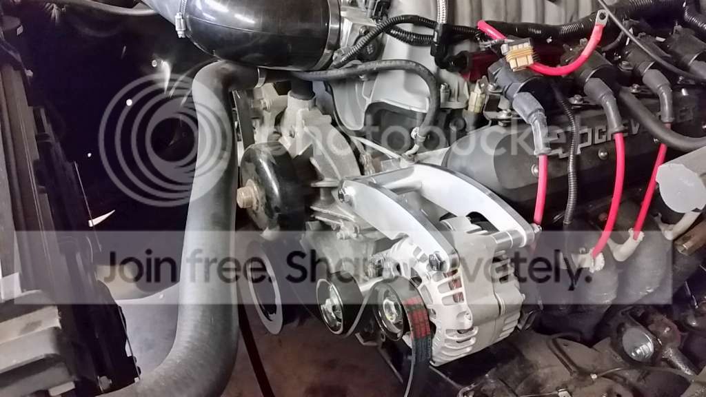

I also threw my alternator only bracket on, really nice piece.

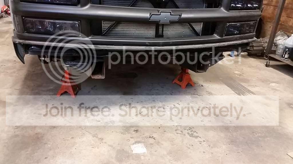

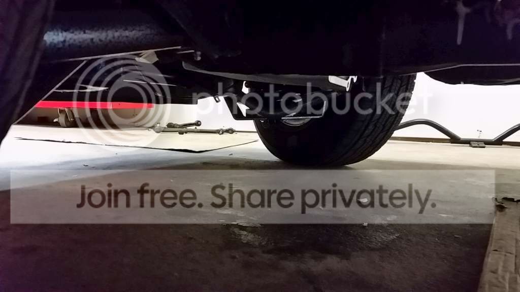

Got started on the rack and decided to hack the frame rails off while Im at it.

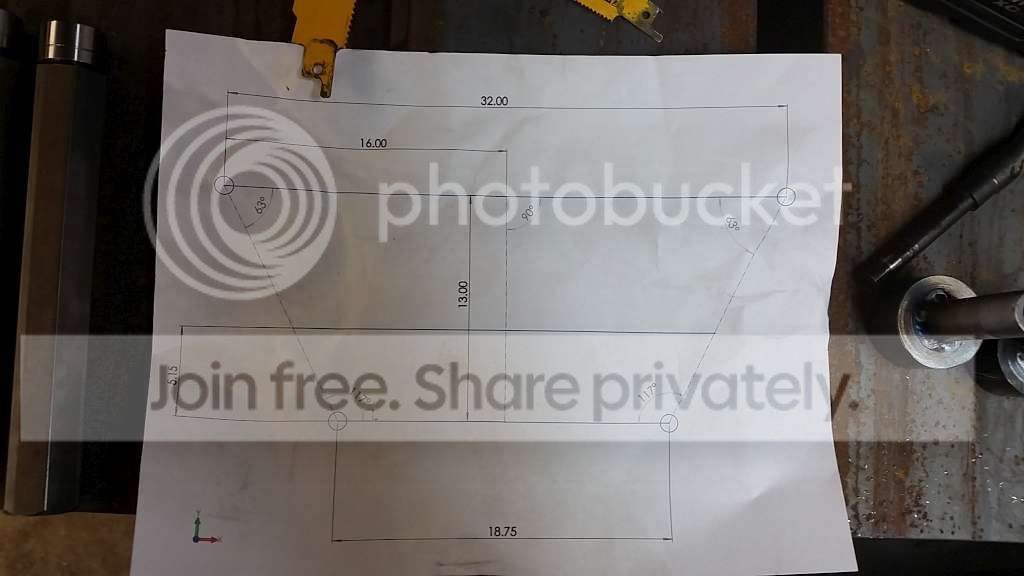

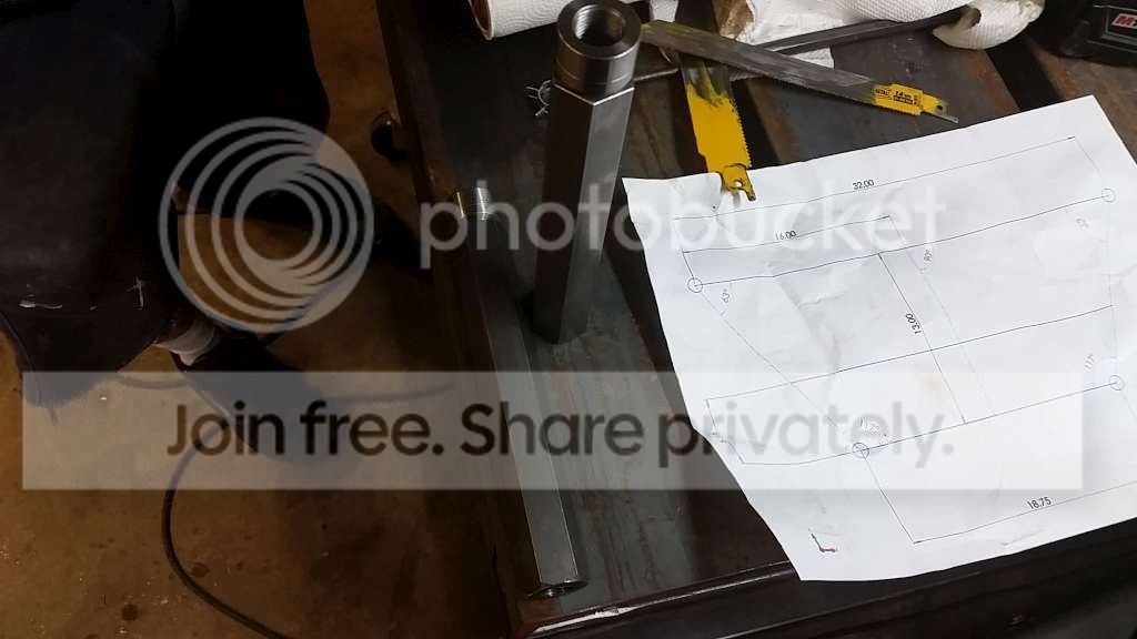

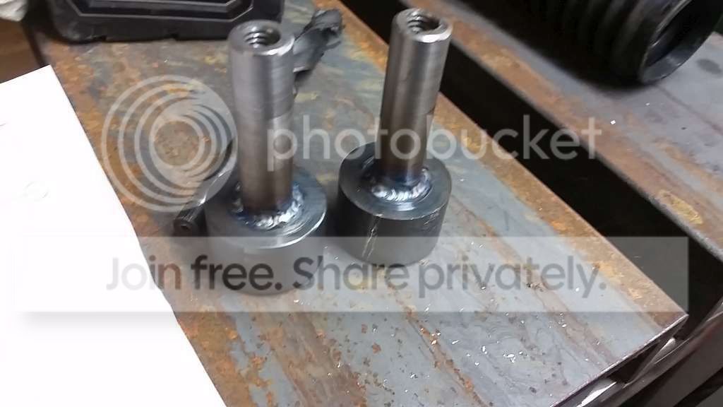

Spend some time on the lathe at work making adjusters and mounts for it. Also did all my geometry for placement in solidworks so theres no bumper steer.
Adjusters are 9/16-18 on one side for the inner tie rods and 5/8 fine left hand for the heims on the other.
Ditched the bumper, time for a glass one. Im gonna weigh everything I cut out/replaced. I wouldnt doubt I got 100+ pounds off the front end.
