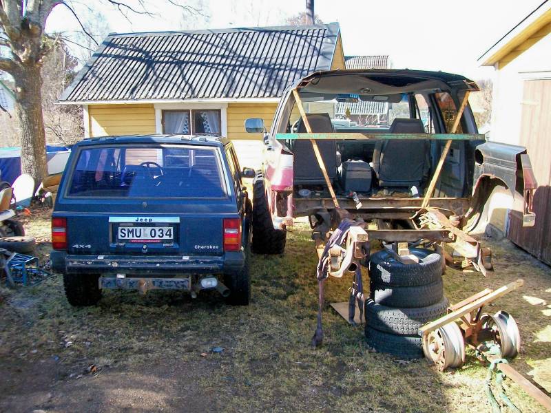

jeep on 31" burb on 47",just a little diff in height?
the burb tire is taller than the jeep´s hood,lol!

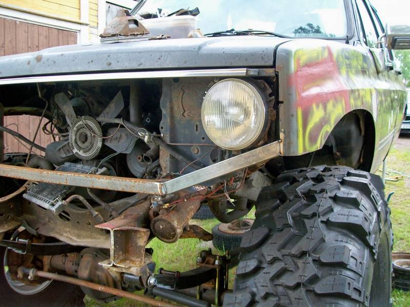

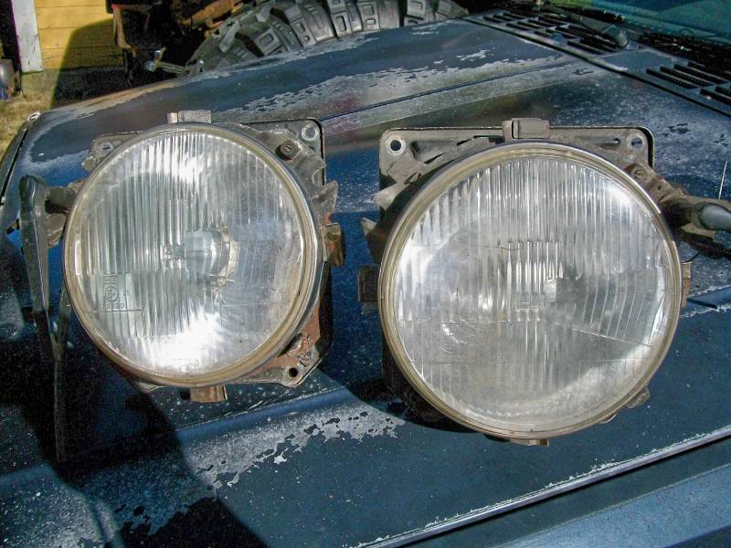

new headlights,these are from a volvo 240 series,75-78,I don´t think these light were used on the us models,but were standard here in sweden,they have a flat mounting bracket,and are 8" in diameter,hopefully they´ll give a tad more light than the std square gm units.
very cool......
does Cibie make e codes for those........that would work out real well i think.

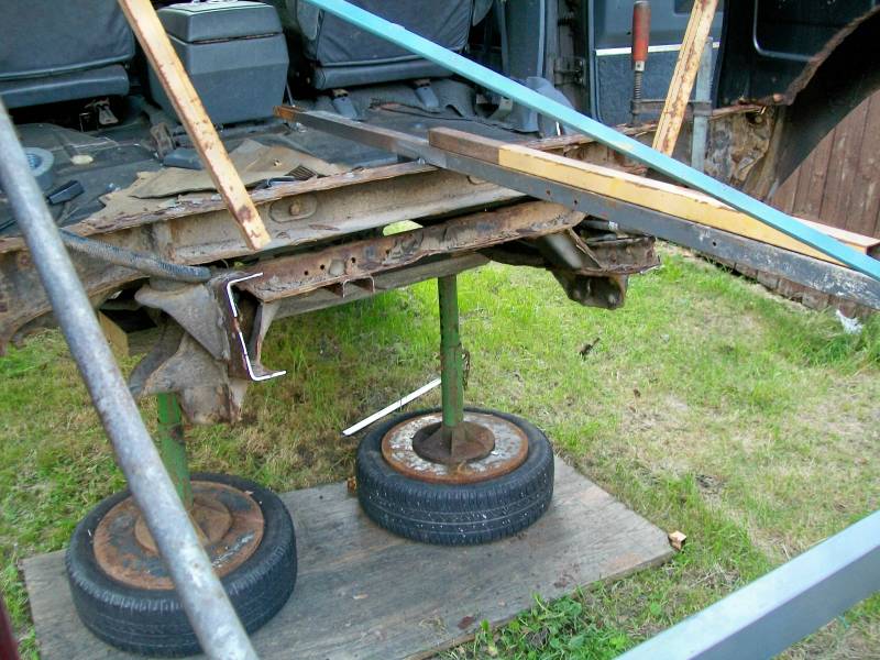

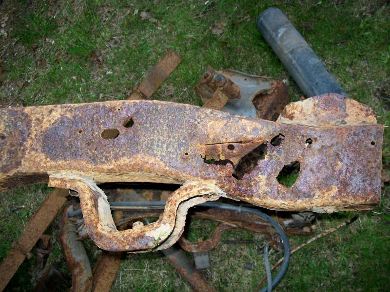

finally got started on it again,got it squared/leveled front and rear today,and cut off som stuff...

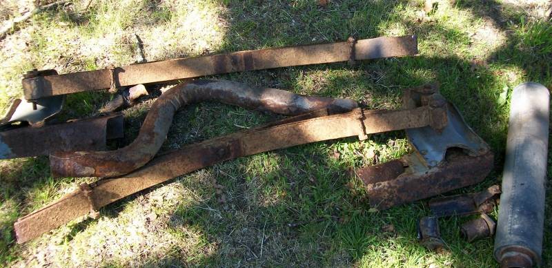

a little pile of crusty gm parts...

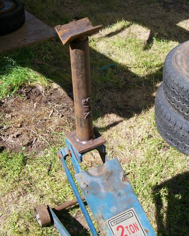

my homemade jack extension,works great,it´s locked in from the underside with a big bolt.

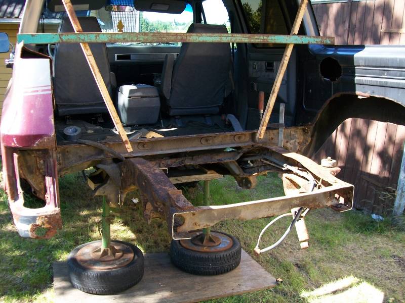

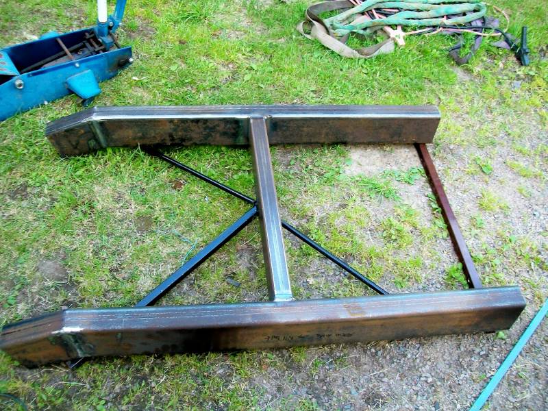

got the new rear framerails welded together to a single unit,hopefully I´ll get it welded to the truck when I get home from work,pic´s tonight:popcorn:
finally out!
no turning back now

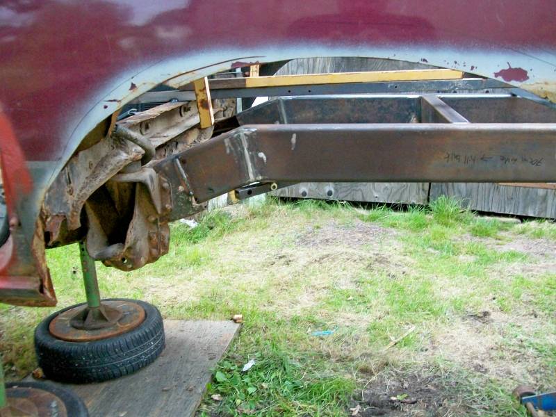

new rails put together,actually did it at work today,with full pay.:D

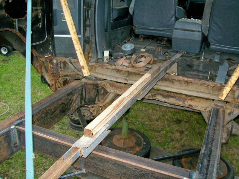

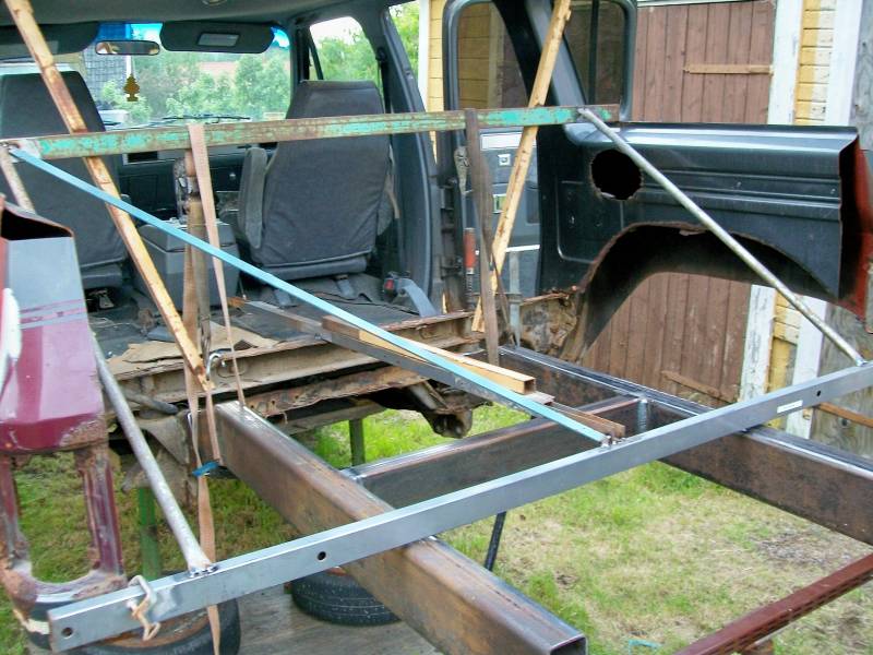

mocked up for final trimming
in place!still lots of work left though...
another wiev

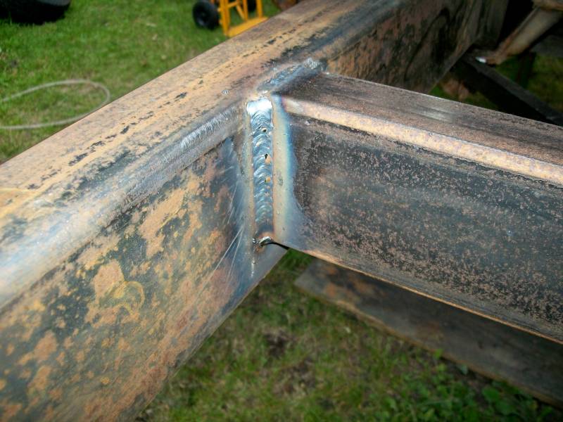

closeup of welding

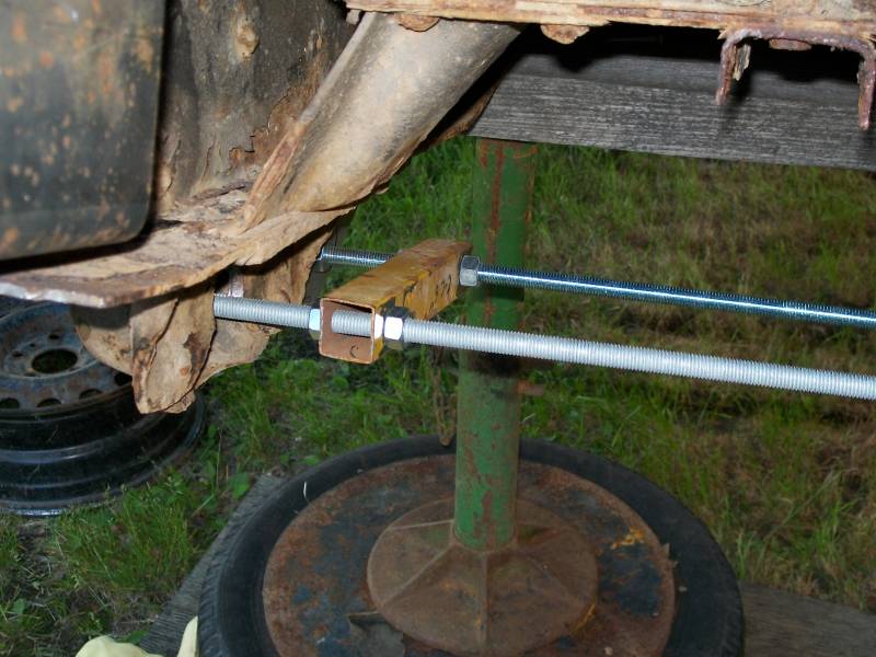

made some stuff to locate the new mounts properly wile welding,ran out of M12 nuts,so I´ll get on it tomorrow after work.

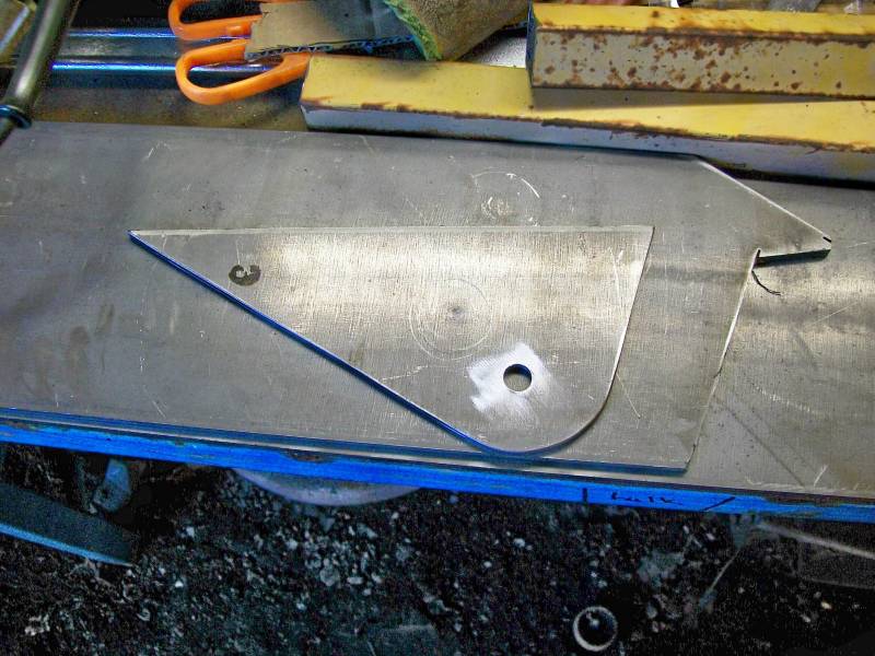

made the outer plates for my new springmounts tonight,6mm steel plate

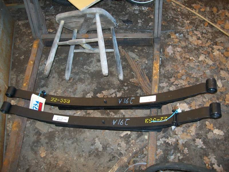

new std rear springs.that´s it for tonight.

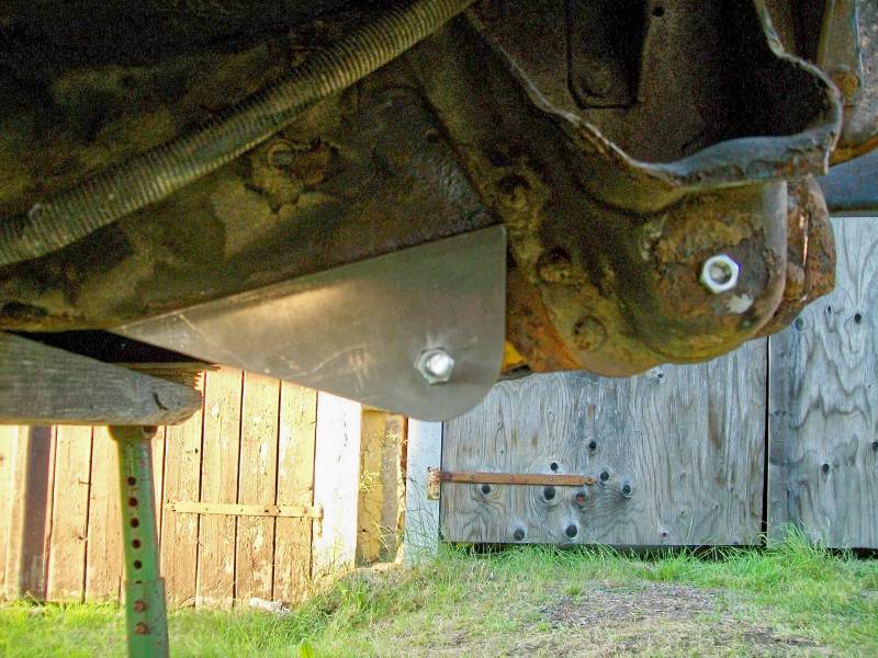

got those outer plates i made yesterday welded to the frame,about50% done,the inner ones needs a bend in them,so I´ll have to wait until monday to get those bent up for me.also cut of some of the scrap metal i used for mocking up the frame and rear fenders.

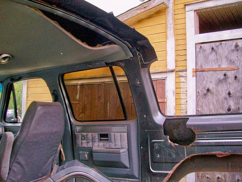

started trimming for the backdoor/hatch

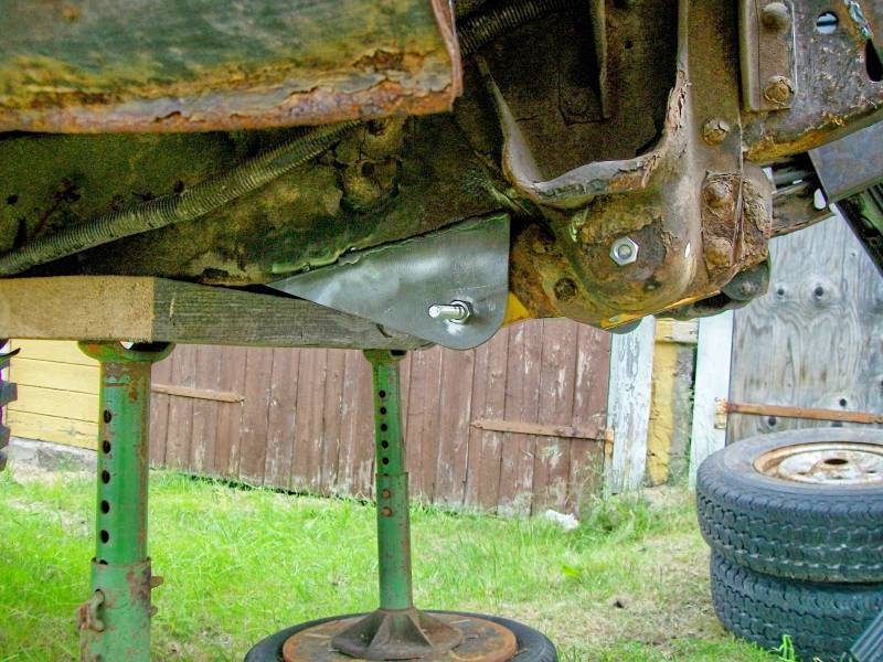

and the springmounts I started on the other day.
