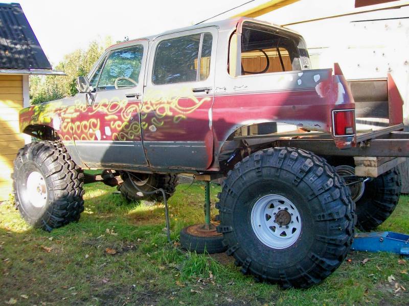

Swedester´s 87 burb build,halfdoor project in progress.

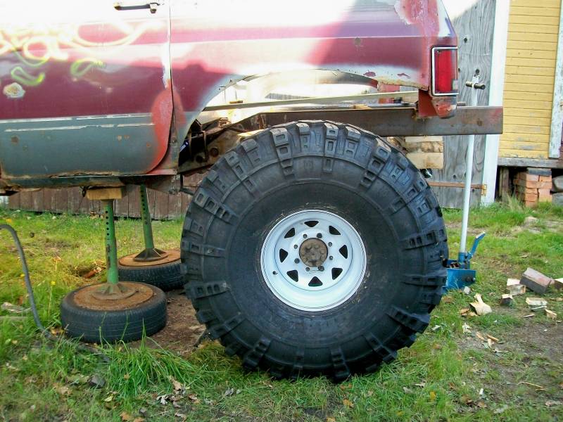

rear mounts

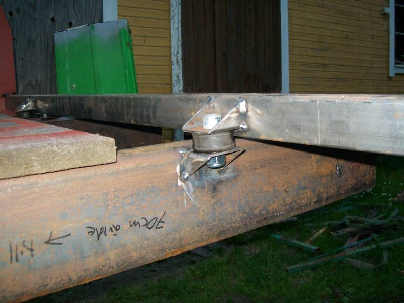

another angle...

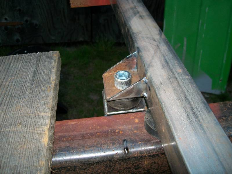

well,after about 2,5 months,I´m back working on the truck,a lot of personal stuff got in the way,loosing my job,and so on,left the truck sitting all alone and abandoned in the yard,but today I got on it,and did the inner plates for the rear springmounts ready,and welded them up.

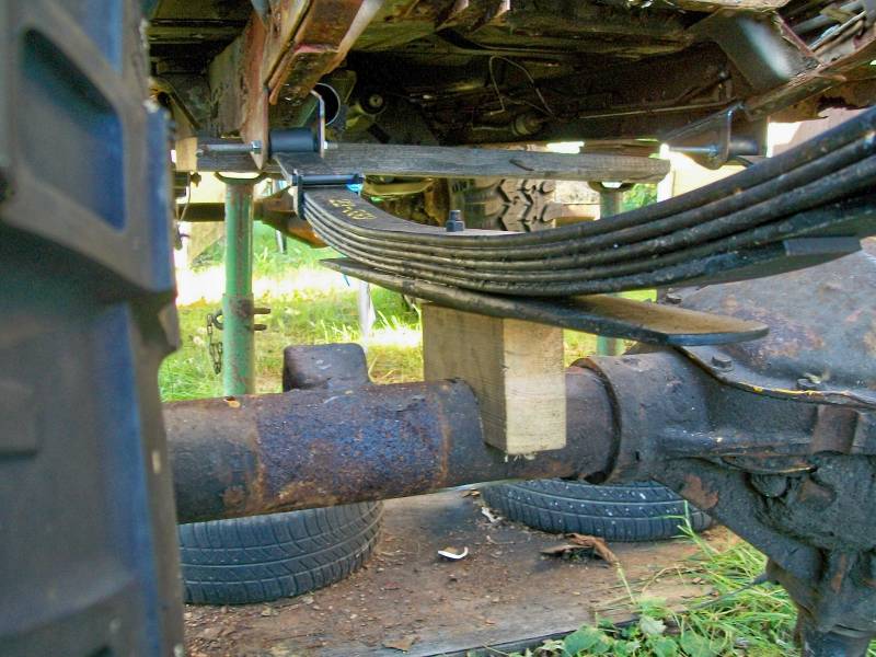

today I´m going to try and get the 14bolt under the truck for mock upp,using hi-tech stuff like wooden blocks,ratchetstraps and a whole lot of cursing :O)

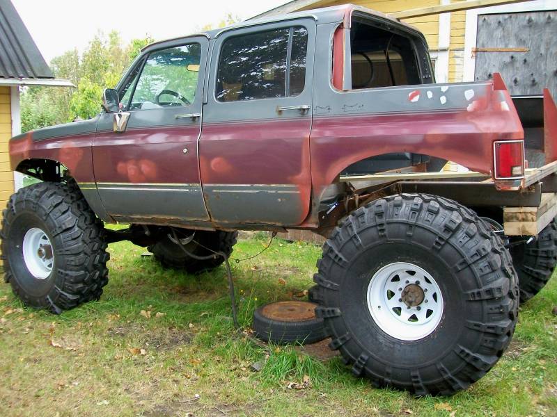

well it sits on all 4 wheels now...
the axle will come back another inch,as I made my woodblocks a little to short for the mockup.
these wood blocks put the axle about 2" to the rear,the metal replacing them will have more offset,and be an inch lower,so the shackles can be another 2" longer,I held the springs lined up in the rear with a threaded rod to get the right cc.

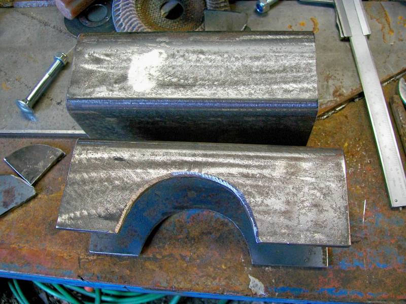

cut of the excess material from the rails,did some touchups with the angle grinder here and there,and finally took som paint thinner and wiped of the yellow crap...
leftovers from the rails will be my new springpads,so I guess the wooden ones will have to go.these move the axle back 3" on the springs,just as I did on the front.
