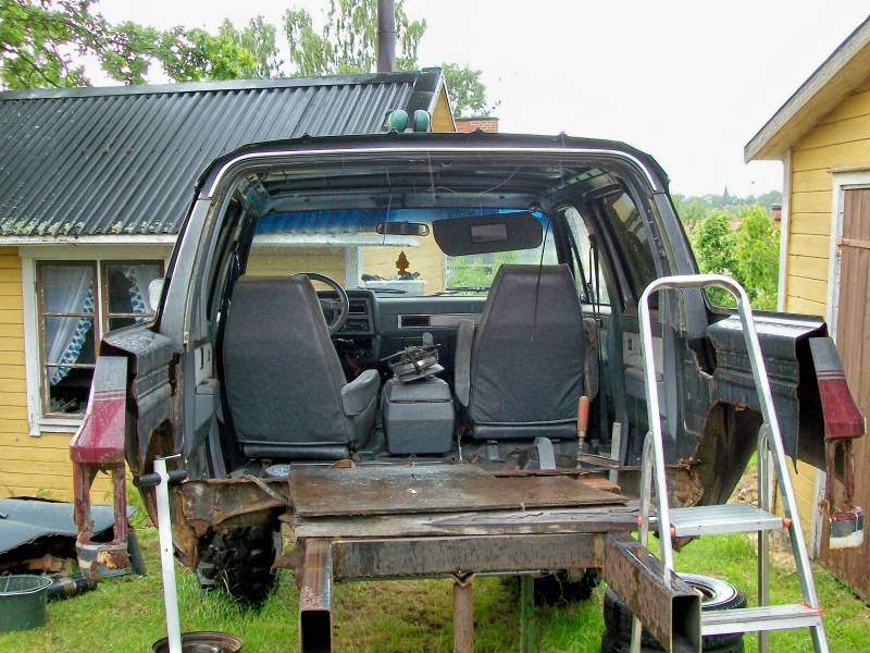

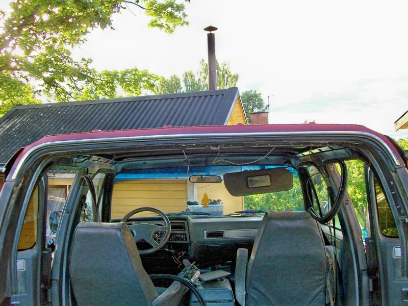

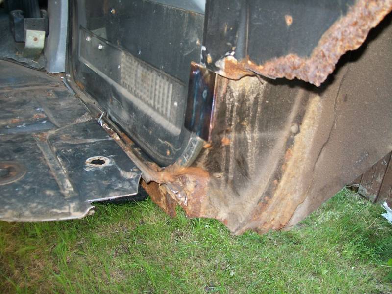

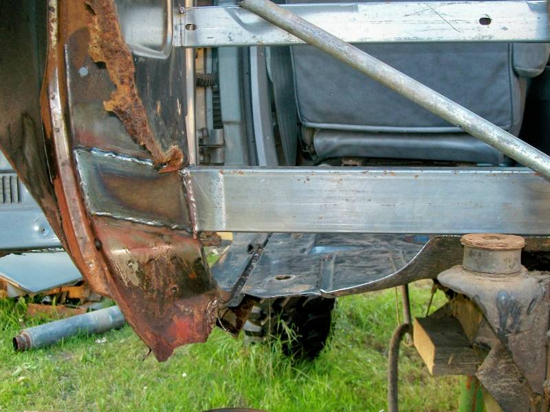

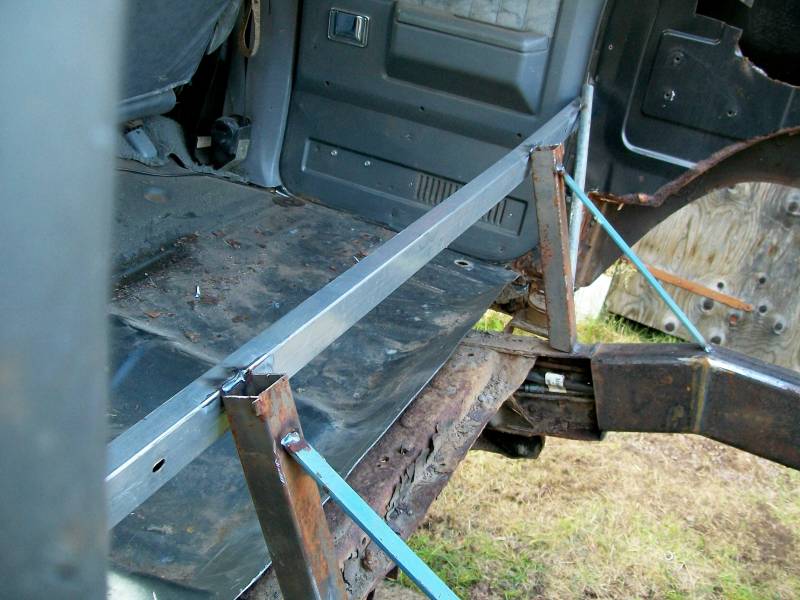

this is how far I got before it started raining,but its in there,and ready to start tacking in place.

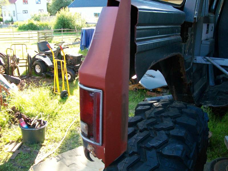

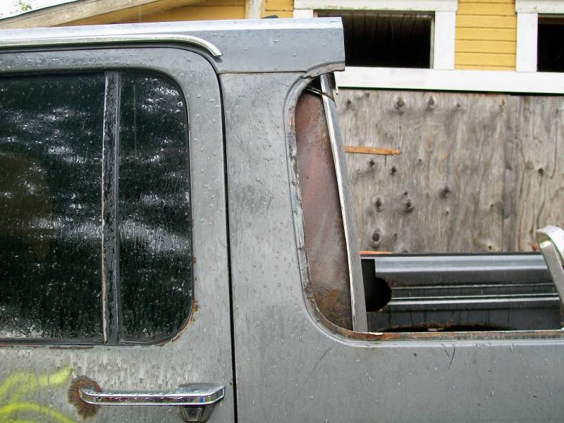

as far forward as possible without hacking the c pillar totally

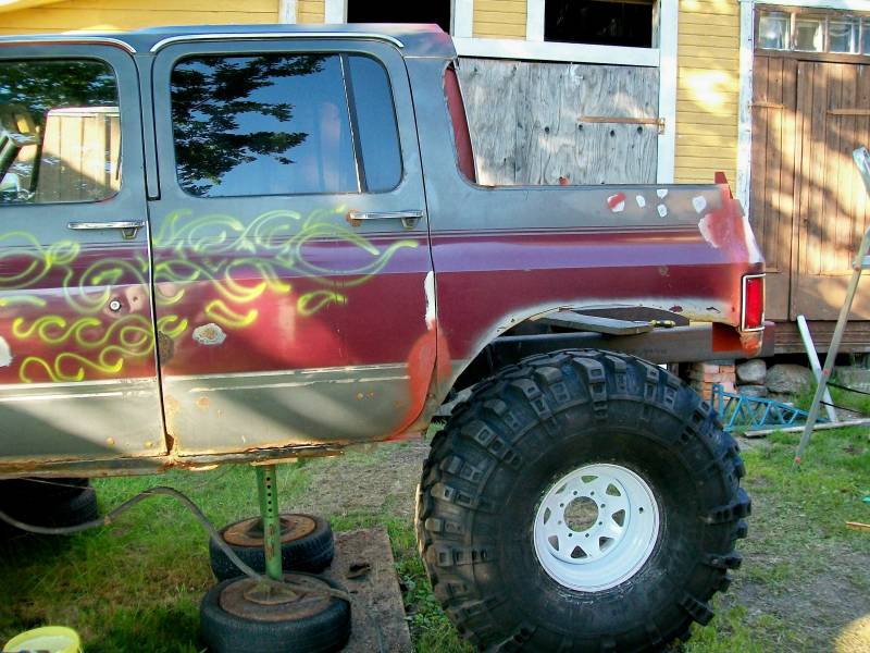

Now you have me thinking of hacking up my burb......

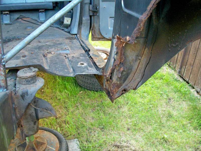

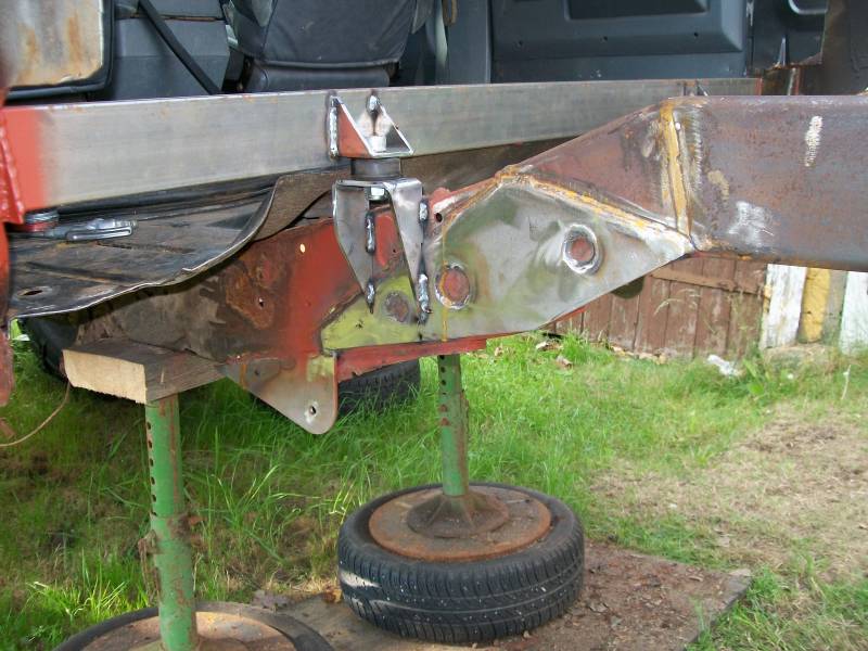

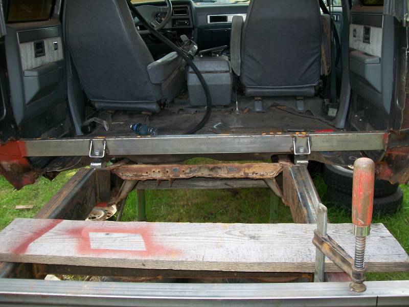

it´s alot of work,but I think it´s worth it.got off work 18:15,home about 18:45,jumpstart the mower,mow the lawn,drag out the welder,got the new crossmember in,then the mosquitos got to much for me,so I called it night,phew!!!

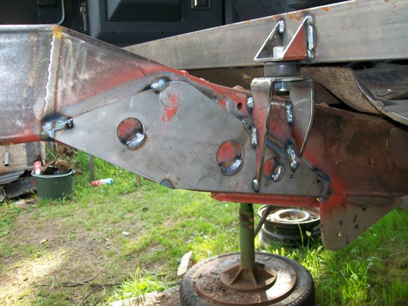

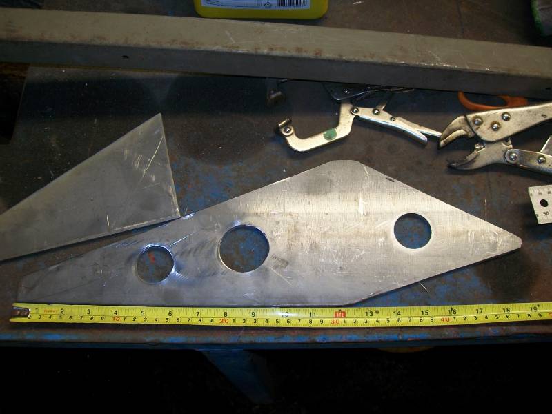

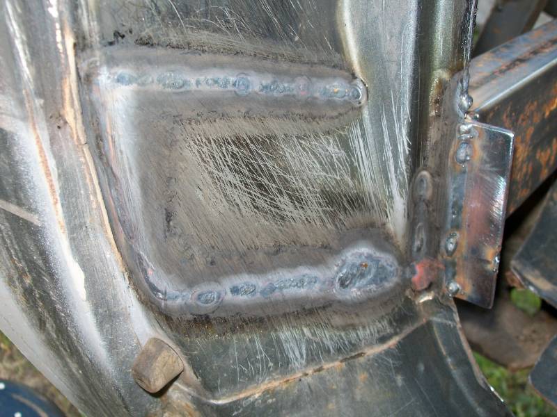

got two 1/8" plates welded to support the c-pillar/crossmember .
. Ok theres a size I understand
, can't wait to see this thing with the suspension in and stuffing the 47's

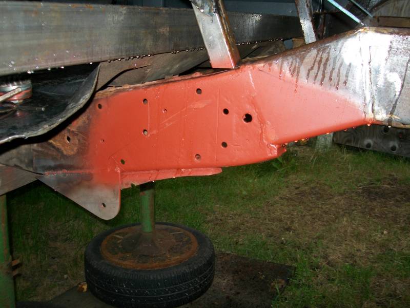

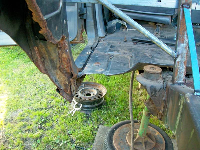

I think it would be a good idea to even out the transition between the new and the old parts on the bottom of the frame.
darn camera makes everything look crooked though?
