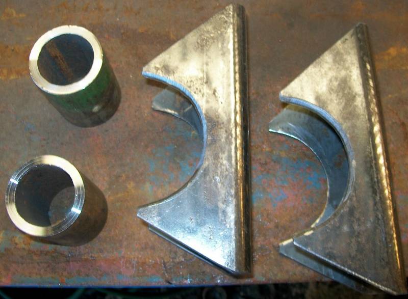

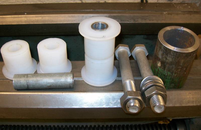

springpads ready to go on,and some pipe to fit the new shackle bushings,it´s nice to have your own lathe.

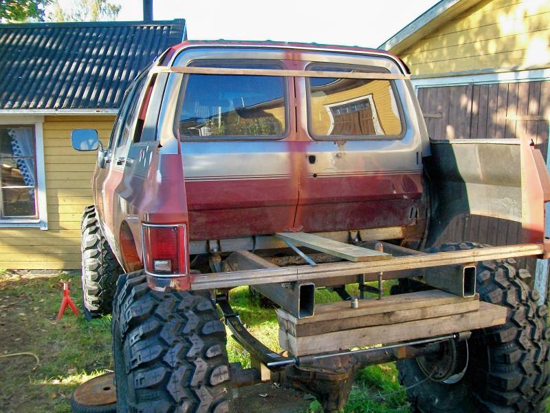

welded the reardoors into a hatch,far from done,but you get the idea,I will do the hinges,and the wheelwells before the final design takes place.

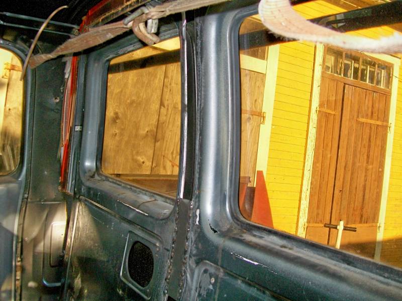

here you see a glimpse of the design,tried to remove as much excess material as possible,dont need any extra pounds of deadweight to haul around,it´ll be heavy enough.plans include cutting out the center pillar,and put in a single backglass.

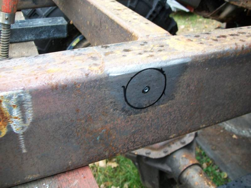

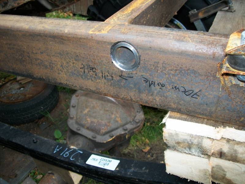

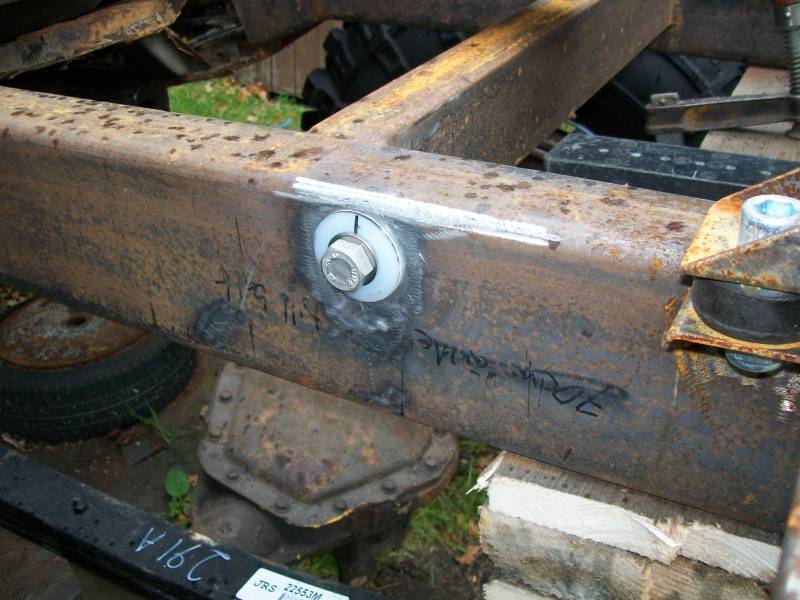

didn´t get much done today,finished up the bushings,and cut a hole in the frame for the new bushing.we´ll see if the weather permits any outdoorwelding tomorrow,now I´m going to run trough the shower,and go to a party :O)

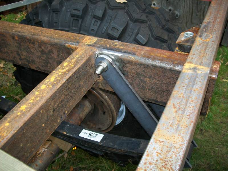

drivers side done.
and that´s how far I got on the pass side before the "humidity" got to much.

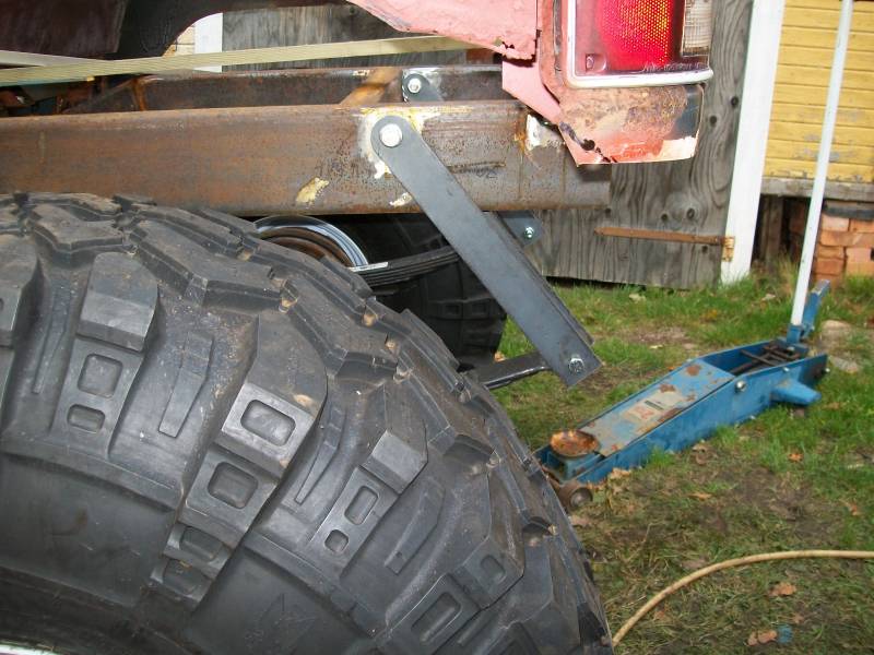

Man you should get a ton of droop out of that setup!! are you gonna use some sort of limit straps so the shackles don't bind against that crossmember on full droop?
Looking at it again I doubt it would droop that far, shocks would probably limit it
