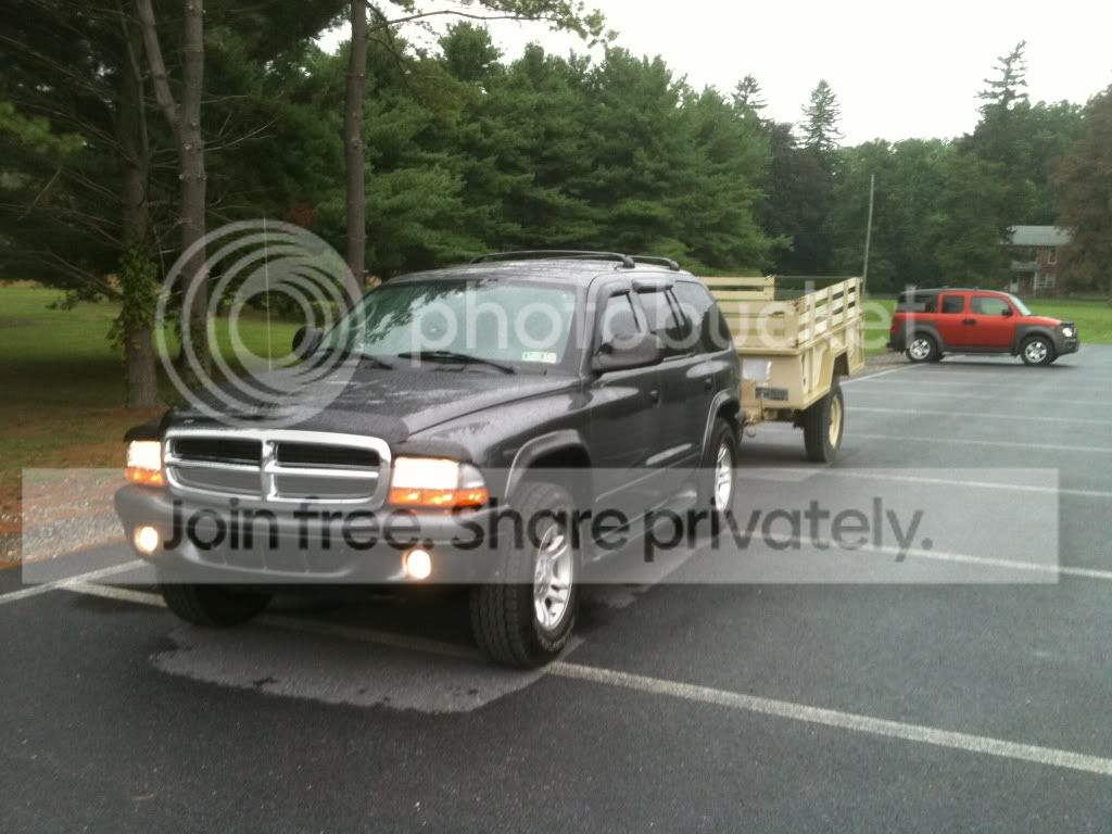

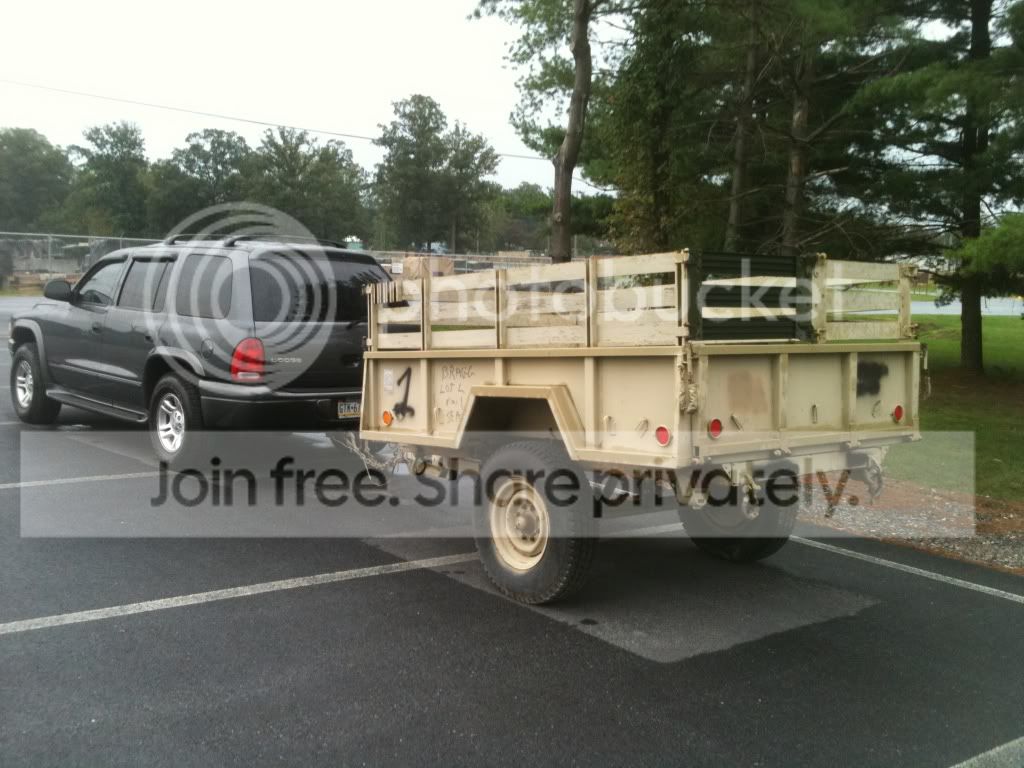

Sorry, I got a bit off topic. So, I've got the classic saggy k5 rear, and an m101a2 military surplus trailer that is going to be part of this combo. It weighs about 1100 lbs empty, we won't be loading it real heavy, just mostly tools, equipment and supplies for 3 to 4 people for a week at a time. The issue is it sits about 4 inches higher than the blazer's rear. Trying to decide about adding helper springs, zero rates, or a small lift? Thoughts?
