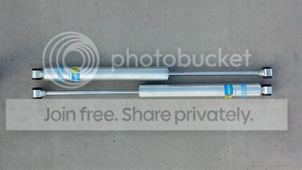

Tried installing my rear shocks today. I discovered that my MX-6 shocks have 9/16" bushings, so they do not fit my standard 5/8" frame-side shanks. I mentally prepared to go borrow my buddy's lathe and came in for the evening. Then the web told me to press out the bushing and just slide the rubber over the bolt.
Of all stupid things, I actually hadn't thought of that yet. :doah: :rolleyes:
The axle mounts have 9/16" bolts and fit perfectly. I don't remember having issues with the old shocks, but I guess they must have been loose on the axle end. :dunno:
The front Bilsteins have 1/2" bushings, but that is what I need up there.

All I have is several piles of new parts waiting for installation. Not much actual progress since I got the front springs installed. So enjoy some stock pictures of what I'm talking about.
Stock pictures of shocks. Shocking.
Stock picture of stock 5/8" shock mount.
Stock picture of 9/16" bolt.
Does that make you more happier?
