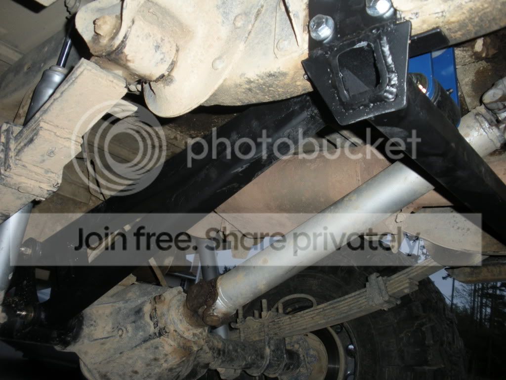

Also worked on my anti wrap bar and came up with this...
picture.php
picture.php
I think I need to triangulate the bar onto a lower mount. Im not completely up on the theory and its much better than my previous design. 76zimmer is responsible for that. I modeled this off of the custom bar that he made for iron maiden.
Input is welcomed
Daves is actually the Wraptor anti wrap bar or whatever from Kert at DIY4X. I would know, kert dropped it on my head when I was putting it in :D (Ill never forget that one hehe)
You need two points on the axle to prevent wrap. The closer the the axles center the better. Just search anti wrap bar and you will find a ton. I just don't feel like going down this road again. It was a lengthy discussion while we were building daves.
It looks like your upper mount is on a shackle. That bar is doing nothing until it binds all the way at the front. Until you get a second mounting point on the axle and tie it together you aren't helping yourself.
