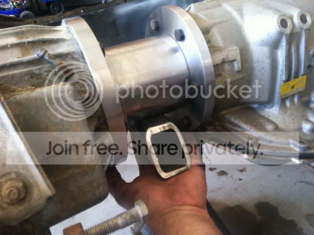

i spent the day in the garage, didn't necessarily make any progress on Daisy but i did get some **** done. i put a bunch of tools away, swept the floor, sold my quad, my old 10bolt front axle and my Vortec heads along with all the EFI **** from the old engine. i also test fit my Trail-tech adapter onto the 4l80e and np241, so sexy. i pulled the hubs off my dana 60 and took the old rotors off, tomorrow morning i'll hit O'Reilly auto parts and get new wheel studs, calipers & pads and have the rotors re-surfaced. here pretty soon i'll get the hubs machined and install the 60. :woot:
goodbye 10 bolt...

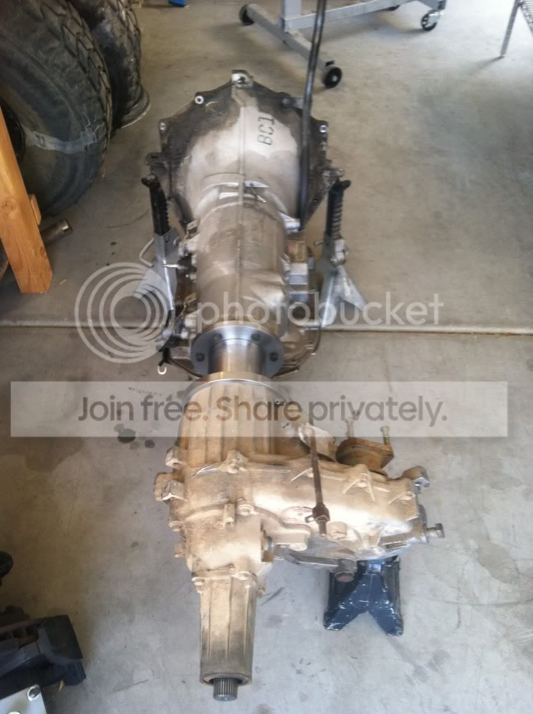

fits beautifully! now i need an SYE kit for the 241 so when my 5.3l shows up i can get everything mocked up and welded, then measure for drivelines.

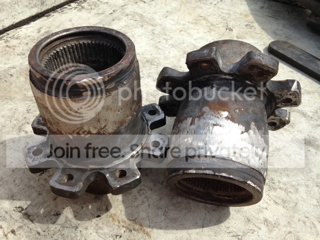

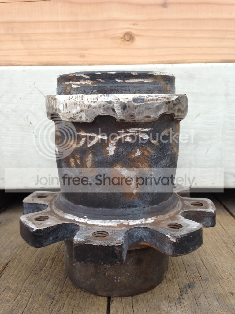

so my DRW hubs are now ready to be thrown on the lathe, a year after purchasing the axle...

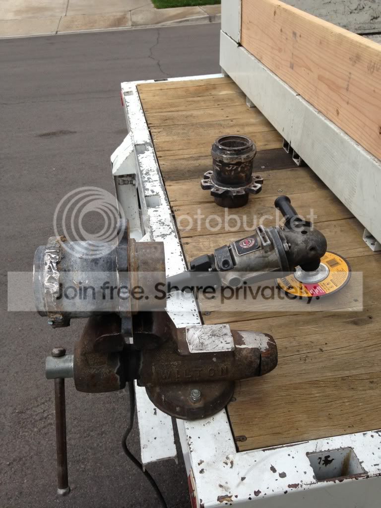

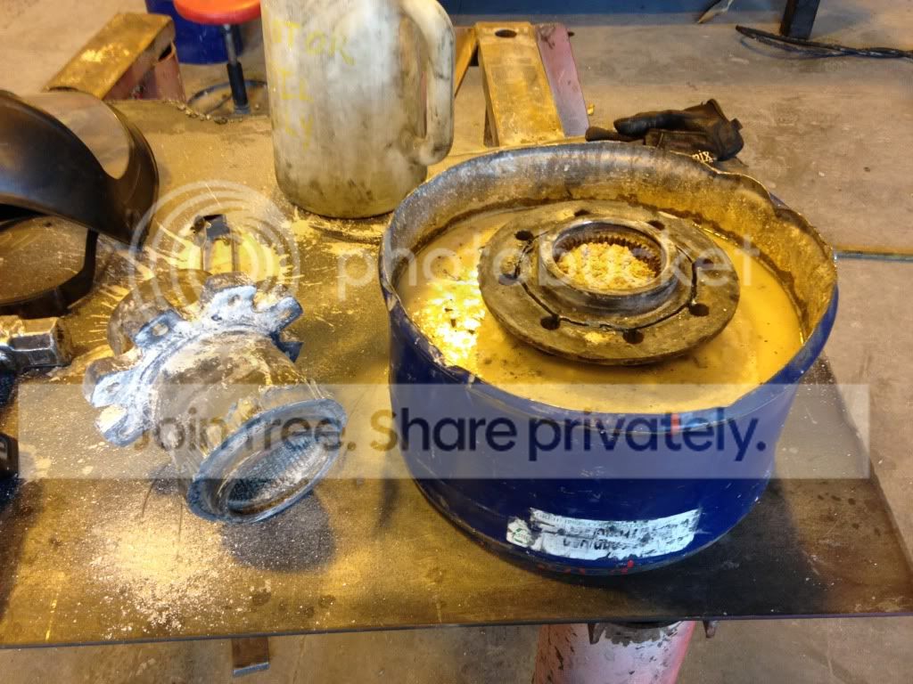

ive read several threads on pirate about the "wrong" and "right" ways to cut off the WMS flange and what kind of metal they are. (cast chromoly is what i kept finding.) i decided to go my own way. after talking to our fabricator at work and doing some research on the hubs, i decided o torch cut the flanges about 1/2" out from the body of the hub and grind the rest off to get them lathe ready. i put the hubs in a barrel full of wet sand, filling the inside of the hub as well. and cut from one wheel stud hole to another, alternating from one side to another. i'd cut 2-3 of them and wait 15min, then cut another 2-3. it took a while, about 45min per hub. the body of the hubs never got over 300* throughout the process. most of the time the body of the hubs stayed in the 230-260* range. then after the entire flange was cut off, i let the hubs cool to under 150* before taking them out of the sand. the idea is that the body of the hub wont be as quick to heat up or cool down this way. after cutting one hub from start to finish, the outside of the barrel was 110* so i guess it did what i was hoping it would do. i'm sure there are guys who will tell me i did it wrong and i'll die a fiery vehicular death upside down on the side of the highway because of it but i feel ok about it.
in the sand box
ready to start grinding
part way through
grinding done!

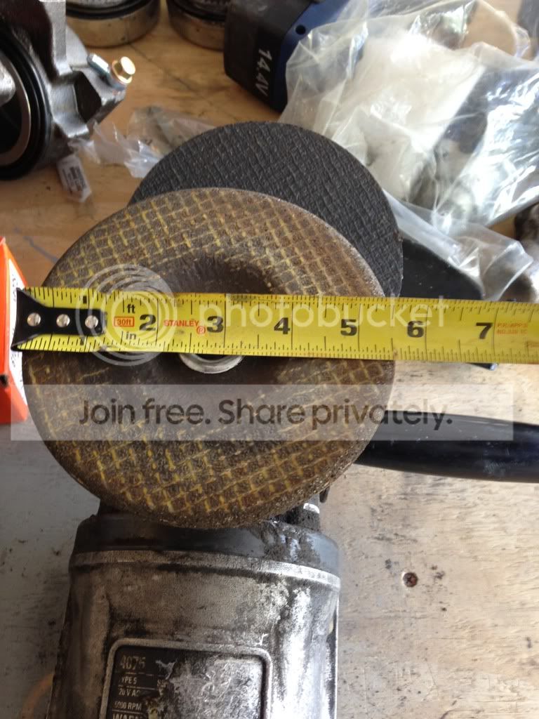

didn't go through half as much grinding wheel as i expected. i bought two 7" wheels thinking i'd kill at least one of them but it only took 1.5" off of one wheel. my hands and elbows are killing me.
tomorrow i'll drop them off at my friend's house to have them cut on the lathe and hopefully have them done in a day or two. (he works in his garage a few hrs a day between his full time job and wife & kids)

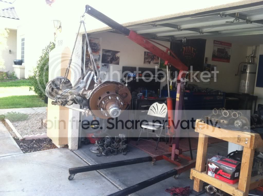

Today I got my 60 and TNA engine crossmember installed. Also got my brake lines all put back in place and measured for tie rod and drag link lengths. Tomorrow ill drop my hubs, rotors, tie rod ends and steering box off at a friend's house. He'll be machining the hubs, building the steering links and tapping one of the mounting holes on the box that I ****ed up being impatient.
