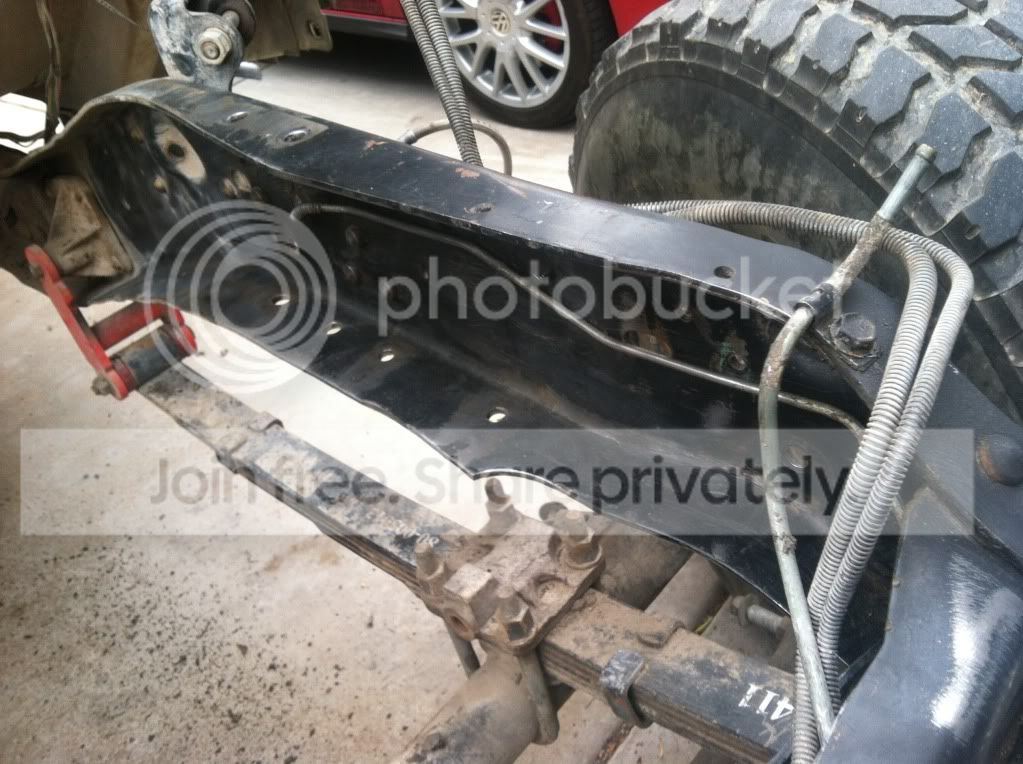

Got a little bit done yesterday in this wonderful (overcast/rainy) weather. Took the front end off and started cleaning up the frame rails. I love my 9" grinder.

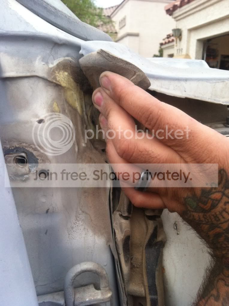

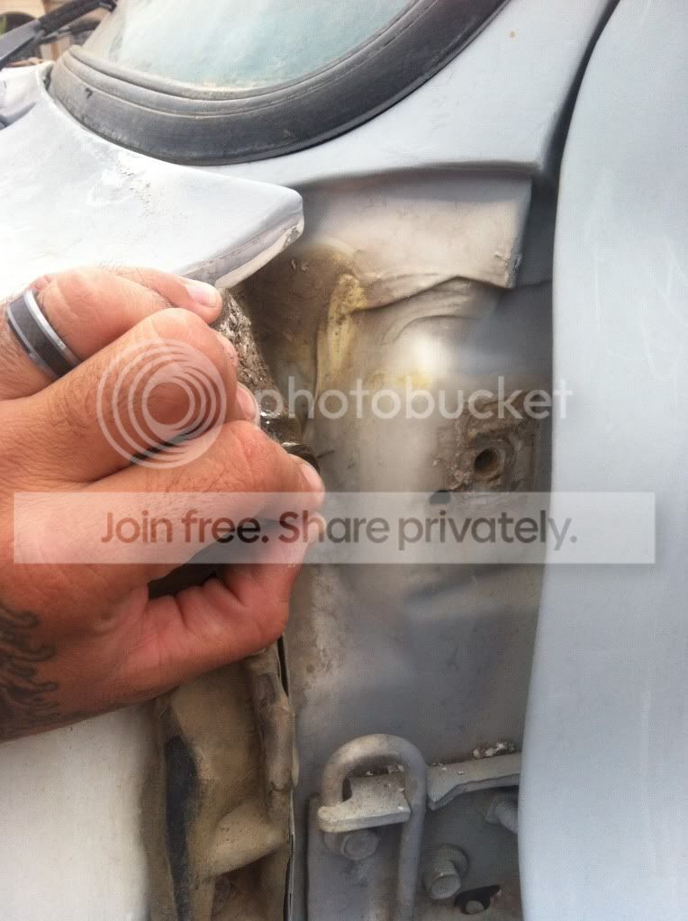

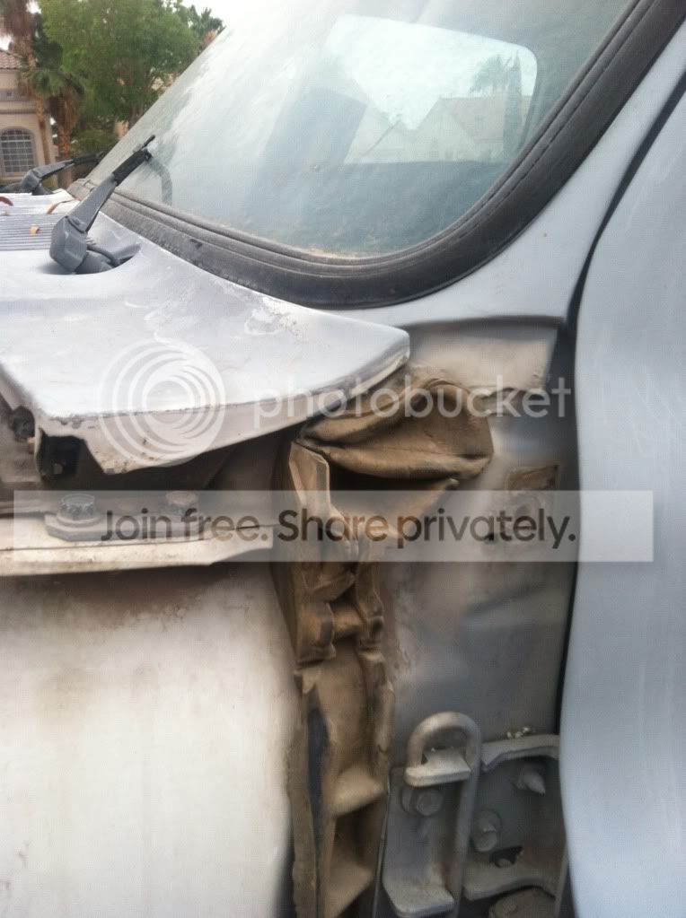

A favor to ask
Could you possibly take a closer picture of the cowl at tha coner of the windshield? My truck leaks rain at that point on both sides and I am trying to understand what it all looks like without having to pull the fenders. A friend told me there is body sealer there somewhere that needs to be re-done.
I would be most greatful.

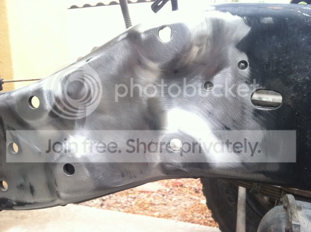

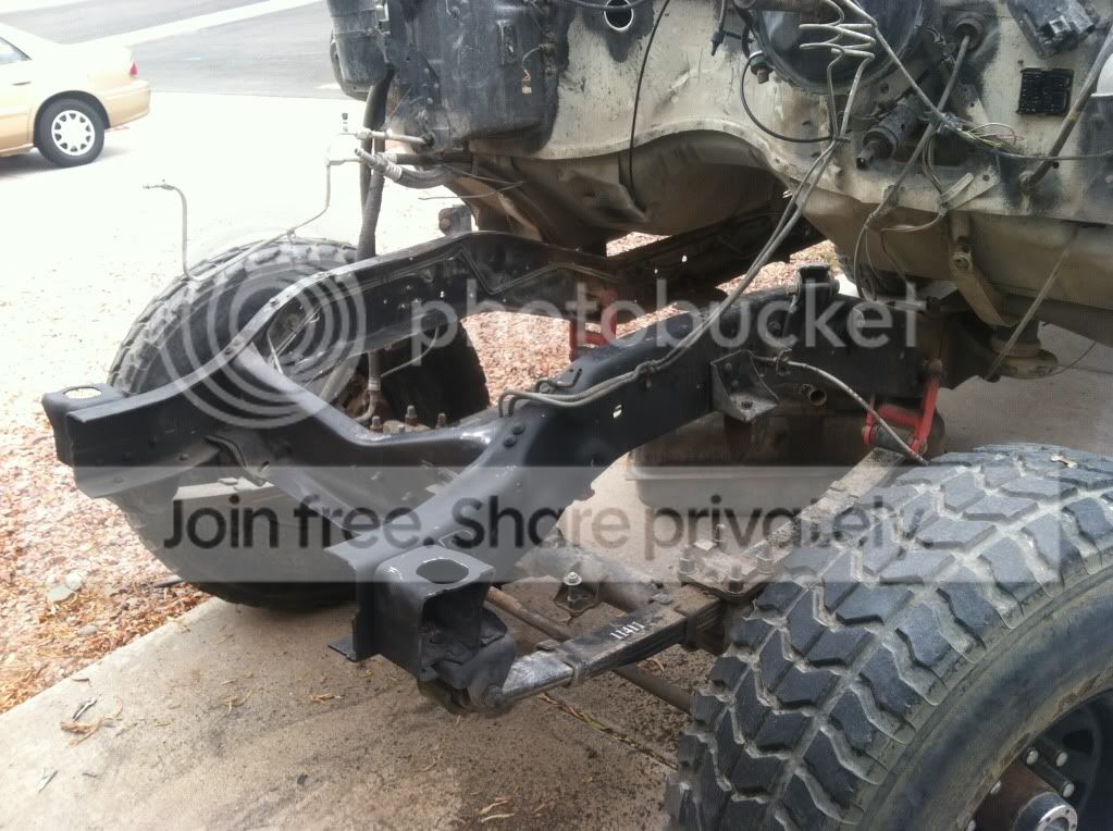

i did some work on the front end of the frame today, stripped the area where the steering box goes, no cracks!! I also got the engine crossmember out and cleaned some of the inside of the frame. this weekend i'm gonna get the bumpstops and upper shock mounts removed, get the axle/springs off and get ready to do a FUSH kit as well. i'm going to relocate the brake lines also to make room for upper shock mounts.
yes my frame rails look funny, when i was 17, i put a 2" body lift on the suburban, cut off the frame ends (all 4) and welded them back on 2" higher to make my bumpers line up. now i have to cut them all off and weld them back in place...
hope this helps
Son of a bitch... Even in person I didn't see it. Had to zoom in on the pic to see it. Well, **** me... Guess I need to slow down a little and pay attention.
So I see at least the bottom of the two top humps have a crack and possibly the top of the rear bottom hump looks like it is a small crack starting?
