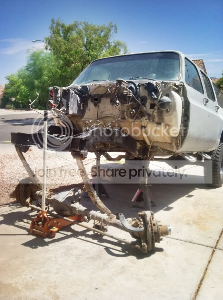

I sure wish my Nikon was working right now so I could upload some high-res photos. iPhone photos aren't cutting it IMO. I've got a bunch of **** cut off the frame and stripped the steering box area to bare metal again. I've been staring at it for almost an hour and I'm still it entirely sure its a crack. Looks more like a gouge of some kind. I think i'll just get the weld in kit anyway to be sure.
[edit] my friend came over, he's a fabricator and does roller coaster inspections on the side. he says its cracked and he's gonna weld in the frame patch for me next weekend. we're also gonna try to get my dana 60 hubs machined down asap so i can throw it under the truck and get the steering done. can't do upper shock mounts til the steering box/shaft are in.[edit]

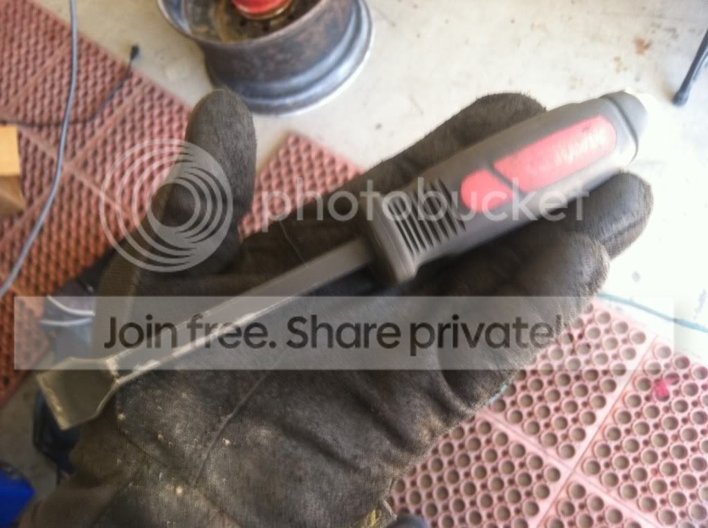

i guess 10yrs is enough for an old makita cordless. i found a chisel in my toolbox that takes care of the frame rivets in no time. i cut into them with a cutoff wheel and then hit this thing with a hammer 4-5 times per rivet and they're gone.
