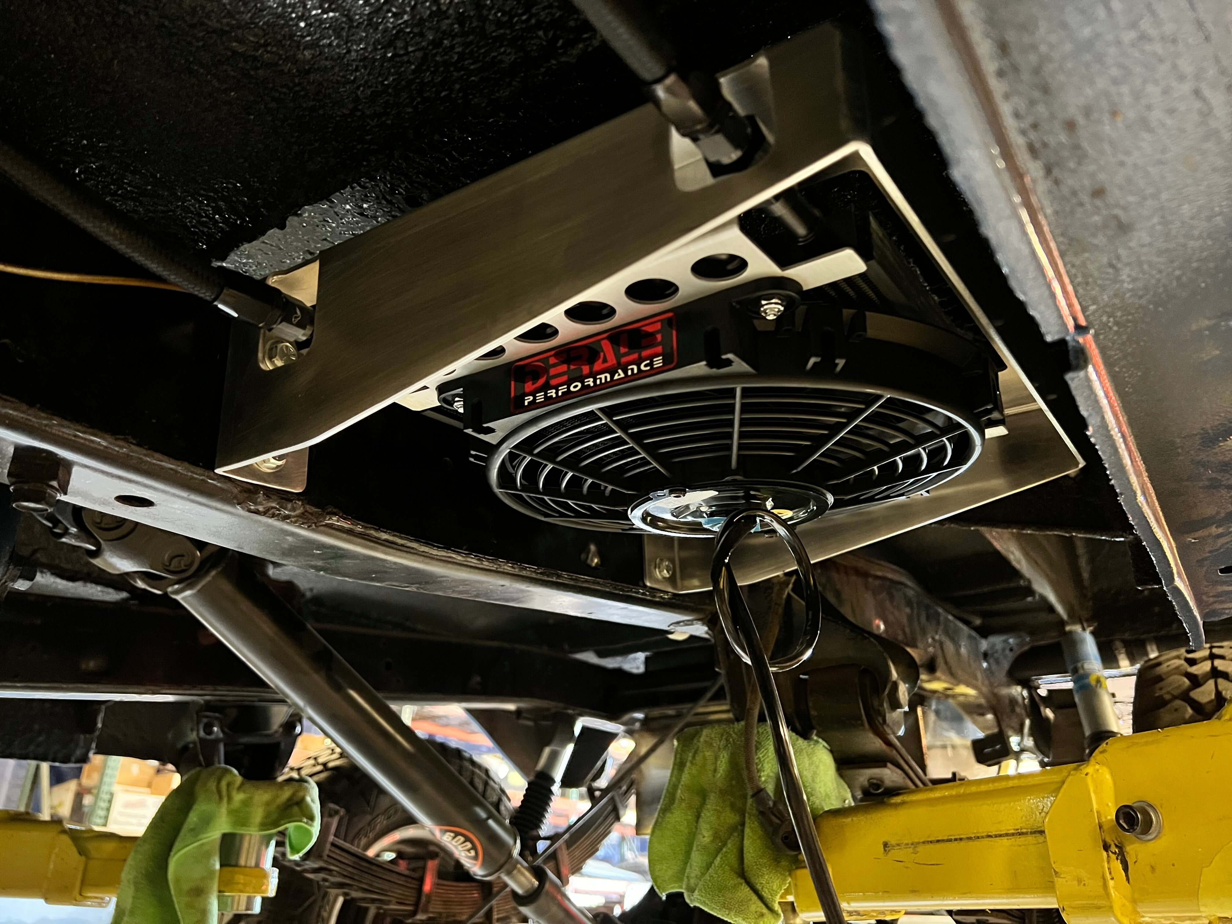

It's the 13740 https://www.summitracing.com/parts/DER-13740 .Which trans cooler did you get? I got a derale 60k with a fan on it, with my trans hunting in od last weekend it only got 170
This is the one I have, I put a fan on it also.Well, now you guys have me worried. The one I bought is only rated for 37000BTUs.
Pictures and videos coming from last night, but I got a new PB [email protected]. I did a couple 13.5 runs, a few high 13.4 runs and the one 13.30 run... I couldn't figure out why the one run was so fast last night, it was considerably faster than anything else I ran (followup runs were 13.46 and 13.49), but this morning it hit me. I ran 4 runs when we first go there, the first was 13.50, the next 3 were slower, then we parked the truck, swapped the bottle and grabbed some food and watched for a bit. The transmission was super hot after the first 4 runs (250ish) and I noticed it was down to 170ish before the 13.3 run. I'm thinking if I can get that tranny to stay cool I'll be much more consistent in the low 13's, combine that with the headers and new exhaust I may be in the 12s, but we'll see.
I'll post pictures and videos later today, but I wanted your thoughts on the trans cooler. It's still in the box so I can return it to Summit and order the bigger 67000 BTU one.
