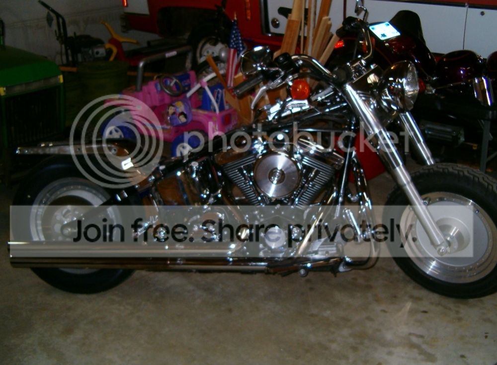

I got the mechanical's finished up today...I had a new tire put on and wheel bearings greased and new rear axle seals, and had my HD guy check out the Vaccum Operated Electrical Switch, which controls the timing somewhat. I've had a sluggishness to the engine which is intermittent and I have'nt been able to figure out the reason why.
I also leaned the carb out some, and replaced the fuel enrichment cable and valve, changed the fork oil, and put in a new battery. Have to replace a few minor items, then I'm going to put the tins back on and ride it...Paint will have to wait til I can find a few good weeks of open time to work on it.

I do like the paint to flow out from the front to rear though, so it'll be going back on...only takes 4 bolts to hold it on!
Hey Dave, the rubber plug on your VOES comes out, there's a screw in there to fine tune the timing....mainly for hi performance motors, but sometimes they come a little off from the factory as I recall...

thats good to know Ray...I knew it affected the timing but wasn't sure how...here is my situation...while cruising 55-75mph (maybe more I don't go much faster than 80) but while cruising and rolling into the throttle heavy to pass or whatever, usually it goes great, nice acceleration, expected performance...sometimes under the same conditions, and maybe only a few minutes later on the same ride, it will feel like it is sluggish, like its retarded on timing...so is the VOES switch something that would be a sporadically ill functioning unit?
It's been a long time since I messed with one Dave, It's basically a switch. I would think it would either be good or bad...but I'm not sure.
You may want to check the ground on it and the rubber house connecting it to the vacuum source...
I forgot what year yours is. If it has compliance fittings (they connect the intake manifold to the head) they are known for cracking and sucking air. If so, replace it with a solid manifold. It has a rubber ring and slip fits in the head. :waytogo:
