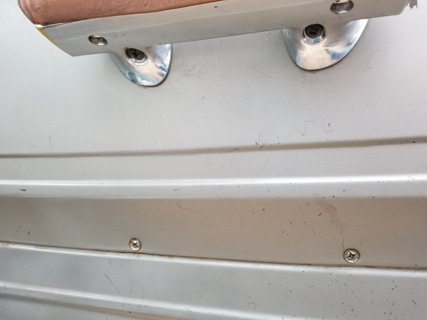

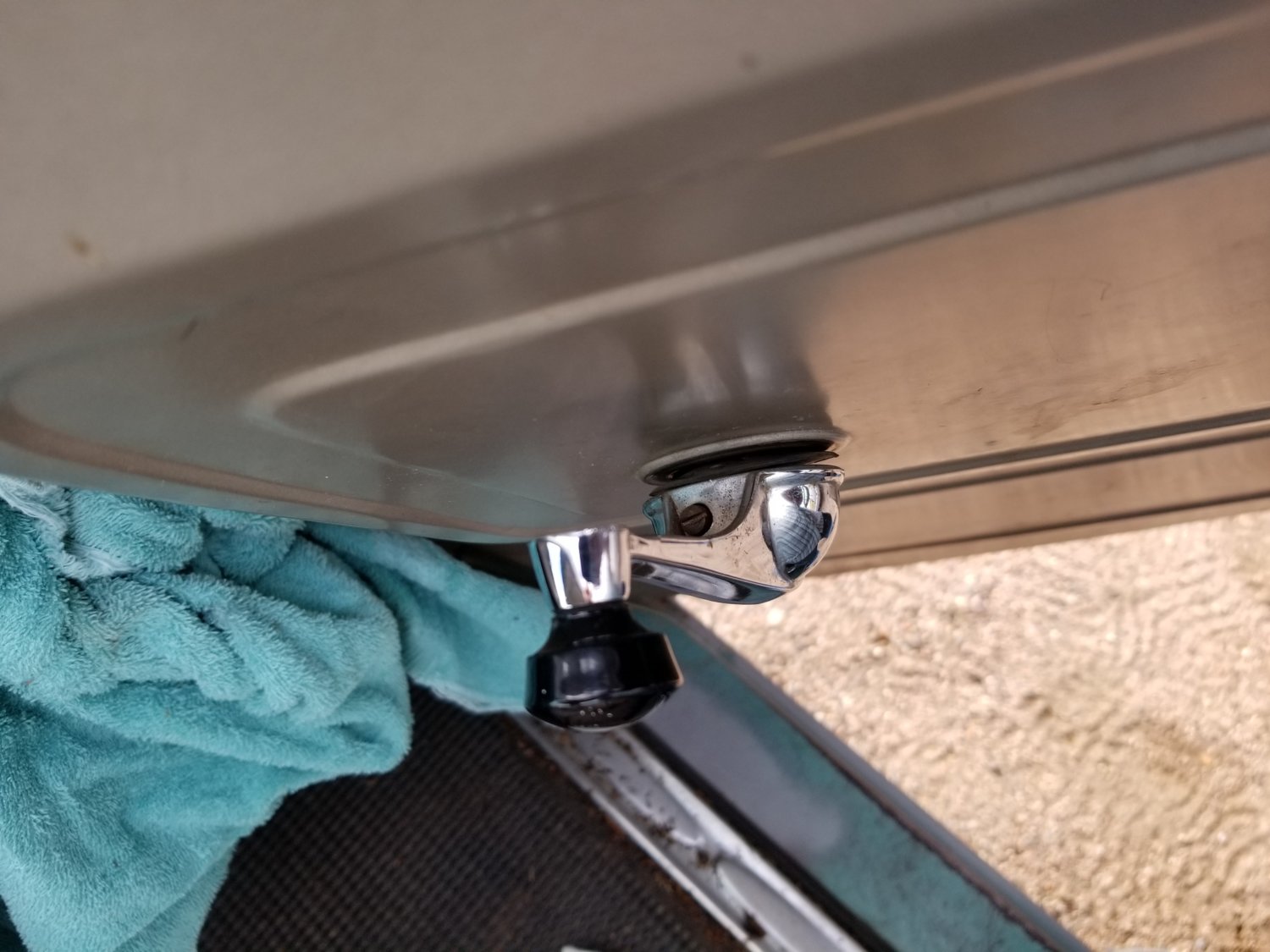

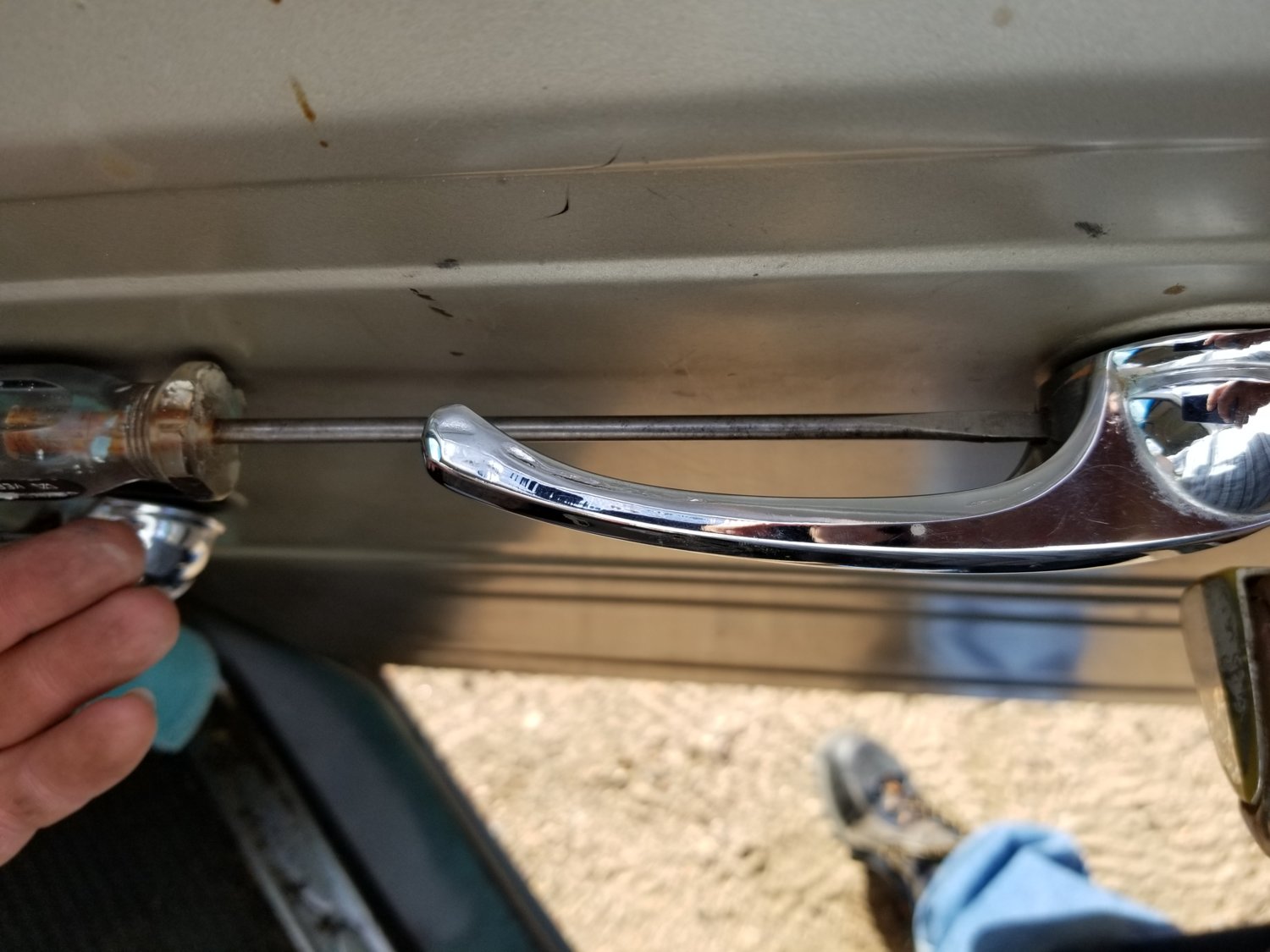

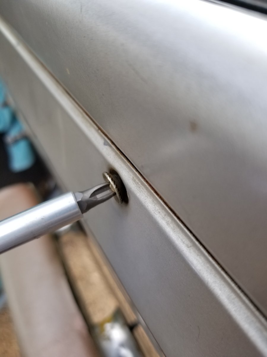

First thing is to remove the door panel. The handles use set screws.
The screws are offset so it's easier to get a screw driver on them.

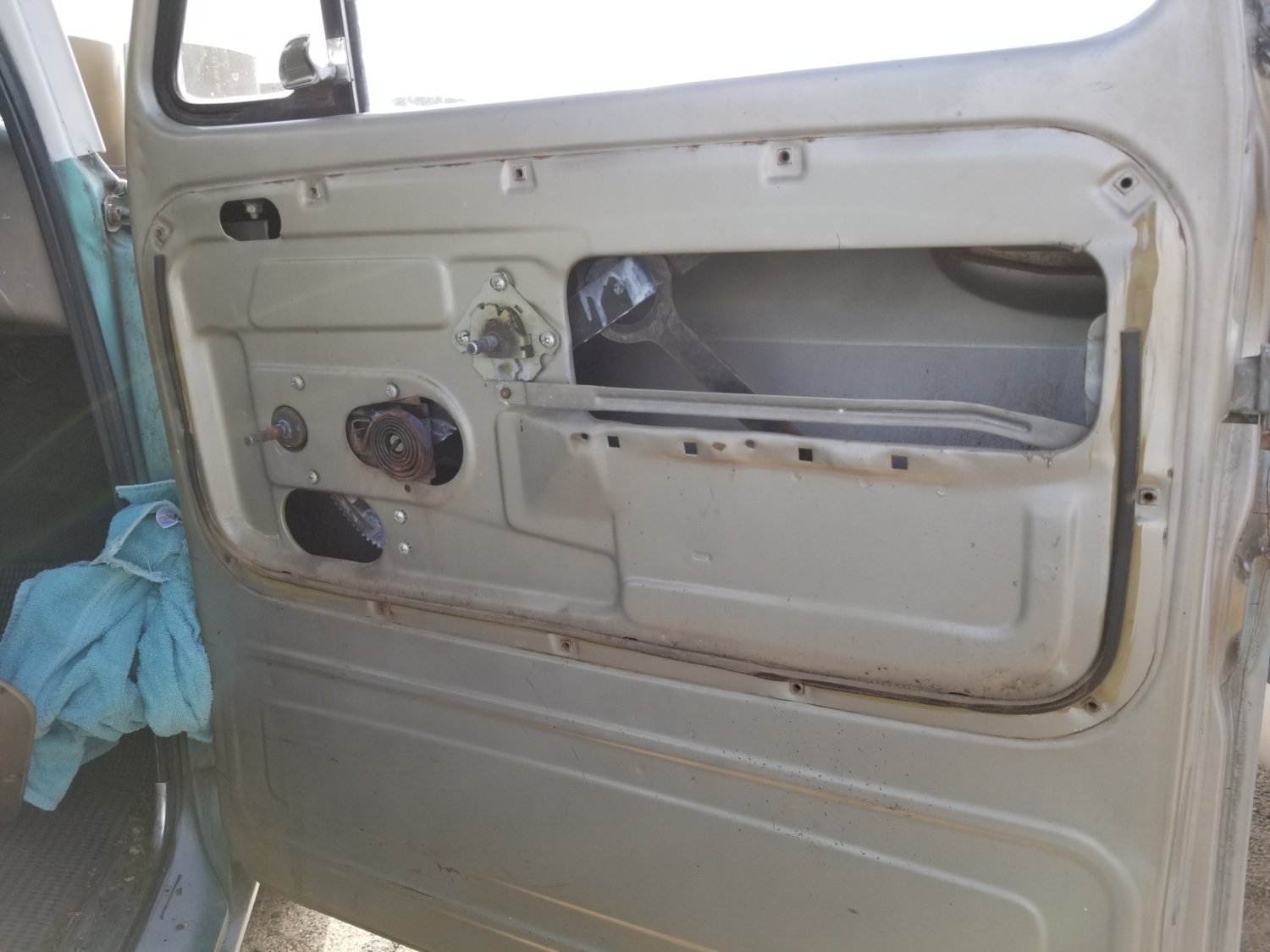

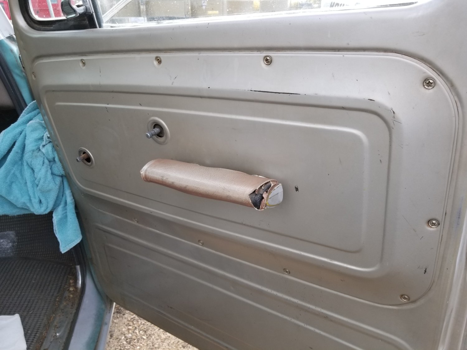

The panel is screwed to the door around its perimeter.
Don't forget the screws under the armrest.
The screws are interesting, a serrated countersunk deal.
Once the panel is off there's not a lot of access.

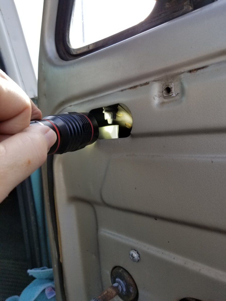

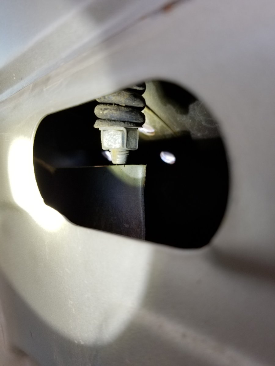

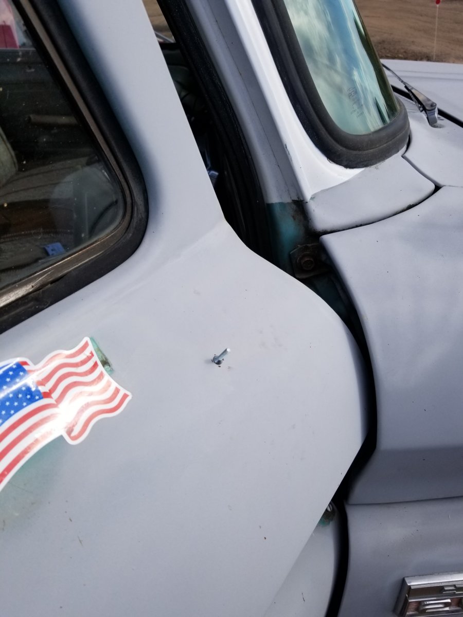

There are existing holes for a mirror on a backing panel on the inside of the door. I was thinking this makes a good template for drilling holes in the correct place.

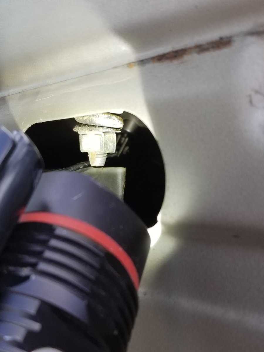

Problem is they are nearly impossible to reach.
I put a magnet in the holes and then used a screw on the other side to mark the spot.
It worked out pretty good.

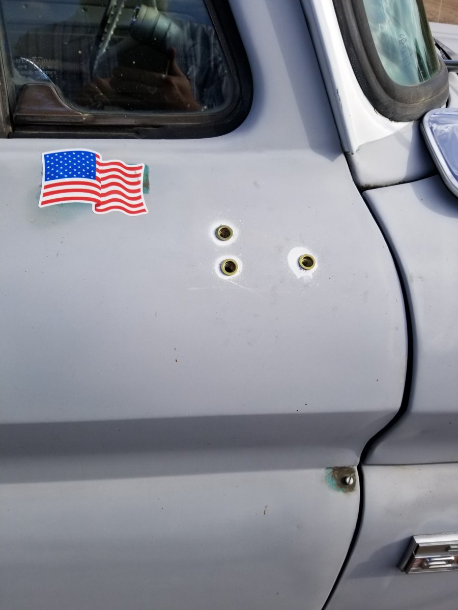

I used rivet nuts for the my ting.
The white paint I sprayed to coat the fresh exposed edges of the holes.

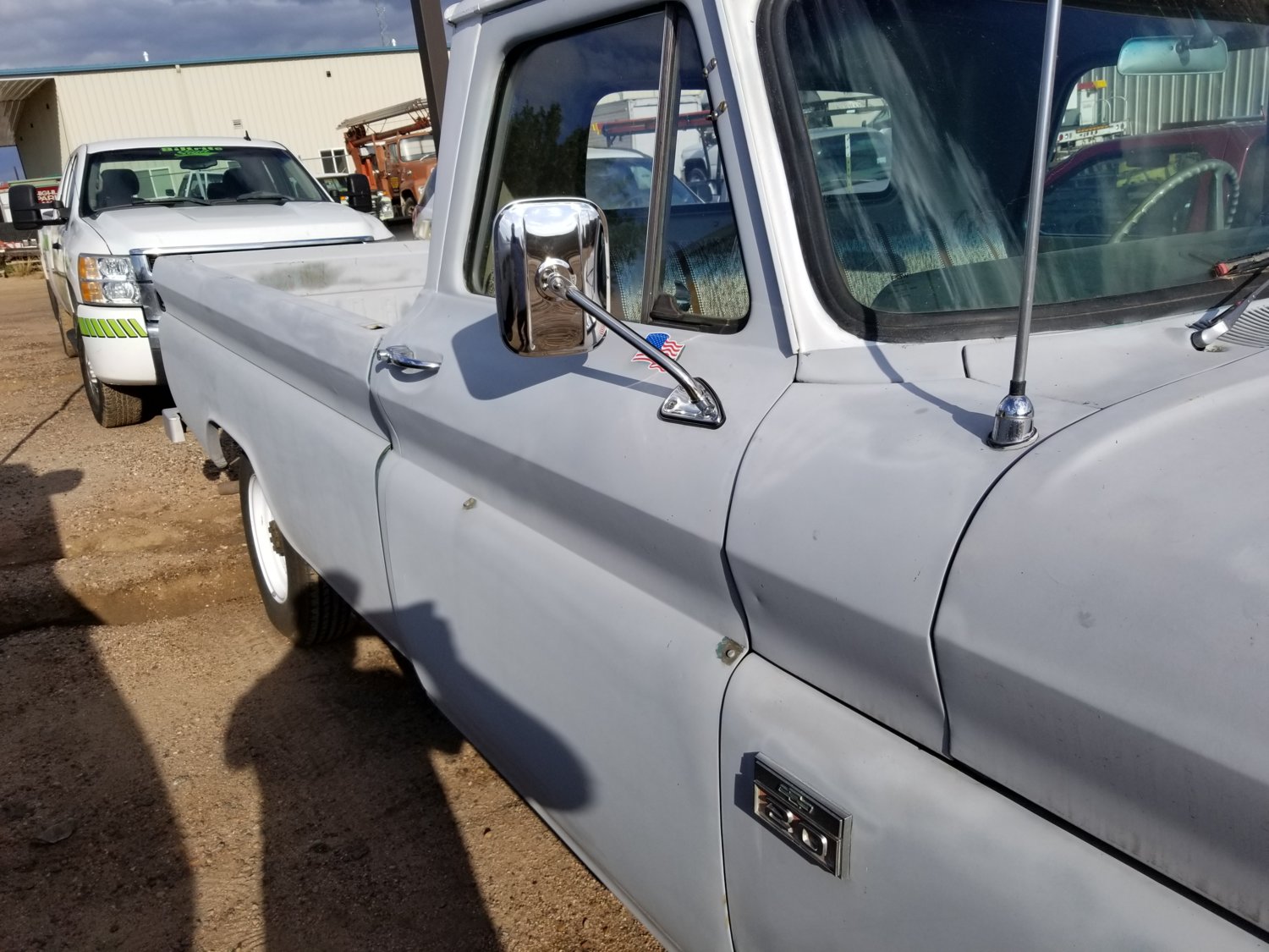

Here are the new mirrors.
