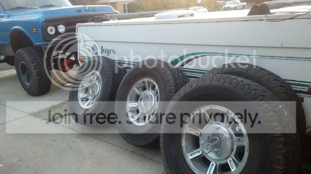

Around Halloween I picked up a set of H2s for 2 bills and the tires are in good shape. Main purpose for this is the allterrains work a better in light snow compared to swampers.
