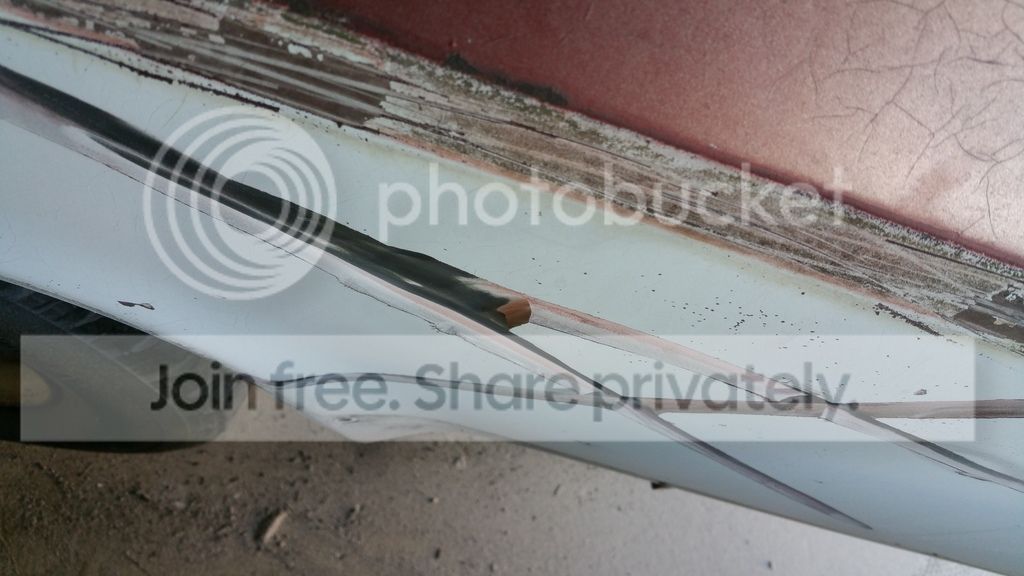

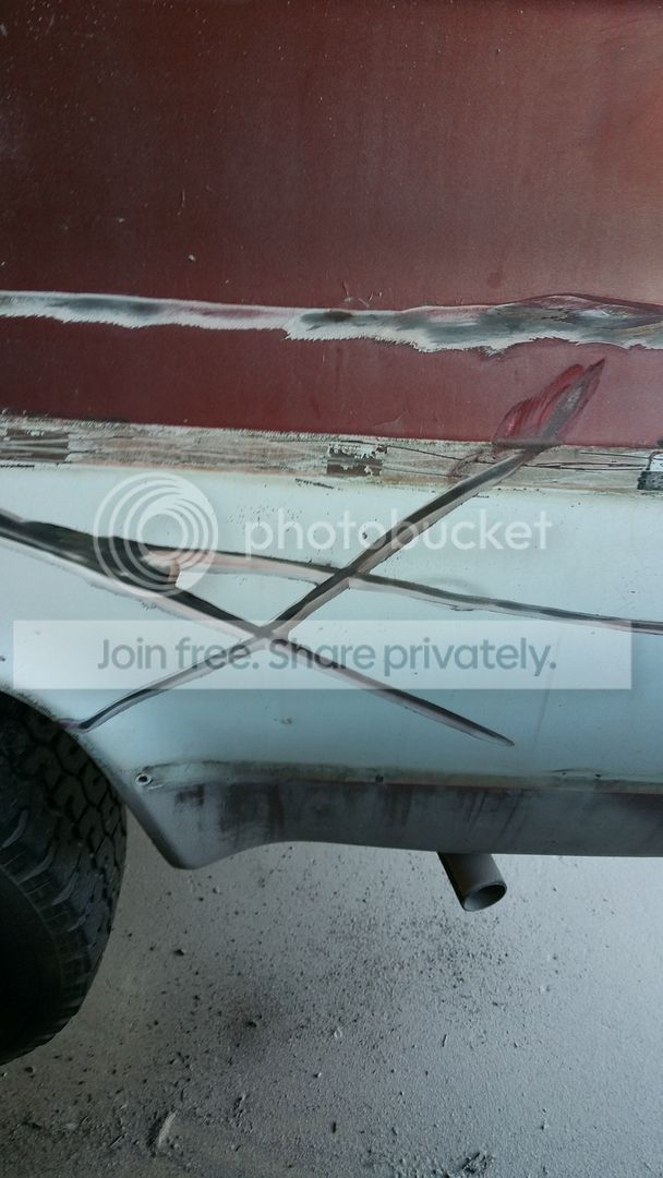

Sweet! Thanks! So here is going to be my next issue... The bed side is FULL of bondo! :doah: it's a full quarter inch thick in some areas... Looks like I got rid of that other bed a bit prematurely.
Where have I seen that before? :whistle:
I know! Lol still deciding exactly what I want to do with that. I can get a brand new bed side for $350 plus shipping. Or a good used bed to steal that side off of for around $200. Or I can spend a couple weekends getting it acceptably straight.
Did you purposely try and make it look like you were making an anarchy A... what bunch of mud
No, but it did turn out that way didn't it. Some people just want to watch the world burn. The person that did this certainly did.
So at this point my plan is to find a replacement bed side. Sucks cause I never would have guessed I would find that there. But if I go into work on a weekend I'll make enough to buy a new one whereas it will probably take me at least two weekends to get the current bedside into acceptable condition. Nut I ordered some stripping discs so I'll get it stripped down anyway and just see what's under there.
Damn dude. That sucks when you don't suspect it. MY BE finding a better bed would be easier than changing a bed side?
Meh. The bed sides are easy to change. It's just a couple dozen bolts and one 3" long weld. I would rather not deal with having a whole other bed again. I think there looks to be a couple good bed sides to choose from at either the Vancouver or sherwood picknpulls.
