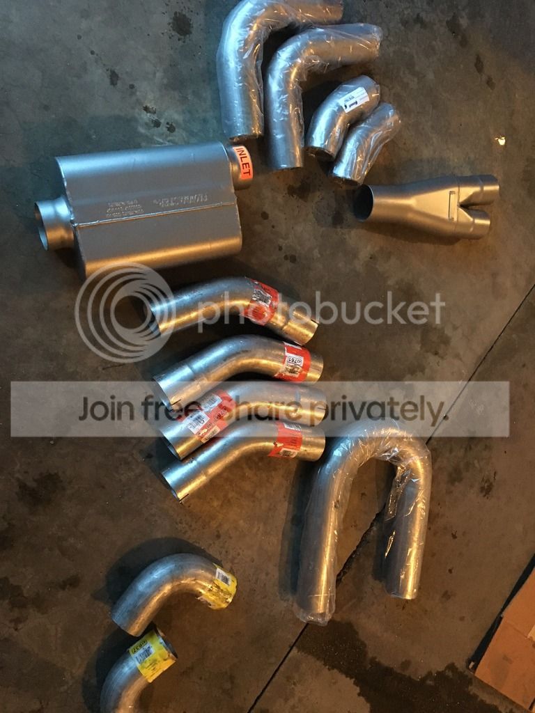

But decided to go ahead and build my own exhaust instead of have a shop do it. Was going to be about half the cost to buy all the materials and do it myself, so obviously decided to go that route. All I have done is pick up the materials as of now, probably in about 2 weeks or so going to get it all in there.
My headers have a 3" collector...so decided to go 3" off the headers and have them connect up together with a "Y" pipe...the "Y" pipe I got has the two inlets that are 3" and the one outlet converts it to 3.5" (can see the "Y" pipe in the pic below). Then into a 40 series Flowmaster (also 3.5" inlet/outlet). Then 3.5" all the way out to a 4.5" classy looking tip. From the numbers that Team 208 Motorsports was telling my stock 8.1 should put out with his tune on it, I knew it was going to flow some pretty good air, and I wanted an exhaust setup that I knew I could do some mods to my motor later on and know the exhaust was up to par (if I want to later).

I'm curious to know how much pipe you end up with. For my swap in the crew cab I'm figuring on (2) 2.5" mandrel U-bends to get from the block hugger headers to the Y-pipe. I'm hoping to have enough straight pieces from the U-bends to not need any 2.5" pipe.
From the Y-pipe I'm doing 3.5" into a 50 series big block muffler. Figuring on (3) 4' pieces of 3.5" straight pipe and (1) 3.5" mandrel U-bend.
Please post up what you actually end up using for exhaust pieces. Should help me out since it should be about the same length as yours.
I'm a little surprised with the muffler choice being a tow vehicle but it should perform well.

Yeah, I'll take some pics of the install and give you some measurements once its in there
Performance was my main goal, and everyone knows the 40 series is a great performing muffler, and I like the tone it produces too

I'm only 30 yrs old...so I still kinda like the loud factor to it...I want to make sure everyone knows when I drive by, that the motor under the hook ain't stock :flipoff3:. This setup should get me overall what I want out of the exhaust...should flow real well for performance, but should also have a pretty good tone to it with the 40 series. I had one of these mufflers on my old blazer in high school and I really liked the tone a lot. The whole exhaust is going to be welded except for the muffler connections...I'm going to clamp those...so should make it easier to change the tone of the exhaust as I get older and don't want to :weapon10: so much, haha
Make sure you leave enough tubing/room in the design because you'll likely have a longer muffler when you choose to run a real muffler with packing :rotfl:
and a straight through Magnaflow will perform just as well when that time comes.
