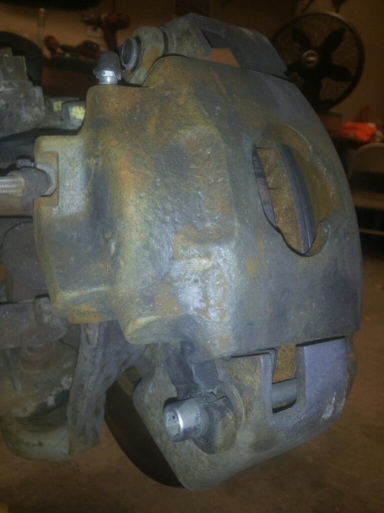

well, that was fun...
notice the missing bolt on top and the broken eye on the bottom. :doah:
I was driving along when I heard a pop and a bolt hit the ground. Luckily I DID hear it so I pulled over to see what the hell was going on and found the above. I wasn't far from home so I was able to limp home using just the rear brakes.
I've never lost a caliper bolt before and I can't believe I didn't see it sticking out considering how often I've been under the truck but at least the caliper was under warranty and nothing else was damaged.
Just sharing my fun. :whistle:
Glad You Made It Safe I Just Had My Starter Go Out On Me While Driving To Work It Started Grinding And Would Not Stop Scared Me Thought It Was Going To Blow. Couldn't Imaging Losing My Brakes
Glad you caught it and got it fixed easily. That could have been pretty bad methinks!

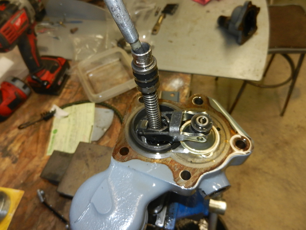

The hydroboost unit I installed last year started leaking like sieve, so I decided to try and rebuild it.
I bought the rebuild kit for $35 and everything seemed simple enough.
split it open per instructions:

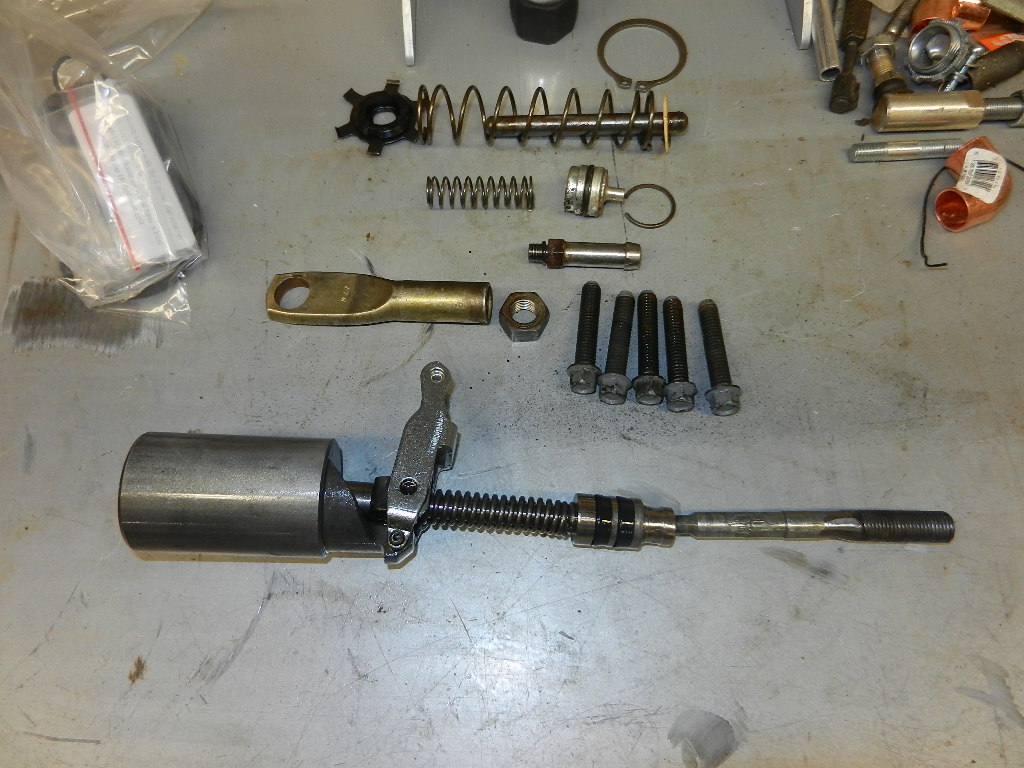

laid out all the parts so I wouldn't screw anything up:
put it all back together and tested it out... :doah:
brake pedal down and then never releases... I don't know what I screwed up, but for some reason the pressure never releases and I can't unlock the brakes. :dunno:
anyway, just ordered a new one from O'reilly's instead. /sigh
I wasn't completely confident it wouldn't have leaked again anyway though. according to the instructions if there are any scratches on the main plunger you have to replace the unit.
as you can see here, there are some decent size scratches near the end of it that may have been the problem all along.
still, it's disappointing that I put it together wrong somehow. not sure what the issue could be though. :dunno:
just figured I'd share a little of my fail. :rolleyes:
My guess your problem was this...wish I saw this sooner for ya
...from the duramax forum: clicky
problem
So I replaced the piston seal yesterday and my powersteering lines finally came into day and when I got it all together as soon as I turn on the truck it immediately sucks the brake pedal down and it never comes back up again. I figured over time it would on its own but it isn't anyone have this issue after a rebuild, it came a part and went together decent no pieces came flying out or anything like that.
solution:
You missed the same critical step that I did the very first time! The pins on that rocker arm were not in the groove shown on the picture
below.
Taken from the how-to above:
Quote:
When you begin to slide the halves back together, pay special attention to this picture.
If you do not have those pins in the groove, then nothing is holding back the rod. As soon as the pump is running, fluid pressure pushes the rod down (pulls your brake pedal to the floor). Trust me, I did the same thing when I first put it back together. Then I made sure the pins were in the grooves and the pedal was back to normal.
__________________
thanks. Too late for me but still good info to have around the next time someone decides to rebuild their hydroboost.
