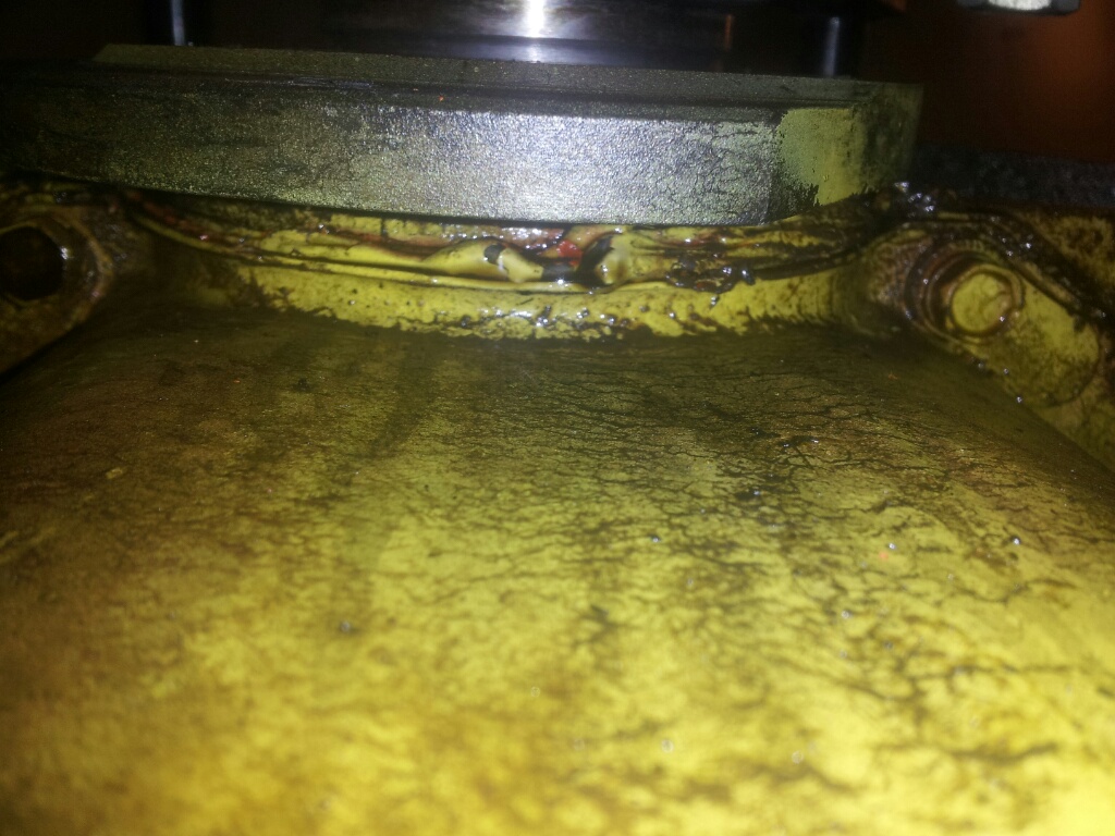

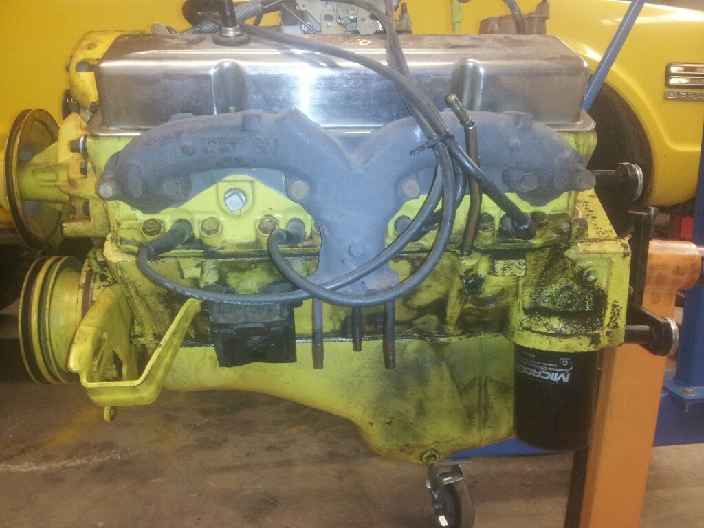

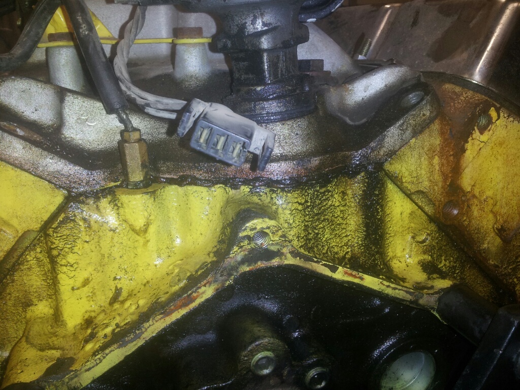

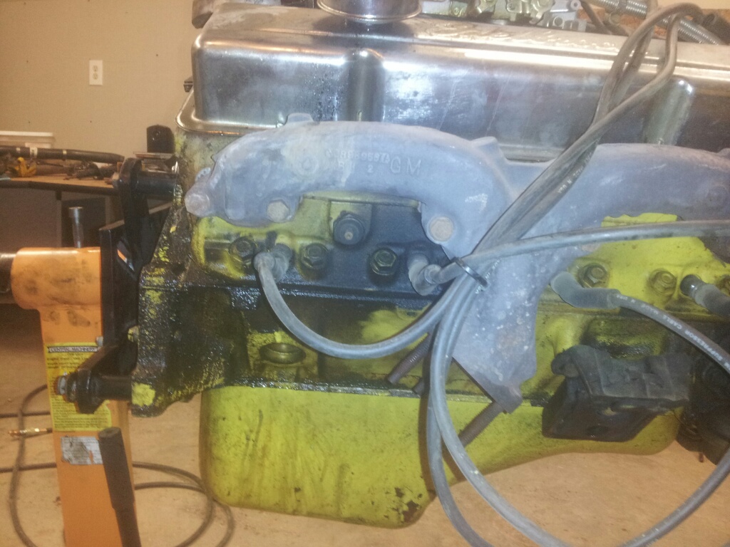

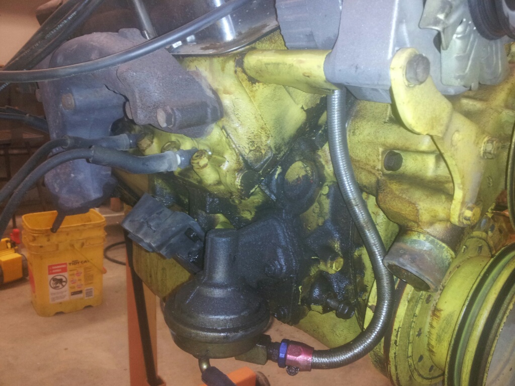

Got the engine pulled tonight. Crane worked out fantastic! plenty tall enough to clear the fenders.
Unfortunately, so far the engine is dirty as hell, but nothing screams "this is your oil leak".
The last shot is up at the rear main seal. It's as dirty as everything else, but I don't think that is where the leak is coming from.
There is a lot of seapage everywhere (especially around the fuel pump), but nothing jumps out as the source of all the oil that is coating the underside of my truck along the drivers side. :dunno:
Would it be worth pulling the dist and trying to spin the oil pump to see if I can find it that way?
No expert or anything and correct me if im wrong but what I would do is spray down and clean the engine from oil dry it and wait overnight and you might find a the leak coming from somewhere. but I could and probably am wrong about it. :dunno:
yeah, I'm going to clean it up good this evening, but it doesn't leak just sitting there so I don't know if that will reveal anything.
I'm wondering if spinning the oil pump would help any. :dunno:
Looks wettest around the adapter for your oil pressure line. I'd bet that's your guy. Looks like the intake is seeping, and maybe the gasket around the distributor, but I have a feeling your drip is coming from there. I'd clean it up, plug the other end of that little line that goes to the oil pressure gauge and spin the oil pump and see what happens.
any advice on the best way to spin the oil pump? never done it before. :)
Get a oil pump primer. It's like $18 and goes down in the distributor hole and you spin it with a drill.
