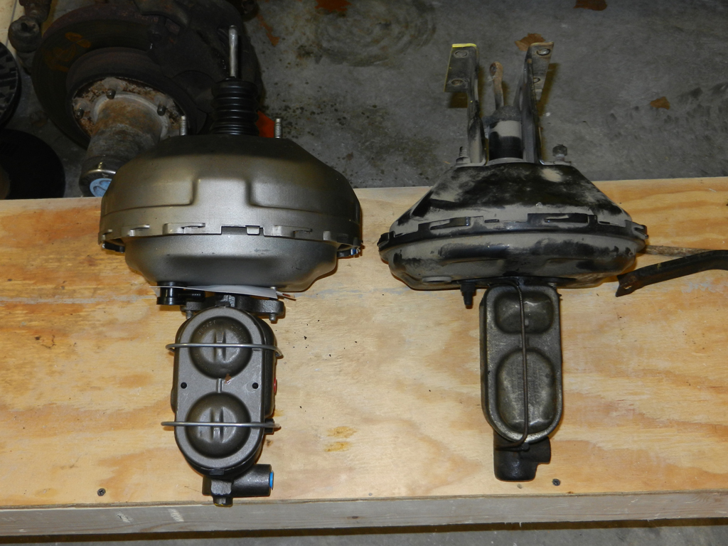

I decided on doing the 1 ton booster brake upgrade for now. I think in the long run, I'll want to go hydroboost, but hopefully this will be a big improvement for now.
my old MC next to the new one:

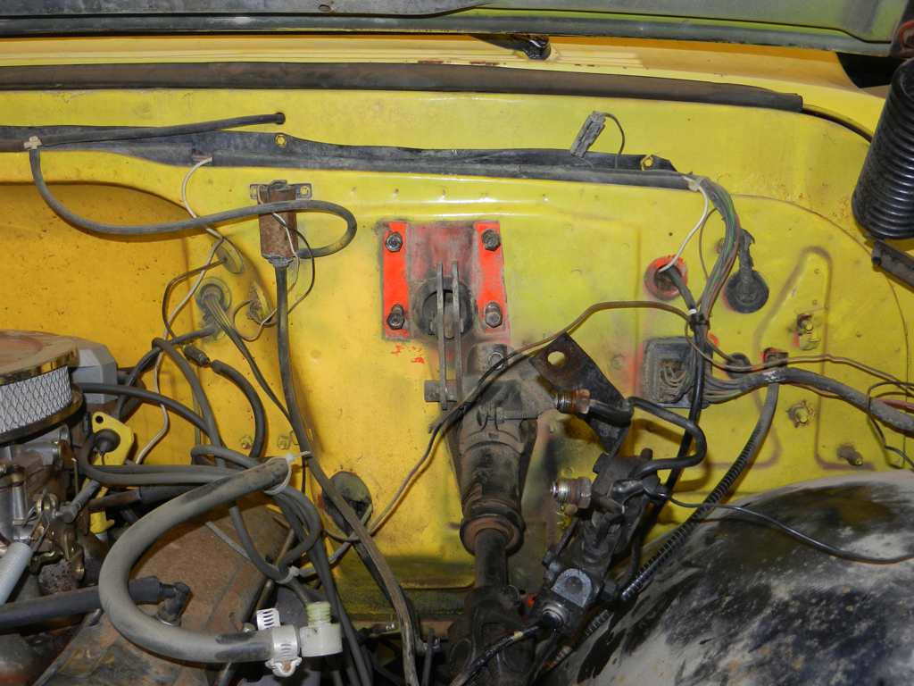

guess what I didn't pull when I painted the truck last time. :whistle:

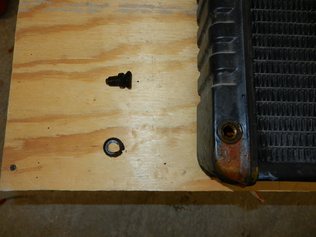

while I was dealing with this, I decided to pull my radiator and take it to the shop to see where my leak was coming from. turns out, if I'd have just taken a closer look, I'd have seen it was just the rubber seal around the drain. :doah:
since I have the radiator out anyway, I'm going to take it down and have it flushed out good. also, I'm going to see if I can plumb a drain line on in place of the existing plug. where it is now, there is no way to drain it without just dumping the water all over the drivers side frame, which makes for quite the mess every time.

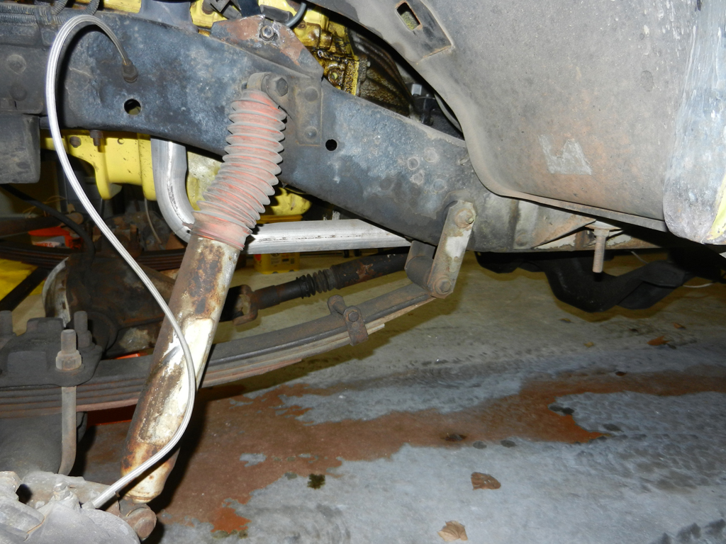

also, since I was in the picture taking mood, here is a nice shot of why I need to replace my tie rod:
that rock was closer and bigger than I thought... :whistle:

how bad is this shackle angle? would this be causing me any steering or other issues?

I did. actually following that thread as a guide. I was considering going to hydroboost, but this seemed a lot more simple for a pretty decent gain, so it will do for now.
That shackle angle looks ok but by the way that whole front end looks (well used) you could be dealing with bad/worn out tie rod ends or ball joints. That tie rod when it bent probably changed your alignment a wee bit too. At least you have a nice,Real Nice area to check them out in.:waytogo:
