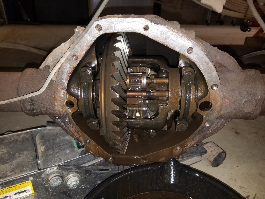

My power trax no slip let me down this summer. I rarely use 4x4, but the 2 times i did start burying the rear and put it in 4, only one tire was getting power...![]()
If you had a d44 front. You could test the trash lock for us. Not much sand here.
@Deuling There is nothing wrong with it per se, and I think it would work pretty good in a sand situation, but for low speed rock crawling it wouldn't always lock up since it's not really a locker. At crawling speeds with a tire in the air it just wasn't any help. In a situation where you could spin the tires a bit it would lock right up and be great. From what @blazinzuk tells me you could even add more clutches to make that lock up happen a little quicker.What is wrong with the trac lock? I must have missed it.

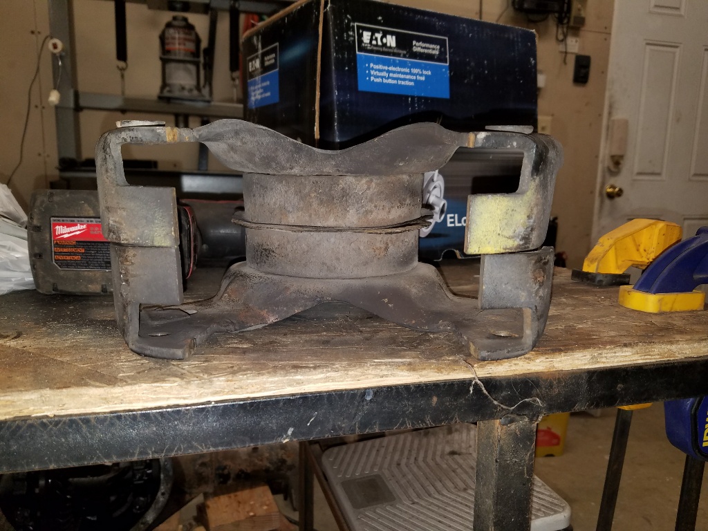

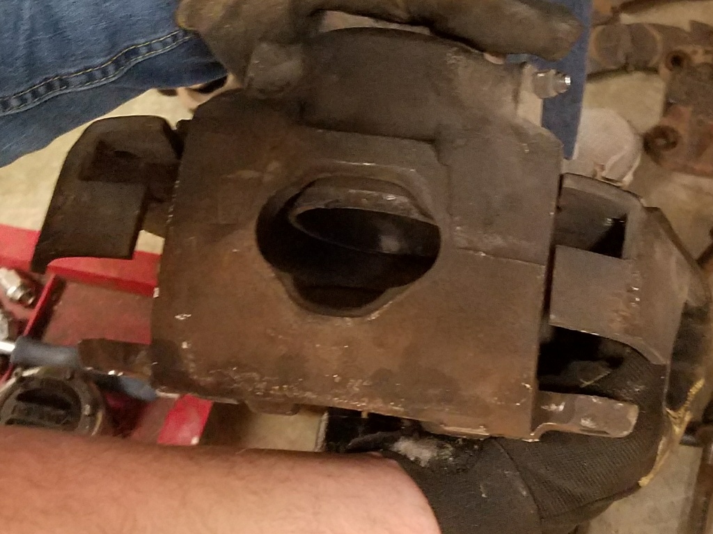

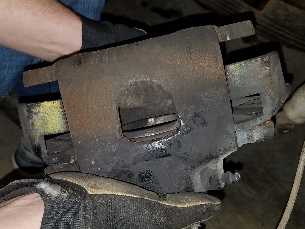

Back to the broke right brake caliper.
The caliper bracket is definitely bent.
You can see how much of a gap there is with the caliper held in the bracket.
Drivers side for comparison:
And both together:
Looks like I'm in the market for a new caliper bracket.![]()
It looks like there is no left/right side, so either side will work. Anybody happen to know if the brackets on a 10 bolt would be the same? I plan on hitting the junkyards tomorrow to see what I can find.
