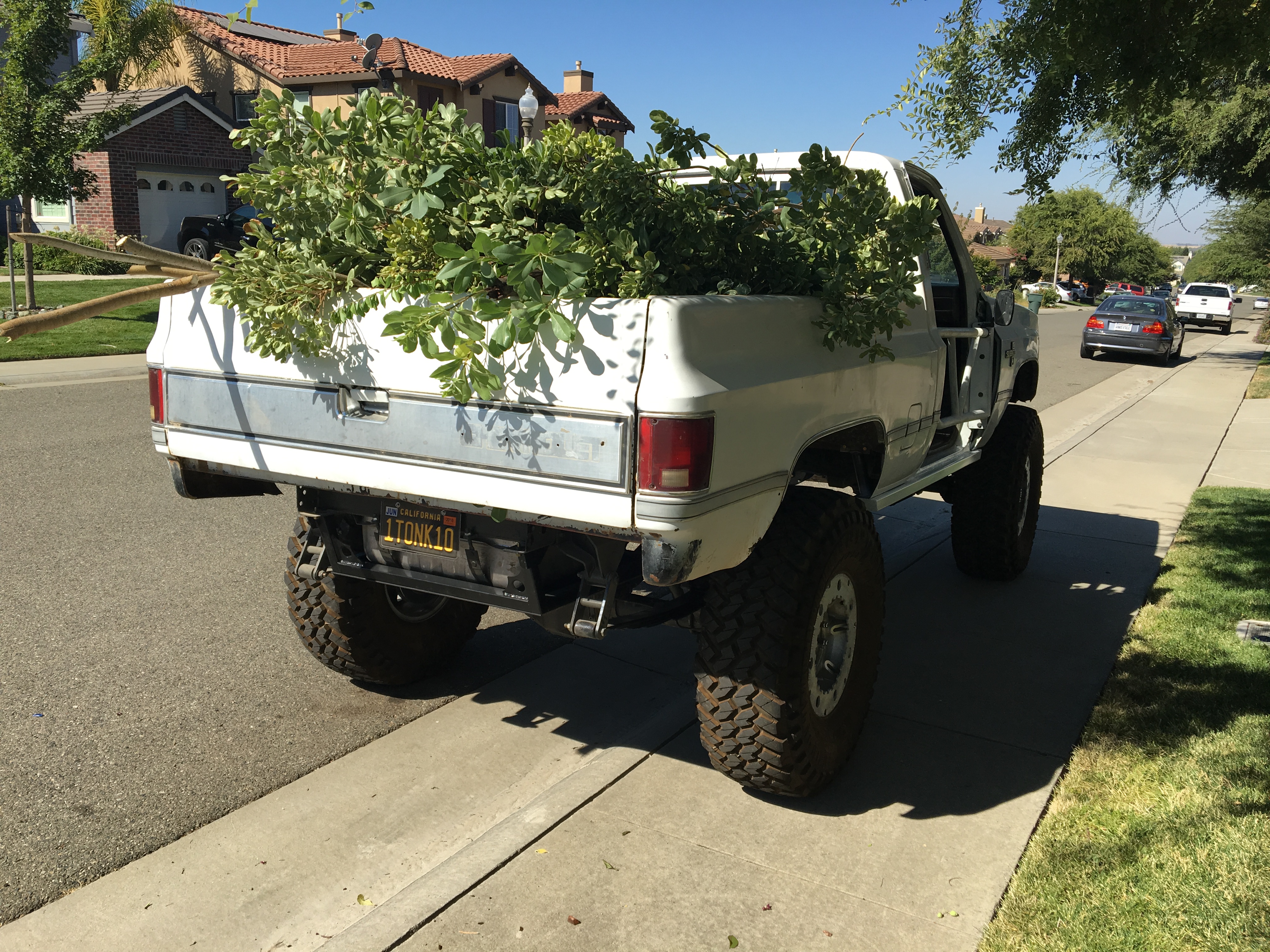

@ashman below are some pics from my K10 skid I built about 6 years ago. It see's plenty of action and I agree with @mrk5 don't half ass cover the tank.
Before the frame was boxed, I welded 3/8' flange nuts on the frame so the bolts run through the frame into those nuts. The plate is 1/4" IIRC.

Used your feet to put it up there huh? lol

yes, used my vans to get it up there :rotfl:
