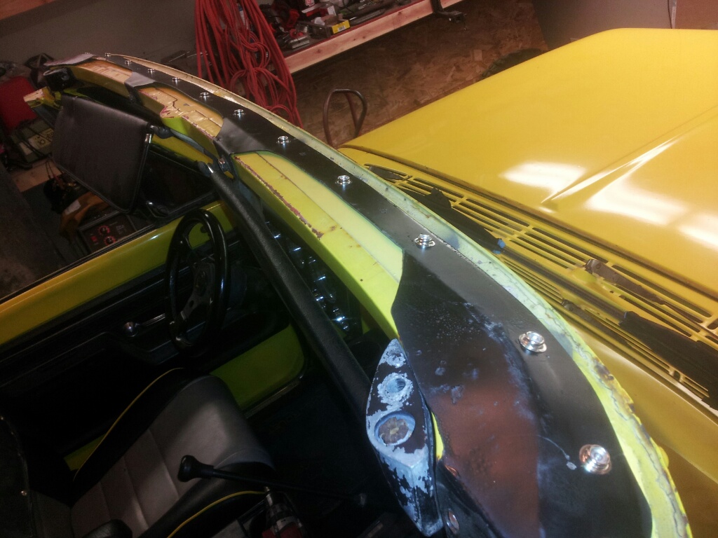

not a huge update, but I finally decided to get rid of those rusting snap studs in my windshield frame and get the snap bar that Z made for me installed.

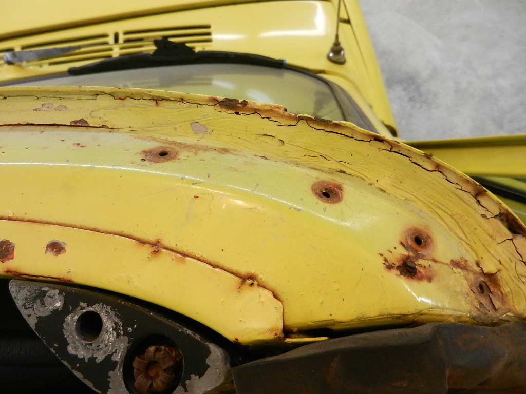

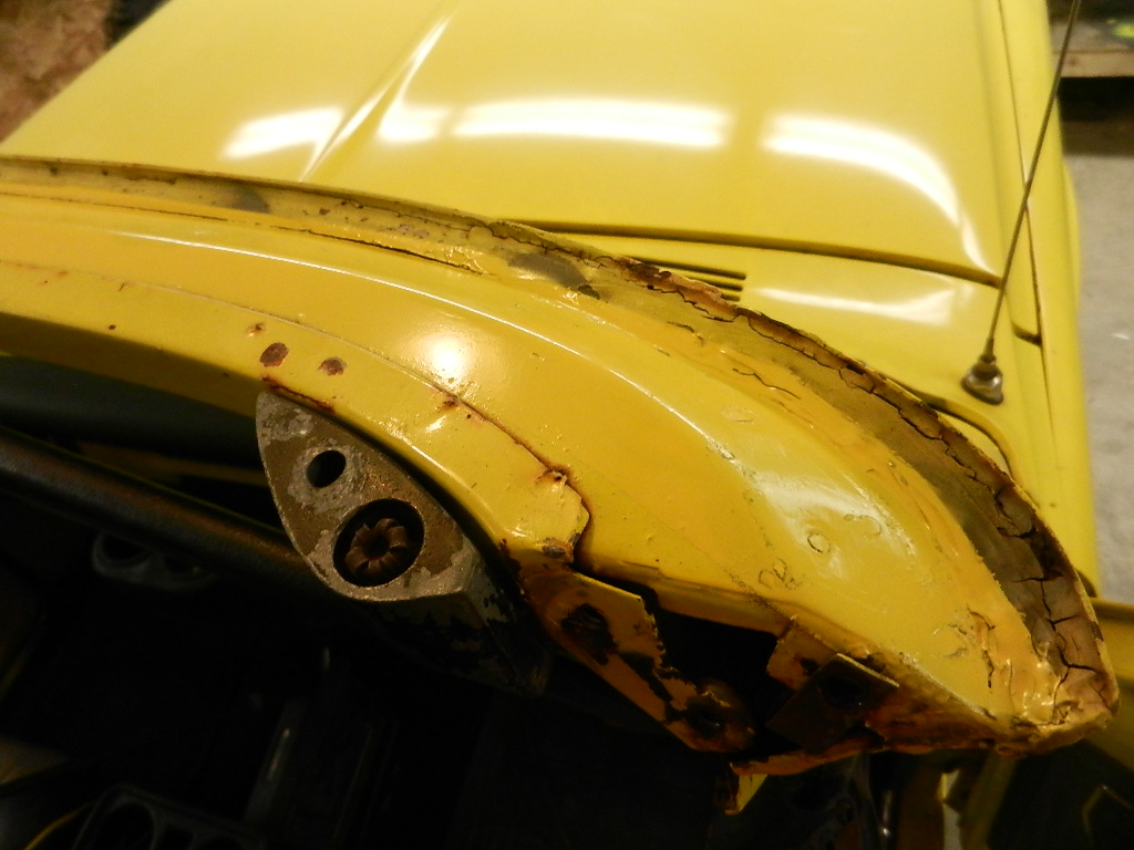

rusty holes left after removing the old snap studs:
grind/weld/primer/paint. much better:

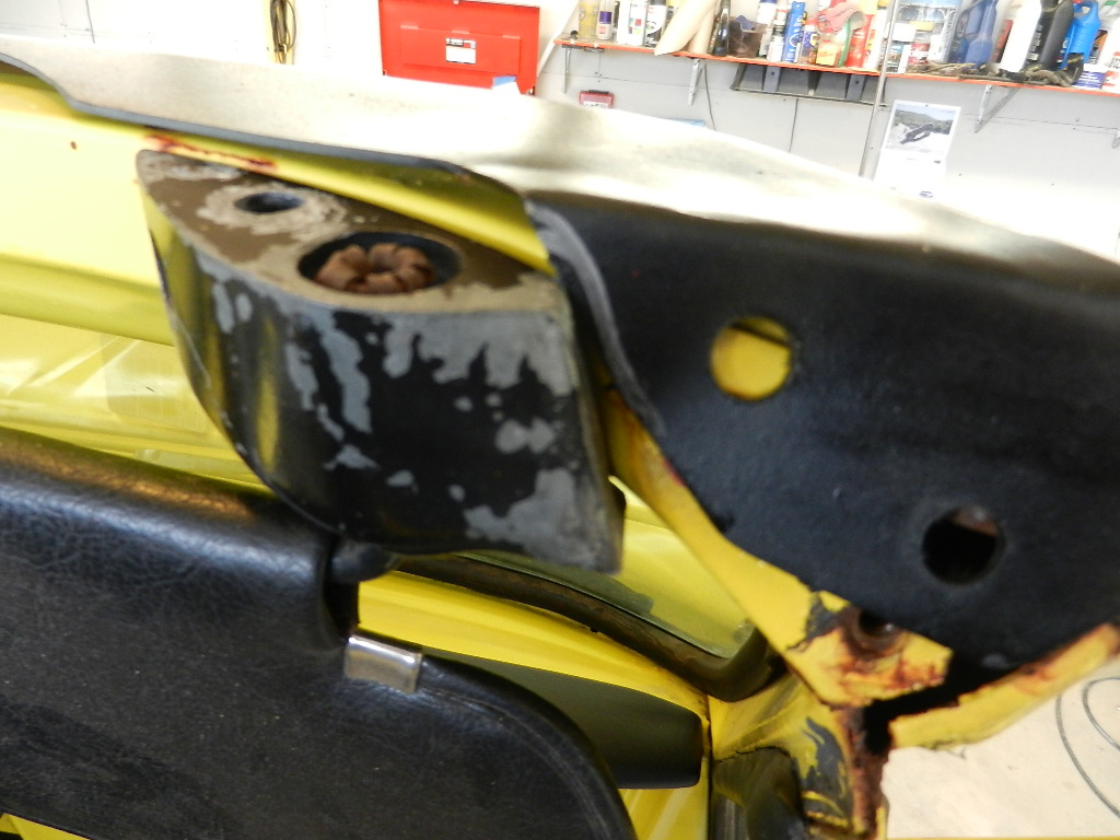

because I have the stock sun visors I had to trim the bar a bit:
the 3 holes on the end didn't line up for me either, but welding them up and redrilling them wasn't too hard.
all done and installed:
overall I'm really happy with it. Since I still have the big triangle shaped door/top gasket installed I don't think it would have occurred to me to use those 3 bolts if I would have designed my own attachment bar so I'm glad I got this one from Z.

Now with the windshield frame cleaned up a bit (still haven't fixed that rust issue in the corner... :doah:) I can move onto another idea I wanna try with the hard top. :D

Glad you were able to get that on there Ash! Sorry you had to re drill those holes. Quality control isn't quite up to snuff apparently!
I dunno. I've replaced my windshield frame as well so it's quite possible that there were just variations between our 2 rigs. It honestly was no big deal, so don't sweat it.
Just out of curiosity though, did you test fit them on your truck?

Yeah, I fitted all 5 I made to my truck. There must just be some variation between them. Glad you got it on there :thumb:
I figured you did. Hopefully that just means small variations between trucks, not that I screwed something up when I put my windshield frame on. It would be interesting to hear from any of the other guys that put one on.

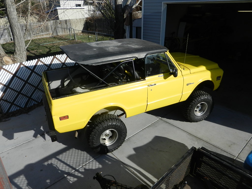

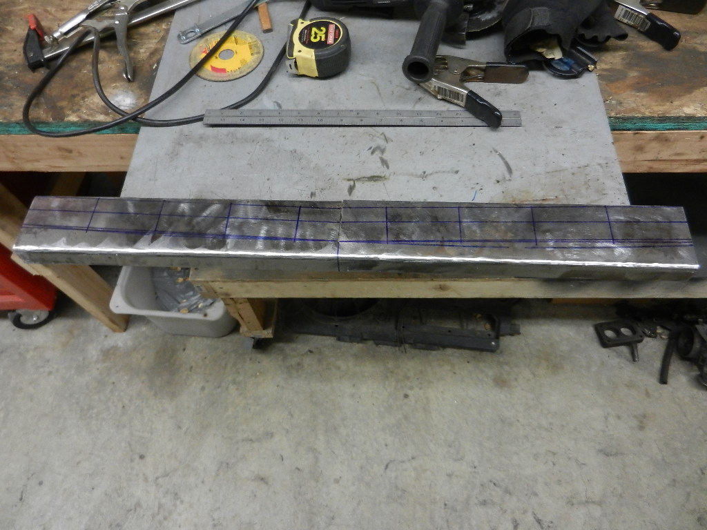

Another benefit of installing Z's bar is that I can reinstall the hard top without having to remove all of those snap studs. Of course installing the hard top is a pain in the ass all by itself, and I've gone more than a decade without it, so really it was just yard art at this point. But, once I saw what Zimmer did on the maiden, I decided to give that a try.
I love having a full vert, but the heat of the summer combined with a bald head (young, cool bald, not old sad bald, dammit!!) means that a lot of the time I need to have some sun protection. I can accomplish this same look basically with the soft top and the sides rolled up, but at freeway speeds the soft top vibrates a lot and it's noisy. I figured this might be a better option... maybe. It didn't take long to do, and if I decide I don't like it, it's just that much easier to get rid of whats left of the hard top anyway. :P

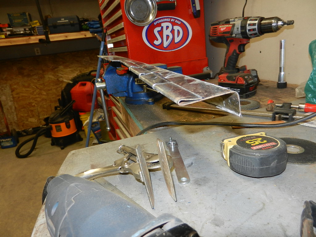

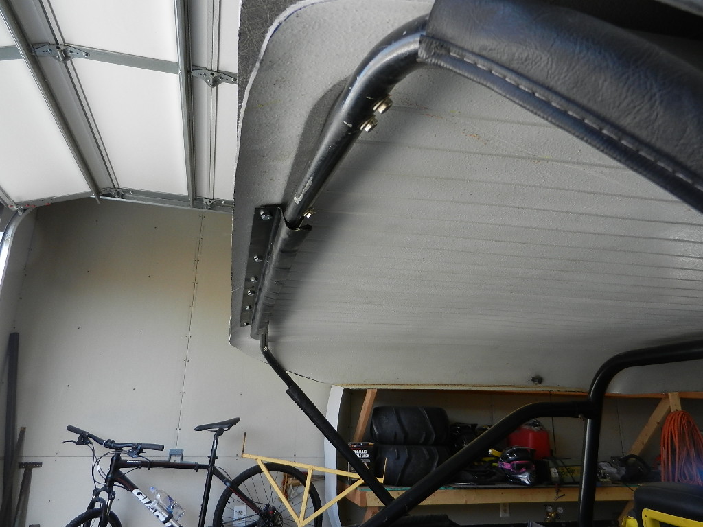

The only real fabricating I had to do, other than cutting up the hard top itself was building a bracket to hold the thing up. Since I had this nice bar there for use with the soft top, I figured why not use that. :)
The support bar isn't straight across, so I had to put an arc into the bracket.
Because I was bending this by hand I had to cut it into 3" sections. I rolled over the outside edge to make it less likely to injure, and to make a pocket for the bar to sit in.
Bracket all installed. I sprayed it down with a rubberizing coating as well.
I'm still deciding if I like the way it looks or not, and I won't know if it's more hassle than it's worth until I switch to the soft top and back a few times, but what the hell. :pimp:
I have to say, that was completely unexpected! An interesting idea for using the old top and making it a little less bulky. Can you remove it by yourself? Is there any chance it'll fly off on the freeway?
I can move it around by myself, but it's still more of a pain that I had hoped. I'm thinking of putting a couple of handles on the inside that could double as oh-sh!t handles for the bench seat. I think that would help a lot.
As far as flying off goes, it's still attached to the windshield frame by all 4 factory bolts, so I can't see that happening, but I do think I should mount it to the top of my roll bar as well so it can't move around even on big bumps. I'll do that and fill in the holes created by cutting on the top if I decide I like it enough to keep it.
