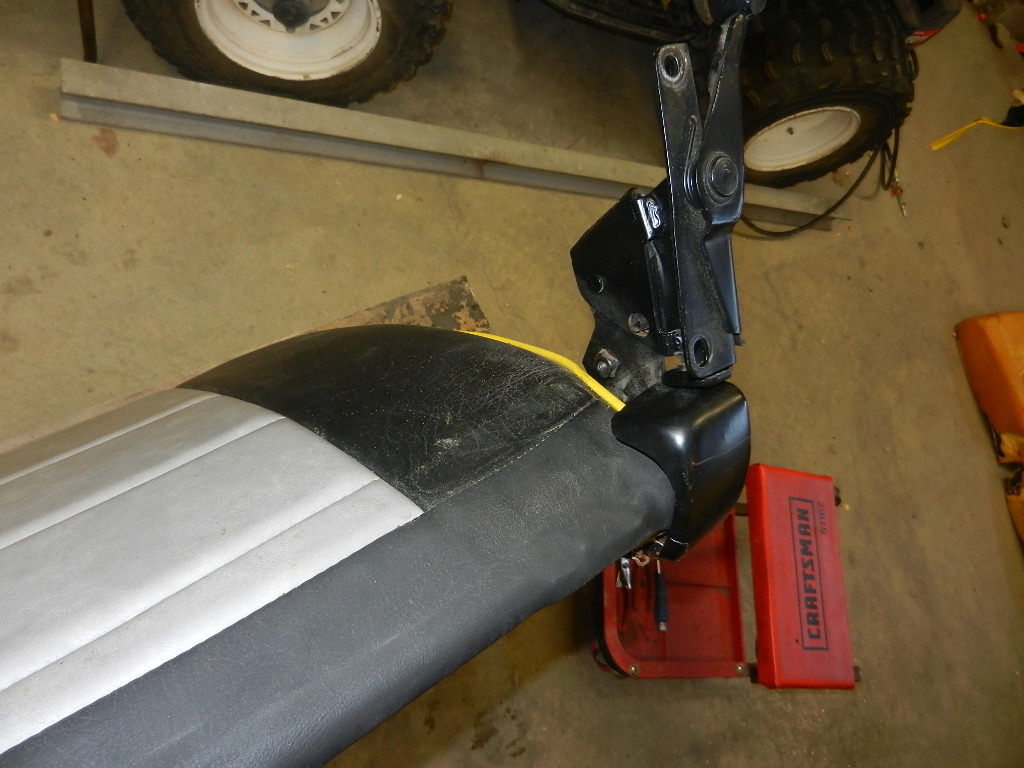

I always wanted to do the rear seat mod to make easier to remove the seat, so I decided to tackle that instead. Since I already had my seats recovered last year, I couldn't just slap in a newer seat, so I modified mine.

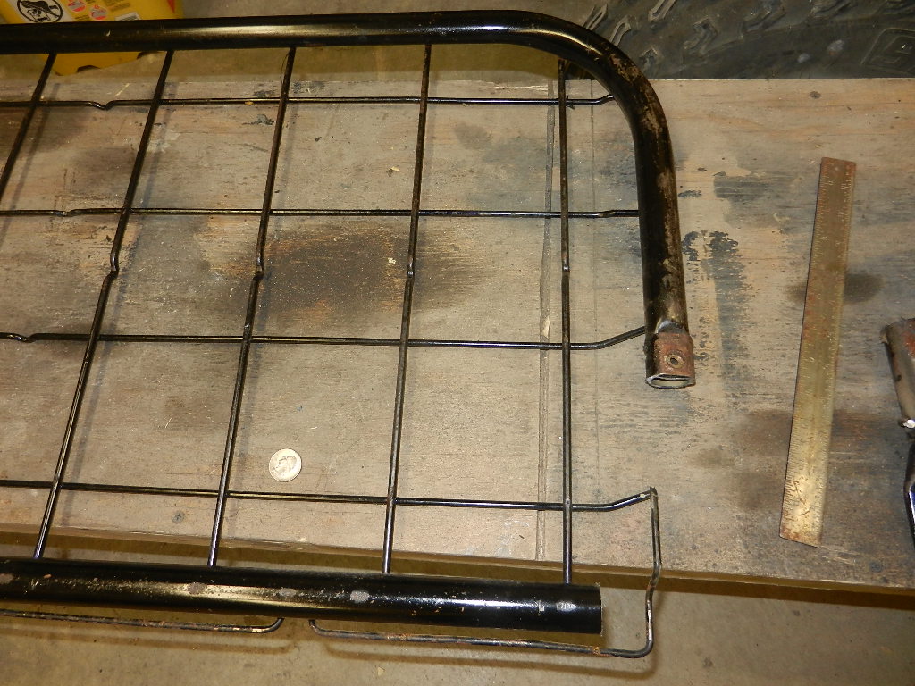

add hinges to bottom.
cut corners out of back and switch for corners that fit the hinges.
get some help from my daughter cleaning up the parts. :thumb:

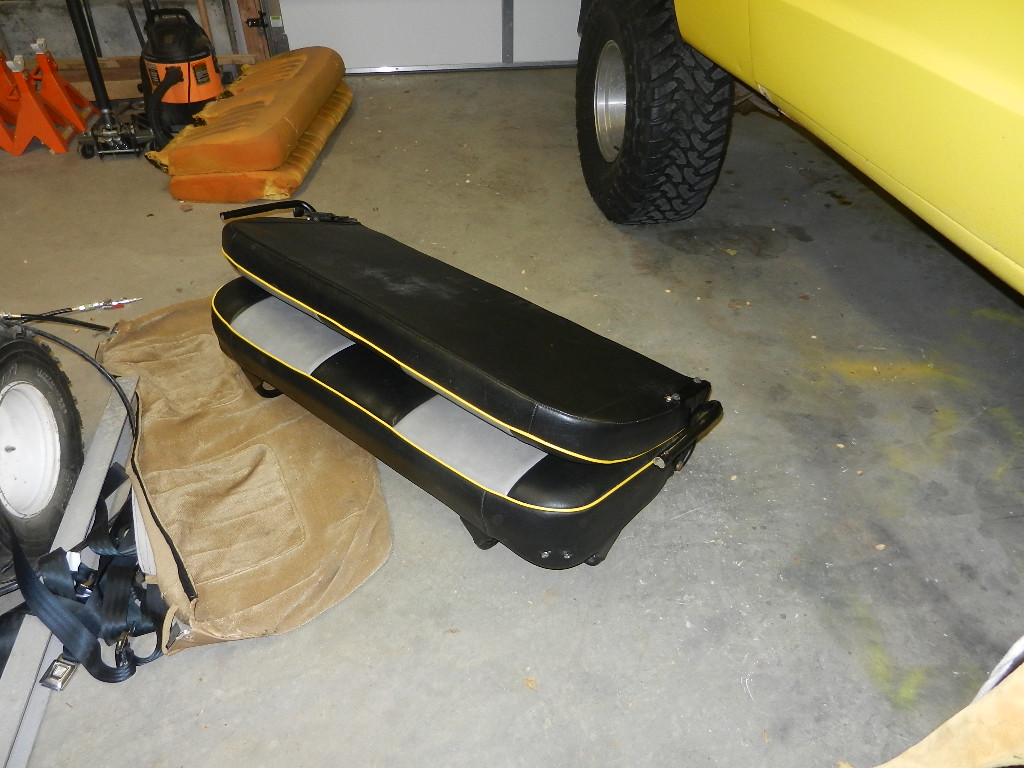

finished with seat mods:

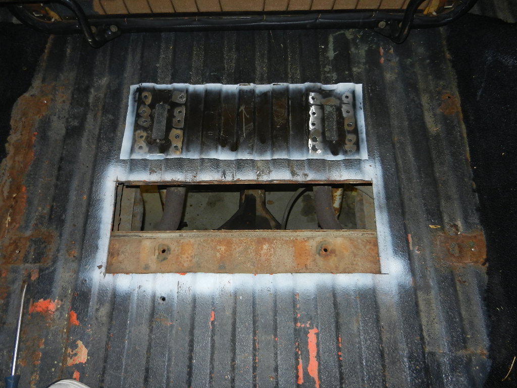

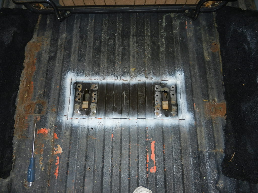

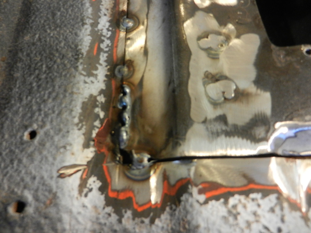

started welding in the quick disconnect pockets:

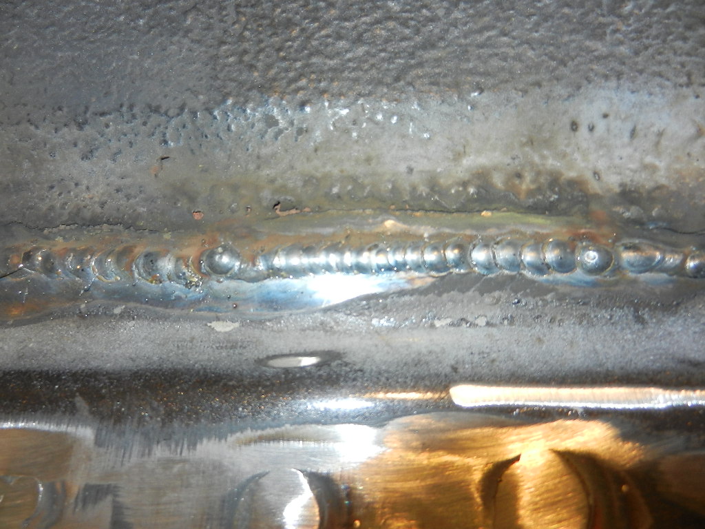

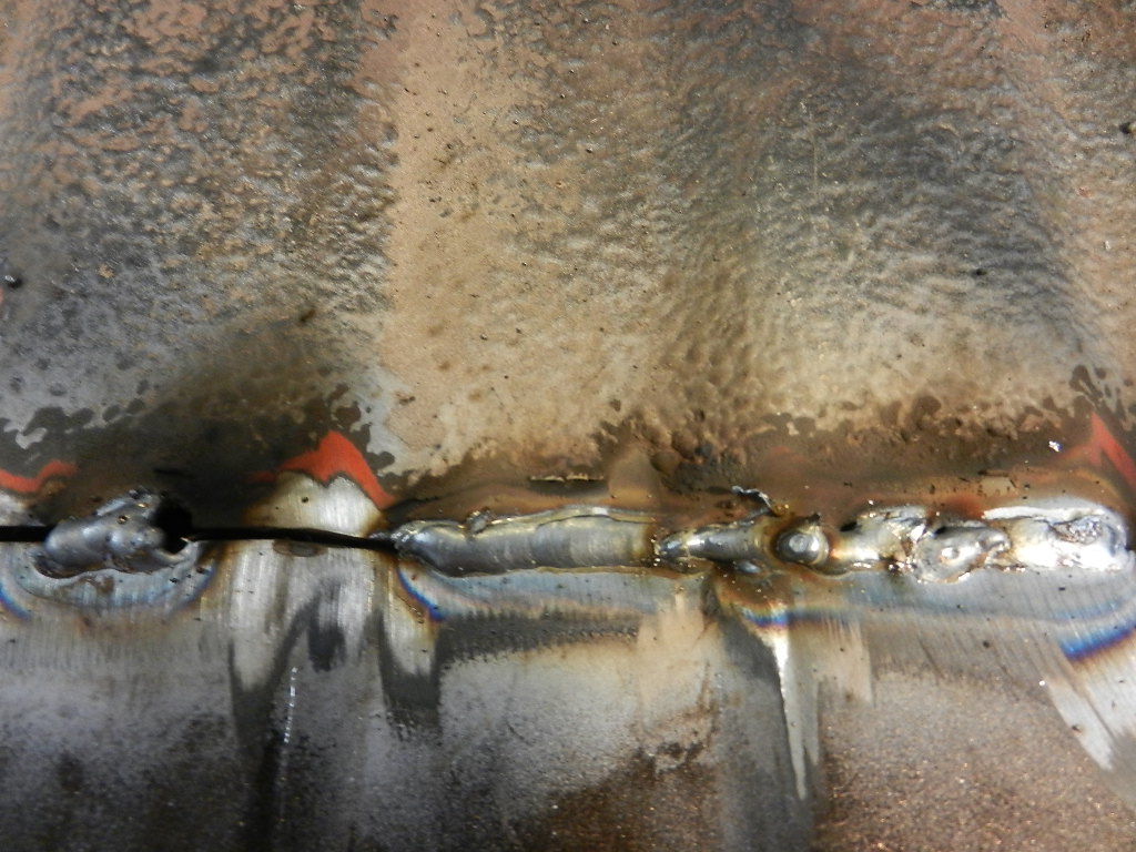

I'm glad I started here because welding sheet metal sucks!
I think I'm getting a bit better, but I'll take any welding hints you guys are willing to pass along.
so far if I'm burning through I turn down the heat and wire speed and if the welds aren't laying flat I turn up the heat.
sometimes when I burn through I think it's because I get ahead of the puddle, if that makes any sense. :confused:
I'm not done with it yet, and it's nothing compared to what a lot of you guys are doing, but it's something. :D
The stitch welds look good on that sheetmetal. The problem appears to be that you tried for a continuous bead. That's a no-no on sheetmetal....... No shortcuts allowed! :)
You have to just keep stitching around the perimeter, adding a weld next to each of the previous ones. I usually try to overlap the existing weld by maybe 1/3 to burn into it a little. This helps prevent burn through because the weld is usually a bit thicker than the sheetmetal is so it tends to be a bit more forgiving. Plus by doing a slight overlap you won't end up with little pinhole gaps between the individual stitch welds.

Nice work Ash. If I weren't planning on 4 buckets in mine, I'd be doing this as well in the future.
Like Greg said, have to stitch sheet metal unfortunately. It's time consuming, but otherwise your finished product will look like this ~ even if you can manage to not burn through every couple inches...

Just like the boys said. It's all about tack here, tack there, tack everywhere. Let cool, drink a beer, tack 1/4" from where you started, tack a 1/4' from where you started over there, too.
Just keep moving around the patch with short little bursts of weld till you have a six pack down and a continuous set of weld bumps around your patch.
Then it's all about the Roloc disks for me on the clean up.
It's just a slow process that is nice and relaxing with beer and tunes. :whistle: :woot:

as far as the welding goes, I was trying to run about an inch or so bead before moving to a different spot. that seemed to work ok (once I got the heat and wire speed right) in the middle of the panel side and as long as both panels were touching. I had much more problems in the corners and in places where there was a small gap to bridge.
is there a good technique for bridging gaps? I'm trying to build up on one side and just slowly fill it in over several passes but is there some settings I should be changing too that would help?
You got lucky welding 1" at a time. You'd be better off "forgetting" that technique now before it becomes a bad habit that you can't break.... when you start doing welding in areas that are more visible you'll have panels that look like wavy Lays.
To bridge a gap, I usually attack it perpendicular (across the gap) with a really shallow gun angle and aim for the metal on the far side of the gap with the wire. As the weld starts, it will grow back towards you and usually will bridge across to the near side of the gap and connect them together. If I can get a few of those in different spots and the two panels didn't shift out of plane I'll go back to welding "along the seam" (parallel to the gap) using the 1/3 overlap technique I described previously. The first stitch weld becomes the basis to build from and the subsequent welds will usually "flow out" to grab the metal on each side of the gap and connect them.
Don't get hasty! If you rush and try to pour too much heat, or do too many of those welds at once, you'll blow through. I usually watch the color of the weld and wait until all the red is gone for a couple seconds before trying to stack another weld in there. Remember, as the metal gets hotter it welds a lot faster.... so the cadence of your welding has to change from when you were welding cold sheetmetal. The trigger pulls generally get a lot quicker as you work your way around that panel.

cool, thanks for the help Greg. I'm with ya on the wavy panel too. I've noticed how much the one I'm working on has warped because of it. It doesn't matter on this panel, so I'm glad I started there for sure.
thanks again for the welding tips all, it's made a huge difference!
once I got the hang of tack welding and letting the red go away before moving on to the next one, I found that I was able crank up the voltage a bit and get a smaller, flatter weld with better penetration.
